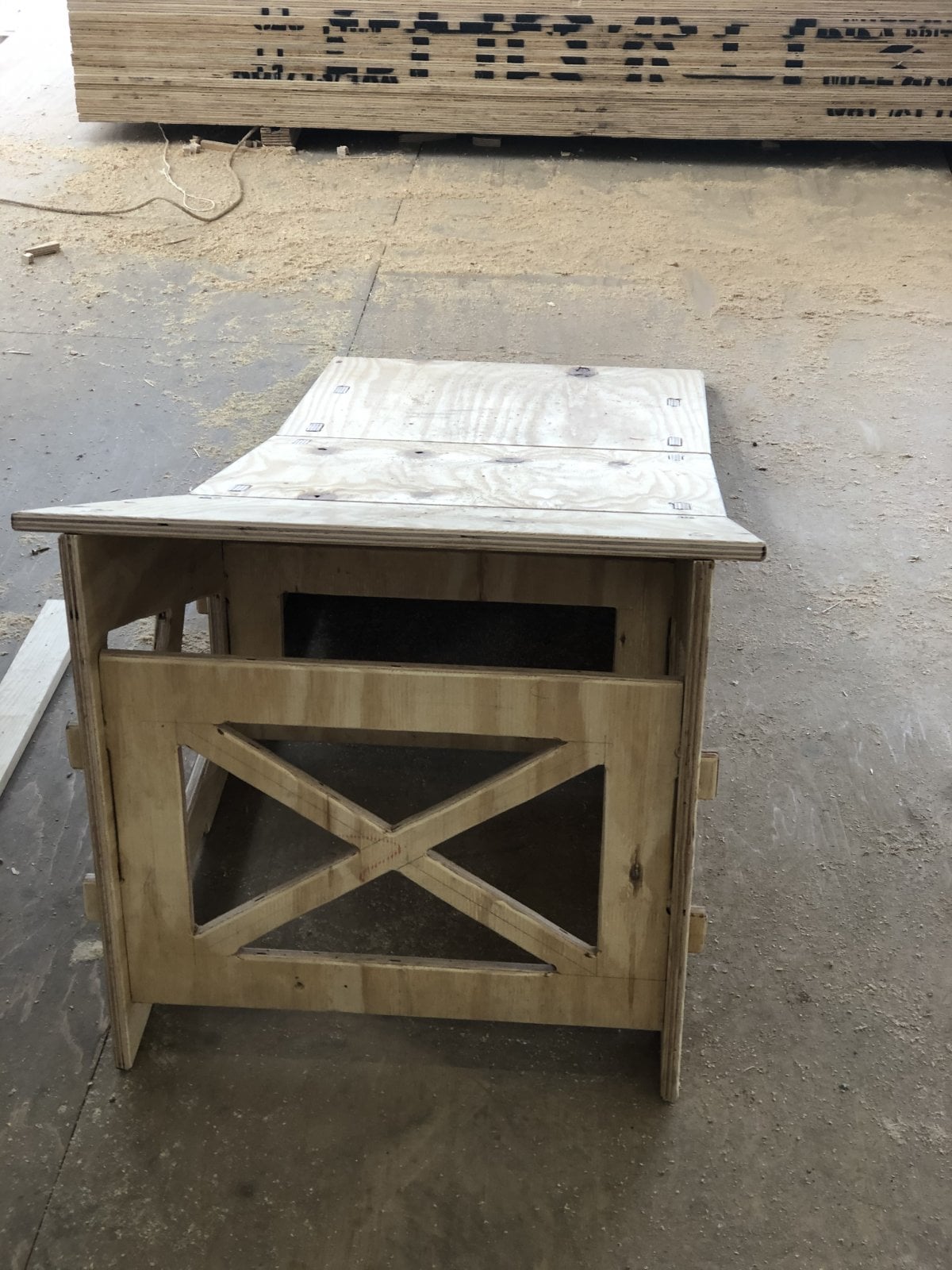

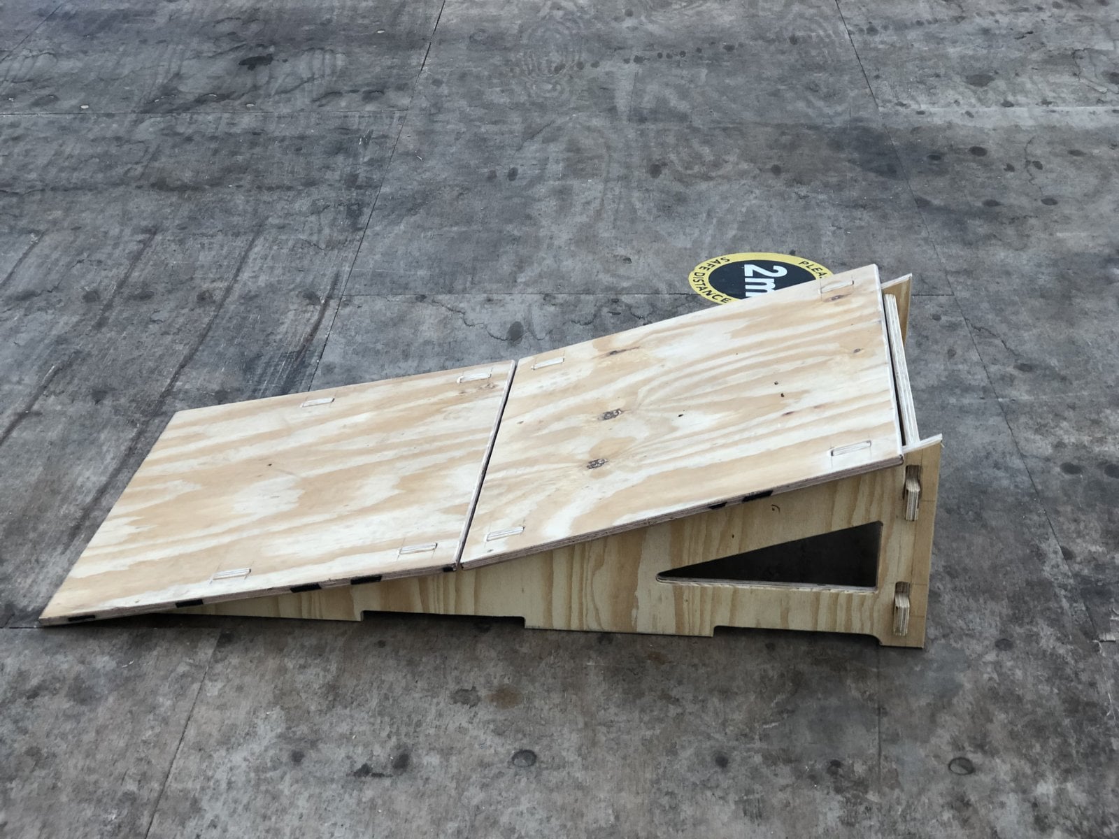

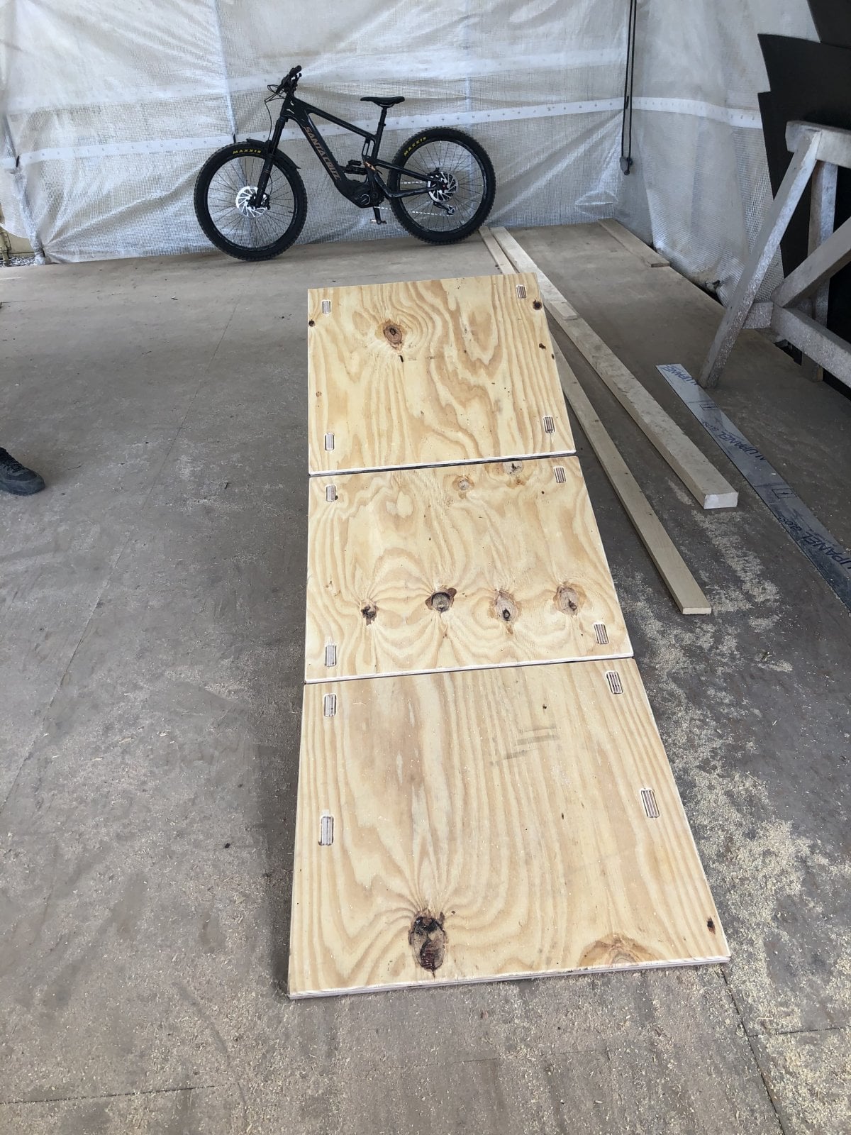

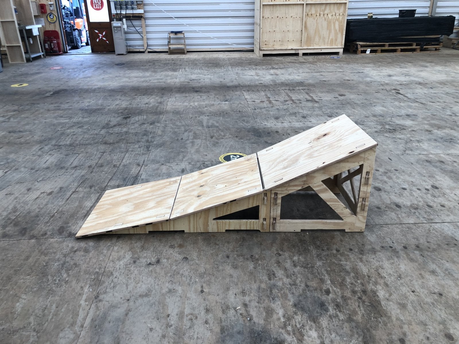

I built this one at work one day when it was quite. Wanted to make a ramp that could be flat packed but also put together and broken down without the need of any tools. After building it I decided to break it in half to make a smaller ramp with the option of adding back the other half.
Built it, jumped it once then gave it to a mate for his boy to have.
outstanding work there mate, thats the way to do it and ive been thinking on how myself.. you have just saved me loads of time (y) (y)
I am planning on a modular landing as well and its hard to do while keeping the weight and materials down !
The jump ramp I built has 2 ribs but for a landing ramp I’d maybe put 4 or 5 ribs tightly spaced but with 4x2 cross braces. That way you should be able to get away with a single 18mm ply deck as the load on it should be spread by the ribs. Obviously this is all dependent on the angle of the jump ramp. As in if the jump ramp is steep, so it put you way up in the air, then I’d double skin the landing ramp.
(I except no liability for injuries caused by following any of these ideas)?
