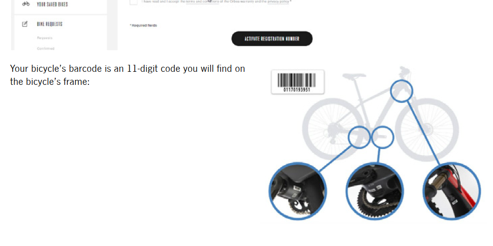

@RickBullotta Yeah, you are probably right, I guess they notified those that got their M-TEAMs or M-LTDs delivered with e*13 alloys first, and then once that was complete moved on to those that had received their bikes with the e*13 carbons. Anyway, both sets of customers are getting the same Shimano cranks. Regarding your question on the other thread, the serial number on my bike was a barcode sticker on the bottom of the downtube just behind the head (above the CE certification sticker and the 'Made in Spain' sticker).

interestingly my barcode sticker was on the rear of the bottom bracket area and I had to remove the rear wheel to get to it! Sounds like not a lot of consistency with Rise builds. Ha.

The quick start guide shows three possible locations. (see attached)
