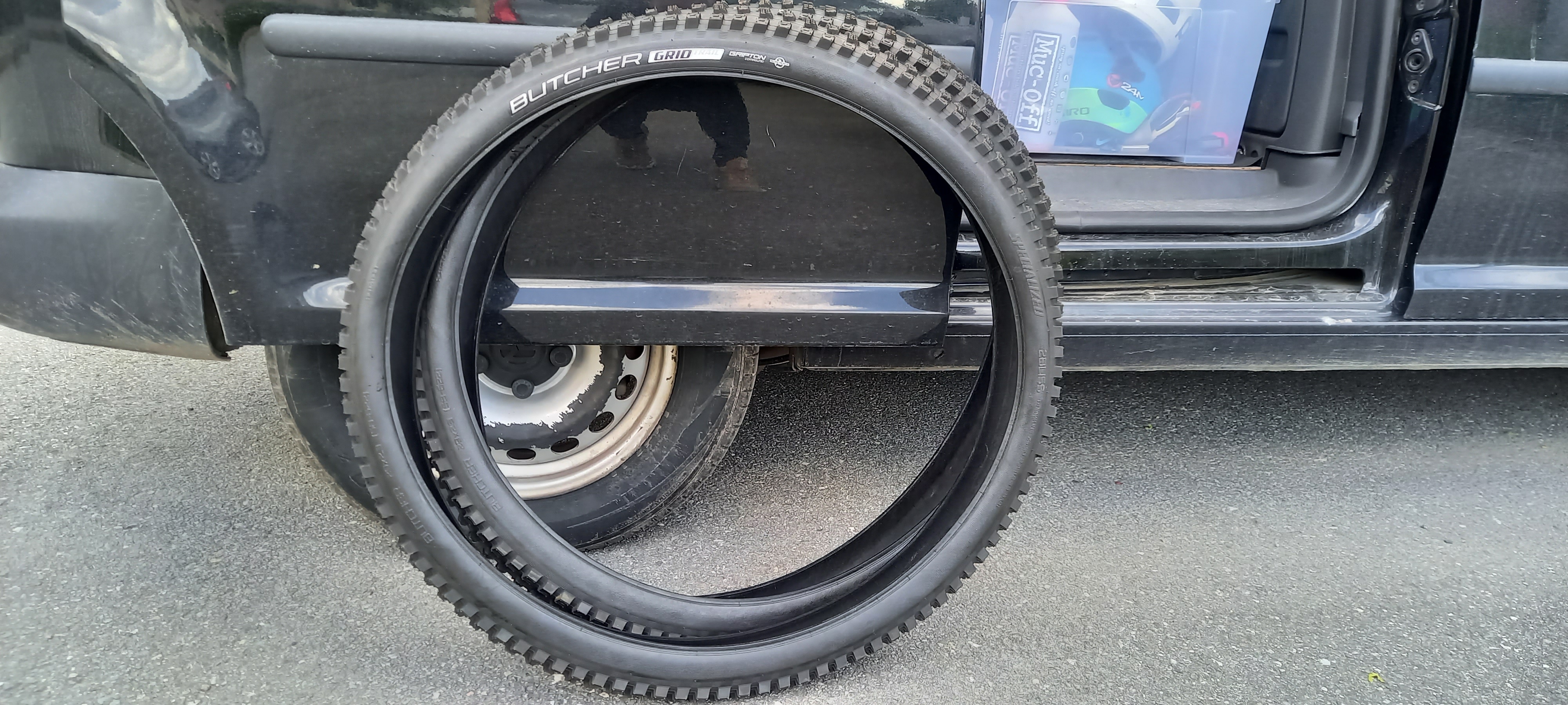

Nothing wrong with the new Specialized tyres both in trail and gravity casings in T7 and T9 compound. The pic above looks like an older generation tyre.
People who have issues with the front washing out on the Butcher are basically not leaning the tyre over enough imo. Same deal with people not liking the Maxxis DHF on the front. That channel, or no mans land between centre and side knobs, is the part that riders who lack confidence lean to and it feels vague and washes out. If you lean it harder and further and actually get into the side knobs then it grips hard.
An Assegai is an easier tyre to corner on as it has the transition knobs and gives the impression of more grip at mid lean angles. Braking into corners on the Assegai is its ace card imo.
Butcher trail front and gravity rear is a good combo.
