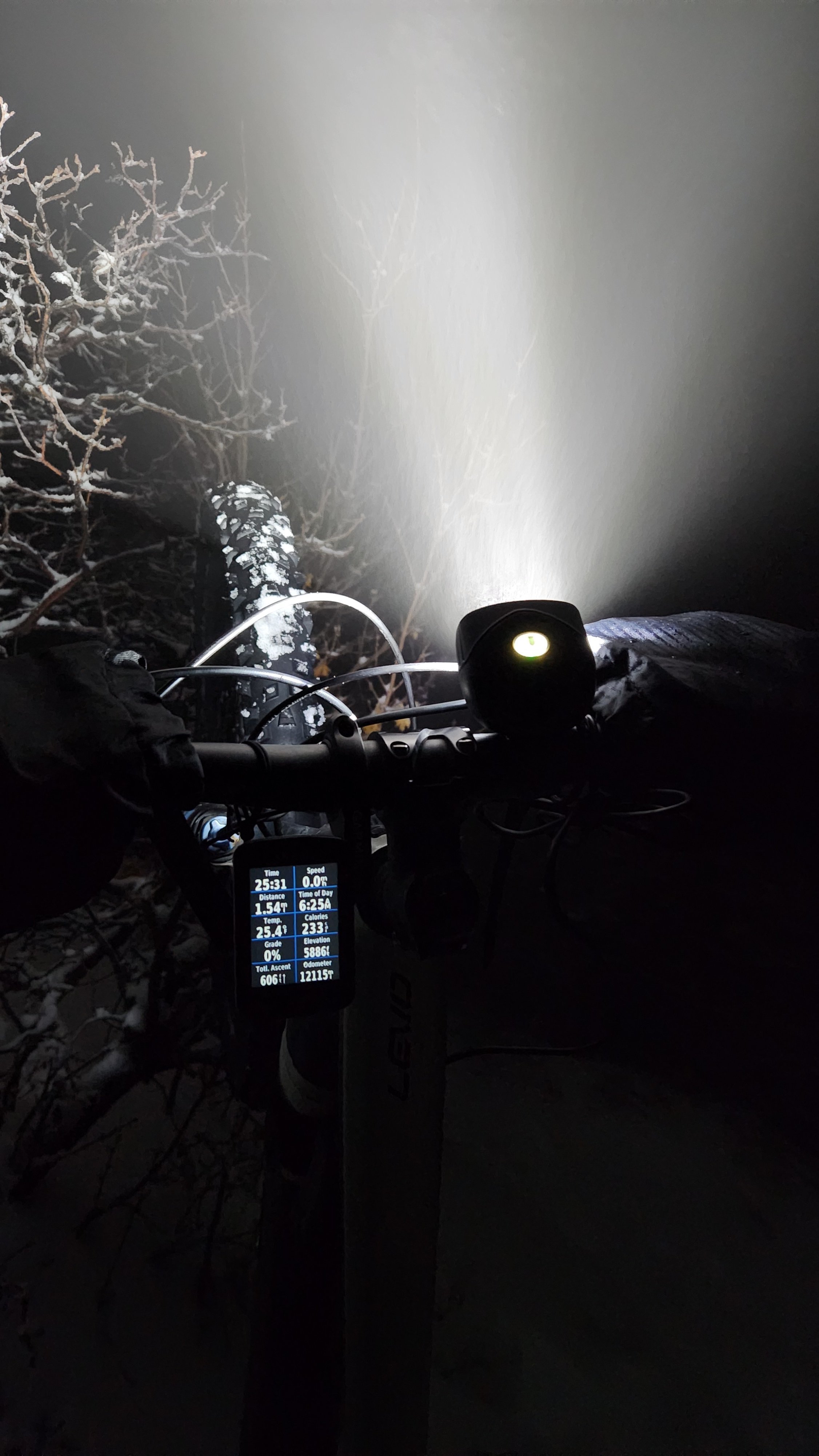

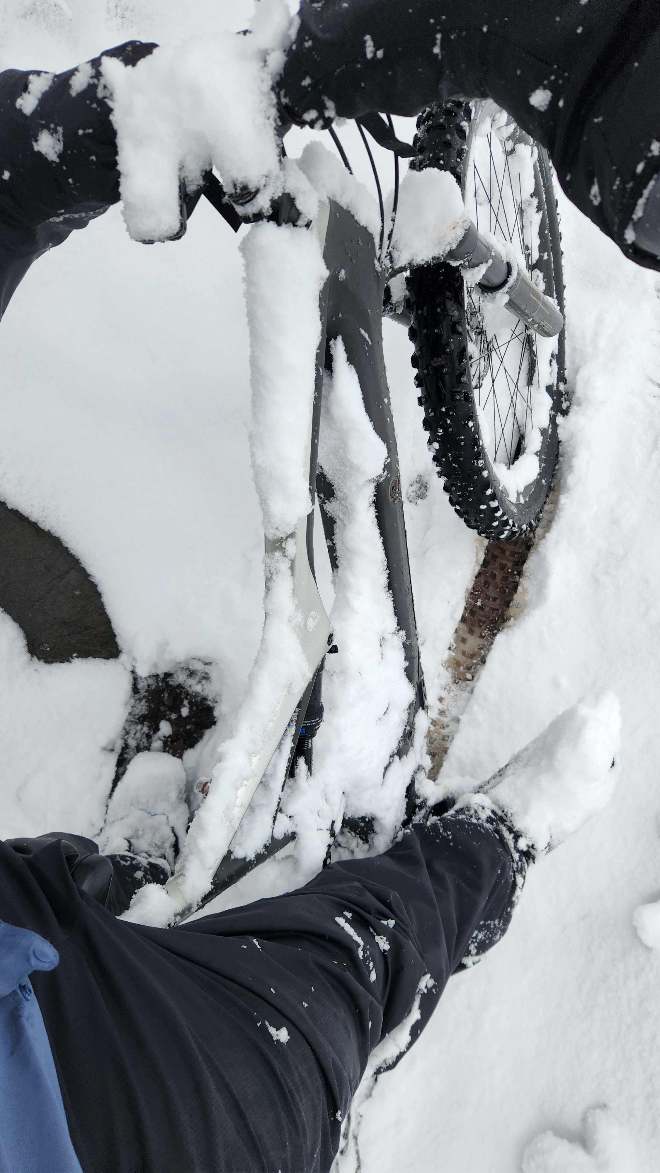

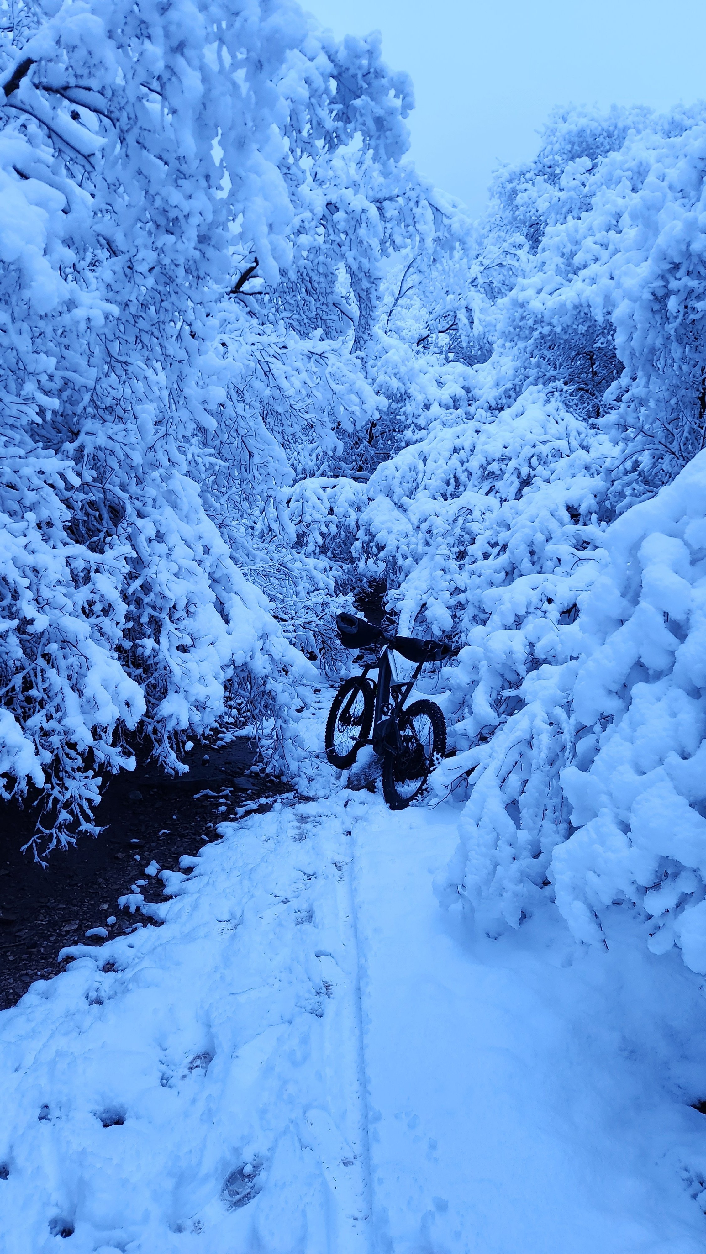

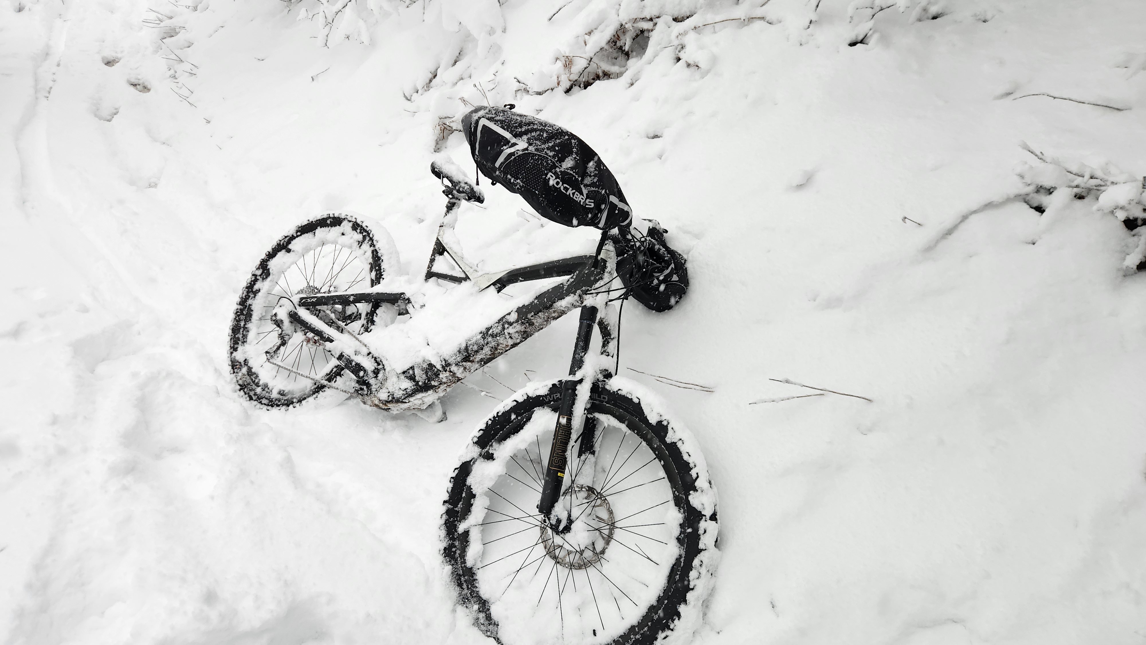

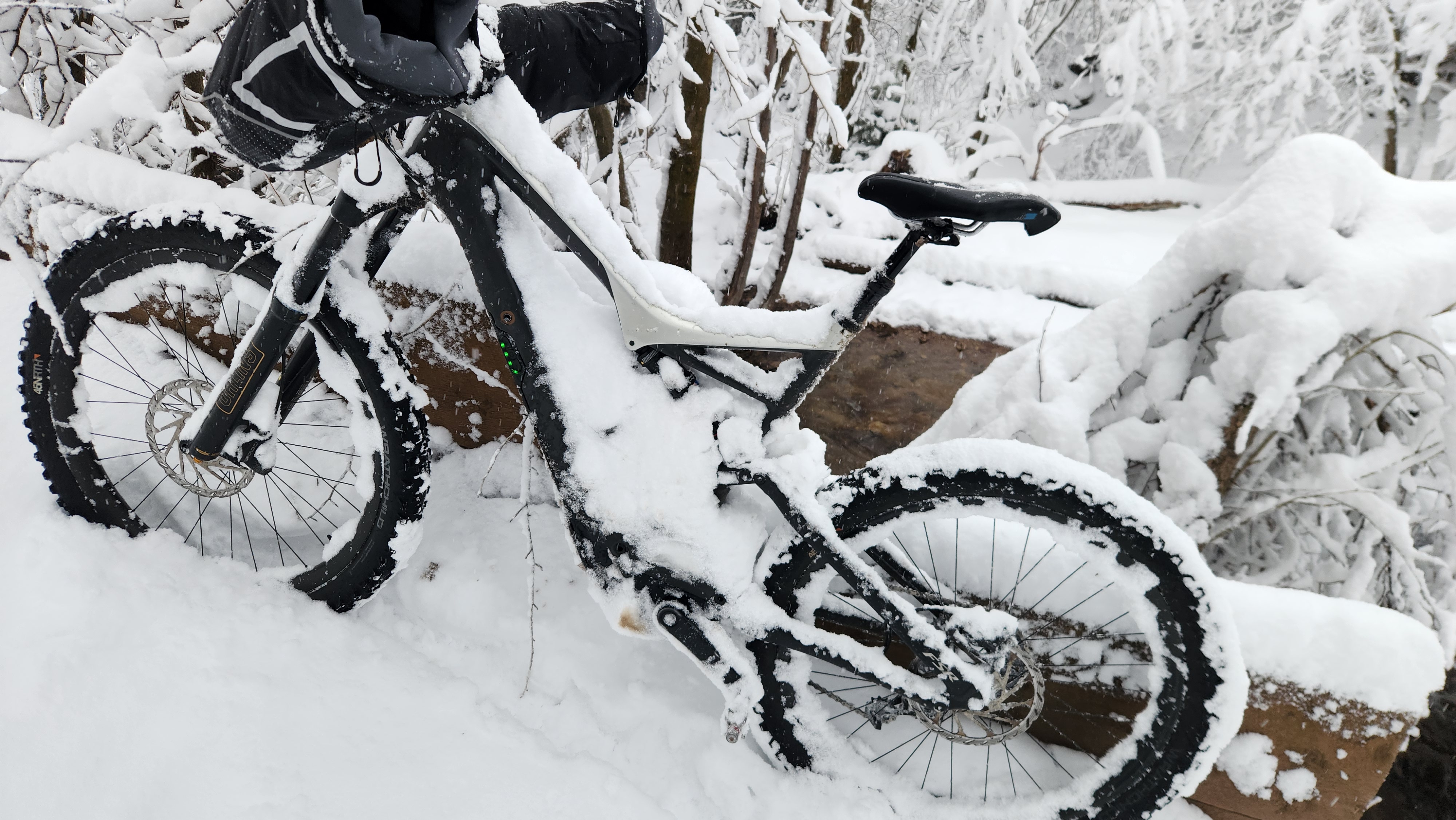

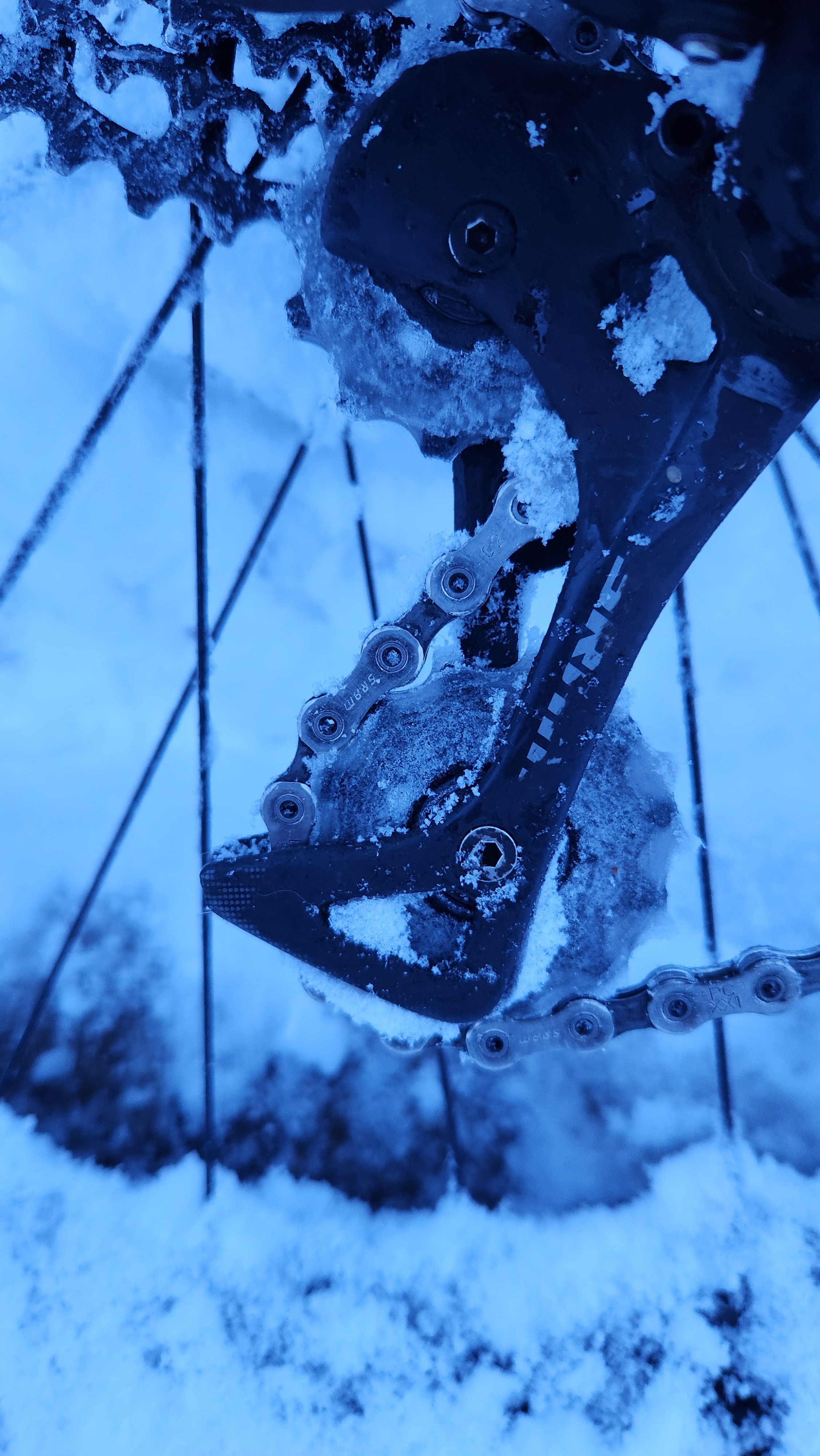

I've probably had at least 6 gen 1 batteries over the course of three gen 1 bikes. I've never had one not turn on. They did have several battery recalls where they put sealant around the LEDs. Your dealer should be able to perform the recall procedure for you even if the battery is not on the recall list. I airways carried a spare battery for swaps out on the trail in all kinds of weather. Specialized makes a great product. My beef is the battery config keeps changing which makes it hard to share batteries between bikes. I've had three different versions. Three Gen 1, a 21 Kenevo that won't swap with a 22 Levo without changing the bottom mounting config. Not something you want to do when you are out on the trail.
