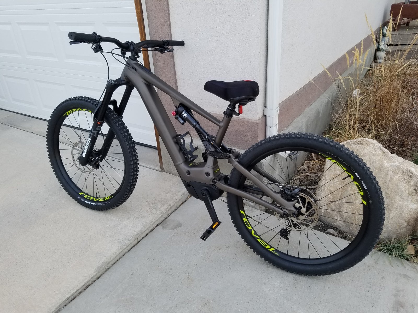

Finally an easy question. I got a 2021 Kenevo for my wife and put a big fat seat on it. The bike is made for bombing down hill but who cares. It fits her and was way cheaper than the new prices. The stock set up was a little too low for trail riding and it had many pedal strikes. Luckily you can do the flip chip on the rear shock and get the pedals off the ground a little more. She is already trying more trails than she would have on her old Levo. The plus side is that I can also steal it for a "wrench ride" .
