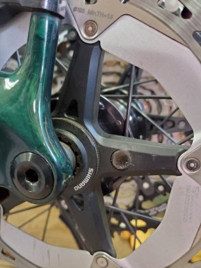

I too put Chris King wheels on my Levo SL and ran into the same problem. Specialized does make a center lock ring with a magnet, but wont fit on the CK hub. I had bought Shimano center lock rotors. In the cut out of the rotor spider I put a round magnet from an old cateye computer magnet, the kind that screw onto a spoke....I also put a nylon locking nut on the backside. Works flawless!
Did you use the XTR rotor? I think the XT may have the same cutouts but not sure. I assume you are referring to one of the small holes above the lock ring area. is that right?

The lock rings did not work (as mentioned above). They don't fit onto the Chris King hub. I ended up using a Cateye wheel sensor on a (rotor swap) XTR rotor that replaced my SRAM HS2. Yeah, bummer. Thanks Bicyclenut, for the pics. Do you recall what size nyloc nut you used? I currently have the VCateye black plastic piece but that will prob come loose eventually.

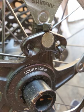

Hi I solved this issue quite easily, I had built a second wheel on a Shimano hub with centre lock. I simply took off the magnet and placed it as per the pics. Marked the centre of the holes, drilled through the aluminium with a 4 mm drill then tapped the new thread using a 5x 0,8 tap and the fastened the magent with new M5 cheese head screws. It’s a 2 min job now if I change wheels to take the magnet off from one wheel to another
*That's* the way! My mantra is "everything must be modified"! Nice work.
Im sorry I dont remember the size of the nut. I just took the magnet to my local hardware store and found one that screwed on.
