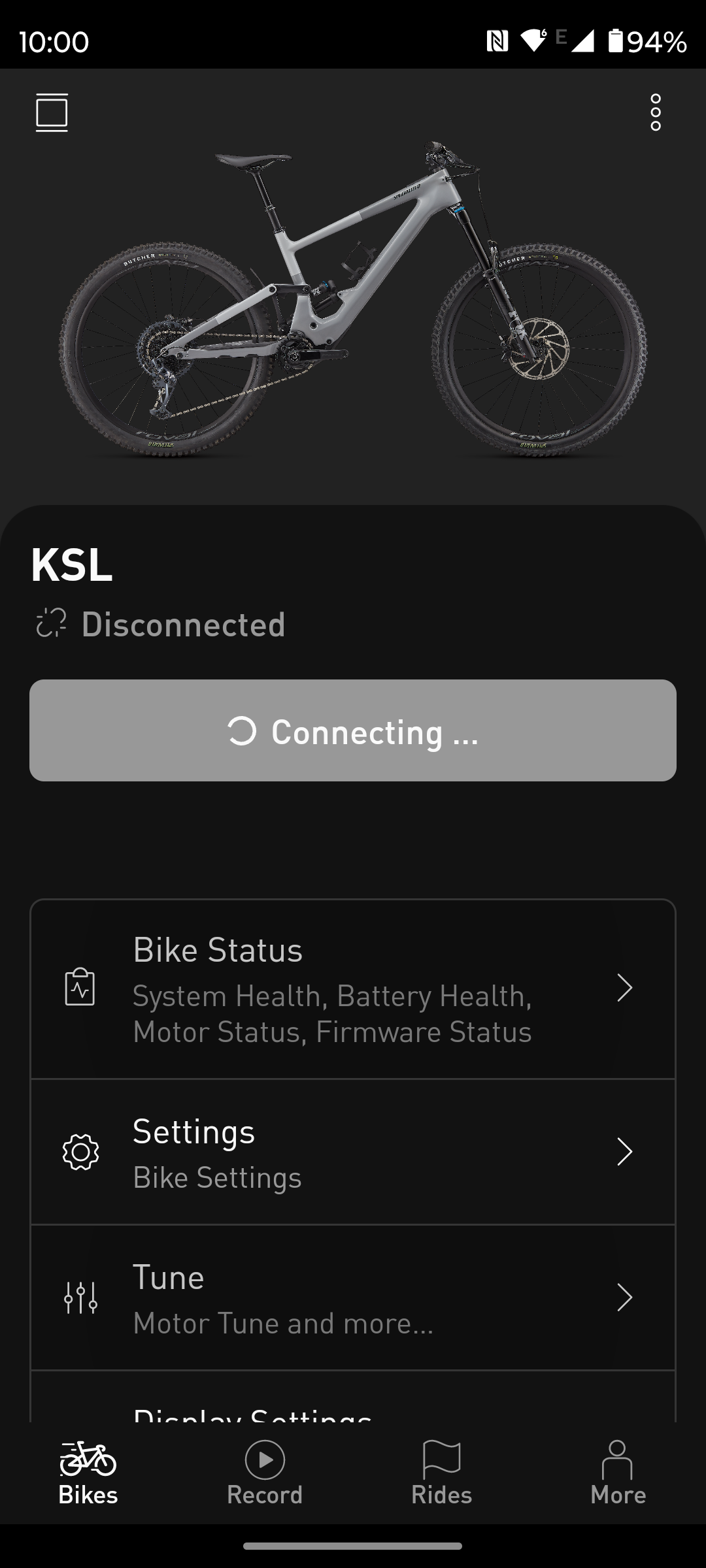

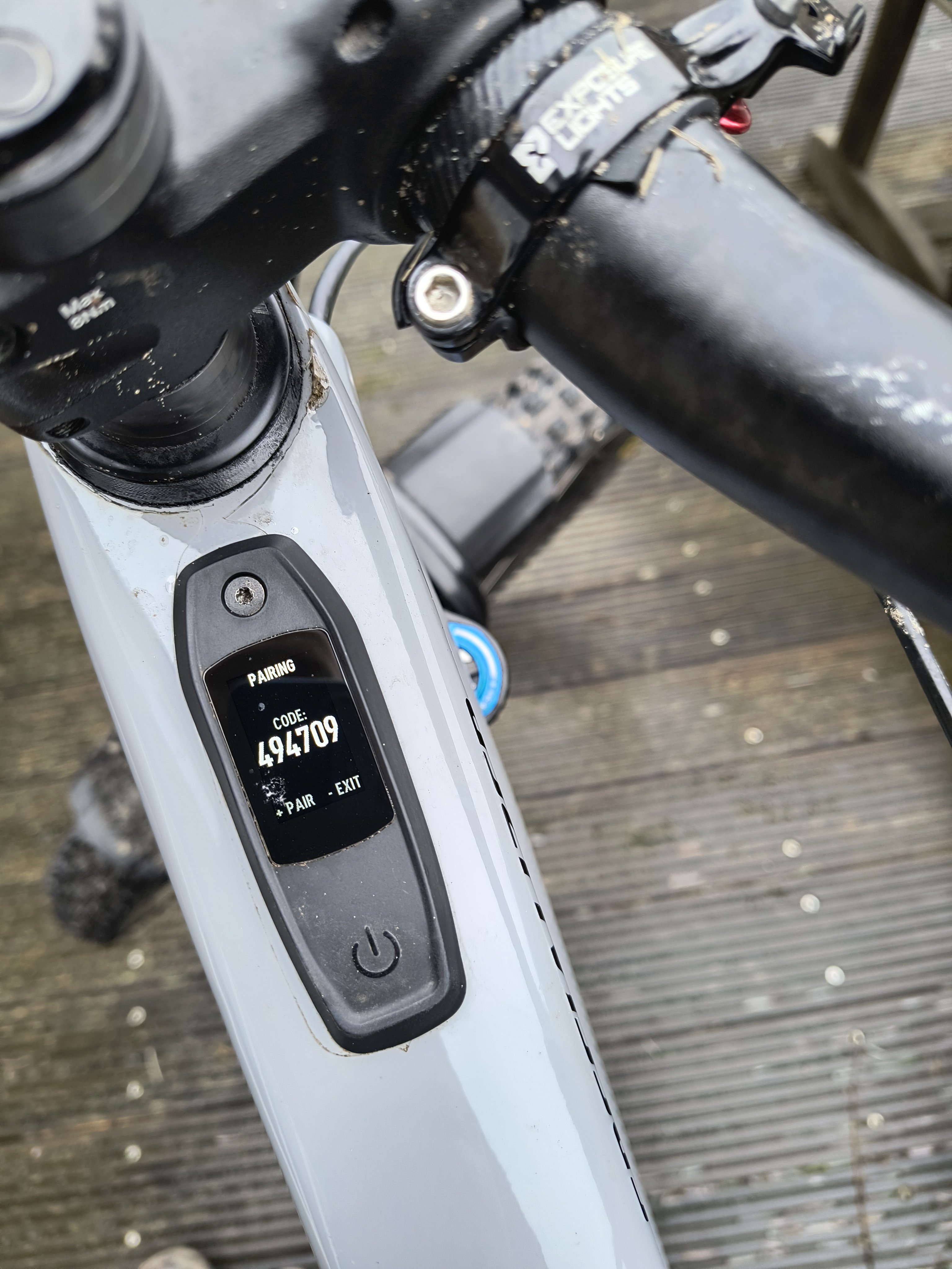

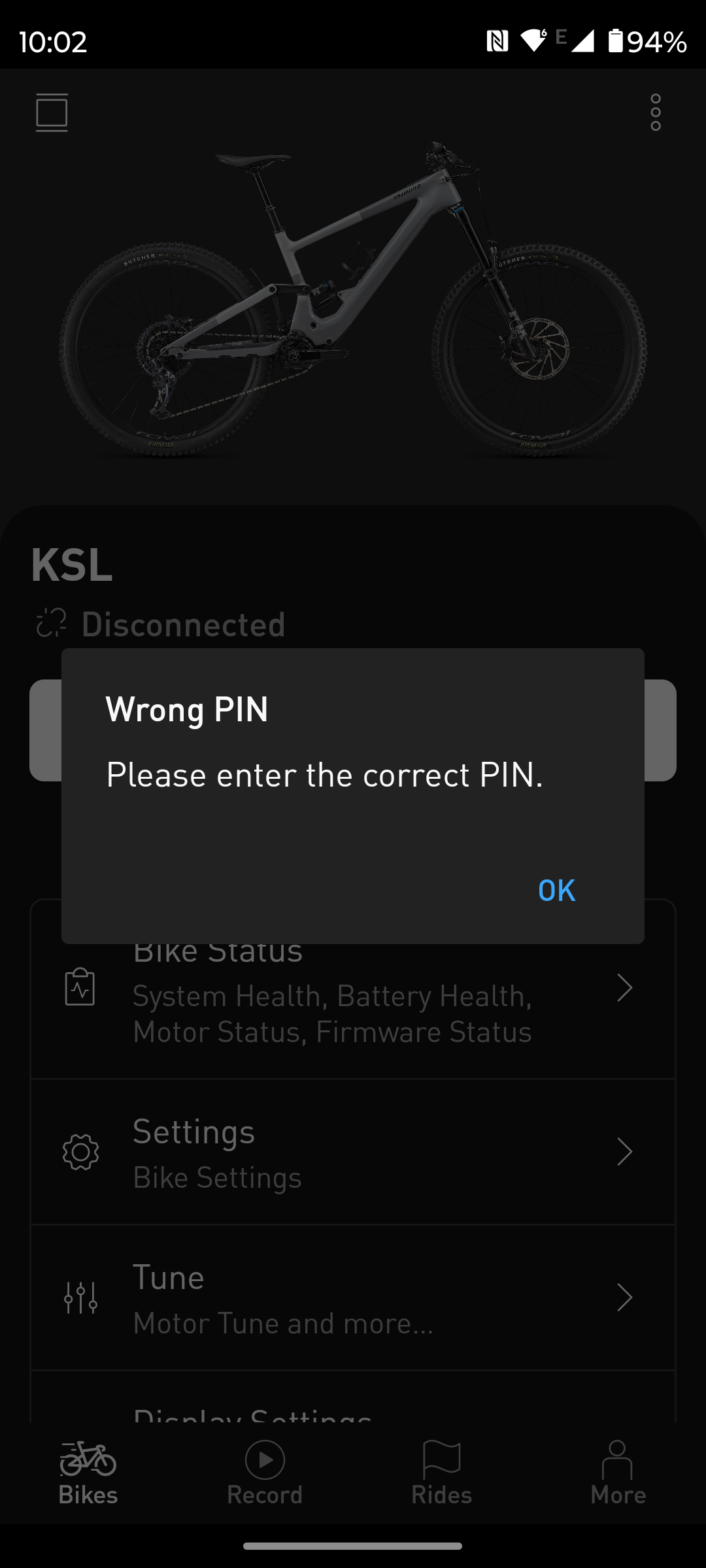

Can't even get mine to connect now 🤘🏻
Screenshot_20240217-100049.png IMG_20240217_100118722_HDR.jpg Screenshot_20240217-100224.png
