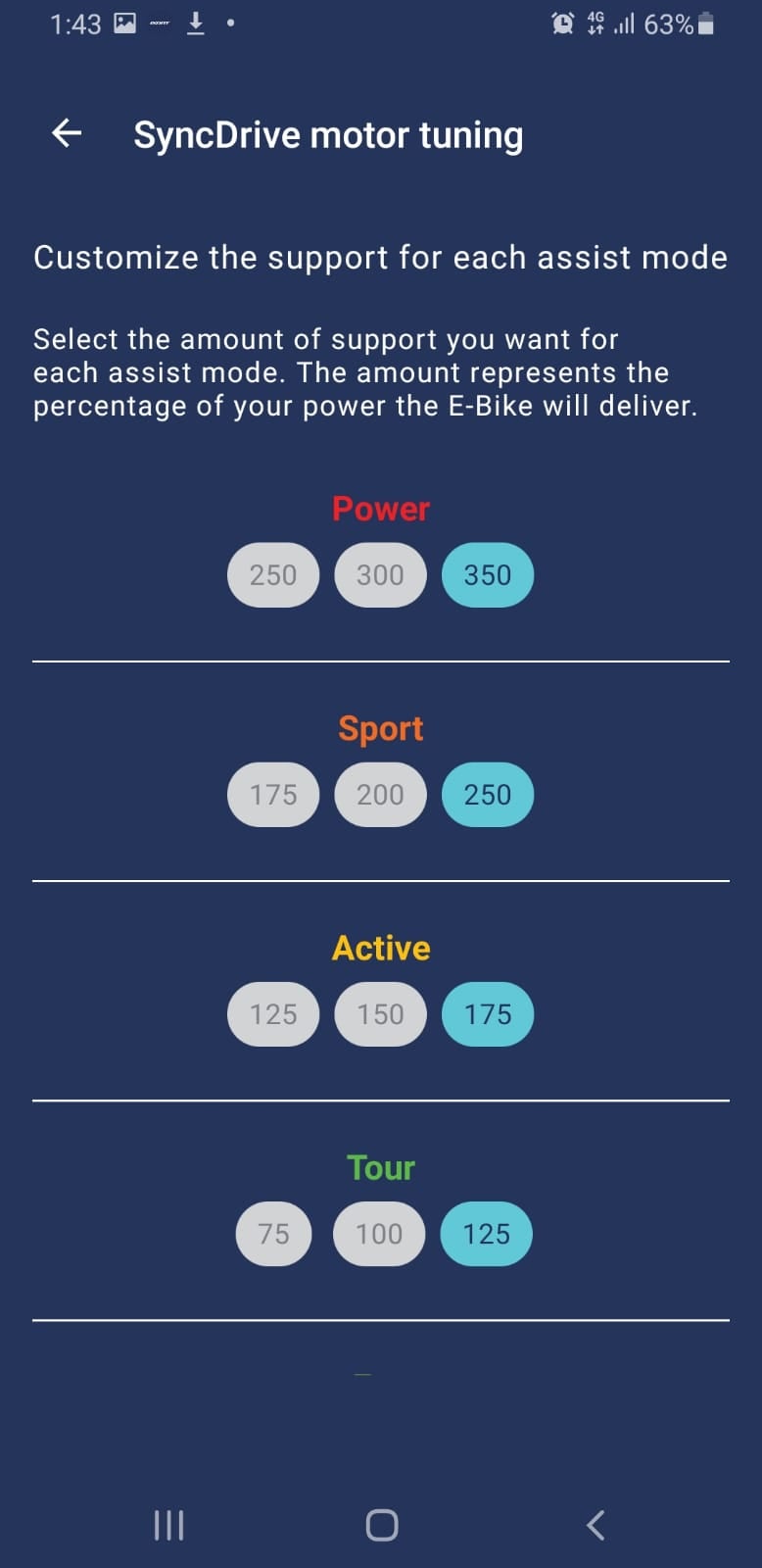

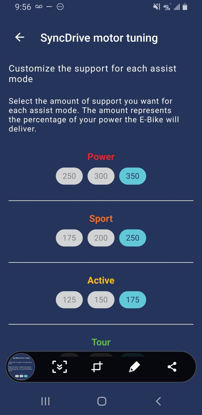

Nope, still getting this :(
Ok went to the dealer. They popped out an Android and connected correctly to my bike and did showed the tuning alternatives that do not show up in my iPhone. I tried my iPhone on 5 new bikes on the store and got the same problem. It is an iOS problem. Tried with 2 more iOS devices and got the same problem. The iOS version of the app does not work correctly in some phones. Also, it did not showed up the alternative to update the firmware to the August versión. Not sure if that is available for the Trance X or only for 2020 and earlier bikes. Furthermore I only get 350 in the power mode. Shouldn't it show 360?

Ok went to the dealer. They popped a Android and connected to my bike. I tried my iPhone on 5 new bikes and got the same problem. The iOS version of the app does not work correctly in some phones. Nevertheless, it did not showed up the alternative to update the firmware to the August versión. Furthermore I only get 350 in the power mode. Shouldn't it show 360?
Good question about power level support. My android, paired to a 2021 trance shows only 350 as a maximum as well.

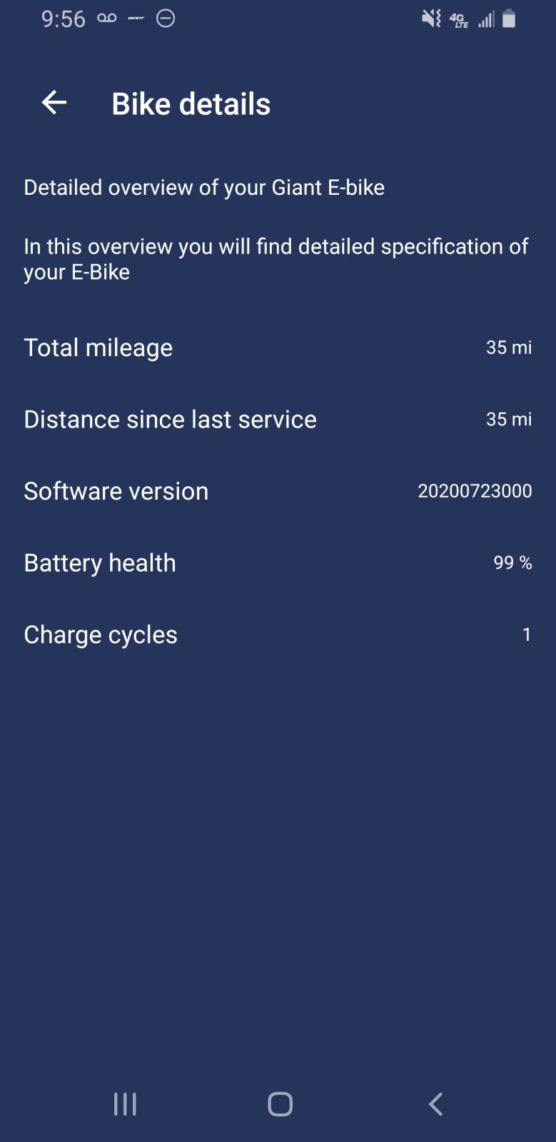

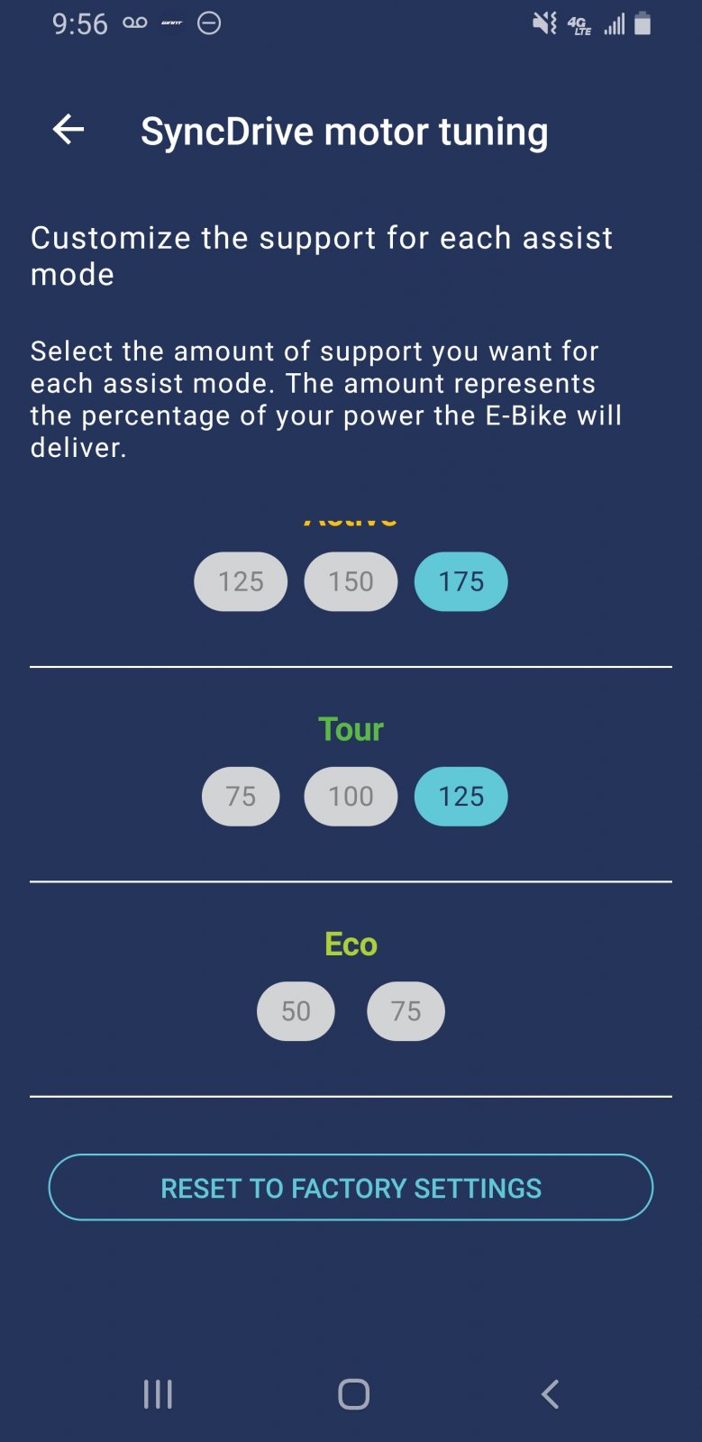

great to know I am not the only one. Couple of questions: 1) do you only get 50 and 75 for ECO mode? 2) what is your software version? 20200723 or 20200806? I believe the new Trance X are not getting the update. Thanks!

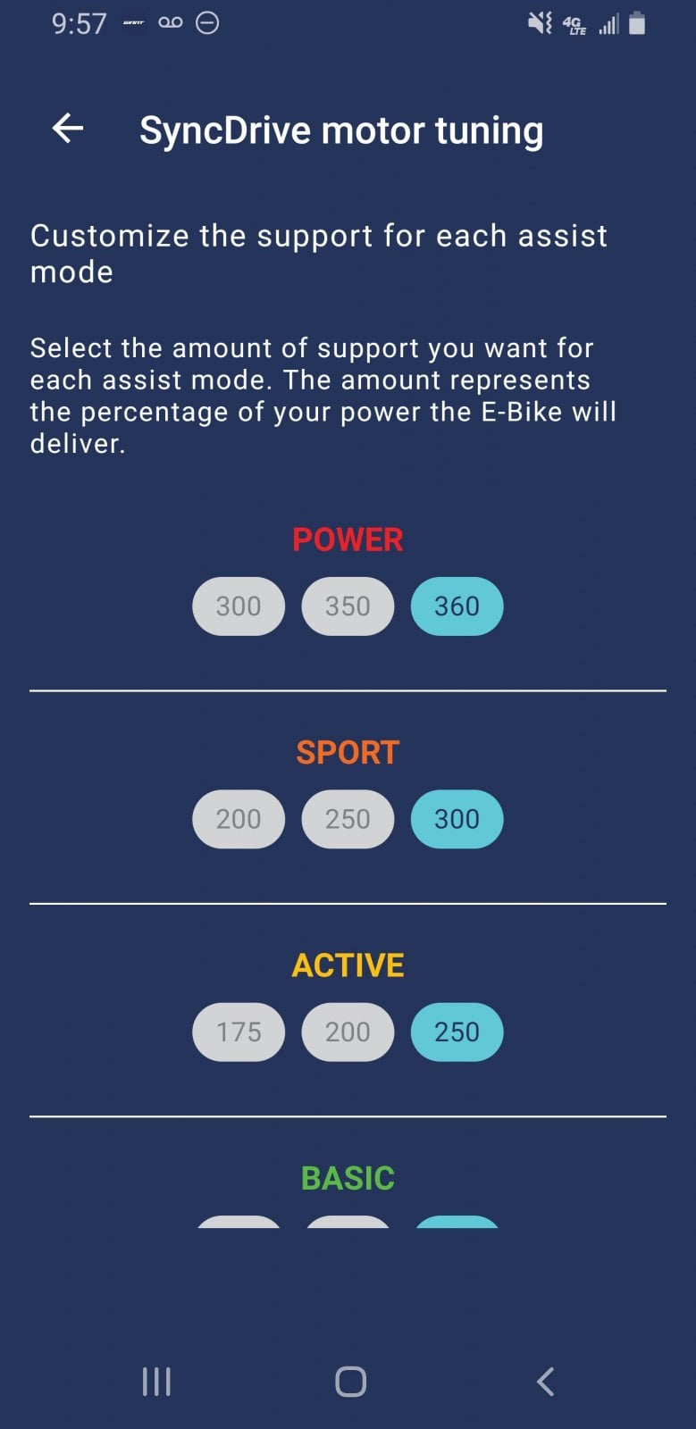

Update V1.1.0 just released.
All works fine on IOS with 2021 Trance X
My software version for 2021 Trance X is 20200916000 (was updated at store when I picked up the bike)
All tuning levels are there ie 360 and 50,75,100 for eco
Have not tried to change them.
