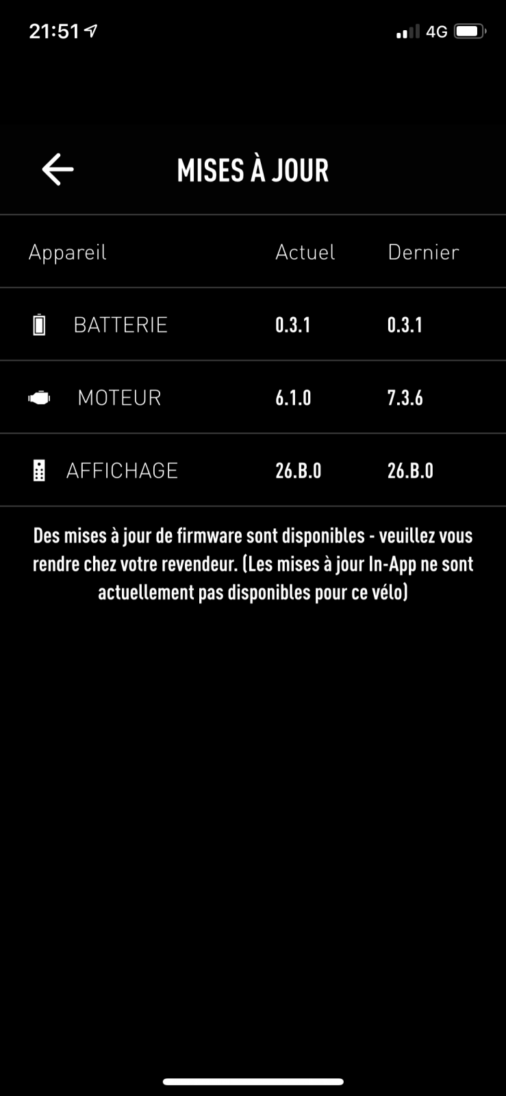

What motor firmware are you on?
Firmware version 6.1.0

I believe firmware 6.1 limits torque under high stress situations to preserve the motor life. Shouldnt be abrupt though, should be a tail off. Sods law I cant find the release notes to the firmware though so its hersay
I’d have the motor checked out by a dealer.
There are a few people who have found that a hard reset of the TCU have helped after the 6.x update ?

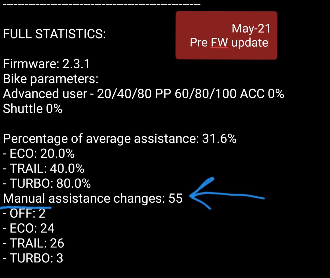

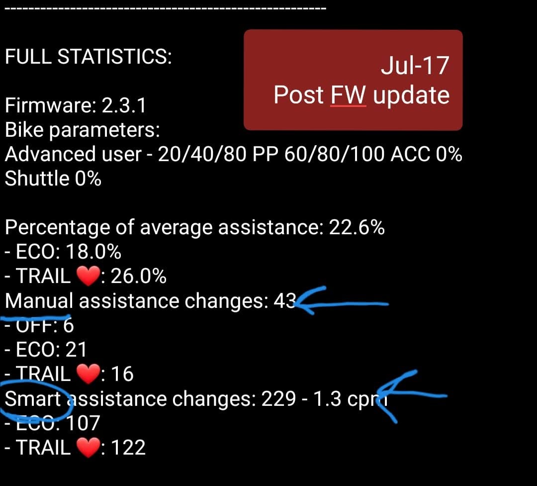

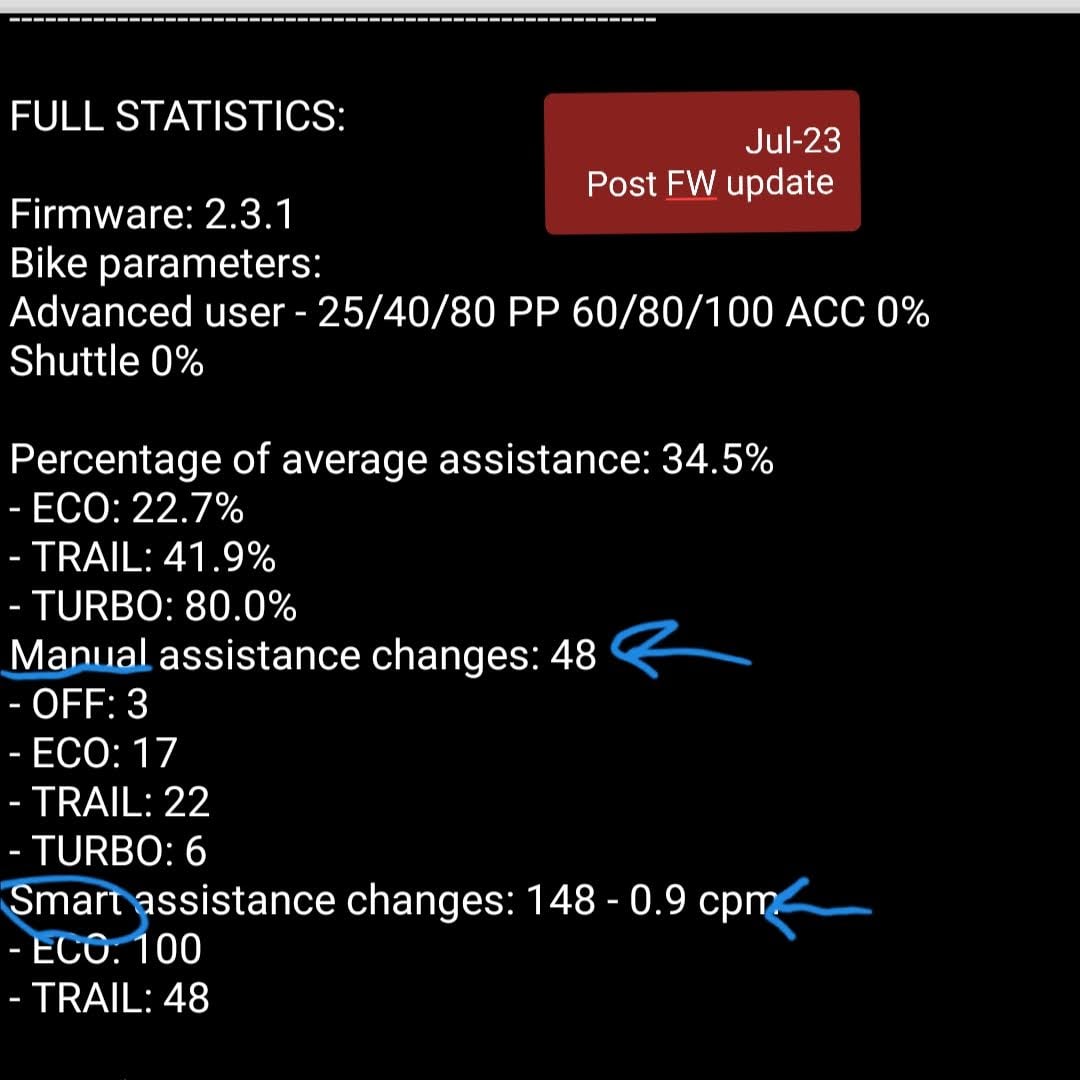

Looked into it some more, very interesting:
1. All my recent ride logs on BLEvo reveal the answer - a "SMART" mode changes assistance power during the ride!
It is logged as "smart assistance changes" , right below the "manual assistance changes" that was always there.
2. This behavior began only after FW update, but I cannot fully link the two as I had one short (non representative) ride, after FW update and before smart changes logged where this did not happen.
3. I did try, for the first time, to use smart modes with the bike right before this thing started happening. I've used BLEvo's smart HR, as seen in the second image (has heart sign next to the TRAIL mode). Suspecting this was the matter, I did confirm smart modes were OFF on the next rides, but still smart changes happen. BLEvo does not show the heart sign anymore on the logs so its off.
4. I did rule out this being related to motor temp, as both pre-bug logs and post-bug logs show similar motor temp, averaging 50C to max 66C.
5. I could not find any correlation to power (WATT) curve/output. Not saying there isn't any, just that I couldn't see one, yet.
So to conclude:
- Motor power loss - not just a "feeling", its happening.
- Most likely to be related to SW and not HW. Not likely to be related to motor temp.
- "Smart Assistance Changes" are logged, most likely to be one of two reasons:
1. BLEvo bug makes smart feature remain active in some sort of way.
2. SPECIALIZED inserted this smart feature in their latest FW update (no release note, so who knows..).
