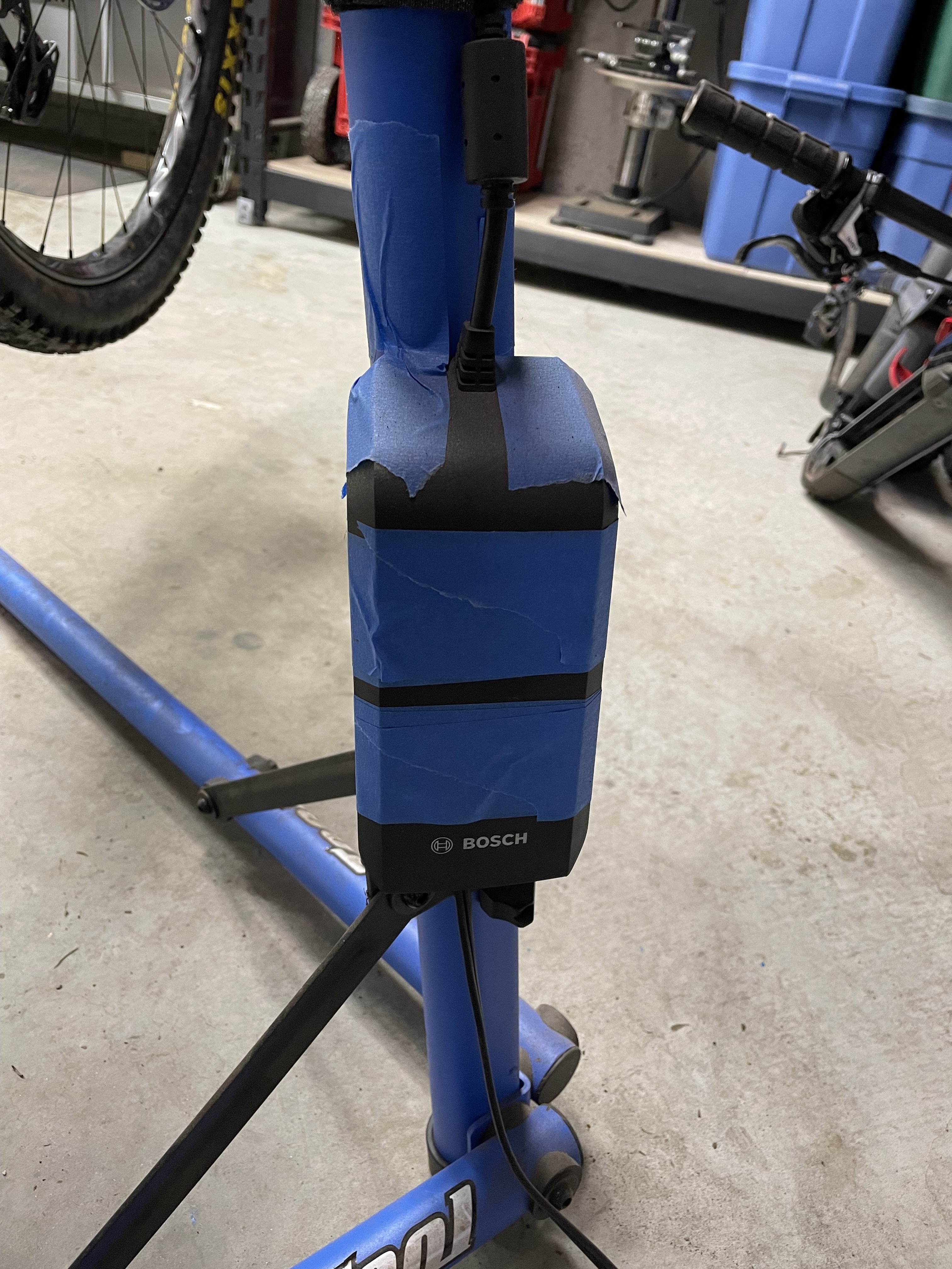

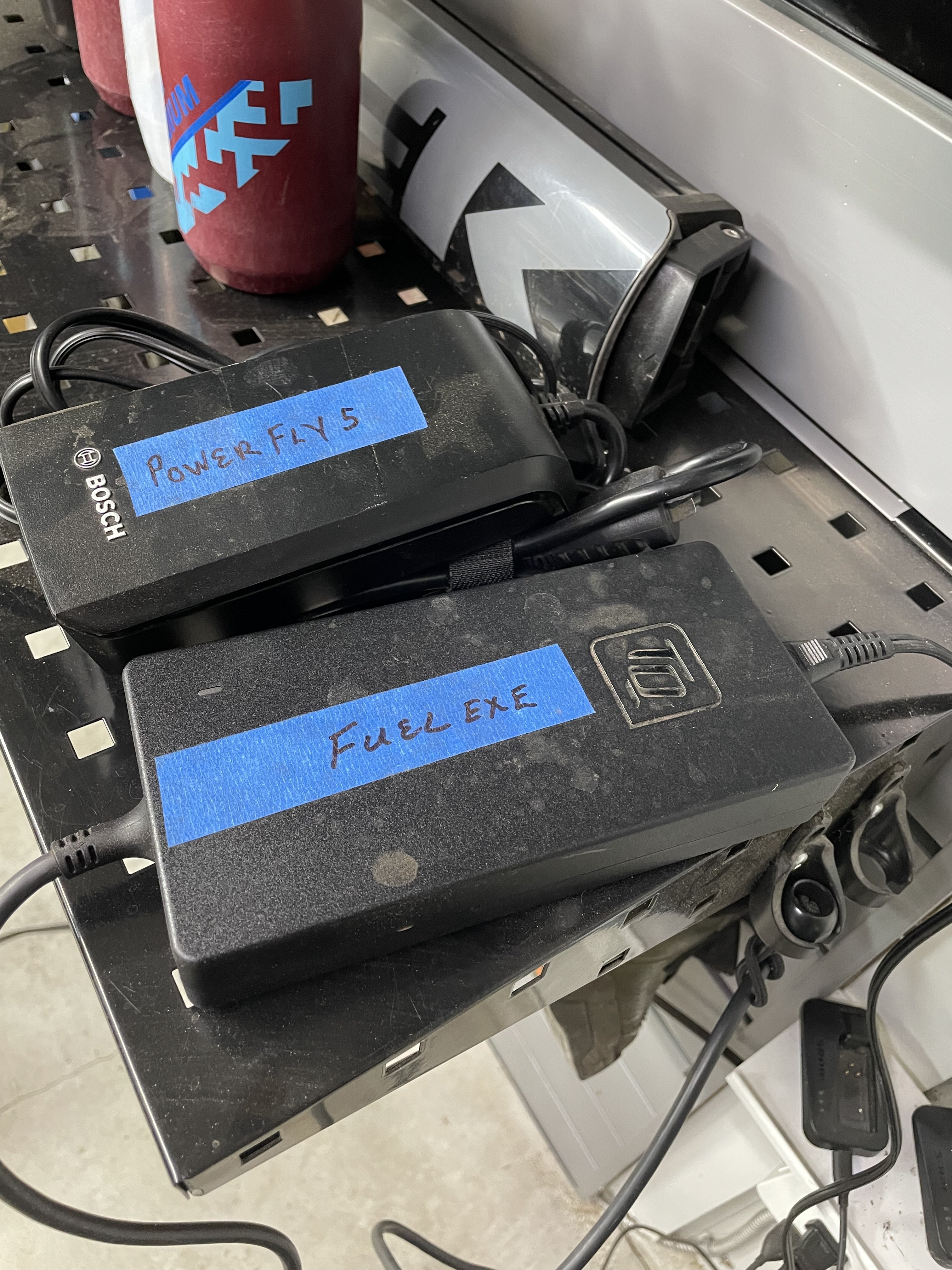

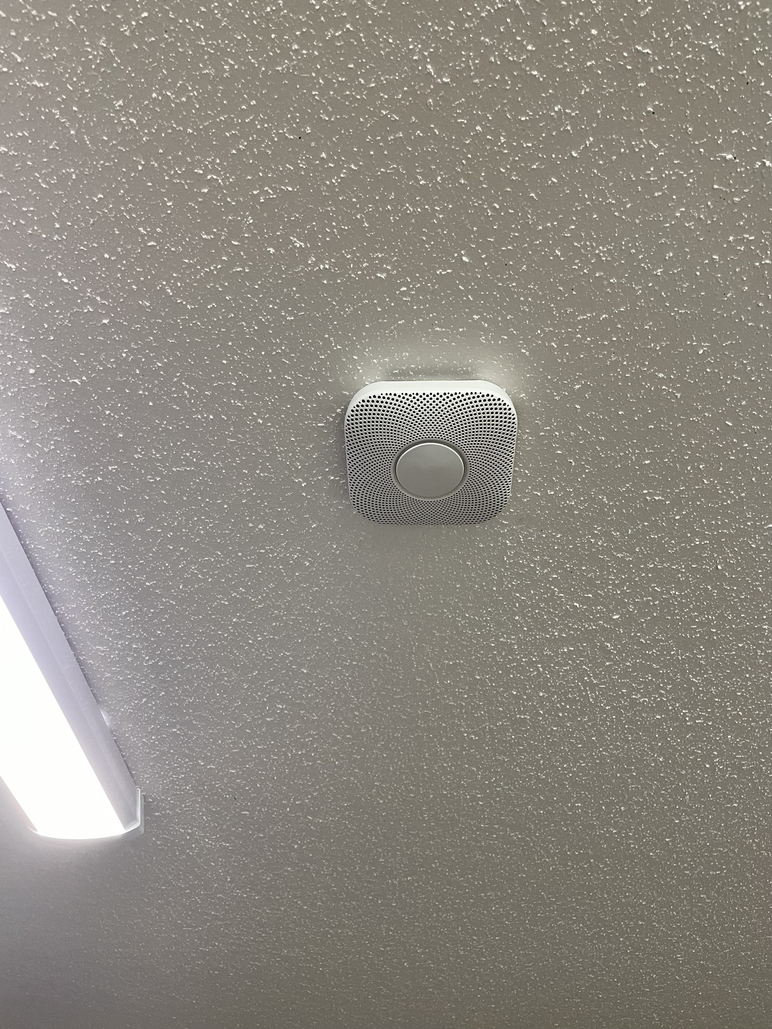

I have 3 different chargers that came with the bikes. (OEM?)
I don’t charge the batteries on a wooden bench or anything combustion-able. No sound. Slightly warm during the charging cycle. I’ve also installed a smoke detector in this area. (Which speaks to the other detectors throughout the house.)
