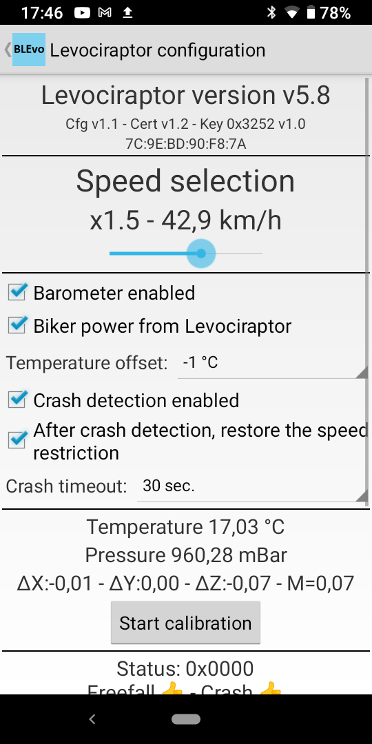

After more than five months of testing, I am pleased to announce the full integration of the new Levociraptor Generation 2 into BLEvo.
The new Levociraptor (called Gen2) integrates a Bluetooth module for connection with the SmartPhone. In addition to the unlocking of the speed (for Brose and SL motor) that can be customized from the phone, it also allows you to detect the ambient temperature, the atmospheric pressure to have the altitude measurement with extreme precision.
The joint development team has made it possible to achieve important improvements in SmartPower management in BLEvo as BLEvo will receive data directly from the Levociraptor without waiting for the delays introduced by the TCU. This integration with the SmartPower allows an improvement in responsiveness and fluidity in the delivery of engine power.
Through the BLEvo interface it is possible to instantly remove the speed release or send the position in the event of an accident, these two functions can be activated automatically in the event of an accident.
The interface with the Levociraptor Gen2 is available to all BLEvo users in free mode. Versions 3.9.0 for Android and 3.7.0 for iOS have been released and are available in the stores.

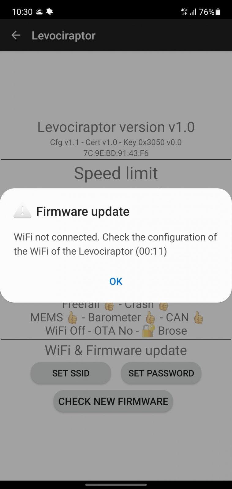

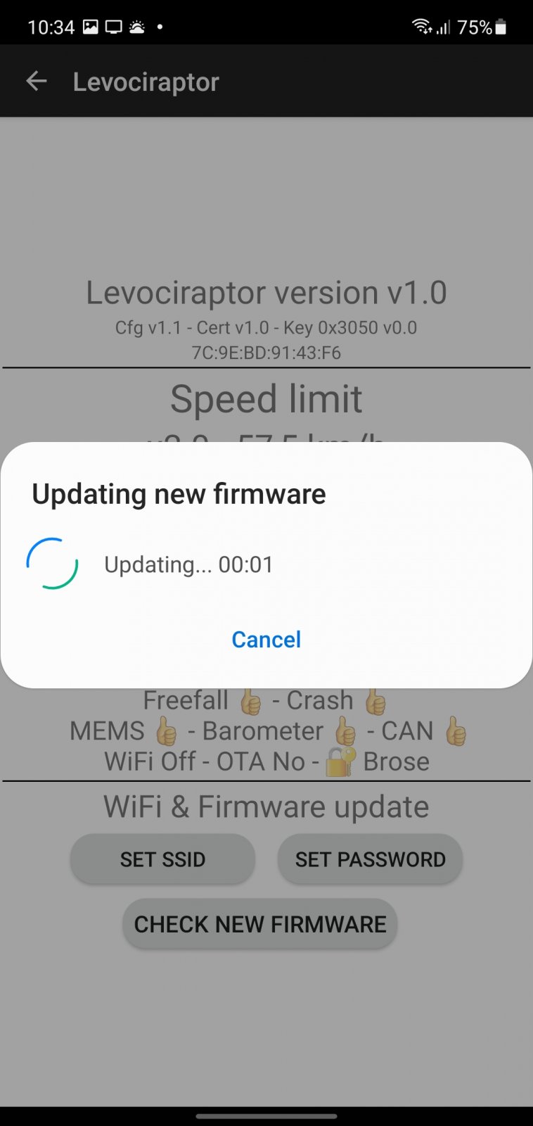

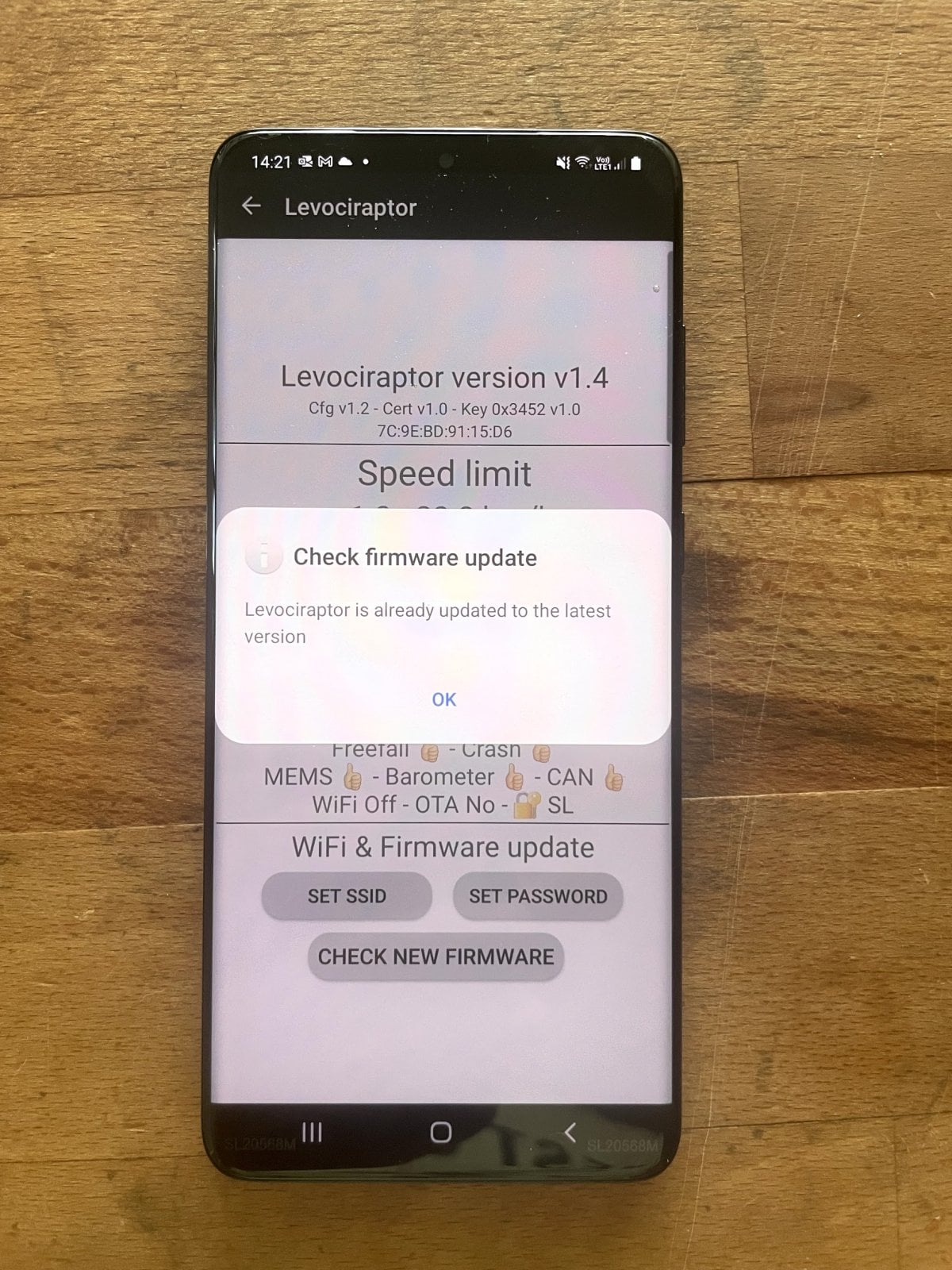

Hey, I have a problem with Gen2 Levociraptor. SL creo and for test SL Levo.
When I get Gen2 is works properly, but now it is stopped. On App levocirapotor says everything is ok, but it is nothing change. Still 25 km/h. Levocirapotor is in SL creo and now for test in SL Levo - the same thing.
There is any solution?

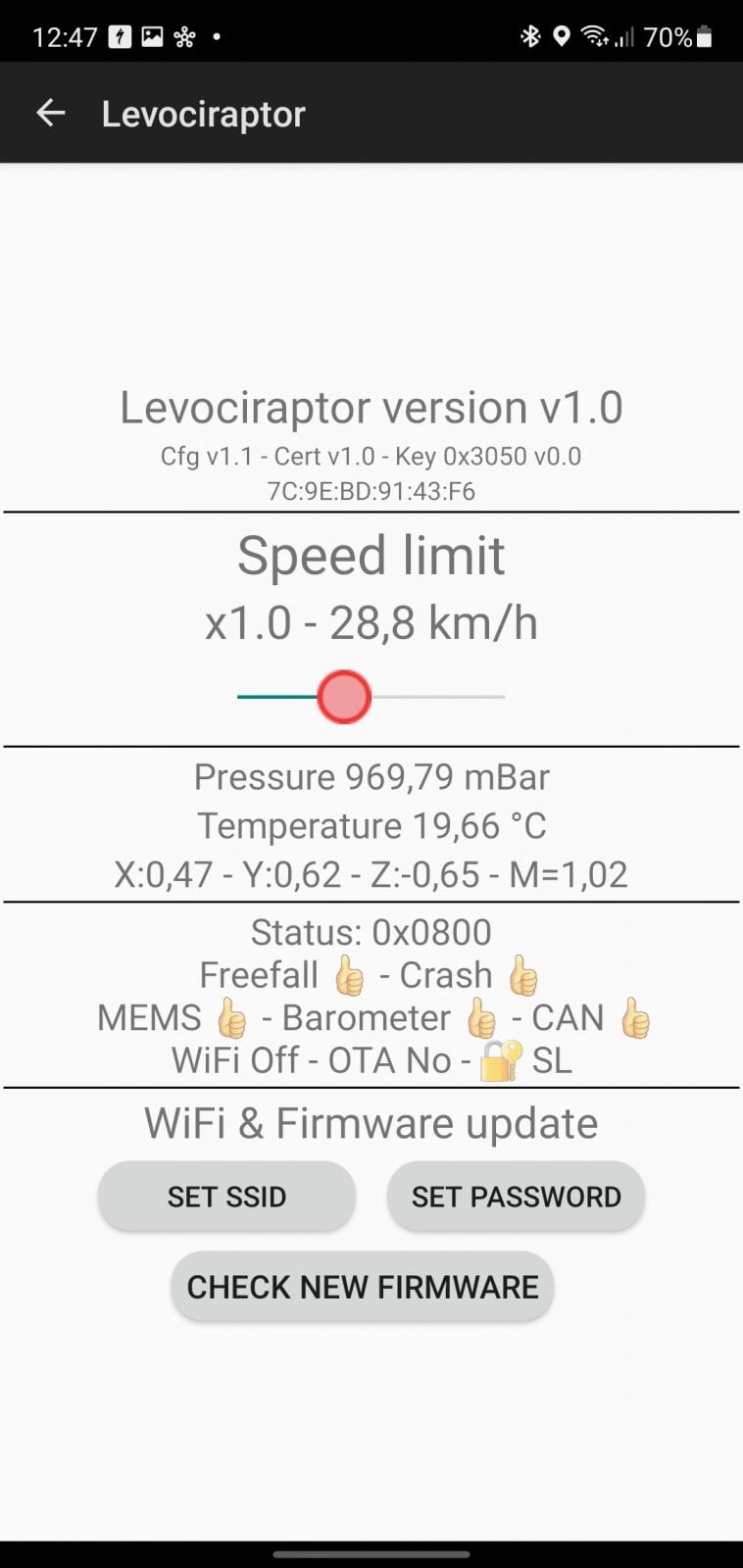

The configuration says that the speed limit in Levociraptor is set to 28.8.. Maybe the crash detection deactivated it..

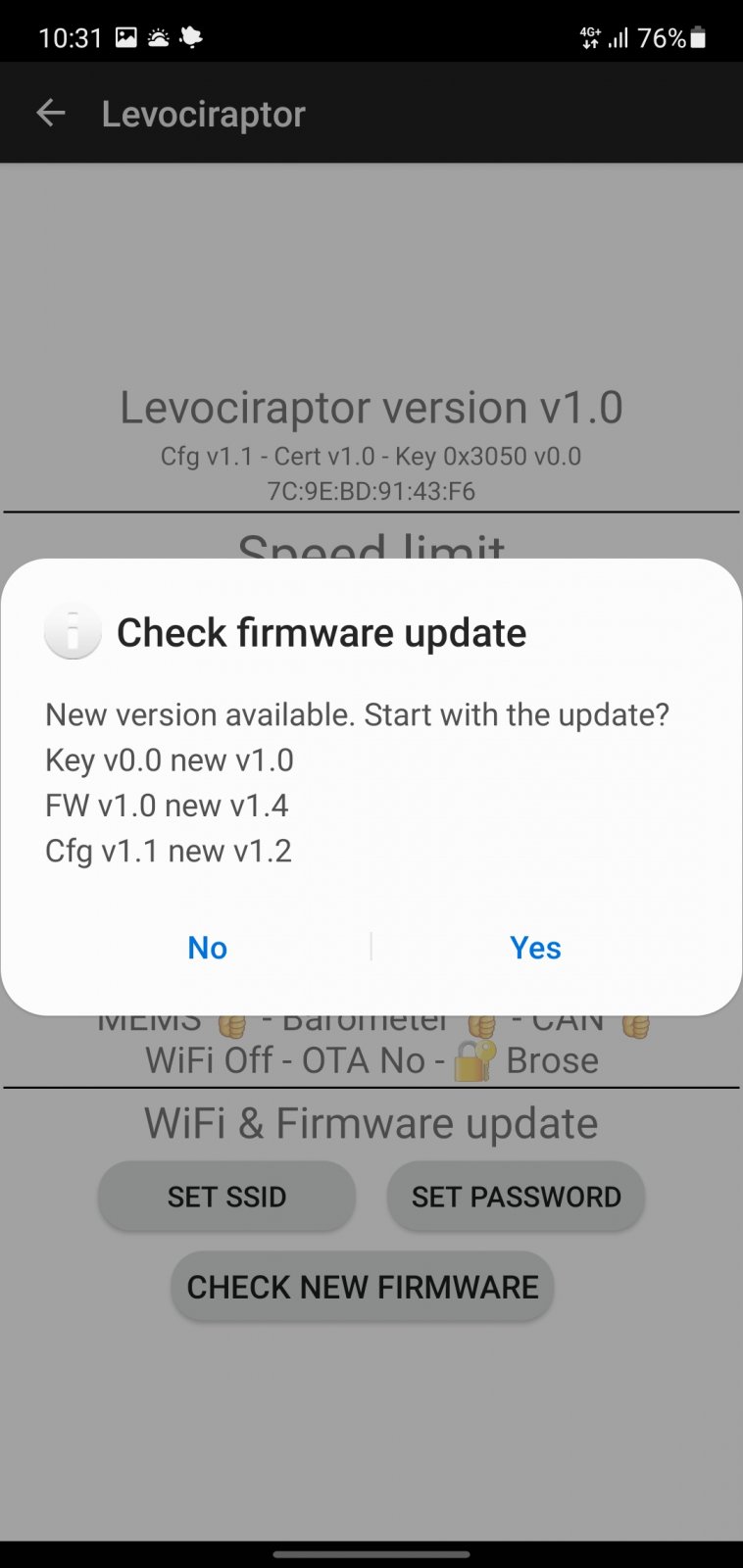

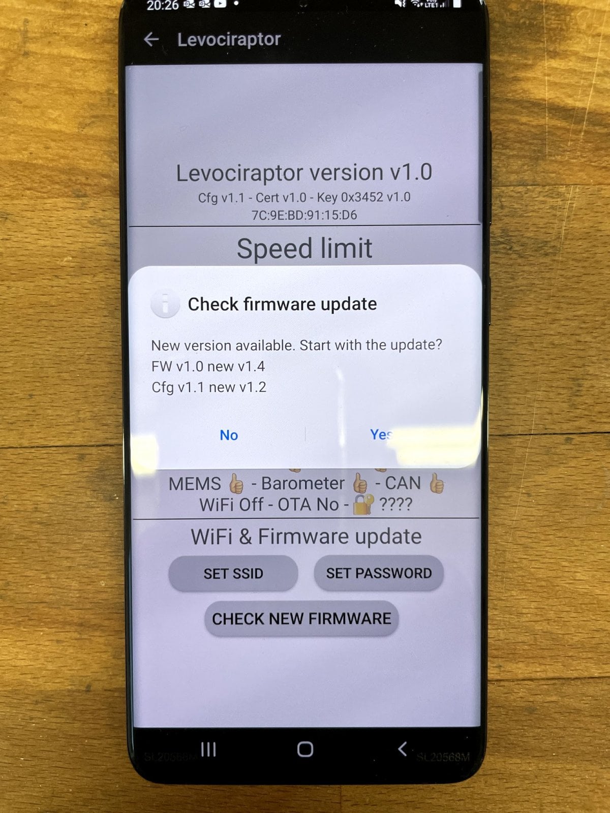

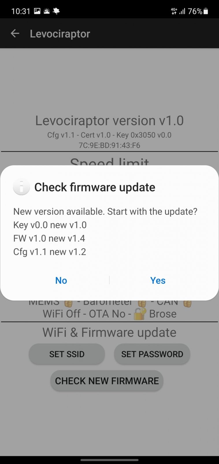

There seems to be a firmware upgrade. If you charge your bike and connect with the Android Levociraptor App to your module, it offers an update. Mine failed....because of missing WIFI configuration...But I don't now what setup is needed. Could somebody explain please? Thanks!

So in the meantime, i got updated my two devices. What I did:
  1. Configure on your Levociraptor App on the Android device your WIFI connection. Even if you have configured it already over the Android Setting. Wifi connection should be available.
  2. Charge with the battery charger you bike, even if you have 100%
  3. Press the power button on your bike and scan with the Levociraptor App your device.
  4. When your app is connected with the Levociraptor device press check for new firmware.
  5. You will be prompted and first you can update the firmeware.
  6. Repeat the procedure 2-4 for the configuration update
  7. Unplug your battery charger.
  8. Just how I did the upgrade. Not sure...if its' the right steps. But I have installed the new firmware and Config.

I have still problem with update. sometime i have info there is update but then i have wifi connection problem (i set ssid and password), sometime i have info levocirapotor is already updated...

For the check of new firmware version, is not required setup of WiFi connection... The check is done by the phone. If an update is found by the phone, the update is performed by the Levociraptor using the WiFi Setup
Jaśminowyjeż
Aug 16, 2021
Poland
no, i cant skip setup of WiFi... there are pop-ups to fill it up after check new firmware. When i fill pop-ups, it is start update, but it stops at 0:11 sec.. Always, different bikes, different wifi connections
