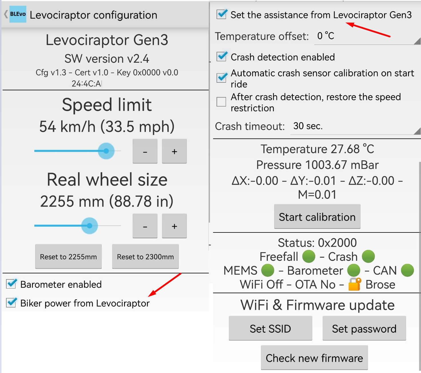

I am asking few questions about L gen 3 settings. What is correct wheel size for gen 2 bike(29")? 2300mm?
There is settings "Biker power from levocirator" and "Set assistance from L gen 3". What is the purpose for these two?
Is L. gen modifying assistance levels somehow? I am not sure but sometimes when I start pedaling motor feels really powerful and I am not sure is it reacting to bikers pedalling torque just like it should. When I stop for a second and start pedaling again there is much less power.
If it is not changing assistance any way then I must be wrong. :unsure:
ps. crash sensor sensitivity is really sensitive and I cannot adjust it at all.

Hi,
29" should be 2300mm, 27.5" should be 2255mm or 2160mm. It depends from the tire type.
With this option you can use BLEvo to adjust the assistance percentage, like is done with the Smart Power functionality.
Maybe you have the Smart Power activated.
Try to disable or configure it better.
This option works only if BLEvo is running
The crash sensor should be calibrated with the bike in the ride position. This is done automatically when you press the start ride button.
Before move the bike to ground, please wait the message (on the screen or via voice) to notify you about the disabilitation of the crash sensor. The voice message is new from the version 3.12.5

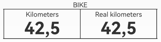

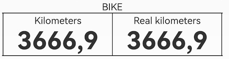

Ok, I changed wheel size from 2255 to 2300mm. And also changed speed limit and also played with these two assistance/power related settings. Then I noticed few days later that mileage has resetted. Now it is showing around 40km and it was before near 4000km. Could these things relate to each other?
There is two checkboxes. Did I understand correctly that "Set assistance from L gen 3" makes possible that Levociraptor is able to change assistance based HR? When Smart Power is not activated, it doesn´t do anything else and assistance level is calculated inside engine based to torque, cadence and other assistance settings? If I don´t use smart power, I can disable it and it won´t affect anything?
How about "Biker power from levociraptor", is it picking up power from motor and forwarding it to ANT+ devices or what is the meaning of this setting ? If I disable that what happens or is not happening?
I use Blevo with every ride and I have smart power disabled.

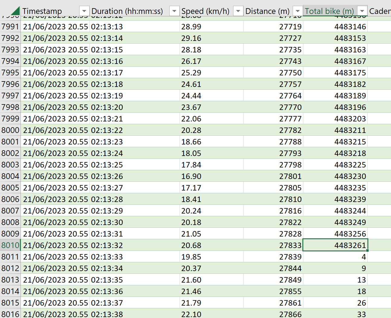

edit. I found when km reading screwed up from logs. I was riding around 20km/h at that time and that just happened in the middle of the ride. :unsure:
Yesterday.
2.6.2023 it was like this.
I checked with the Levociraptor Team and when the km are over about 4000km, the value is reset to zero.
There will be a new release of Levociraptor firmware that will solve the issue.
This option is used for Smart Power and/or Smart HR and/or when you want to select the assistance percentage from BLEvo. Also manual percentage. For example in the Bike Monitor (or with the remote control for BLEvo) you can change the assistance percentage.
This is to get the biker power from the Levociraptor and not from TCU Bluetooth. With this BLEvo can read the information faster and the reaction of the Smart Power is faster.
