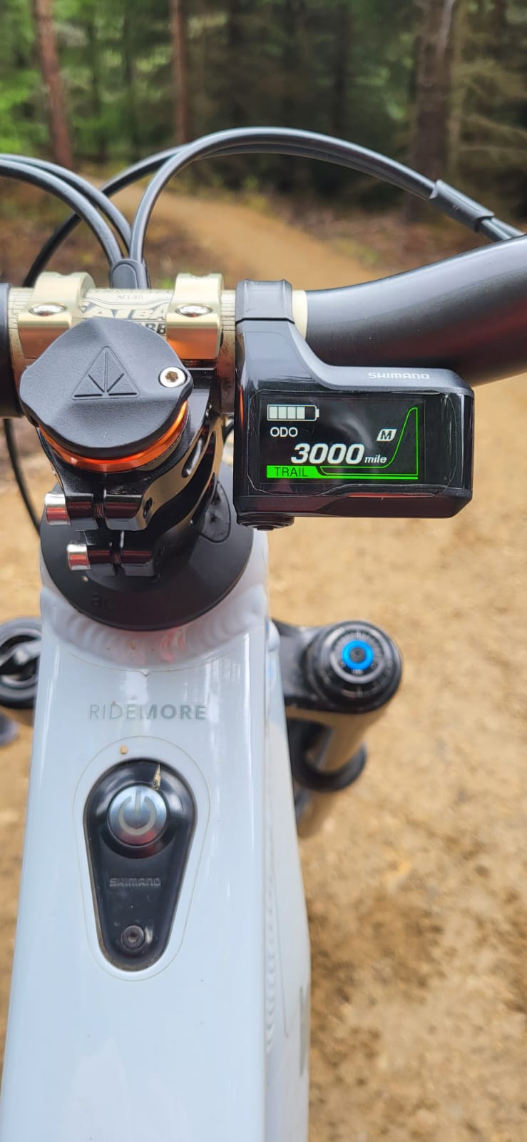

My previous E8000 ebike had 3 motors. All had that play. None of the motors lasted more than 1400 miles.
My current EP8 bike is still on the original motor and is coming up for 3100 miles. There is no play in this motors crankshaft. Can you tell I'm not superstitious..:)
