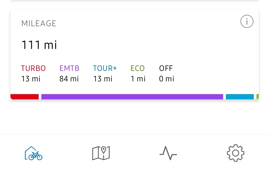

I had the old bosch on a cube and pretty much never used eco and I can see it being the same on my new mondraker with the 750 bosch
Here's my usage so far.
Tour on road, emtb for most stuff, turbo for climbs I cannot do with my weak legs and spirit.
I wonder if it's worth modification within the flow app of eco to make me wanna use it more but to be honest I'm well happy with emtb mode.

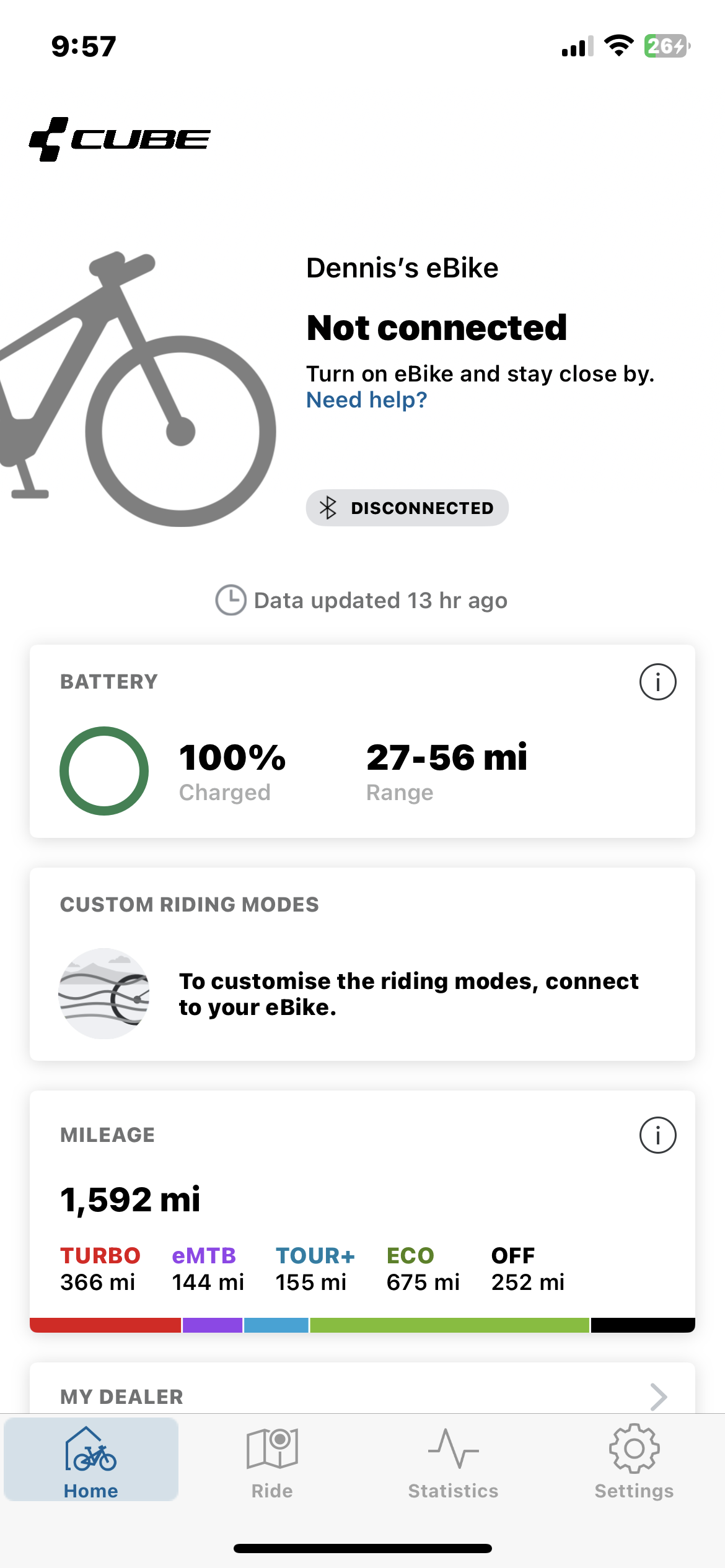

This one is mine I run eco and switched off quite a bit I like what it’s doing to my fitness levels
