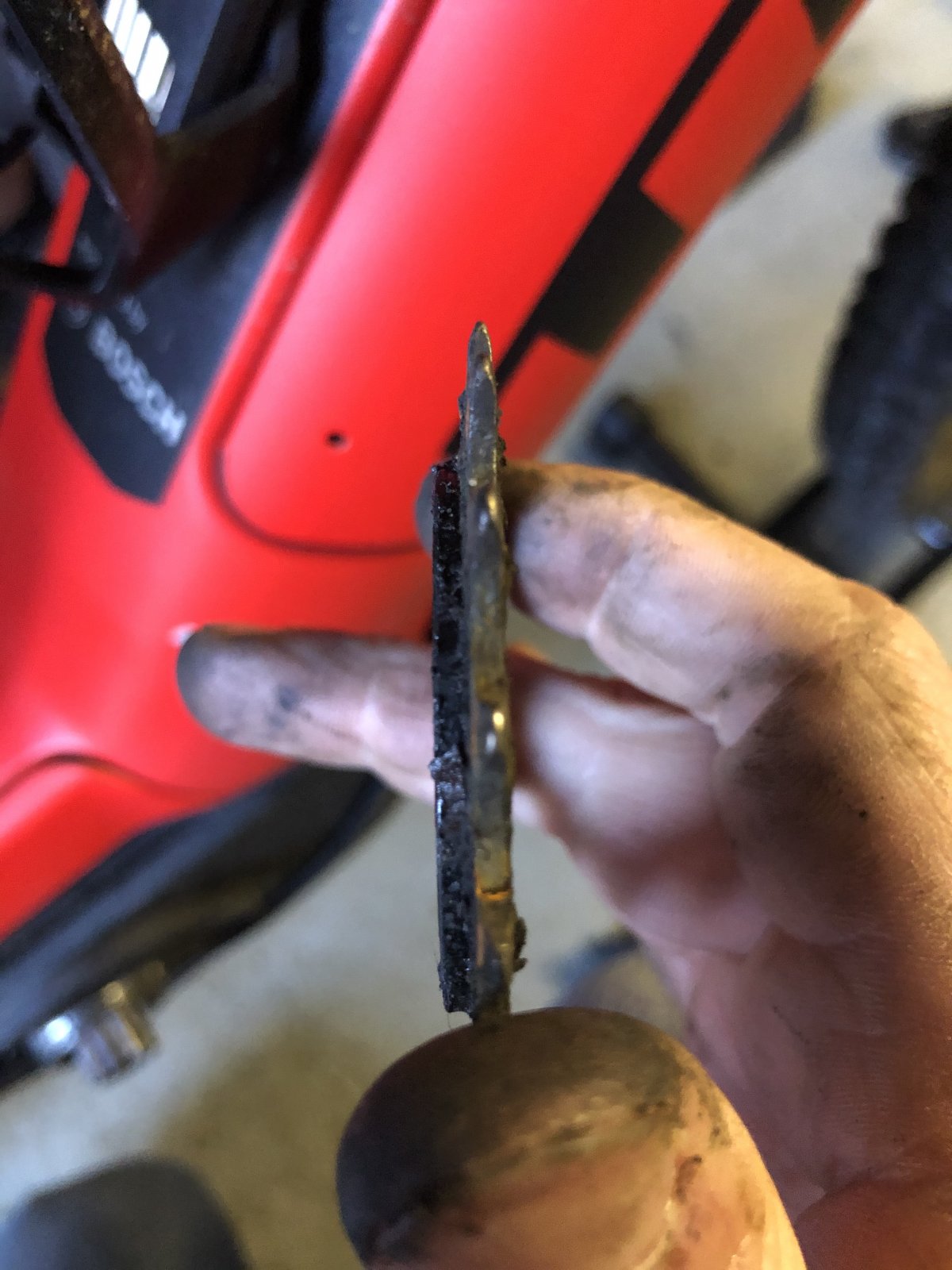

I’ve removed the crank and locking elements to find the chainring is not flat, it has a lip on one side. I cannot find a replacement anywhere on the internet, has anyone previously located a trek Bosch gen 2 chainring 15t with a lip on one side please?

I think you may need an “offset” 15t chainring
I had a look on Amazon but this one seems to be sold out....
Miranda 15t Bosch eBike chainring 3mm offset Black
