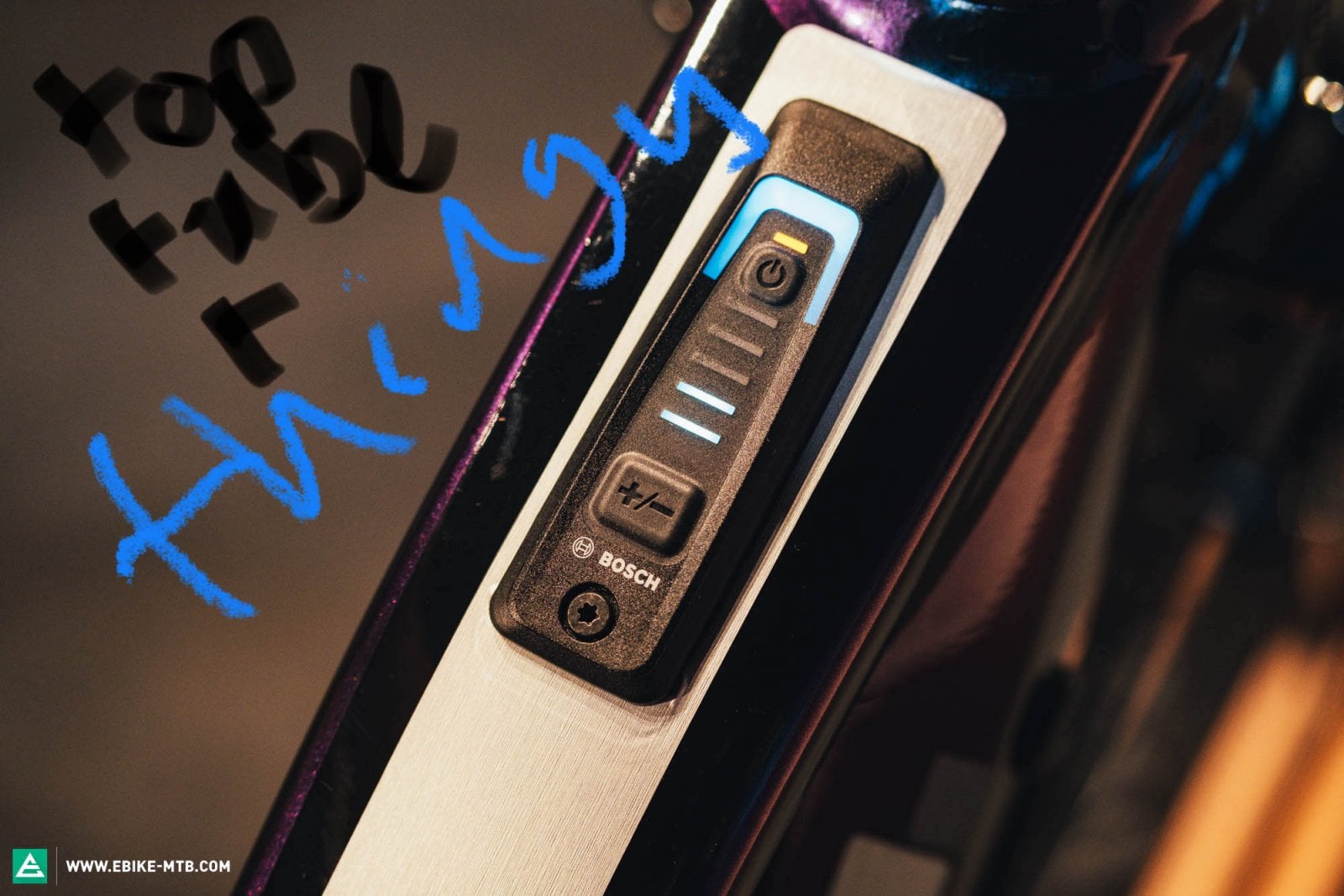

šŸ¤” I thought I'd send Bosch UK an email to enquire whether this new Thingy might be compatible with the Kiox Controller, perhaps a version with an adapter mount to fit directly onto the Kiox control cradle?
Here's their reply..
Guess which Kiox I have..šŸ˜­
Dear David,
Thank you for contacting Bosch eBike.
Regarding your query.
First of all, which Kiox unit do you currently have (since we have 2 different ones)?
Please follow the link below and confirm which one it is you have installed on your eBike.
Kiox 300: The eBike display for sporty eBikers
If it is the new Kiox 300 with Smart System then we can confirm that it is indeed compatible with the new System Controller & Mini Remote.
If you however have the standard Kiox from System Generation 2 we are sorry to say that you will not be able to connect the System Controller & Mini Remote to your eBike.
We hope this information is helpful for you, please do not hesitate to contact us if you have any further questions or doubts, we are happy to help!
Best wishes,
Bahare Green
Your Bosch eBike Team

Is that saying that youā€™d have to install the new mini remote and the system controller to use it with Kiox 300? Doesnā€™t seem practical if thatā€™s the case.

So is that saying if you've got the kiox 300 (latest) smart system that you can replace the existing bulky controller with the new small one?
technically yes, but where are you going to put Top Tube Thingy? This is what the mini remote connects to. It requires a frame cutout.
Bosch werenā€™t quite giving all the info in the email above when they said itā€™d work with a Kiox 300 system as the Thingy is a prerequisite for the mini controller.
Ah crap, I didn't realise that bit. Thought it might be a direct replacement. Being able to use the kiox display and the minimalist controller would have been my ideal choice.
