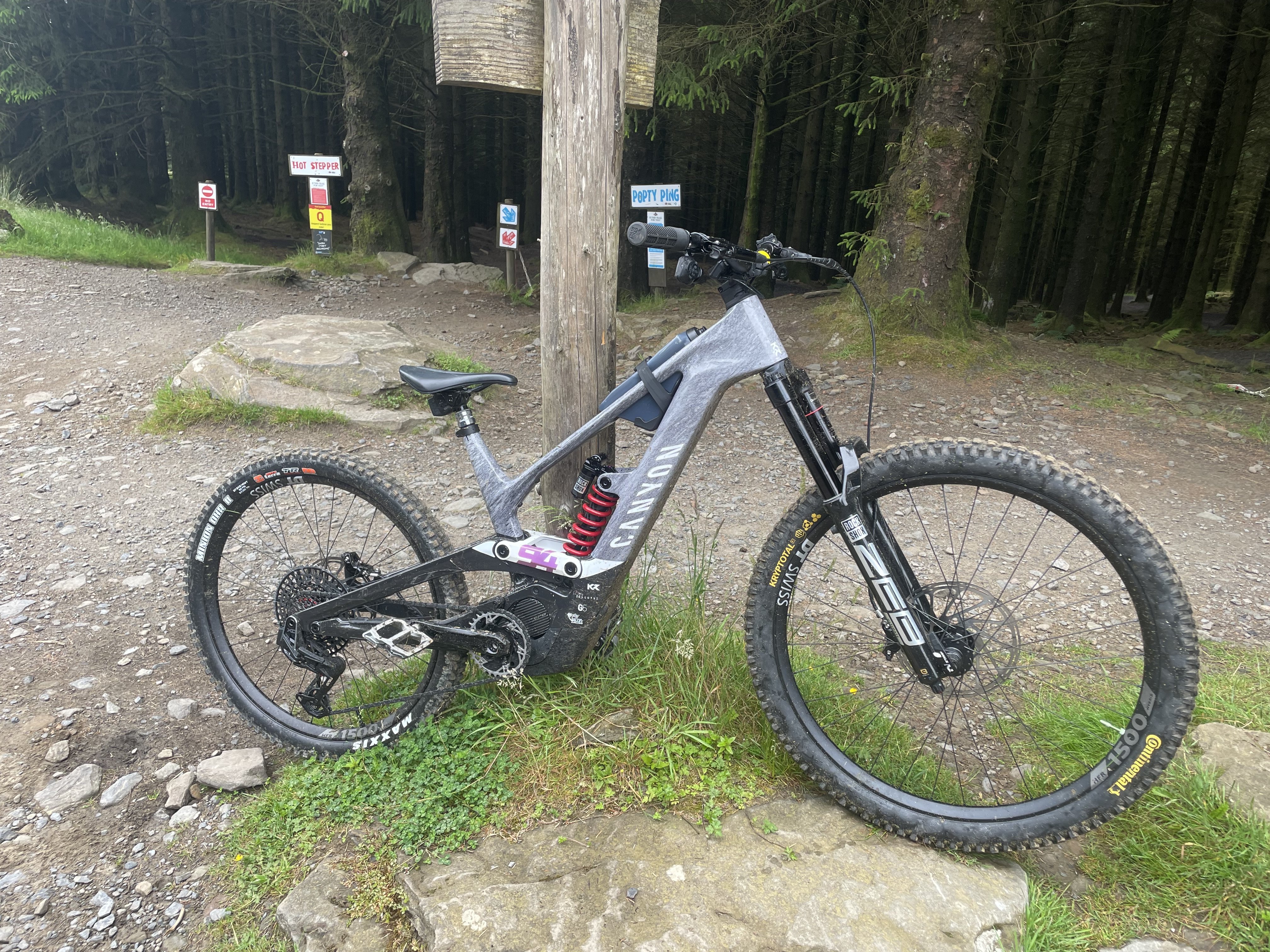

Had delivery last week, Torque:ON cf Roczen.
I’ve been riding a Trek Rail5 but stupidly bought it as a medium size and shortly discovered I needed a large so started looking for a frame to convert, while the rail is a good bike the search for newer and shiny toys overcame common-sense (also having seen Canyon had a significant discount / price reduction on some models I was unable to resist 🫢
Go big or go home?
So, Zeb ultimate forks, super deluxe ultimate coil damper, SRAM X0 Eagle AXS Transmission, reverb Axs dropper post. Ep801 motor, 900wh battery and SRAM code rsc brakes with a colour scheme I’ve nicknamed the ‘mobile granite worktop’ 😜
Before the weekend’s rides it had a spannercheck and conversion to tubeless as well as a general familiarisation with the electronic dropper / shifter systems and drive / display units.
Future fiddlin will include fitting SRAM Maven brakes (currently on my Rail, will use the Code rsc’s already on the Torque to familiarise with the bike and might as well use what’s already working) and I’m evaluating the forks
Against my favoured Manitou Mezzer forks but that’s for future considerations….

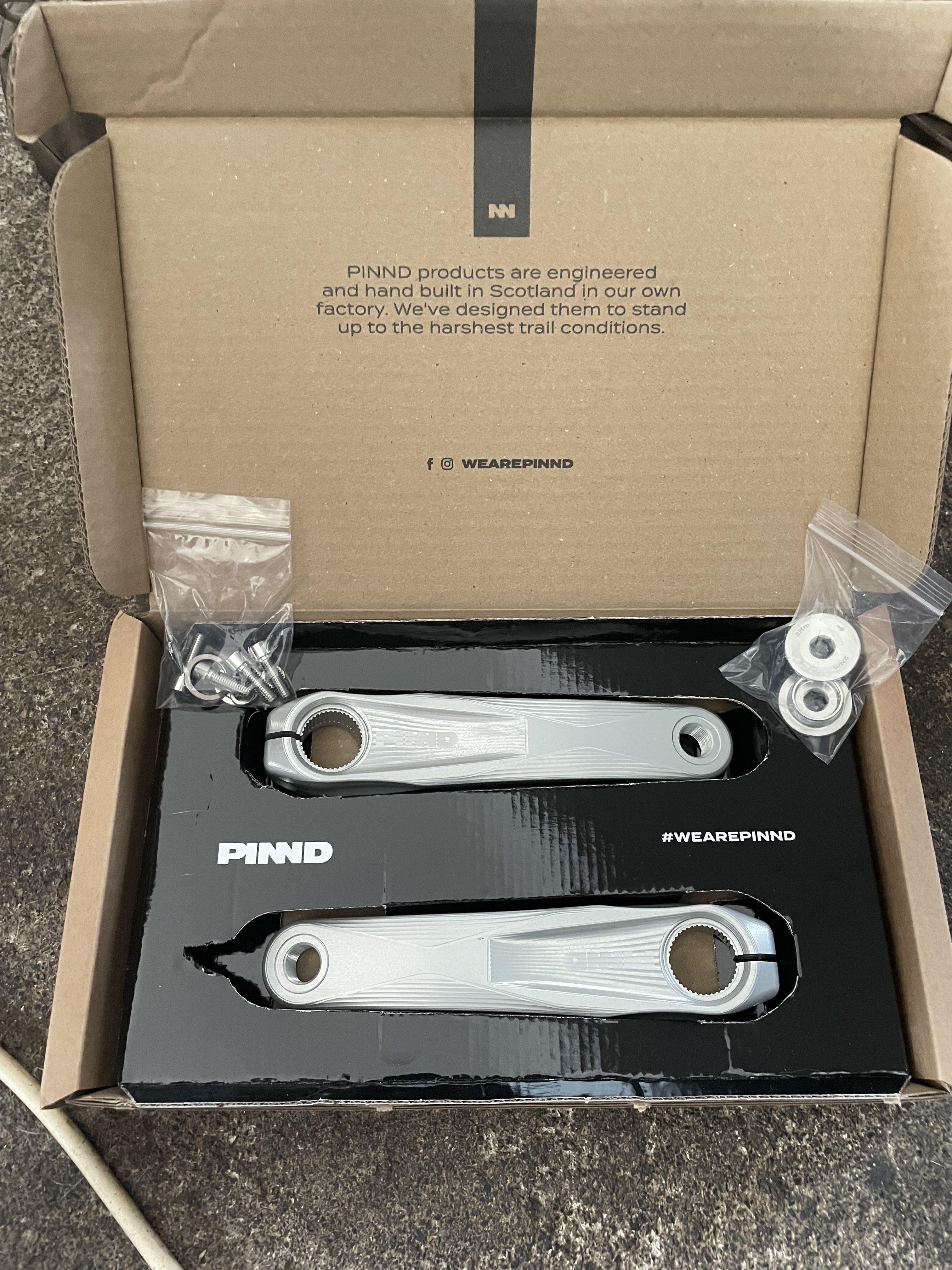

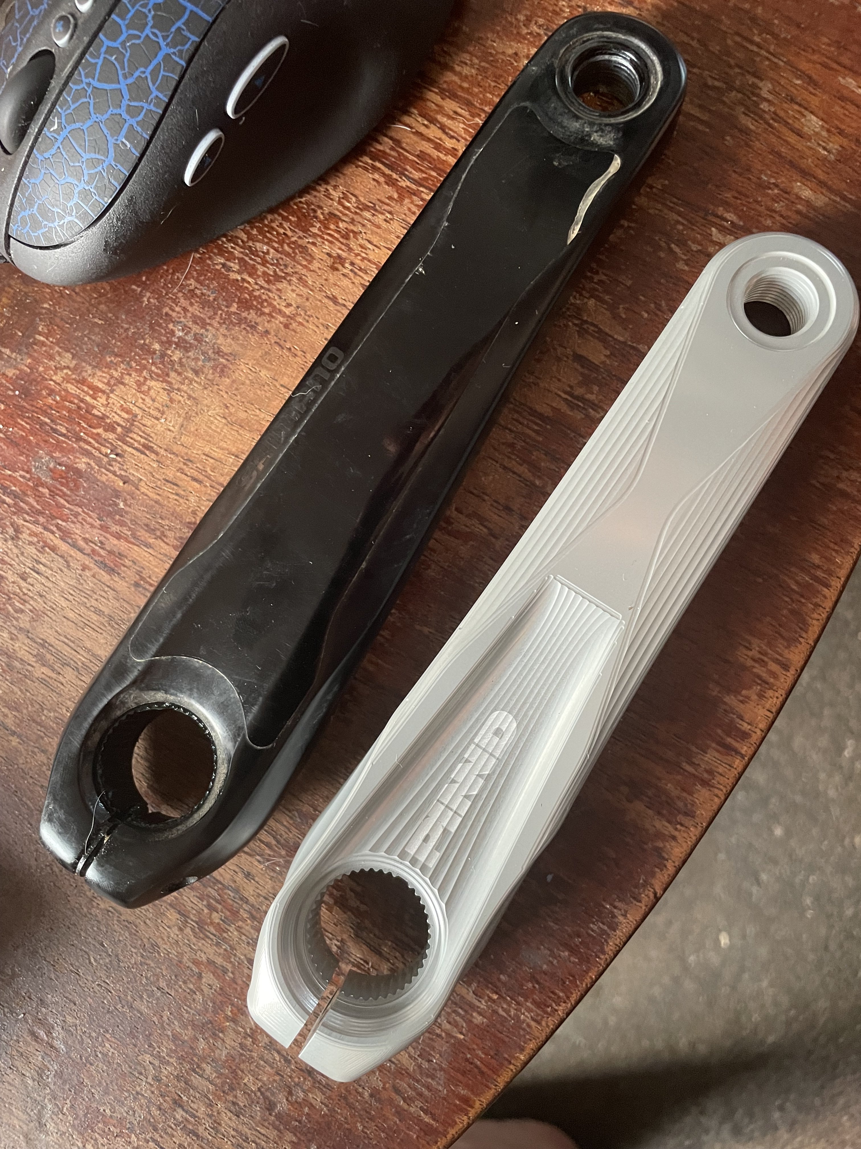

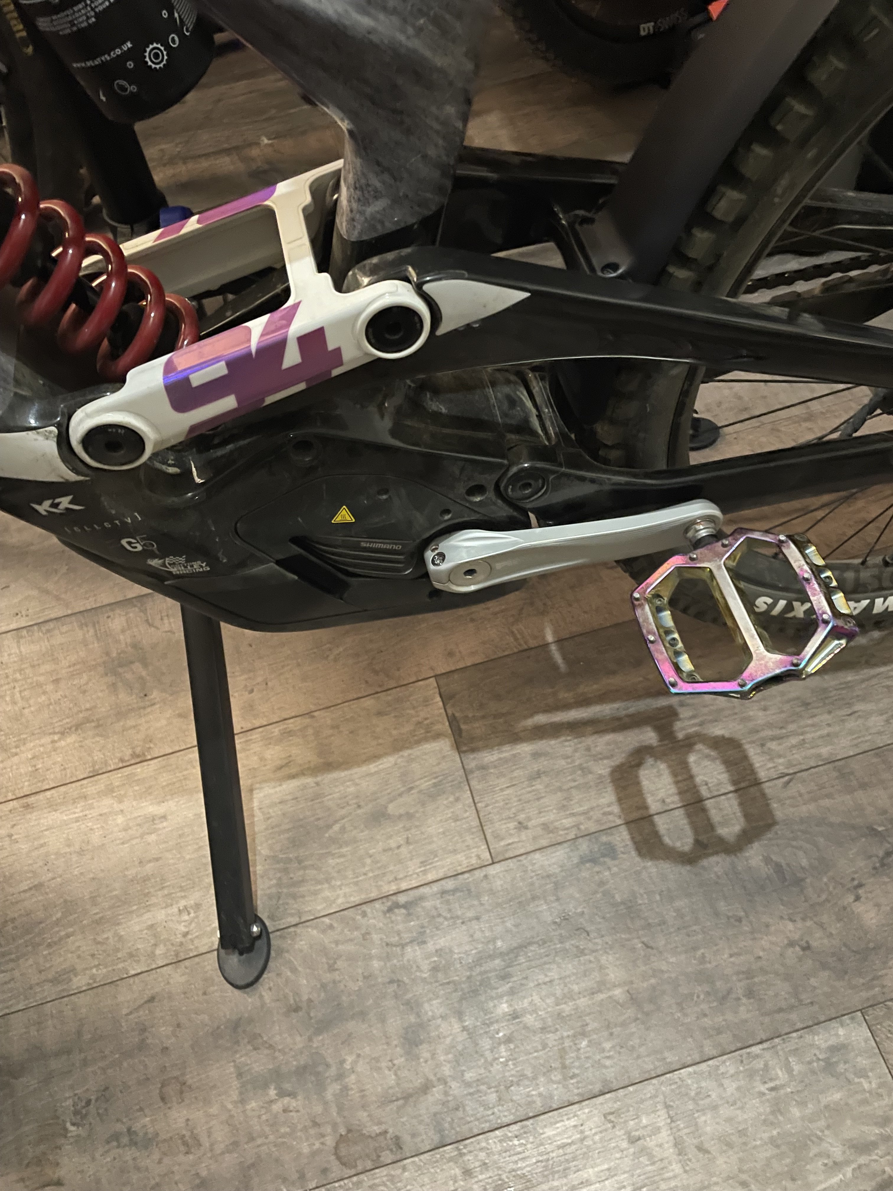

BUT the low bb can cause annoying pedal-strikes especially if you do a lot of pedaling (25 miles today pedalup / ride down @ Bpw)
Lastnight I ordered some 145mm cranks from pinnd (standard fit are 165mm?)
Rich.
So did you get the 145 cranks
