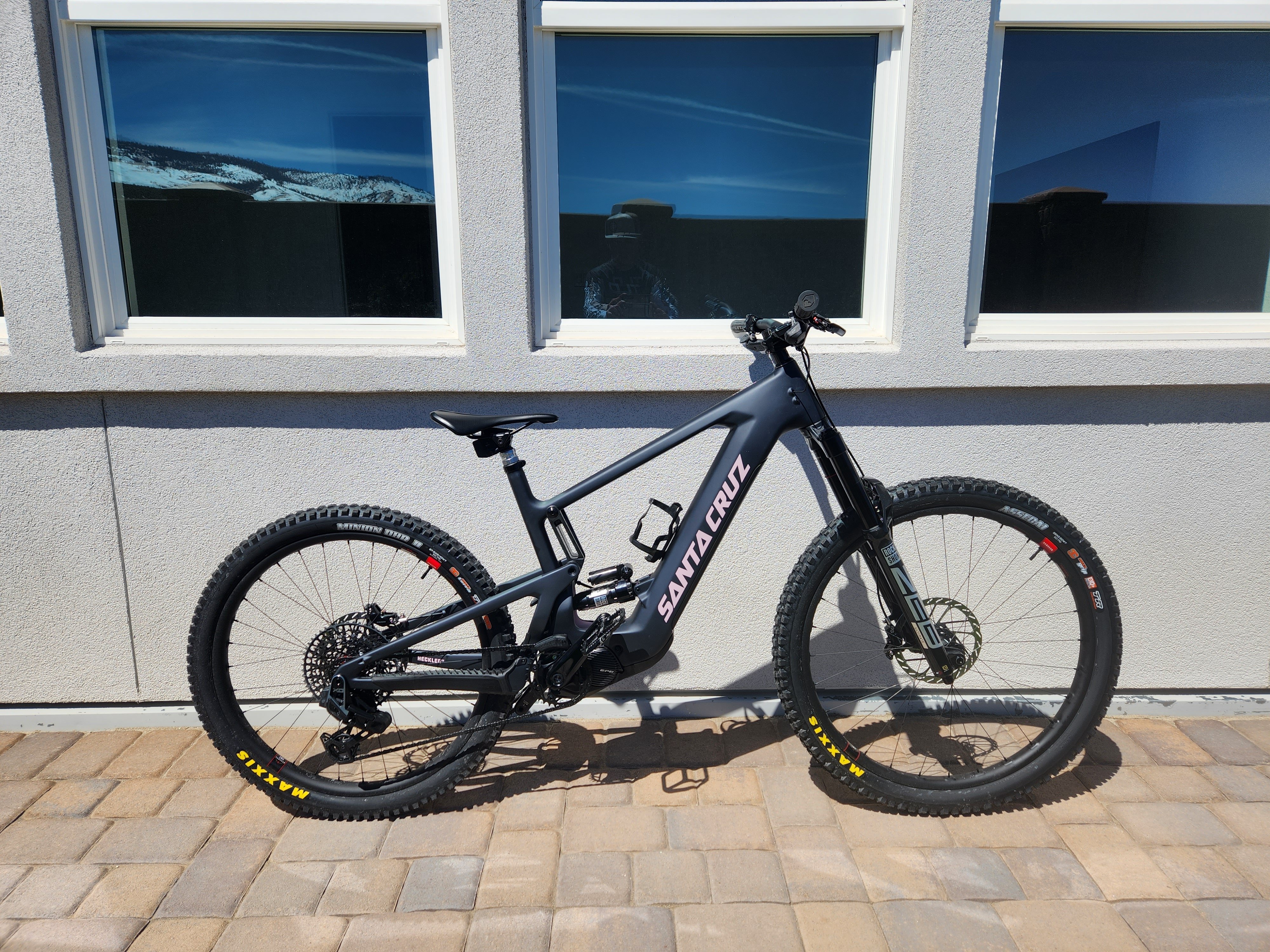

Just picked up another Santa Cruz Heckler this weekend. This is my 4th Heckler and loving this one best.
The new Shimano EP801 does not rattle. The powerband also pulls all the way to redline. Love this motor!
The new SRAM Code Ultimate Stealth brakes are also amazing! The modulation is great! Stopping power great! Love the sleek look and cable routing. Love these brakes!
The new SRAM XO Transmission is also cool. Super smooth shifts!
Super stoked that the fork and shock brands match!
Liking the fact that the price points are starting to drop.

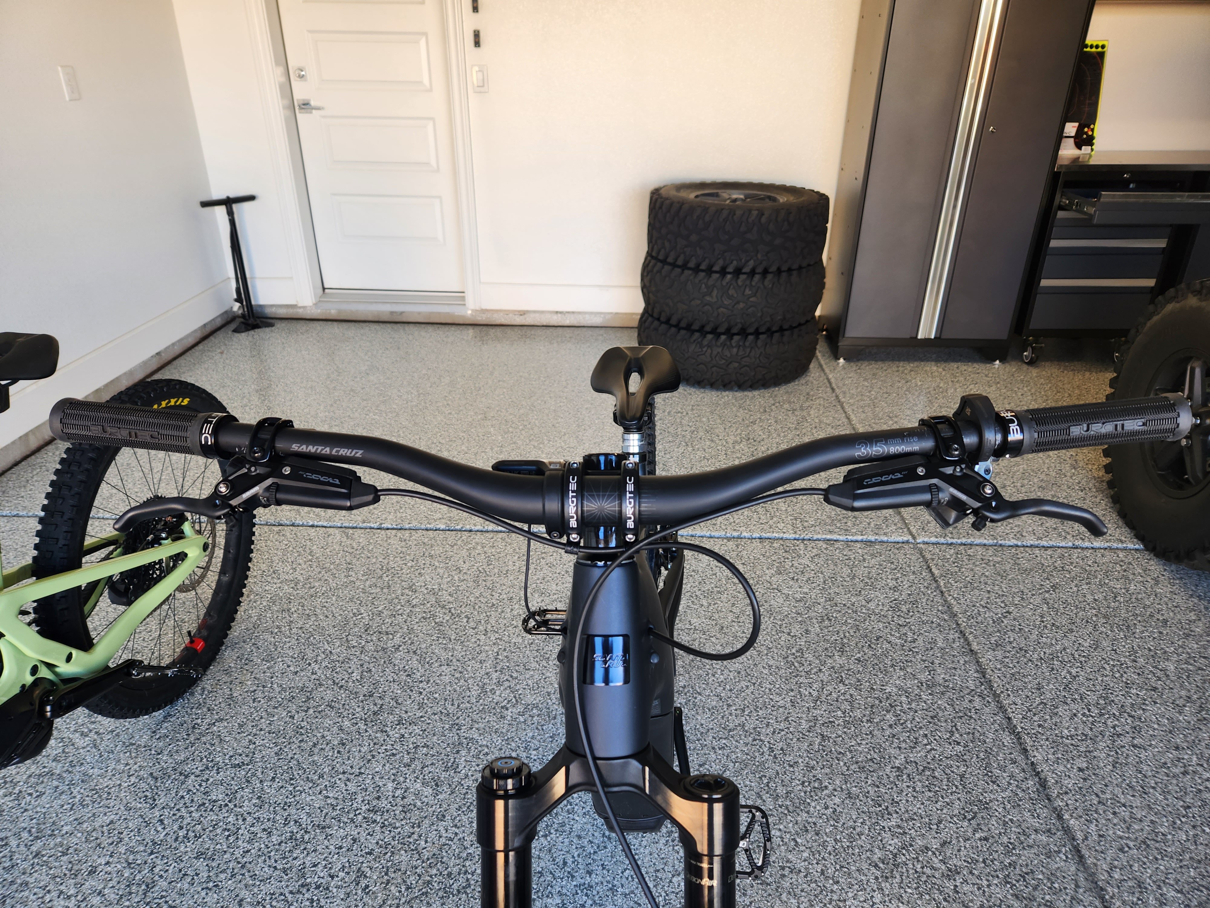

What's different about the cable routing? No more zip ties in the battery compartment holding the cables in place? Does it have the same flimsy rubber plug for the charging port cover and the usb-c power button?

The cabling for the brakes are much closer to the bars and frame now. Minor improvement. Still have zip-ties inside the frame holding the cables in place. Same flimsy rubber plug charging port cover but have never had an issue with it. New button but no USB port. I hated the button with the usb port on my last Heckler.

That is a bad ass bike. If the motor is competitive then this is a serious competitor

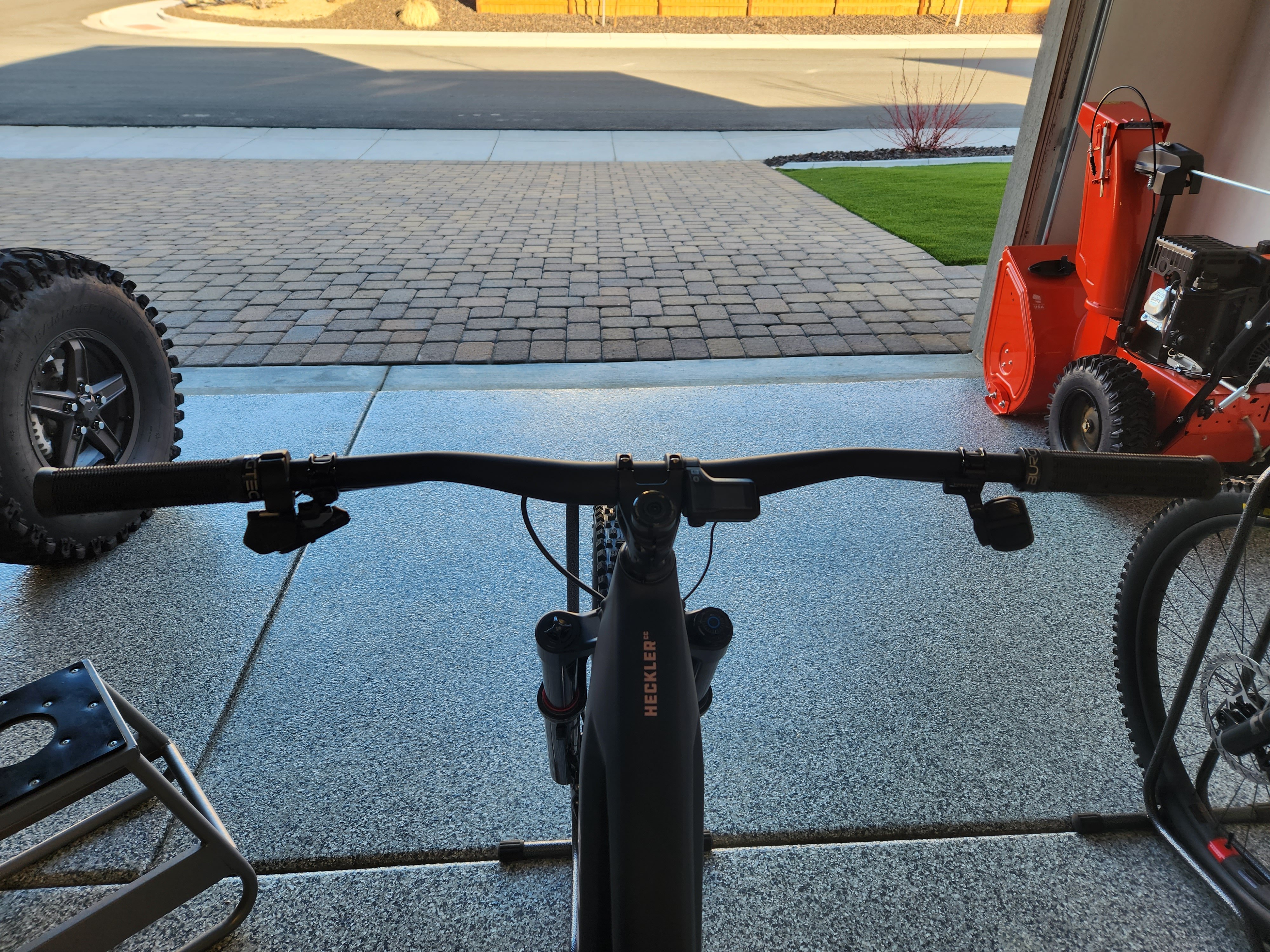

Oh I like that cable routing! Did they just squeeze a couple little plastic mounts in the stem?
I would route the motor wire through that loop as well, and down into the hole on that side. I wonder if I could adapt this to my Heckler...

Yeah, there are 2 small plastic cable mounts in the 2 lower bolt holes on the stem. Great idea on running the motor cable with the brake cable and entering the same frame hole. Would totally clean up the look. I wish the motor cable was wireless but this should do.
View attachment 111287 View attachment 111288
Awesome looking bike. Like the cable routing. What brand are those cable stem clamps? Can't seem to find them

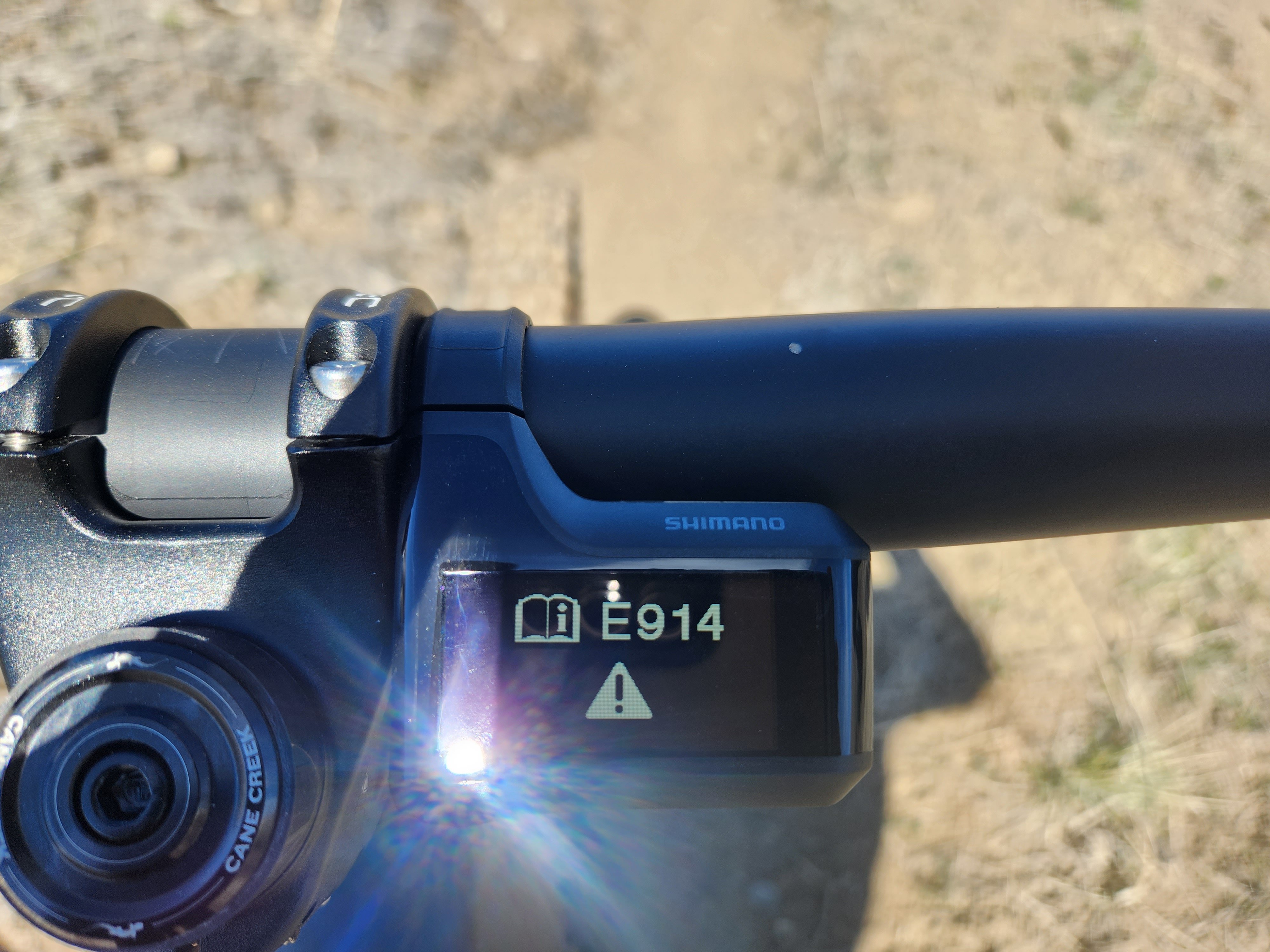

No longer stoked on the bike. :(
Cause of failure
An abnormal condition has been detected between the drive unit and the battery.
Displayed operating restrictions
Support will not be provided while driving.
Remedy
Clean the connector of the battery holder and reconnect the battery.
If the situation does not improve even after step 1, stop use and contact the place of purchase.

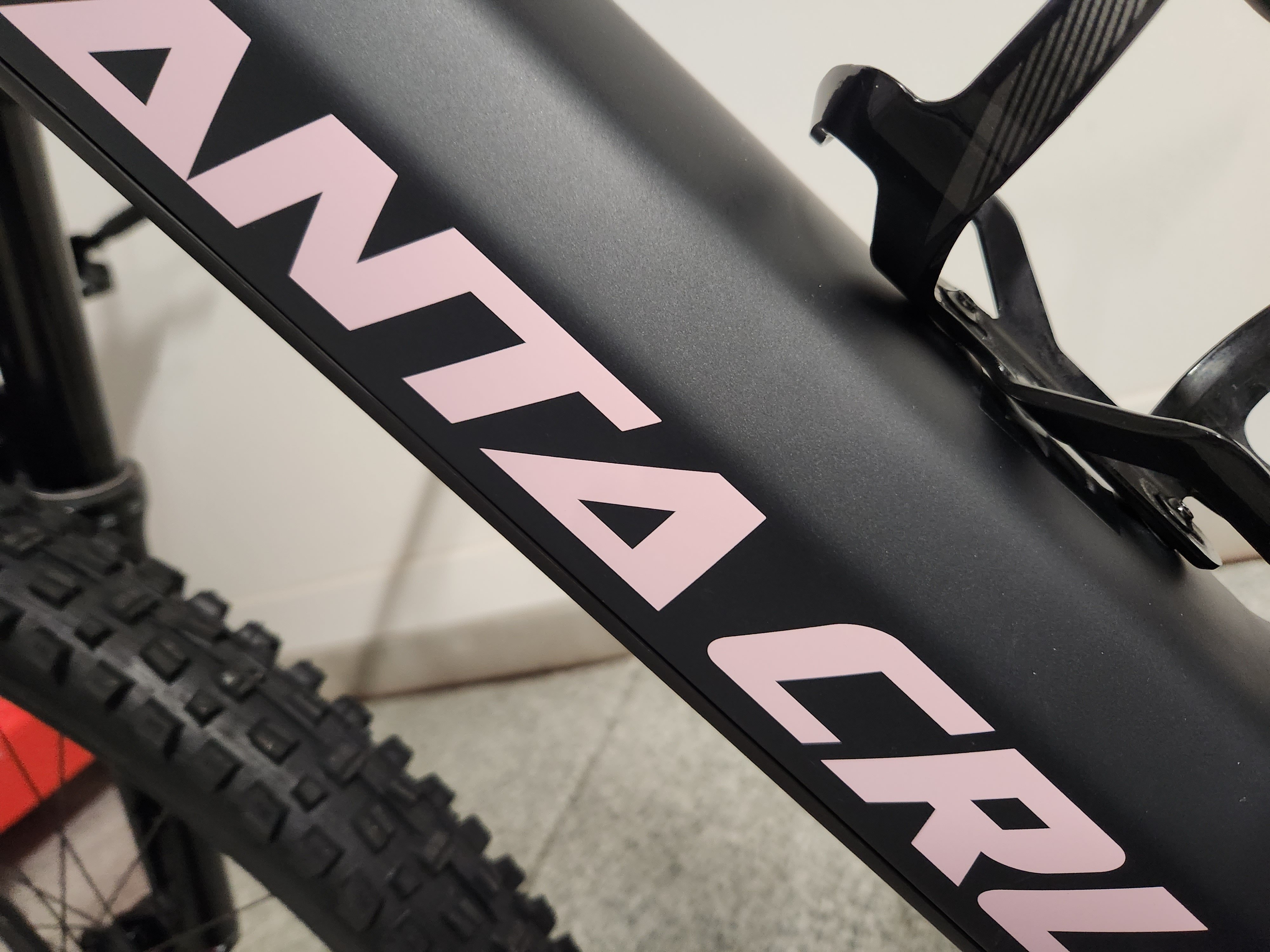

Also, can you send a close up pix of the decal lettering? Is it tan in color and is the main color carbon black or dark blue?

I'm colorblind but told the lettering is pink. :)

Much appreciated. The pink may be a deal breaker!

Well I just stripped the bolt holes in my motor trying to replace the lower battery attachment. This has been the worse new bike experience to date.

Well I just stripped the bolt holes in my motor trying to replace the lower battery attachment. This has been the worse new bike experience to date. Bike is now for sale for $6k. Only 35 miles on the bike. New owner will still need to troubleshoot the E914 error code and re-tap the bolt holes on the motor.
Why isn’t the shop taking care of all of this?
My bikeshop stripped my motor screw holes to on my previous bike. I fixen them with a helicoil
