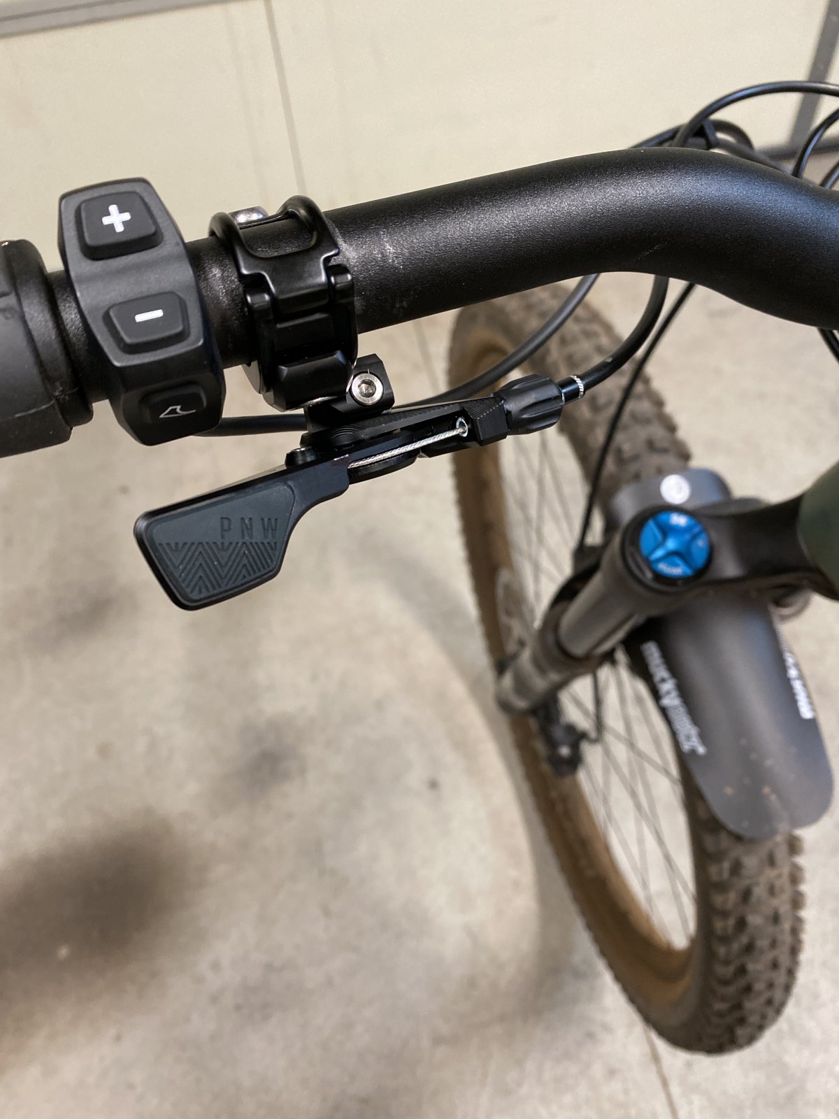

PNW makes a really good post. I just installed one on my 2020 Levo to replace the crappy Specialized IRC that came on the bike. I have Fox Factory on my other bikes but much prefer the PNW with the Loam Lever. The best levers I have ever used!

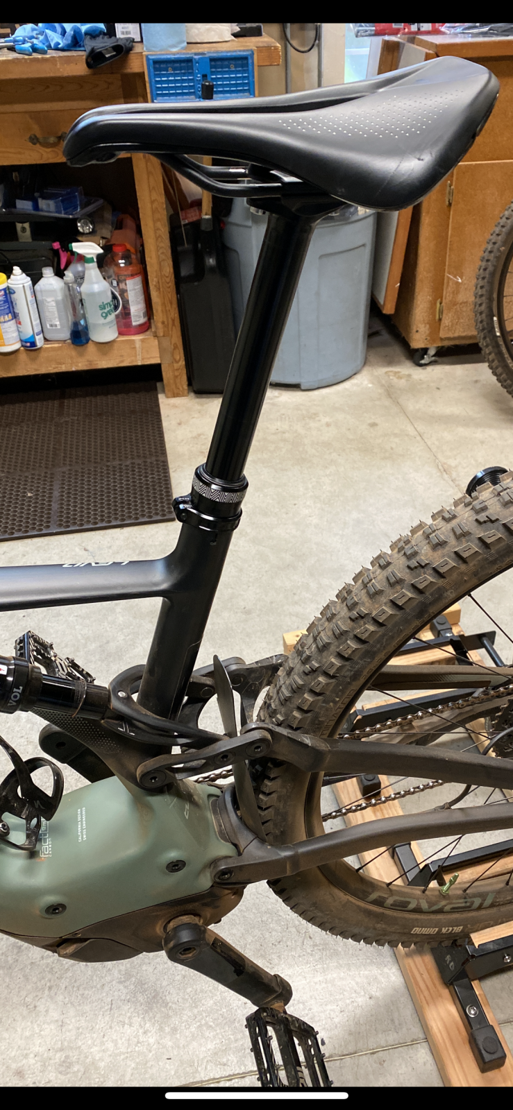

The Bachelor post is 34.9. Also check out the Loam Dropper Lever. I was able to fit a 34.9mm by 170mm rise on my size large 2020 Levo expert. The post will go all the way down in the frame and yet with 170 mm rise I get really good extension for when I’m pedaling on the flats or up hills.
