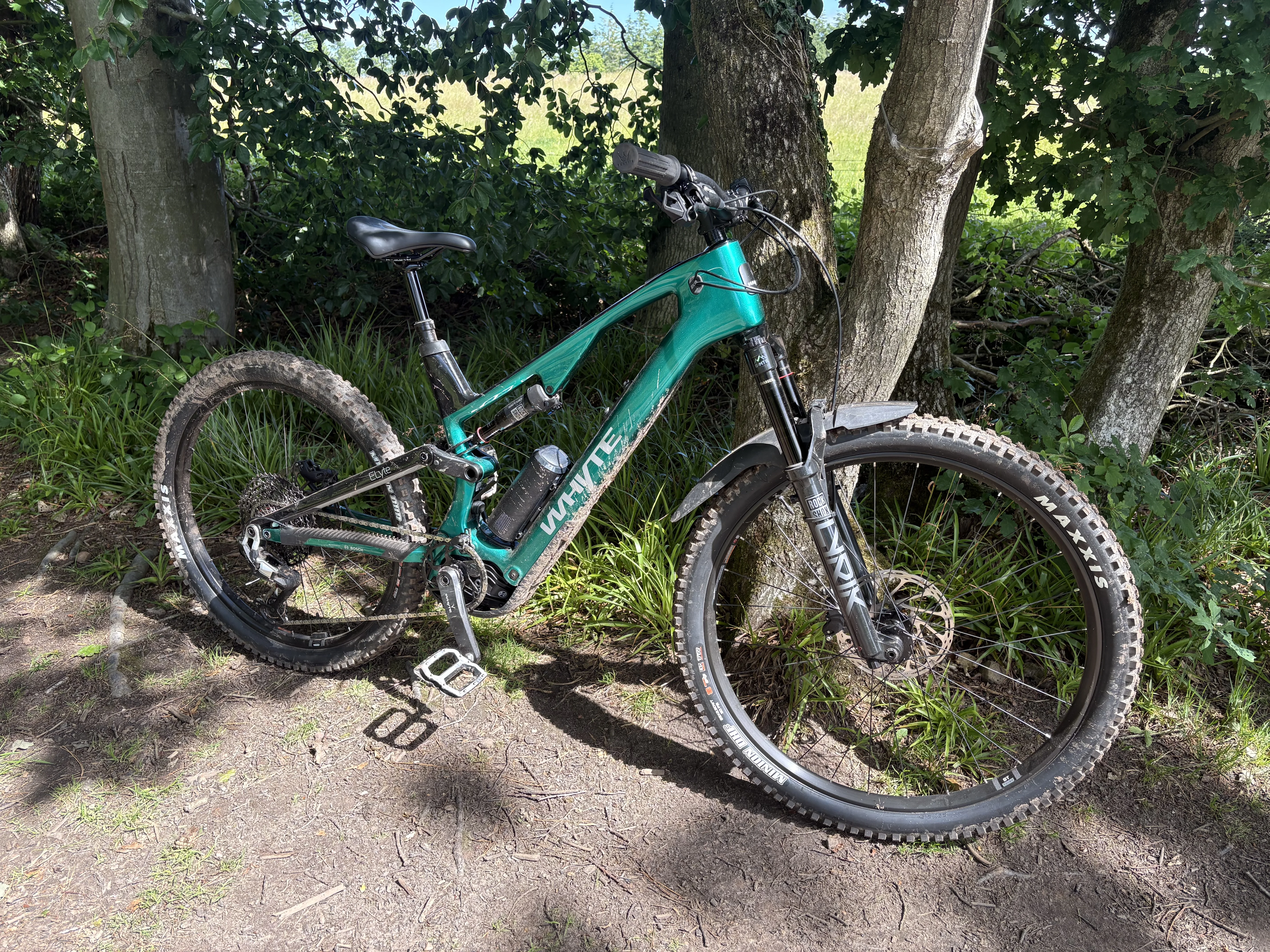

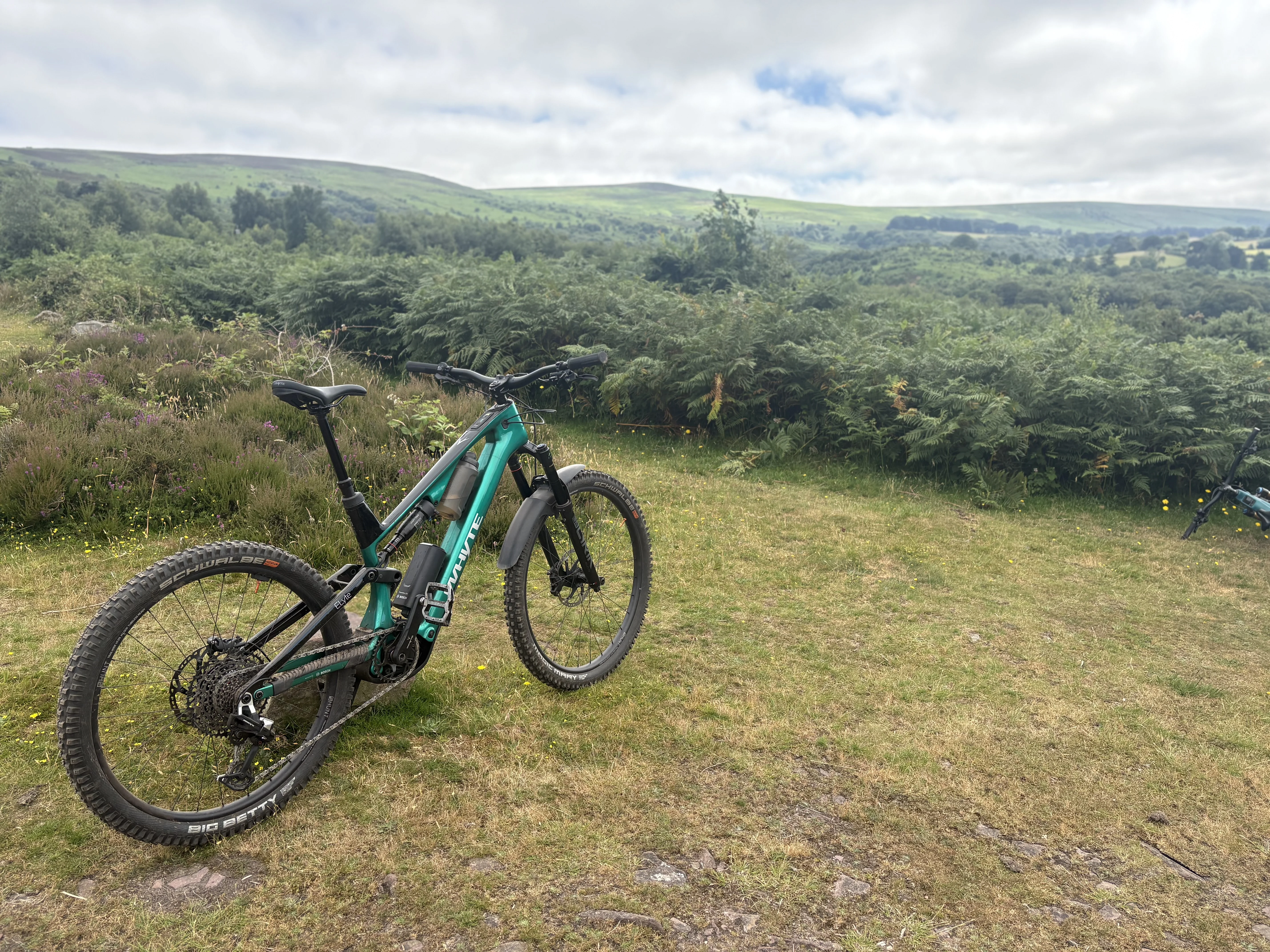

Just bought the above and had my first ride on it so thought I would give some feedback.
I am 6ft (183 cm) and I am about 70kg rider weight kitted up and the bike is size large.
Firstly in terms of aesthetics the bike is immaculate and very eye catching in a gloss aquamarine and black colour scheme. It has the latest Bosch CX motor and all the latest updates were installed....so 120nm/750w max.
My preparation work included fitting RRP Proguard mudguards, setting up the suspension, converting to tubeless, fitting my Ergon SME Mountain Sport saddle and using Flow to tune the modes.
Converting to tubeless was easy as the WTB wheels are ready taped and the Maxxis tyres easy to remove and refit.
In terms of tune I like to just use emtb for the majority of any ride offroad and tour for any road sections I have ride. That is how I set up my Whyte E160 RSX which has the gen 4 motor. So on the ELyte with the Gen 5 motor these are my current settings (assist/ dynamic/ nm/ watts)
Turbo 5/3 ,120nm/750w
EMTB 5/3, 95nm/ 600w
Tour 3/2 , 90nm / 450w
ECO 1/1 90nm/ 400w.
So to the ride review. This was a country ride so no drops or jumps but plenty of non technical climbs and fast twisty single track in the mix. Suspension was super plush ( the Lyric is a great fork) handling superb and DB8 brakes plenty powerful enough. The 2.5 Maxxis DHF/DHR combo set at 23f/25r) added to the comfort and performed predictably well. Manual T Type transmission was also good. I had both main battery and extender fully charged, covered 18.55 miles with 1350 ft of climbing and used EMTB for the majority of the ride with just one short climb against a stiff wind in turbo, and used 50% battery.
The only change I intend to make is to reduce the bars from 800 to 770.
A great bike in my opinion certainly as a trail bike and feels capable of handling more than this ride required........how much more is yet to be discovered!

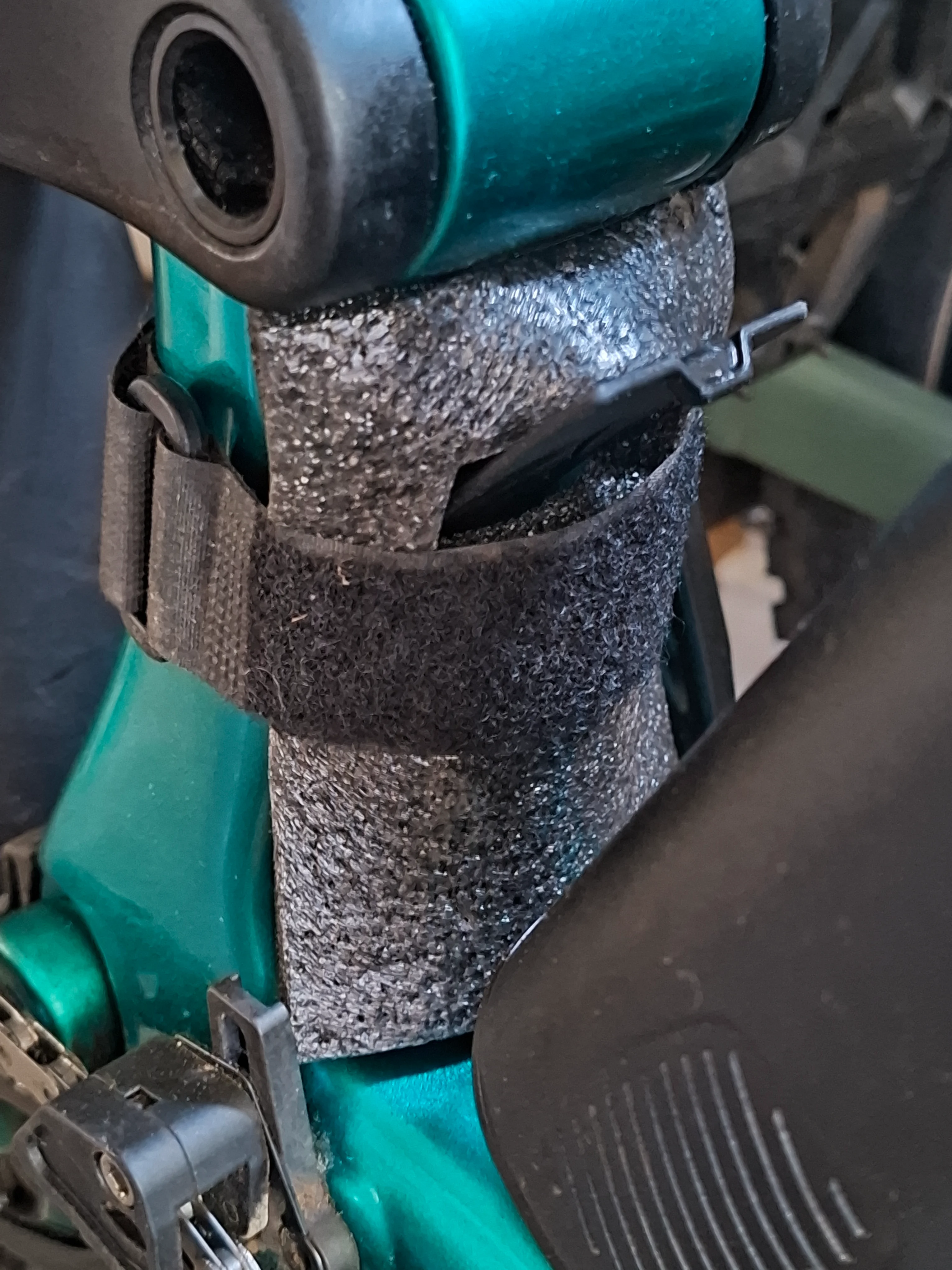

I ride a large E160 RSX and the reach is about the same but because my body form is long legs and a compartively shorter torso I use 50mm riser bars at 770 wide on that bike..........but on the Elyte stack is bigger and seat tube steeper so I am comfortable with the stock bars also cut to 770. I am not that interested in ride stats etc so perfectly happy with the basic controller and uncluttered bars. There are of course options to add a screen if you want....Kiox 400c with surround or bar mounted Kiox 300 with a bit of cabling and probably a change of left side grommet to handle 3 cables. One other mod I intend doing is to add some protection to the front of the down tube....probably a rubber one rather than 3m etc.

2nd ride yesterday, another 17.5 miles. The only changes were bars reduced to 770 and reset of the shock tune. Battery use a bout the same...maybe a little less. It is very noticeable how much you can lean this bike without feeling like it is heavy to bring back up. That is what makes it so manoeuvrable. I guess that is down to the very low centre of gravity. The bike also stays very stable and secure on rowdy terrain. I am still yet to try some decent jumps and drops but to be honest I have an enduro bike for that type of ride so not important for me to test on this bike.

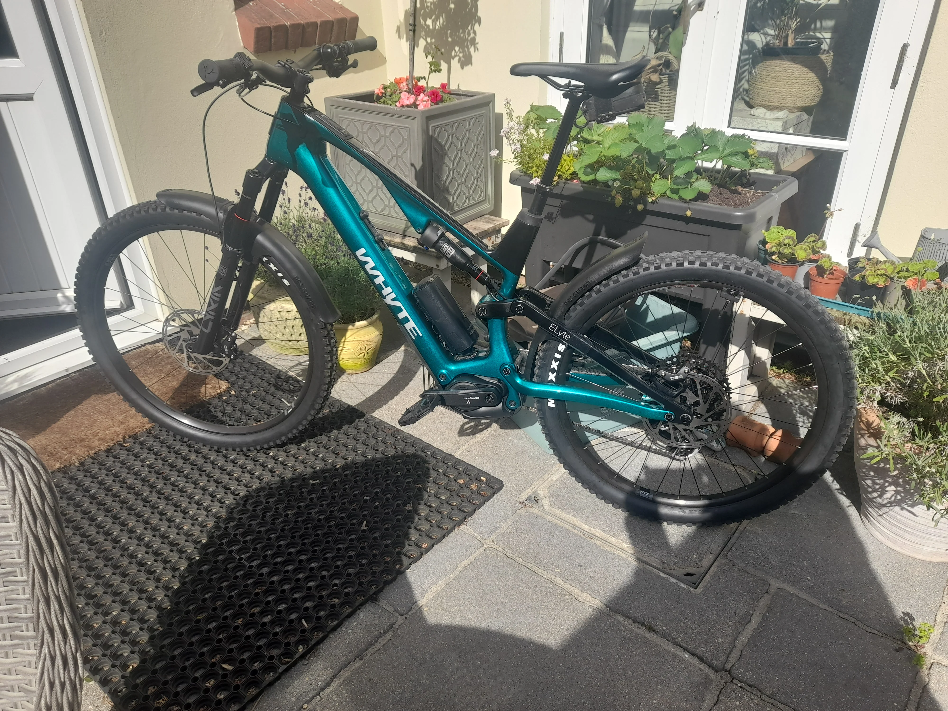

I bought one last week. First eBike. 179cm here, long torso. Getting plenty of elevation from the 400W battery and more than enough for any ride with the extender. Grips and pads changed. Have a bench full of upgrades (longer PNW post, Ergon saddle, SC carbon bars, Hunt wheels. Magura MT7 brakes, etc) but holding off as after 5 rides (in 6 days), the "low spec" stuff is working just fine.
Just being invisiframed. Paint is too nice to leave it unprotected. Only issue I've had is it's quite step-y where we ride and had a few rock strikes on the motor guard. But I needed to up the pressure to get 28% sag. Was way more than that on pickup. Love the way it rides up and down. Going to swap wheels just to see how it feels with Schwalbe tyres rather than Maxxis.
Oh being a Newbie, I've been relying on my more experienced ''e" riding buds. So far added + 1 to Eco. - 1 from Tour+, removed turbo with eMTB and eMTB+ as the final two modes. Mostly I'm riding in the bottom 2, but full power up climbs you've ridden 100s of times is quite addictive!
Ride wise. it doesn't feel that much different to my Bronson/5010. Bit more planted downhill. Low CofG is great for cornering. Without the extender, it is just under 20kg, my beefed up Bronson is close to 17!
