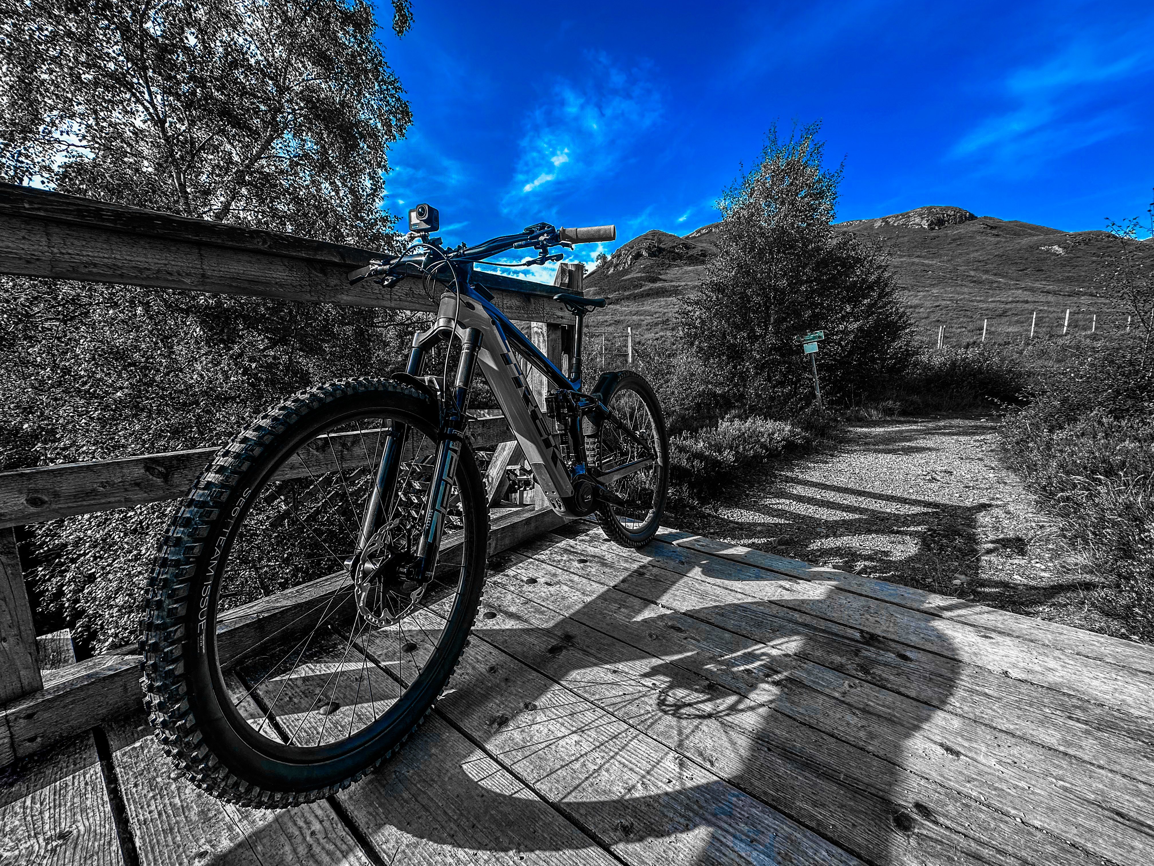

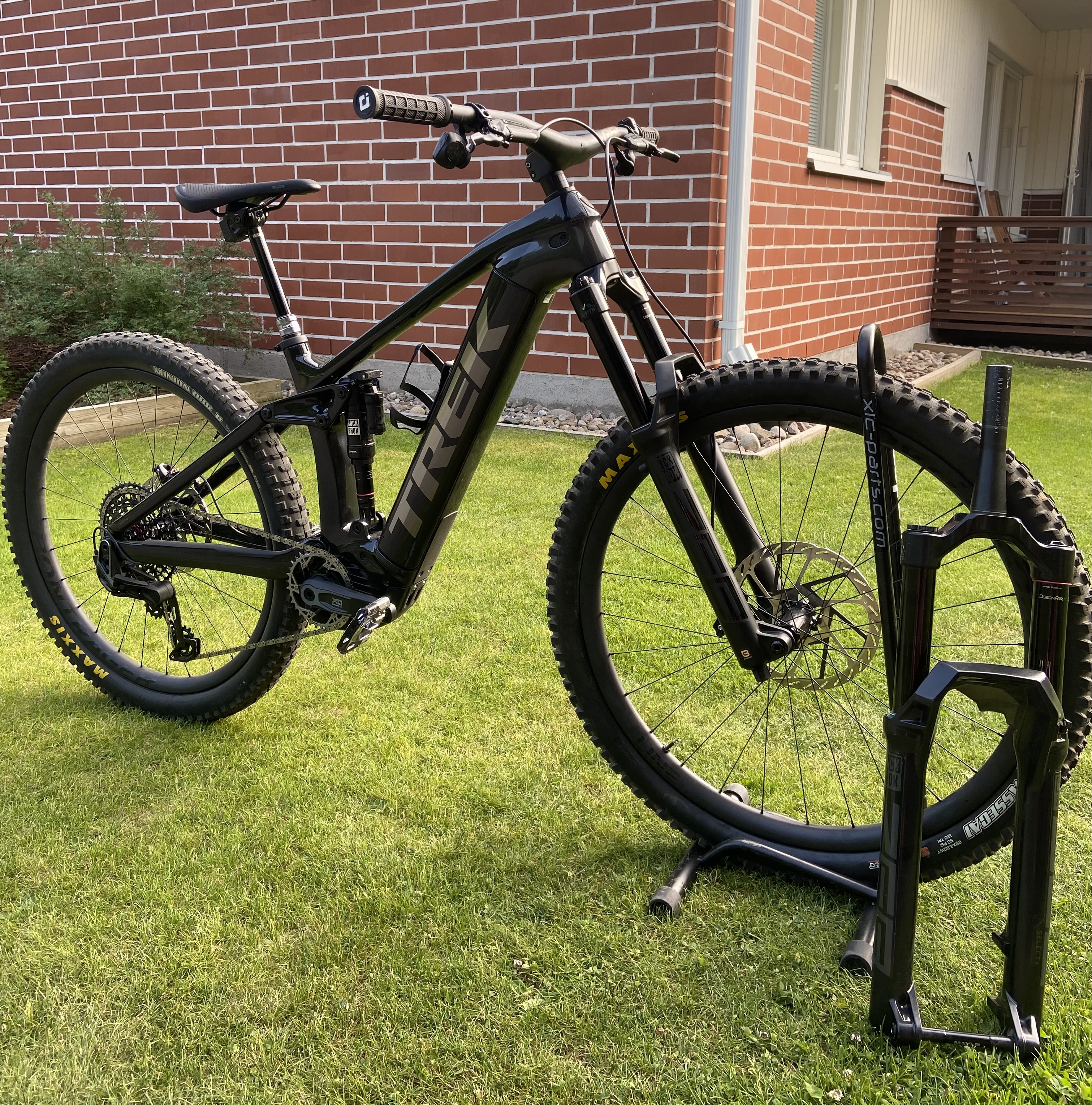

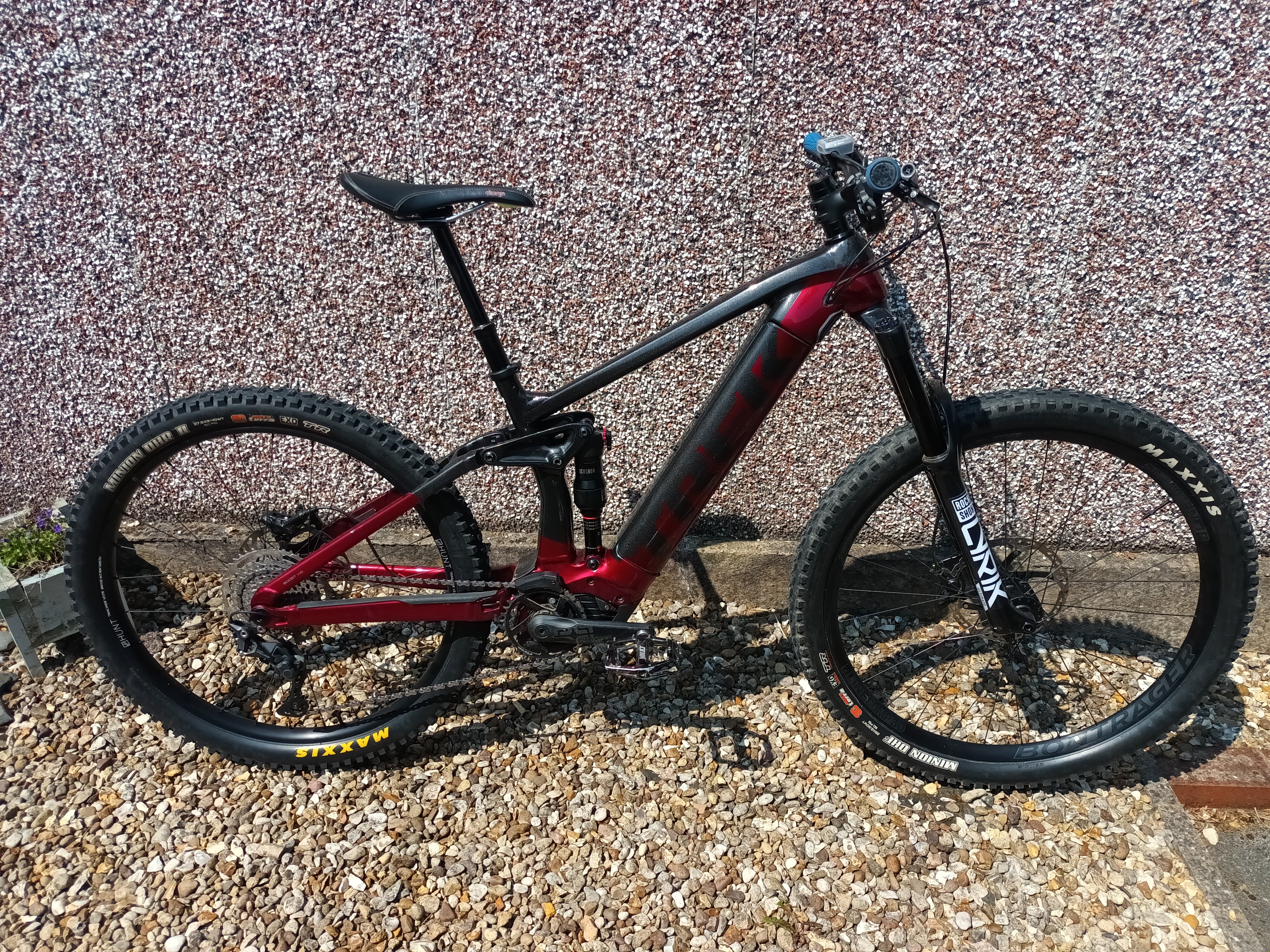

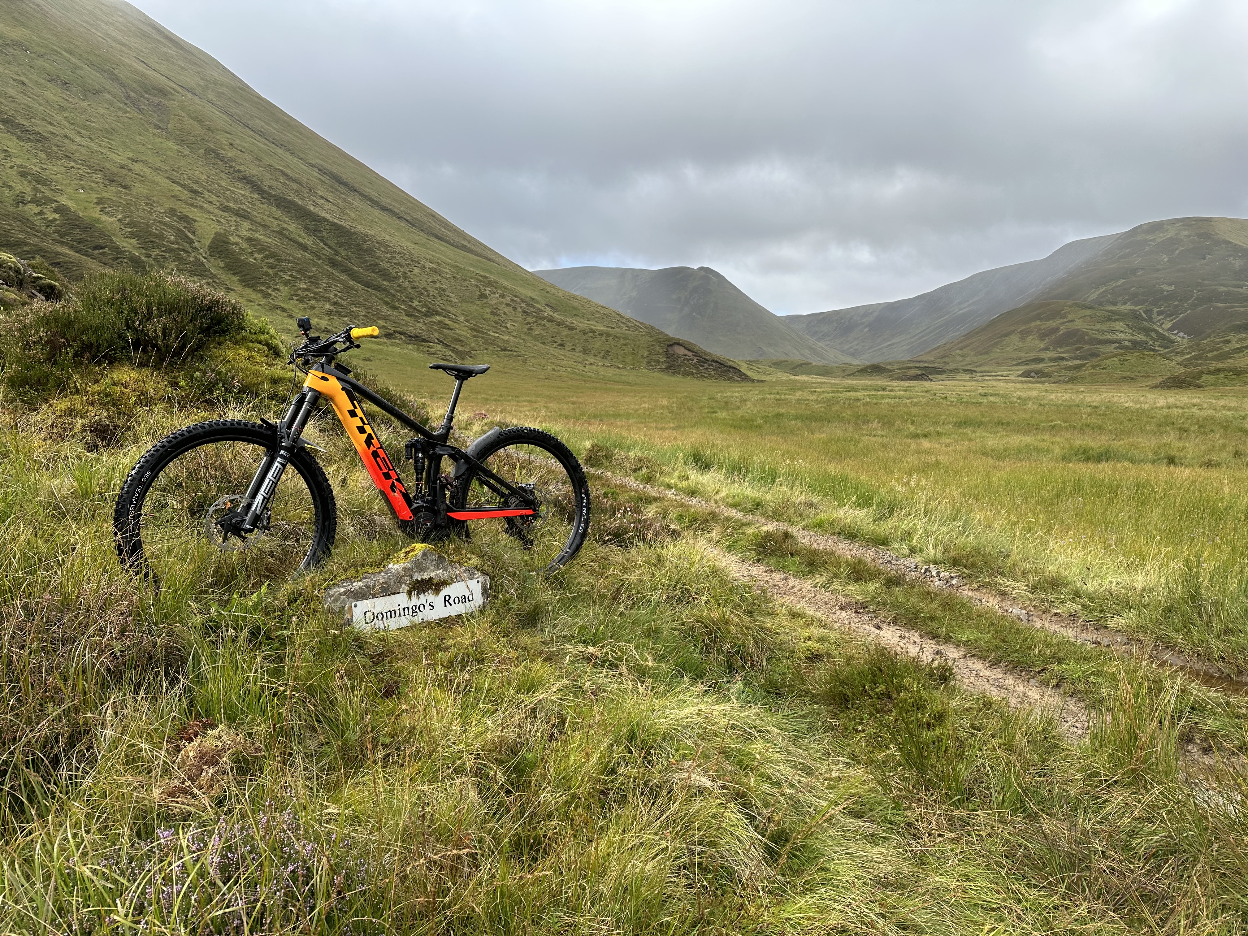

Still very much a work in progress, still changing seat position, bars, levers, getting used to 29 front end etc but third ride in and the Rail 7 Mullet is showing lots of promise.
Coming from an E7000 the bosch motor is a revelation....:oops:
Interesting mod. How does it behaves compared to the normal non mullet? Pedal strikes, cornering, climbing? Are you riding in the hi or lo position? I also assume you didn’t ‘tell’ the motor’s software you had 27.5 wheels.

Truth is I never rode it before the 27 wheel went in. I did think about it but all of my previous bikes have been 27's and I'm a big fan of 27.5 wheels, after riding a couple of full 29's I decided just to go for it straight away. It was a bit strange at first. it felt really high at the front and way too low at the back. Moving the seat angle and height and dropping the bars 10mm helped a lot. The flip chip is in the high position. The fork is a 170mm Lyrik with an RC2 2.1 Charger Damper and Vorsprung Smashpot conversion which is just the best fork I have ever run...on anything! It helps a lot!
We have just come back from the fantastic Afan White's level trail which has a really long rock strewn climb and it wasn't too bad but I was being extra careful. I think I might go for some shorter cranks TBH. The cornering is good but again I think There's more to come from me rather than blaming the bike. I rode the same bike (Vitus E Sommet) for over two years and was Very comfortable on it and knew exactly how hard to push it. I'm already noticing some benefit from the 29 front so I think with a bit more time on the bike I won't be far of the corner speed of before. No I haven't altered the software yet. TBH I'd be interested to know how much sooner the limiter comes in because I honestly really can't tell. Its doesn't feel a huge amount. I have a good Bosch dealer near me (Race Co.) so might take a trip up there at some point.
Hope this helps. Give it a go, why not.(y)

Like you i upgraded my Yari with the RC 2.1 charger, i also installed SKF seals. It’s now a Lyrik Deluxe Ultimate. Never thought of a coil spring, don’t know of anyone around here you runs one either. would be fun to try. I was asking about the software update because if it’s not done then the max speed will still read 32km/h but because of the smaller wheel it will be substantially less.
