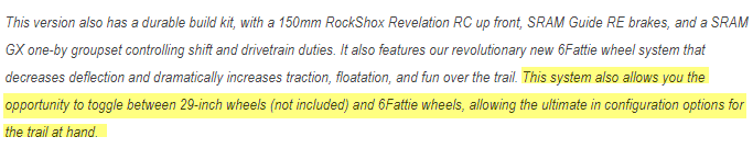

This is taken directly from the official Specialized advertising material with regards to the exact EMTB I bought:

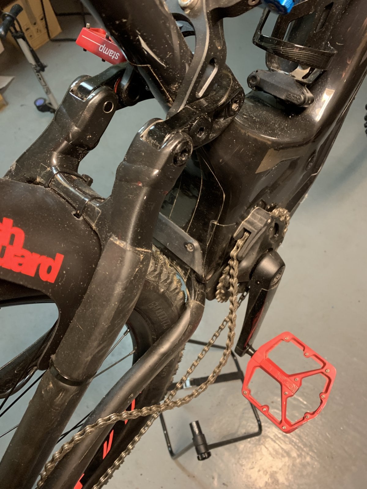

As a prof of my issues I attached the following picture which shows my 29" wheel mounted with a Maxxis Ardent 2.4 29" tire - Picture very clearly indicates that the tire rub solid up against the lower front part of the rear triangle:

For a reference I also added the following picture of a fellow forum member's bike running another 29" setup with a Maxxis 2.5 DHF that shows loads of clearance. My initial approach was asking Rider Care if there somehow could a situation where my bike during production was equipped with a wrong rear triangle during production - This is the picture that shows that some have absolutely no issues running a decent width rear tire:

The reply I got from Specialized was very clear; "During production of MY2016 to MY2018 there was only utilized 1 type of rear triangle for all full suspension models"
They also stated the following; "The max tire width, (recommended by Specialized) with Specialized tire and Roval rim is 2.4”
The information above was completely new to me as they now suddenly stated that they could only guarantee the 29" if only Specialized products were used - This have never been stated in any public advertising material I could find on the Internet. The first statement is also plain wrong as a quick search via Goggle indicates that there last year was sold a Short travel version of the Turbo Levo that came from factory with 29" wheels. For those that are interested you can clearly see on the links below that the front part of the chain stay is very different from what I have on my bike:

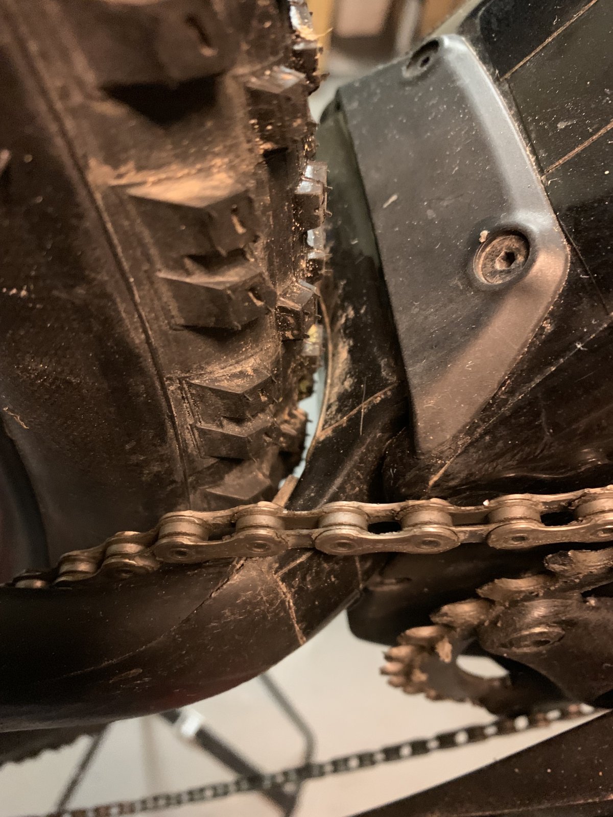

Nevertheless I continued to claim that I did not consider my Turbo Levo fit for purpose with 29" wheels together with a tire wider than 2.1 witch I consider useless on a heavy EMTB for anything else than light XC riding. In the following dialogue with Rider Care they asked me to try the wheel/tire combo from my wife's 2019 Levo HT as Rider Care knew for a reference that this combo would work perfectly for my exact bike. This setup is a combination of a 29" Stout wheel with 25 mm inner width and a Specialized Ground Control 2.3 tire. After installation I did send the following pictures as documentation to Rider Care - The ruler in the picture is 2 1/2 mm wide for reference:

This picture is with 30 Psi and if I raise it to 45 Psi it goes solid, again I would say NOT FIT FOR PURPOSE!

"We never promoted this Levo to fit with all different tire options and the modern wide rims.
It was promoted as a 6fattie bike, with the possibility to mount 29ers. 29er is max 2.3-2.4”, bigger than that, it becomes a plus size tire.
So the answer for this is: Will a 29er wheel with a 2.3/2.4 Butcher tire fit – Yes.
Will it fit with maximum tire clearance? – No, it will fit like shown in the attached picture and there’s a difference on the clearance with the modern rim wide designs."
So basically they are admitting that there initial advertising gimmick is utterly crap and in real use the bike sold is NOT a dual wheel size EMTB. As you can see they also told me plain lies with regards to the question about different versions of the rear triangle and you all want to know what the final answer was from Rider Care as I continued to Claim "NOT FIT FOR PURPOSE"....................?

I would say no its not they could have at the very least asked you to take the bike into a specialized dealer to have a look.
my 2017 and my 2018 were both alloy comp bikes and I ran both of them with 29x2.5 maxxis shortys and 29x2.35 magic marys which are huge for a 2.35 tyre.
have you tried asking somebody with a bike like yours to give accurate chainstay and seat stay measurements for comparison

I guess you need two bikes side by side, or see if the quoted wheels fit, on the website all the sizes are quoted the same.

Hi Karsten,
I share the opinion of @highpeakrider that the triangle below seems to be different. Especially the hinge construction with the bottom bolt looks different to me:
29-dhf-jpeg.10575
Your bike also holds a plastic cap with two small bolts/screws above the hinge.

I would contact that rider if I was you and ask him to measure all key metrics like on the Spesh website just like you did. For me it's one big miracle too and I would really love to help you.
