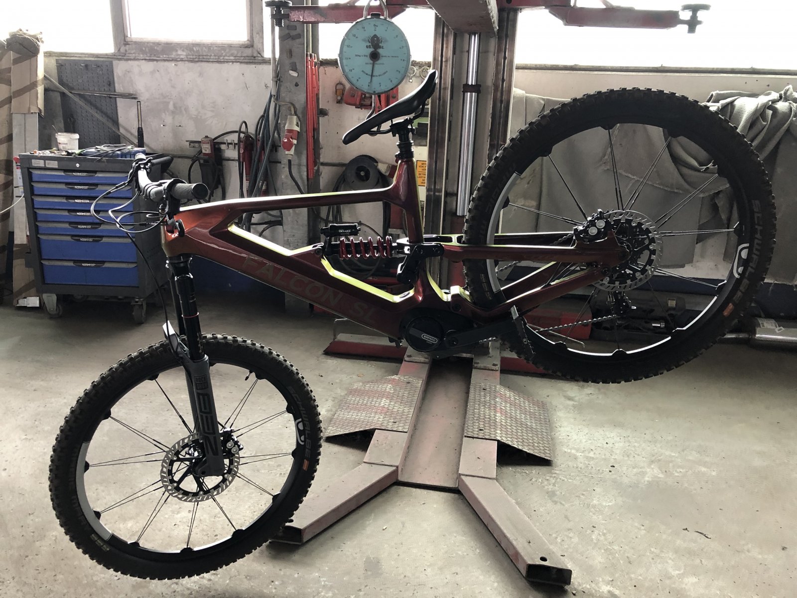

Is the "CHEEB`S" big sister , a very nice bike by the way . I set it up last summer and painted it myself.Was not a problem because I have a paint shop.Nice!
More details needed! Painted by Dengfu? Specs!
A BOM (Bill Of Materials) would help. From the photos I think I recognize :Specs!
You have a good eye ?A BOM (Bill Of Materials) would help. From the photos I think I recognize :
- CrankBrothers Twin Pair Spoke IODINE 2 AM wheels, size ?
- Sram GX Eagle grip shifter (11 or 12 speed ?) which also requires a matching GX derailleur. Cassette also looks like Sram.
- Magura MT5 Estop brakes & Magura Estop discs 203 mm ?
- Front: RockShox ZEB, Ultimate ? 160 mm ?
- Rear: RockShox Super Deluxe Ultimate ?
- dropper ?

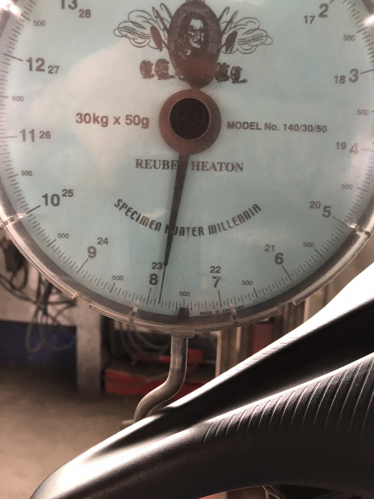

Thank´s,the weight is just under 23 kg with the 700 Wh battery ( 14S4P 3500mAh Samsung cells)super nice
how much does it weigh?
Yes, in 19". I still had the M600 and the battery was built by myself.in size 19 ”? I am very much looking forward to my frame coming. has received motor and battery. you have selected M500 or M600

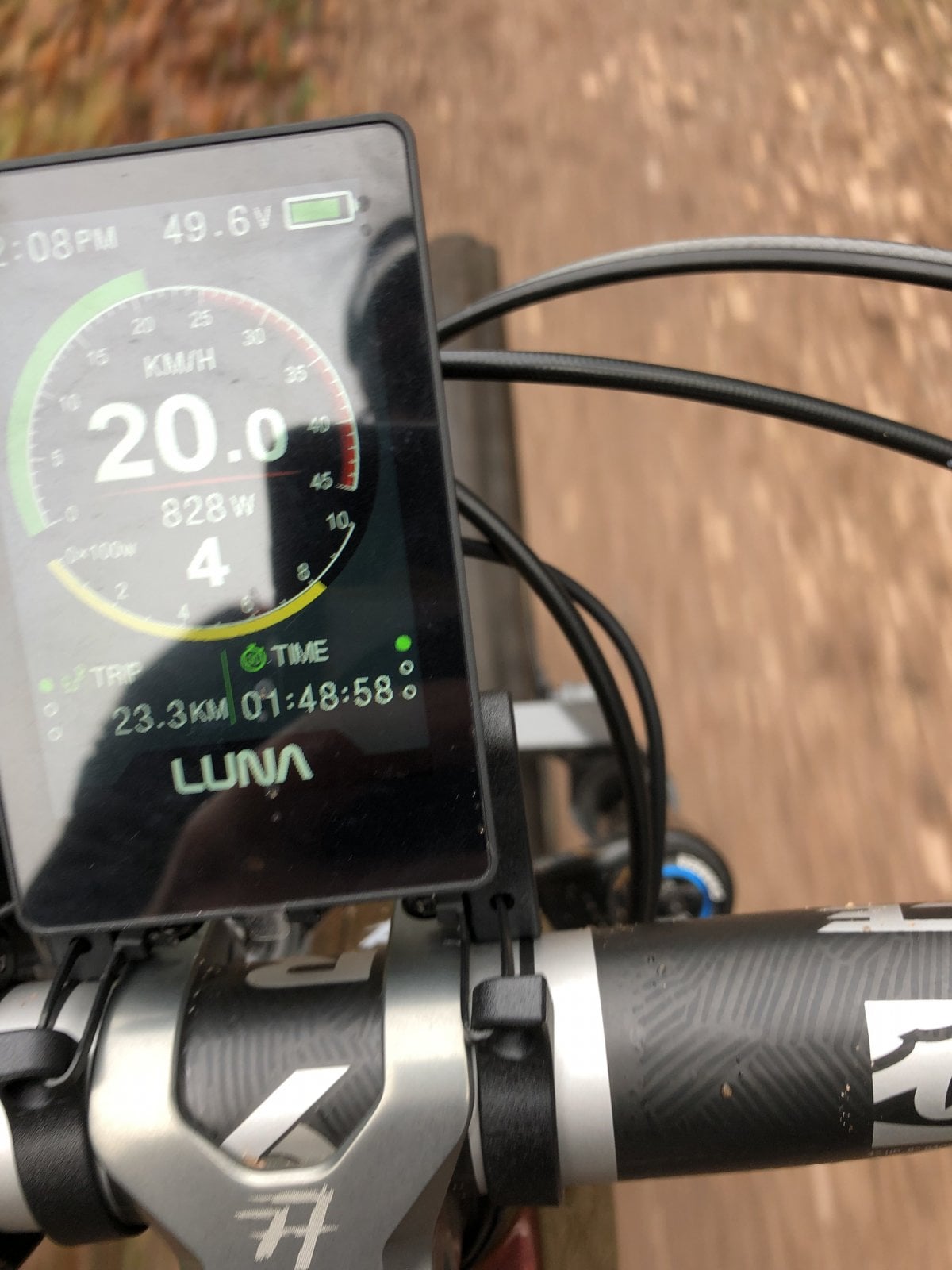

youre using a different monitor?
Yes that is the bafang 860 C display from Luna for the M 600. It is better for my old eyes ?youre using a different monitor?
Nice. How much?Yes that is the bafang 860 C display from Luna for the M 600. It is better for my old eyes ?
M600 LUNA Full Color Display 860c With Removable Selector
95 US $ and 50 $ shipping ?Nice. How much?
Thanks95 US $ and 50 $ shipping ?
cheaper on ali. Strange luna, shipping to france is more expensive than germany ?95 US $ and 50 $ shipping ?
Thank´s, I used this adapter:Nice bike!
Which adapter did you use to fit the magura e-stop caliper with the 220 disc to the Zeb fork?
Does this frame accept m600 too? Are all the frames compatible for both. Or do you need some adapter of some sort?
The 500 and 600 use the same mountings. It's long, but there's an E10 Discussion thread in the DIY section which is worth a read.Does this frame accept m600 too?
I am just here for that scale - quite the bit of kit - for weighing fish isn't it?

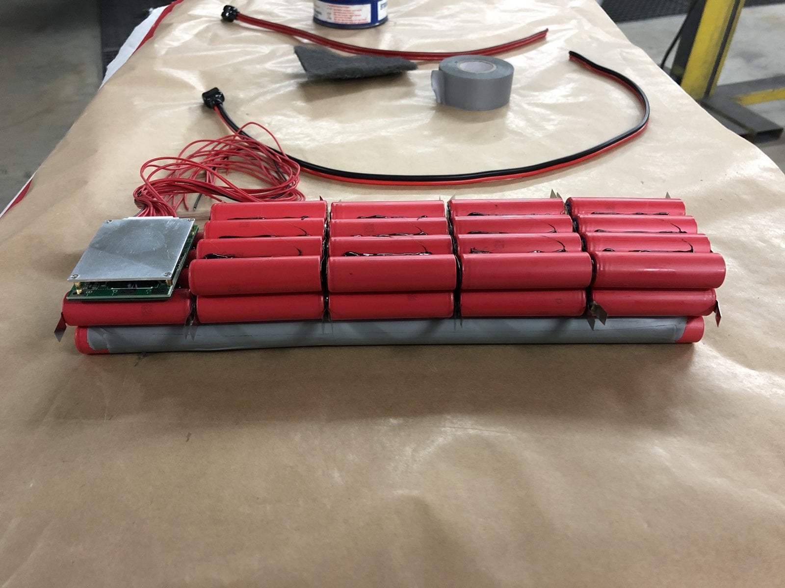

Luv to see your battery recipe if you don't mind! Thanks in advanceYes, in 19". I still had the M600 and the battery was built by myself.

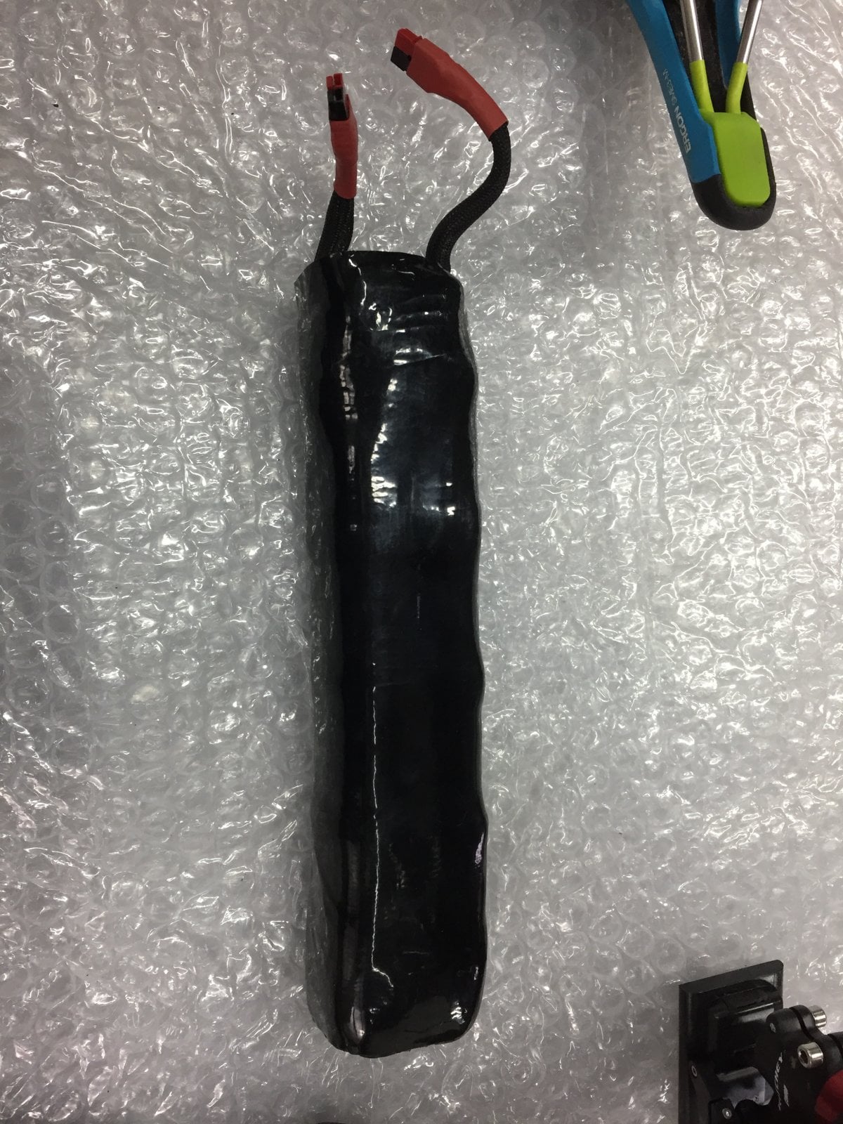

wow looks do able, I might try it if I can find these parts in the USA. Would you mind listing the parts? Much appreciate it!Drives like a dream, had flattened the steering angle by 1.5 degrees and with the power of the 600er, things really get going! Here are a few more photos of the battery:
I connected it with PowerPole to the Motor
56x Sanyo/Panasonic NCR18650GA 3,6V - 3,7V 3500mAh *Lötfahne U | akkuteile.dewow looks do able, I might try it if I can find these parts in the USA. Would you mind listing the parts? Much appreciate it!
