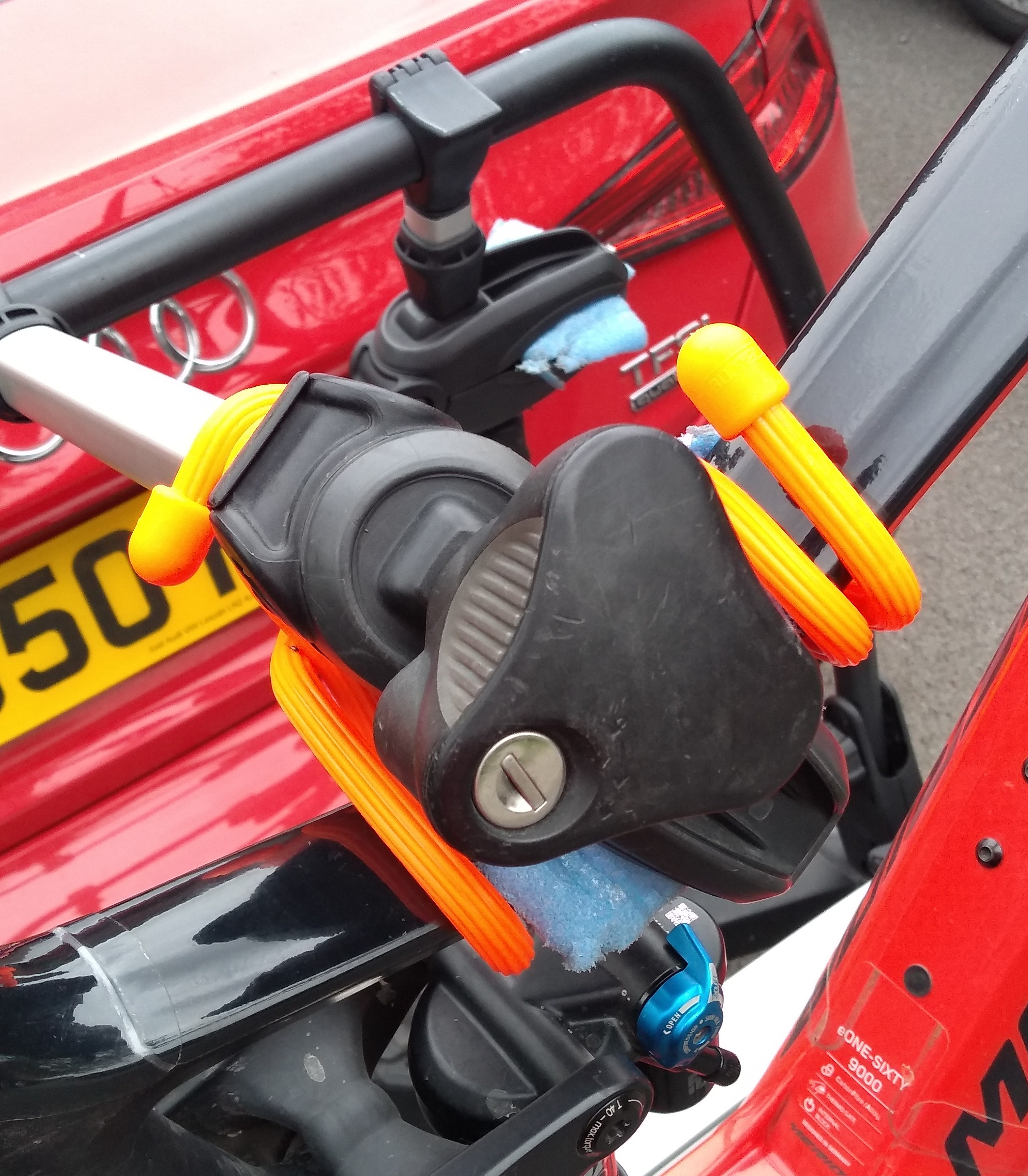

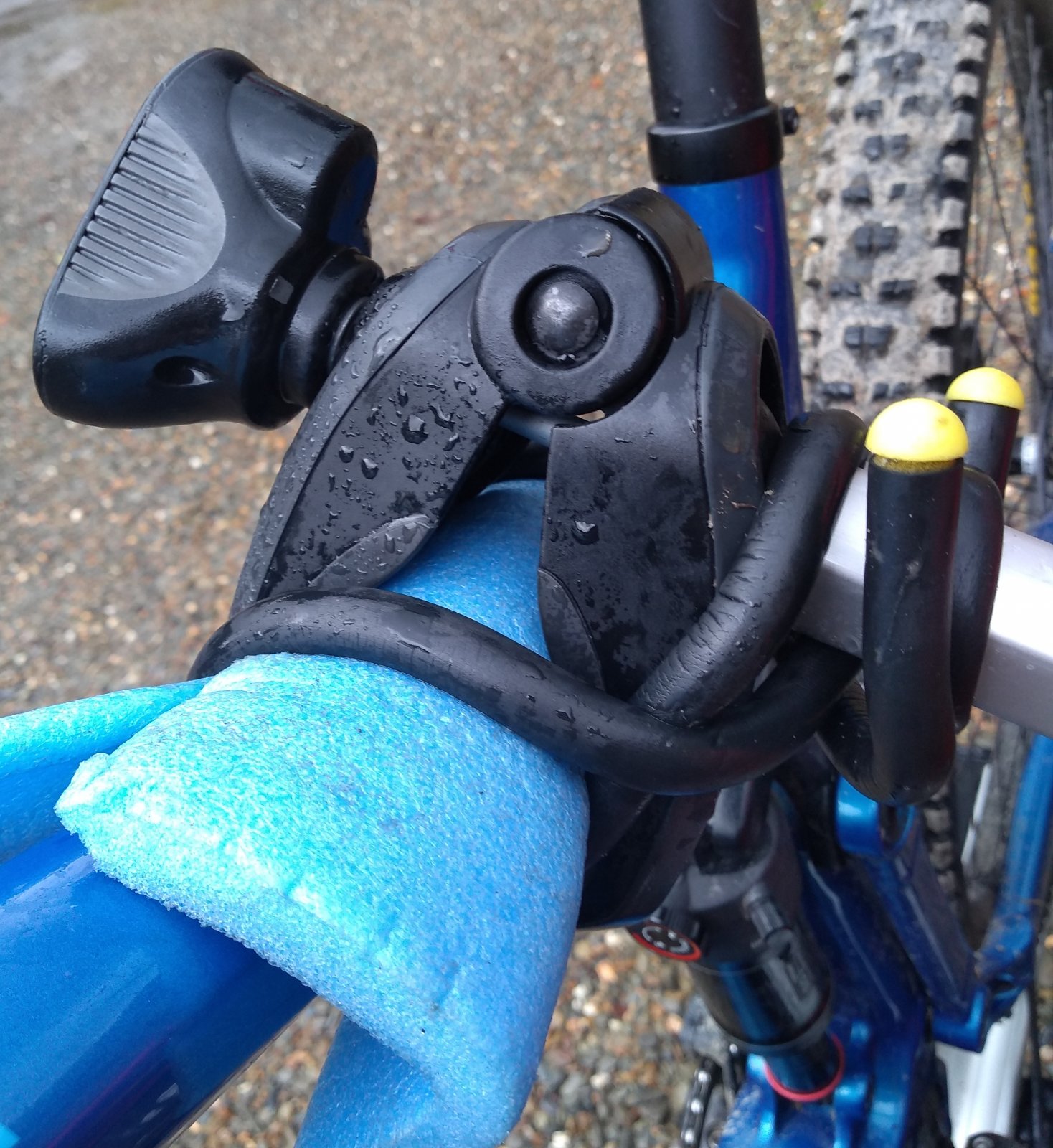

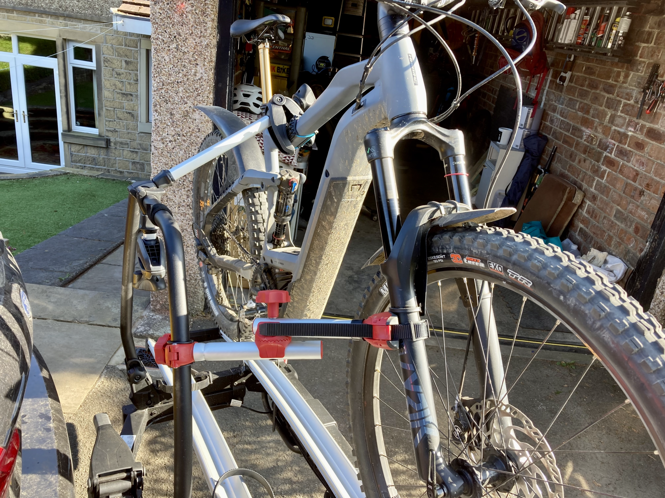

These are the ties I am using now. At least I now have a product name now. "Gear Tie" by Nite Ize. The "Mega Twist 32" length is the longest and strongest one they sell and one is just long enough to do what you see in the picture in post #28 above.

We’ve been using this rack for a few years now with no issues.
Review - Thule Easy Fold XT .
I might be a bit concerned if we were constantly traveling up/down a mountain on gravelly roads. Highways or paved roads don’t seem to be a problem but I do the shake-test at any and every watering break 😉.
The main reason for this model was the size when its not in use. Folds up and wheels under the bench like a piece of luggage. Holds 2 eMTB’s with up to a 55” wheel base. Like Steve said, the wheel straps are surprisingly strong.
I orient the bars so the clamps grab the seat post frame rather than pinch the top tube. This method seems to ensure less chance of accidental slippage from the constant vibration. The locking mechanism seems to work fine (three) , but I still do the shake-test.
Parking lots are not that friendly and having always driven full-sized pickup trucks I’m use to taking a longer walk for a water break. But I still constantly check the side mirrors for a rear view of 2 tires extending past the taillights.

I also have that Thule easy fold. Although it was bought at least 4 years ago so probably not the newest model.
I was concerned when I read this thread that it had failed to hold the bike.
I have used my Thule platform for my e-mtb’s ever since I bought it and I have never had any issues.
I have been driving on gravel roads with bumps. Been driving on highways in up to 150km per hour (obviously speeding like I sadly tend to do by nature) and been driving on basically all roads one could think of. No issues.
I always make sure that I fasten the clamp all the way to I get those clicks telling me it will not fasten more. Then I lock it. I also ofc use the wheel clamps. I do clamp on to the upper bar of the bike (forgot what it is called). The bar that crush your balls if you should slide off your seat;)
I would never dream of adding anything in between the clamp and the frame as I would be afraid of slippage. But I don’t have carbon bikes so this is something I have not thought about.
I do have carbon rims, but I guess the plastic wheel straps don’t mess up the carbon wheels even if they are pretty tighten (the tyres are getting compressed as if I was sitting on the bike)
I could however secure the bike to that metal bar that’s part of the platform. For extra safety ofc. Maybe just zip tie the frame to that bar. It should be sufficient.

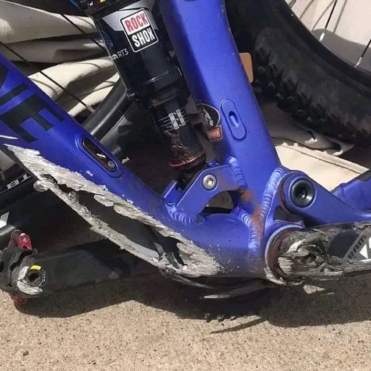

Ive found the Thule folding rack very convenient as you can keep it in the boot for when needed, good for ringing home for a lift home after a post ride beverage etc😆 . However I did have an incident where the top clamp came of and I dragged the bike wearing the bars down, good news was the wheel straps never let go. The damage was worth more than than bike so it was written off unfortunately. I bought a new bike that is slacker and longer so doesn’t have much room on the Thule, I now add extra straps just in case!. I am considering a velocirax but it would end up on the car permanently which is no where near as convenient. Anyone else use a vertical one and have any pros or cons? Cheers
