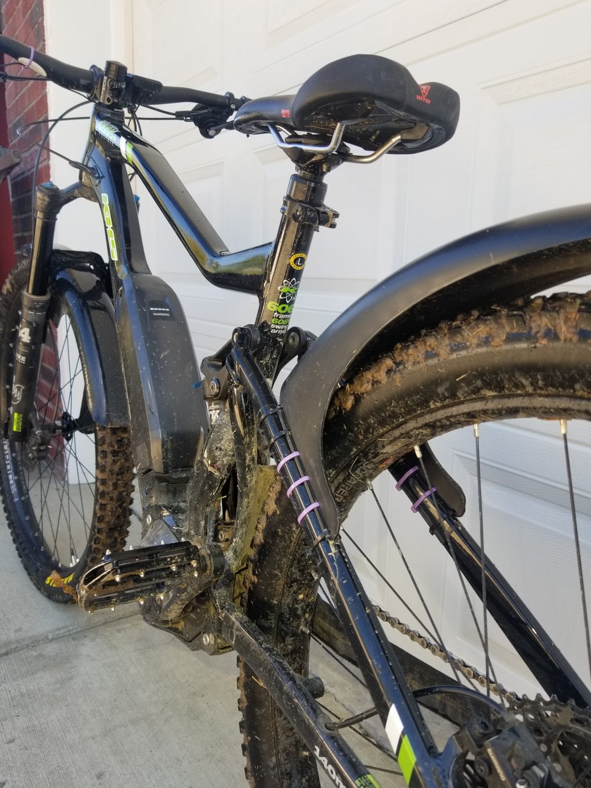

I noticed the rear ate through the tape in just a few days on the trance, so when I afixed it to the voltiac I used all the zip tie holes. I know it sucks but I dont leave it on. I check the forecast and take the the rear fender off once dry ground is on the way.
My plan is the modify the rear fender mount a bit by drilling some holes above the small flange and mount the bottom flange of the fender to the lower side of the upper chainstay, using the zip ties to pull the fender againts entire height of the chainstay.This will eliminate the pressure points by creating at least 10 times the mounting surface area. I'll send pics once I'm done. Its gonna be simple...eek. I never learn.

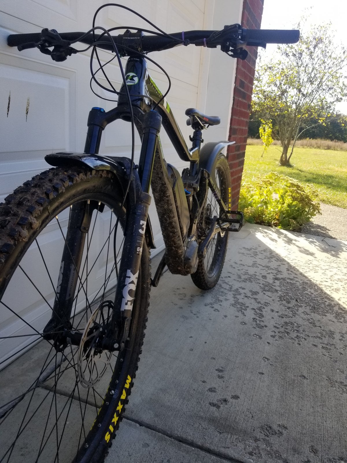

This combo works in spades though. My ride today had both tires totally 100% plugged up with thick tacky Kentucky clay. To clear the mud I rode a mile in wet grass. Here are the after pics. View attachment 20221 View attachment 20222 View attachment 20223

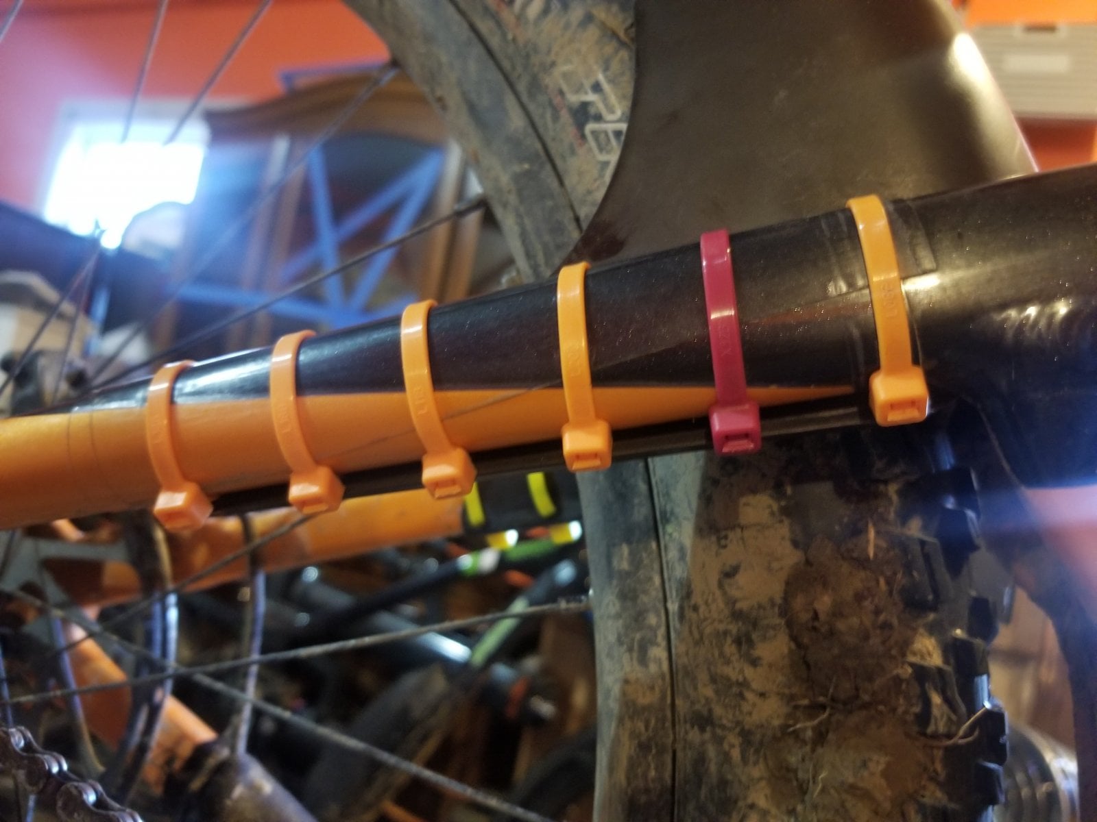

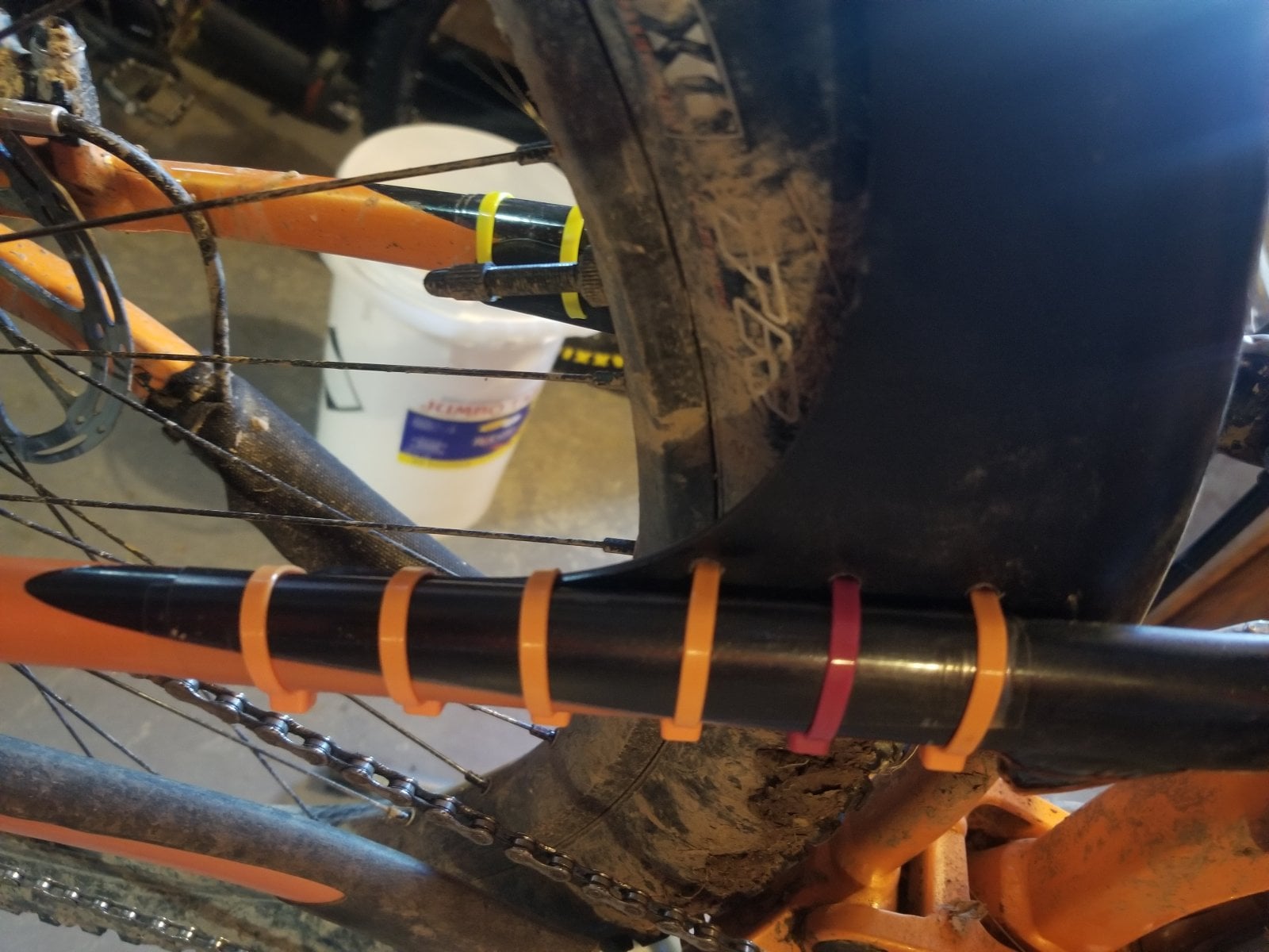

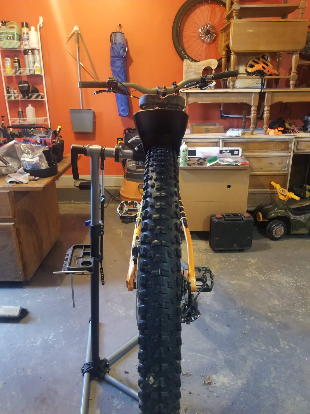

Here is my new fender mounting. Forgive the odd yellow and magenta zipties; the nearest hardware store is 28 miles round trip, so I used what was left in the bag.
I dont like the way the OEM instructions mount the fender on top if the chainstay so I tried something a little different.
I drilled 3 holes in the fender and align the flange at the bottom. Its definitely a better fit and the fender self aligned on Trance.
Zoomed in you can see the holes I drilled.
Flange is now under the chainstay and the contact point is much wider.
After pulling the zipties snug, I noticed the fender actually self aligned.
I ride it later to see if stays put any better.

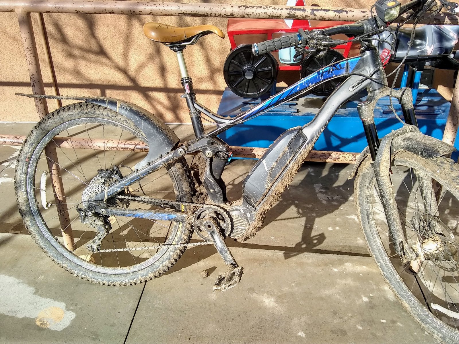

Also running the RRP Max front and Mudhugger 29er rear. My only complaints:
* they're short of full coverage
* the rear can contact the ground when wheeling the bike around vertically on its back wheel
* I've broke the rear's zip-ties twice from accidentally kicking it, while swinging my leg over to mount onto the bike
I leave them on permanently. The included zip-ties broke from the first kick within the first couple weeks; 50 lb rated replacements lasted about 6-8 months. Haven't felt like trimming the length yet, but it probably would be a minimal amount (15mm maybe). Thought many times about making a DIY extension that covered the area between the seat stays and BB pivot area, and also a flap that went further down behind the front tire, but haven't been motivated to bother.
