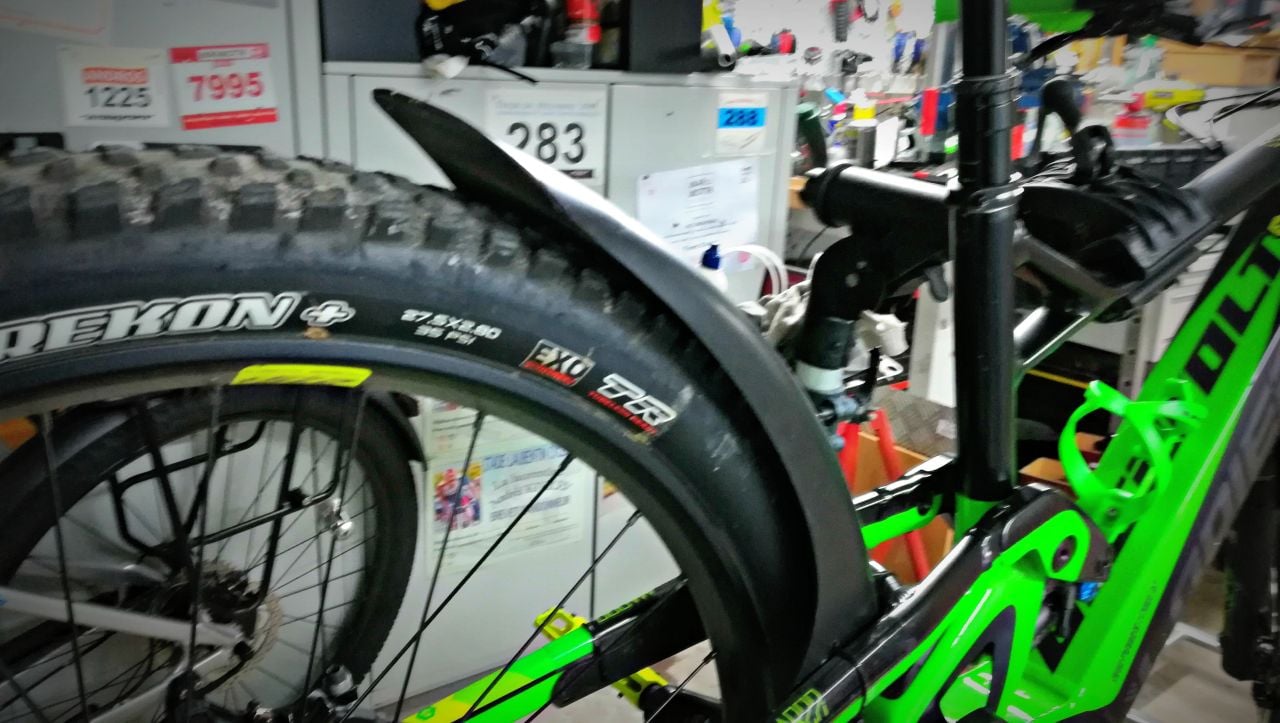

I think the rear Mudhugger looks absolutely hideous when installed on top of the rear fork, so I put it inside instead, after widening and modifying it a bit with a heat gun. Also cut it shorter.
I've had no clearance issues using two separate tire/wheelsets, 40 mm ID rim with 2.80 G-Ones and 35 mm ID rims with 2.80 Rekon+ @rear.
Not being rude but you basically cut the most needed parts off , modified for looks but it no longer does its job ? Each to their own I guess still better than nothing

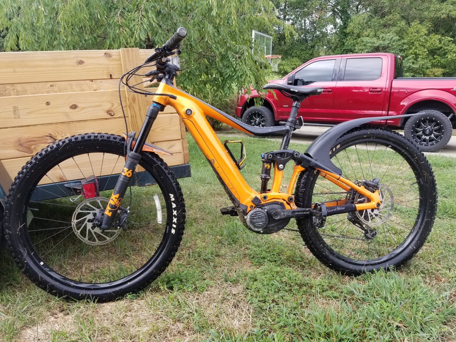

On my Levo I use the RRP Enduro front guard and my own design rear guard. I have also used the Mudhugger FRX (front guard) on the rear....with about 25mm cut off the front of it. That worked ok but is very close fitting so probably not the best for claggy mud conditions. I am more interested in bike than personal protection and the front RRP protects the stanchions and dust seals whilst my diy rear guard protects the pivot bearings rear shock and dropper.

The more coverage the mudguard provides the greater the force exerted on the fixings especially if those forces act at a distance from the fixing point. Normally on full mudguards there are 2 fixing points a distance apart. I took that into account with my diy rear mudguard .....it is straight so does not sit close to the tyre other than near the fixing point.
