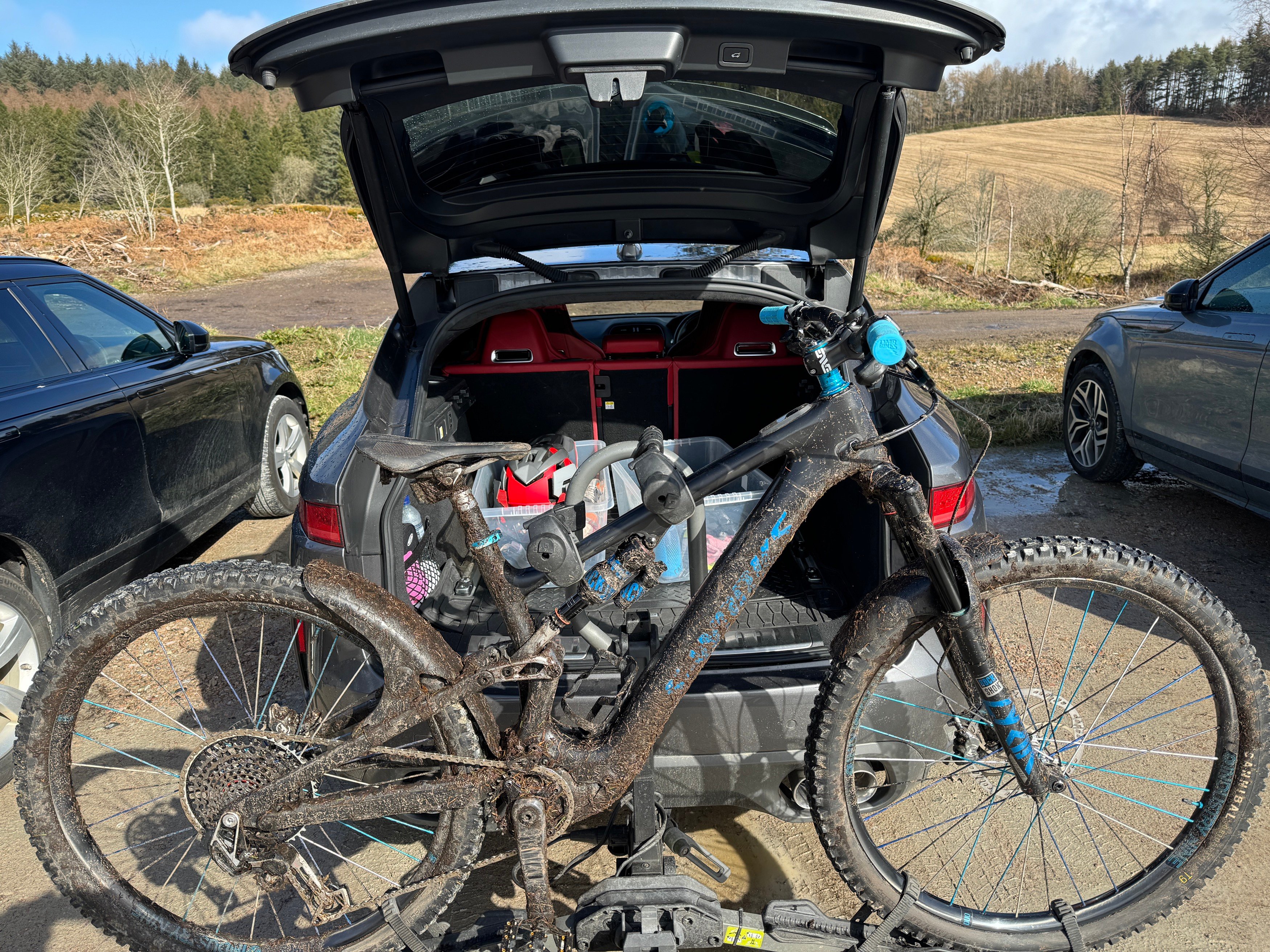

Here’s my bike after a short ride round a local trail. About 12 miles in just over an hour… and this is what the bike looks like.
I’m afraid leaving it to dry and brushing it off isn’t really an option. The cassette and rear mech are full of crud!
Before I went and bought 5L of Halfords own car soap, I thought I’d test the effectivity of car soap… so put 2 caps of Autoglym in a spray bottle with 2L of water, and mixed it up.
Sprayed it all over the bike and left it for 5 mins. When hosing it off, most of the dirt remained.
I then went back over it all with MucOff spray, left it for 5 mins, then hosed it off. The bike was clean!
Genuinely don’t know what’s in MucOff, but it’s very effective!
