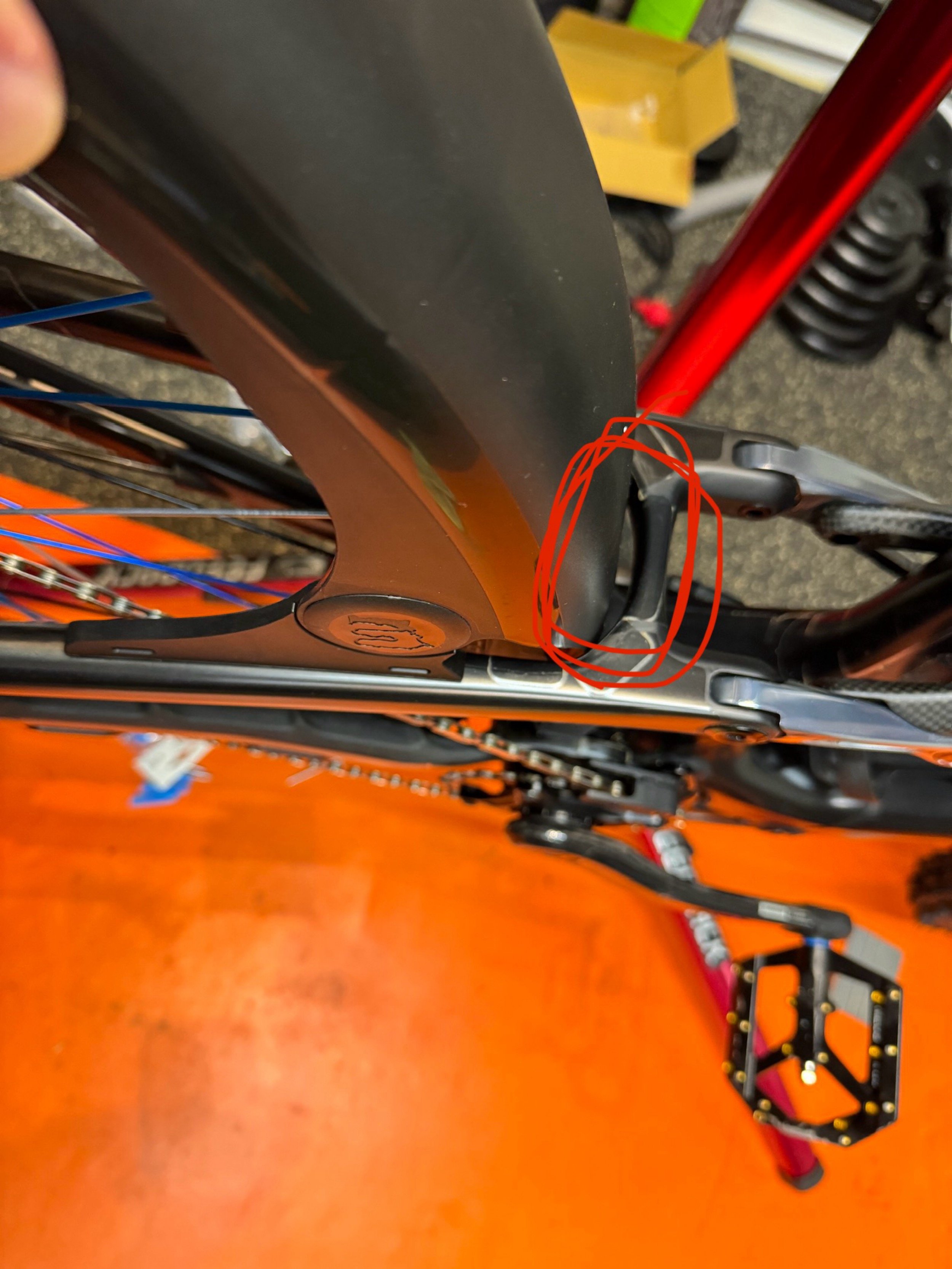

I bought the Mucky Nuts Rear Mudguard (Eco savvy Mudguards, Custom Fenders and Frame Protection for Mountain Bikes | MTB | DH | Enduro | XC | Fat Bike | Road Bike) in the Black Friday sale. Between one thing and another, I’ve never got round to fitting it. I was going to pop it on just now before going out, but I feel like I’m missing something.
I’ve lined up the 2 bits that attach to my frame with the main part of the guard. I could use the Velcro straps provided, but would probably use some zip ties for a better grip. It seems that no matter which I use, a few bumps on the bike - and the guard is going to start sliding down towards the tyre.
I’ve had a few rear guards in the past, but they’ve always had holes to put zip ties to attach them to the bar at the top of the seat stays… to stop it slipping.
Had anyone fitted one, and have the issue I’m predicting… or does it all work fine? There isn’t much clearance between my rear tyre and the guard because of the bar across the seat stay.
I was also considering warming the circled part of the guard up with a heat gun, and moulding it more into the shape of my seat stay to give it a better fit?

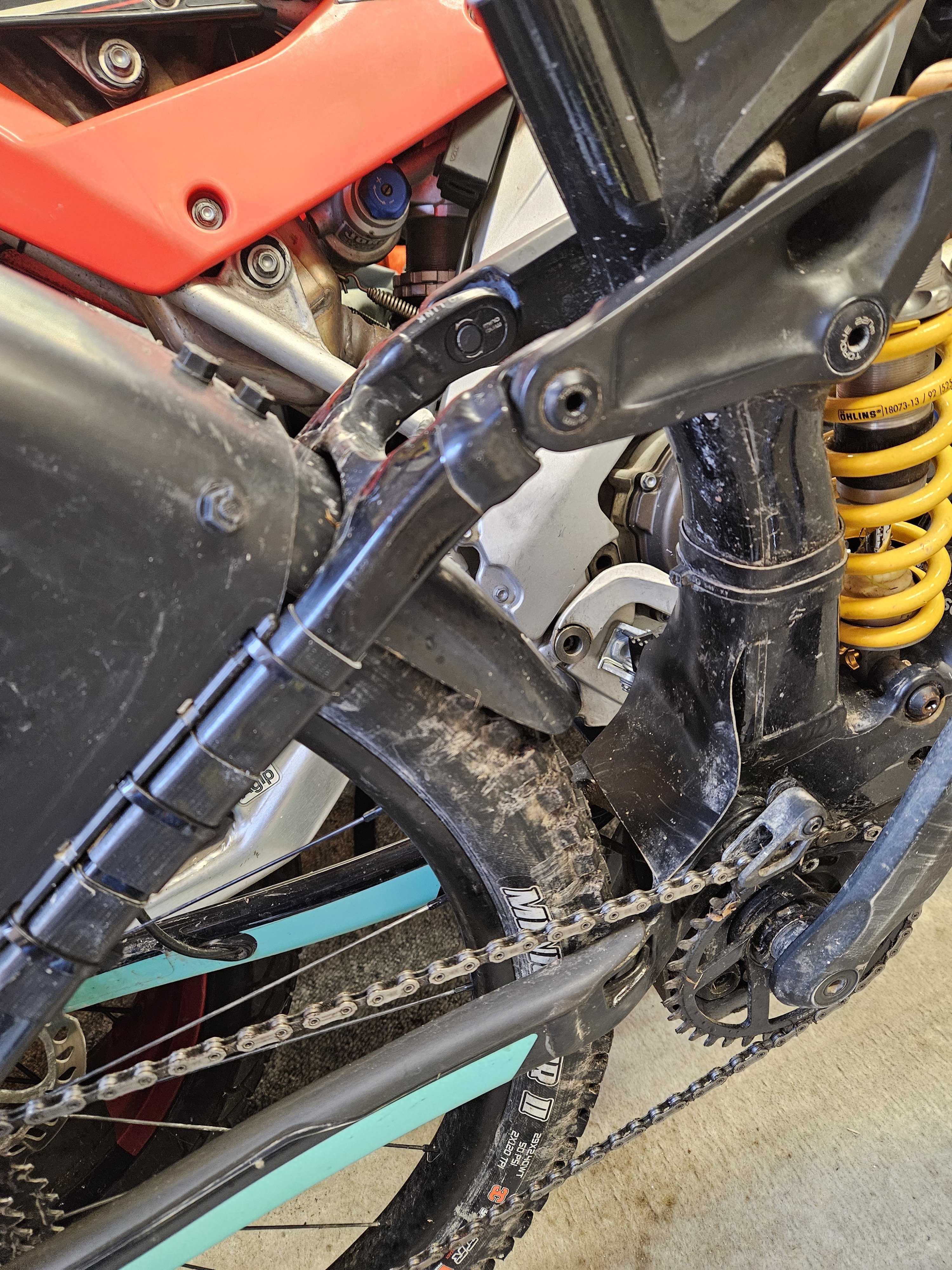

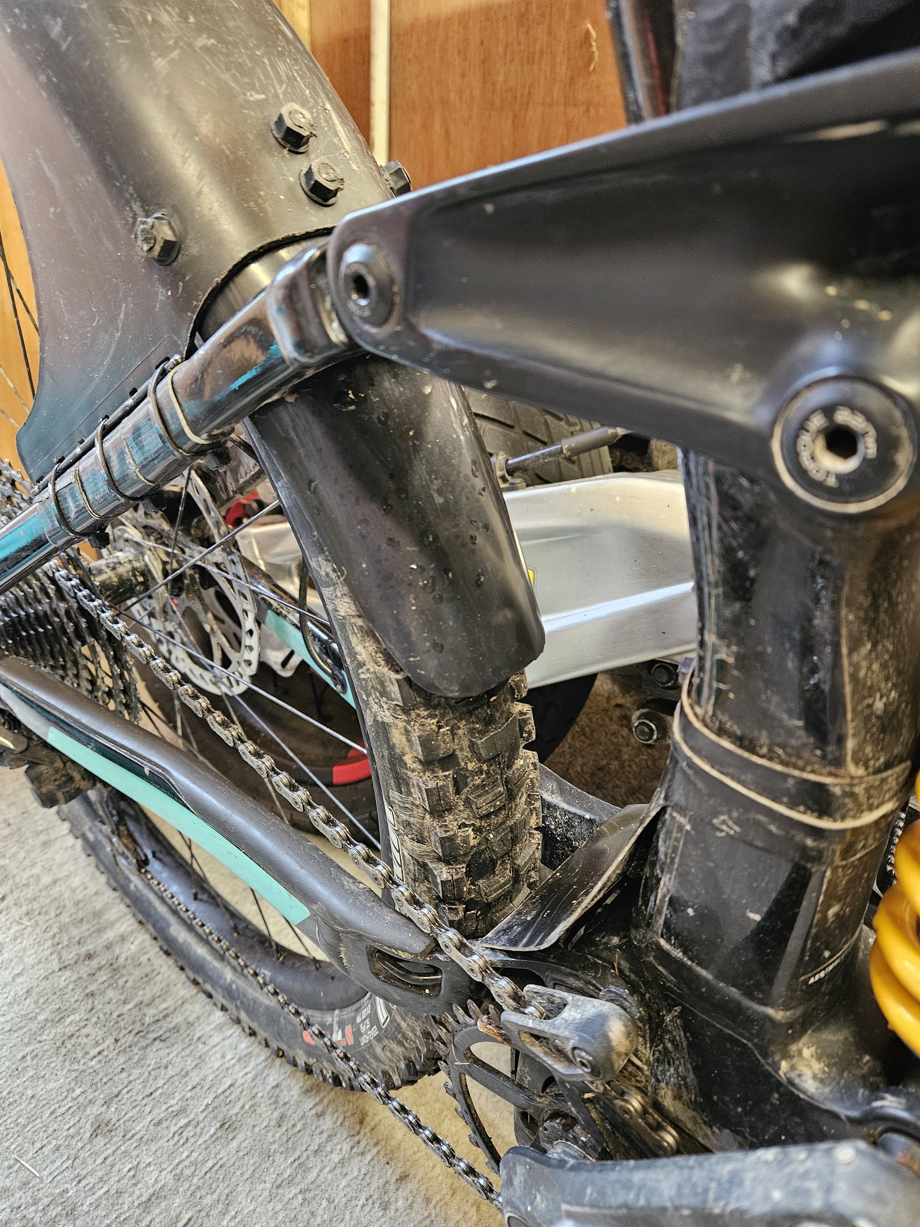

Didn't like the new rear Mudhuggger with the extension because the extension goes over the cross stay so crap will accumulate behind it.
So modified our rear Mudhuggers by attaching the cut off front of spare old mudguards to go under the cross stay. Didn't fit too well so reprofiled the new parts to fit nicely using boiling water. Didn't get clever about attaching to the rear Mudhuggers, just used black plastic number plate bolts. Been tested in some serious mud and works great. Made our shit flaps cut out of 2mm neoprene sheet and held by a cable tie.

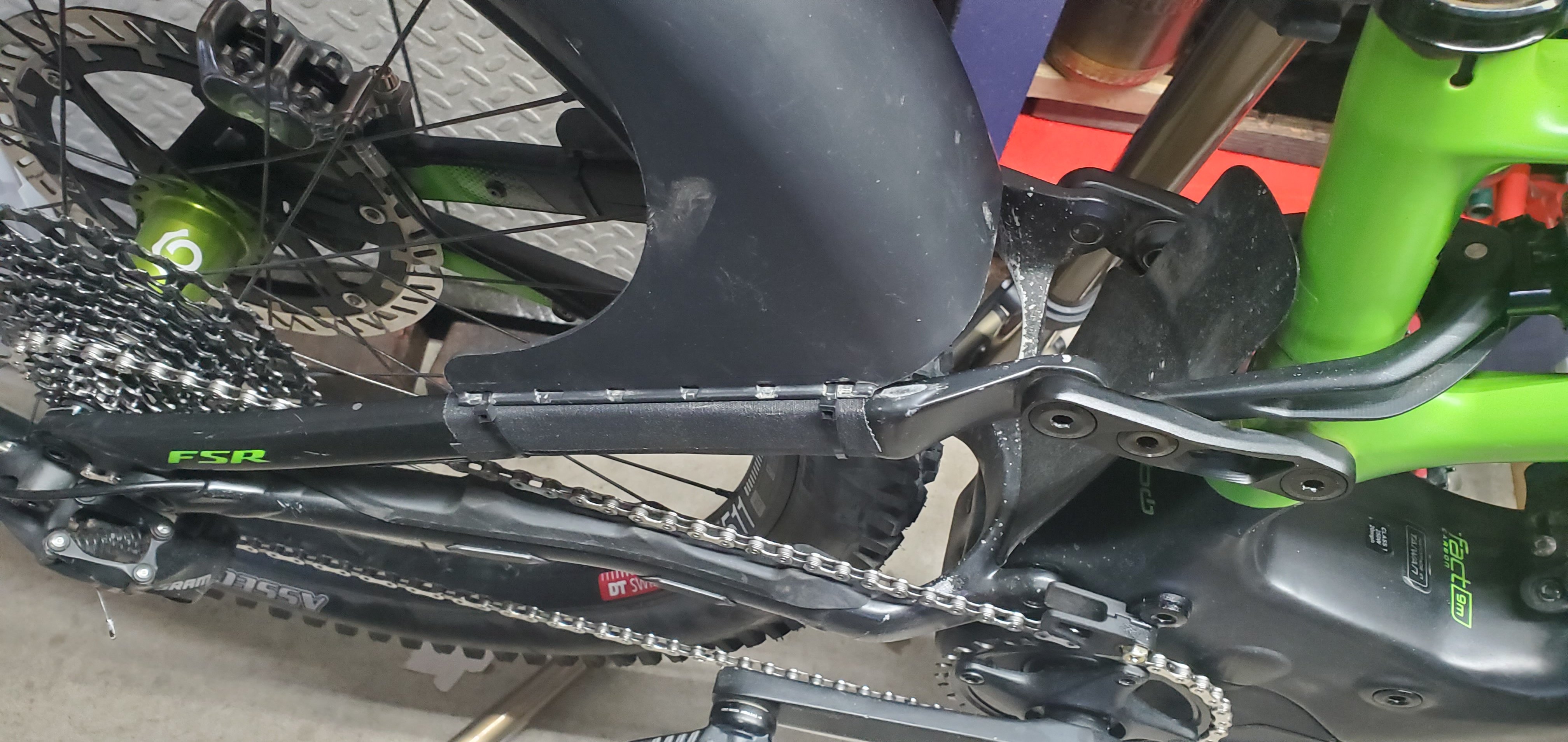

I use the Mudhugger FRX front muguard, as a rear mudguard all year round. It goes from chainstays cross member to about the top of the rear wheel. In the winter I fit the large rear Mudhugger over the top of the FRX and attach it with reuseable zip ties. I decide before each ride whether to take the large Mudhugger off or leave it on......either way its a 2 minute job.
The Mucky Nutz fits on the seat stays in the same way as the large rear Muhugger except the Mudhugger has a larger section that fits the seat stays with 6 zip tie positions. I have found it best to use 5 of those positions to keep the mudguard still. If the Mucky Nutz is used without its extension pieces the 2 zip tie positions may be enough to keep it stable.....i doubt the same would apply with the extension pieces on.
So I suggest you source a rear mudguard such as the Mudhugger FRX and fit that first. Then use the Mucky Nutz over the top of it.

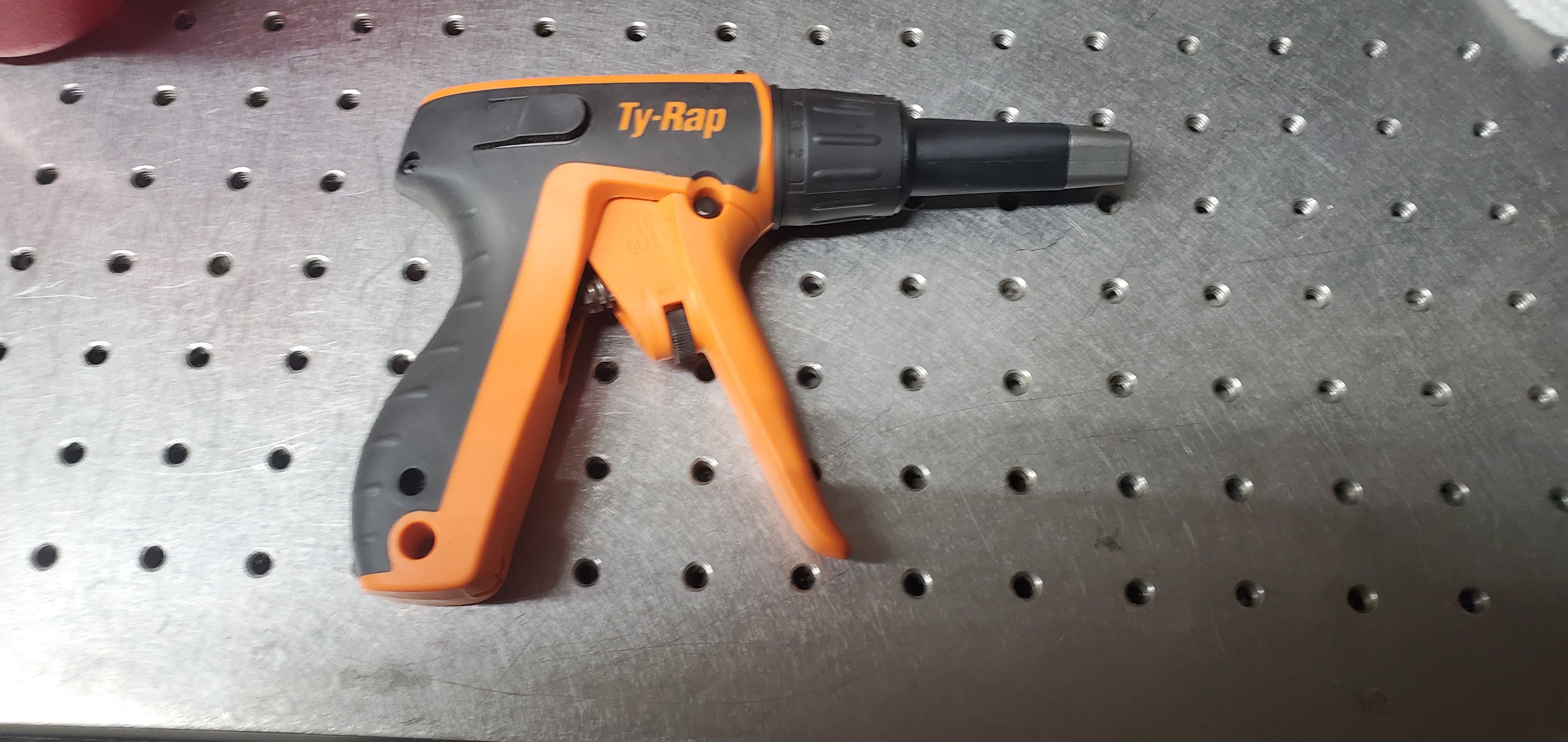

I use 2 tie wraps per side and have never had this similar-design mud guard come off. or even move around a little. I do a lot of DIY car stuff, so I have a proper tie wrap attachment tool. Those wraps are TIGHT!
