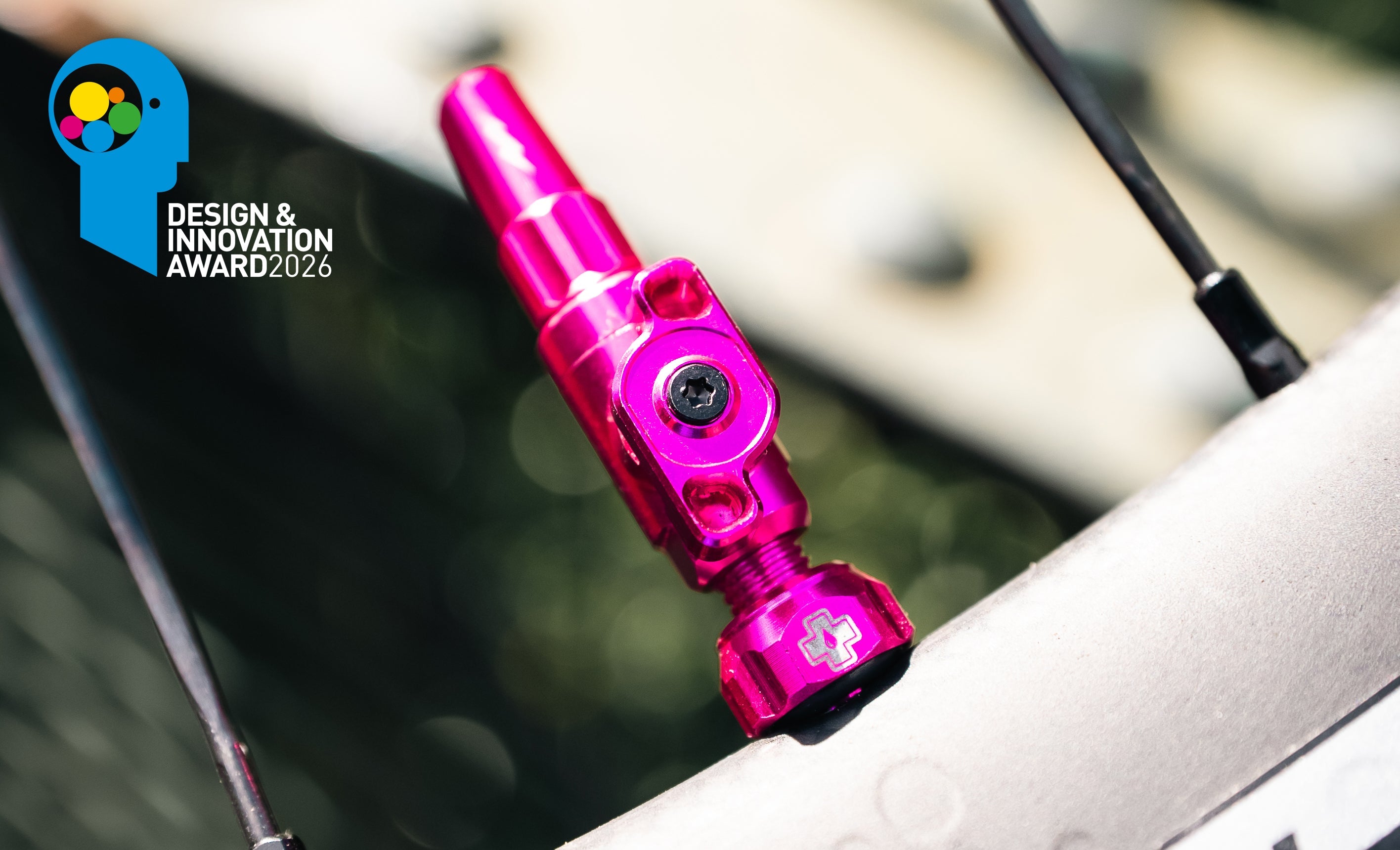

Has anyone fitted a set of these?
Despite always leaving my bike parked with the valves at the bottom, my Presta valves get clogged with sealant on a regular basis. So I like the idea of the new valve from Muc-off. With approx. two and a half times the airflow, of a conventional Presta valve, it also promises to make inflation easier as well as clog less. There is mention of a ball valve (which must be the on/off) but no mention of a non-return valve, so how is the valve used to inflate the tyre and to change pressure afterwards? What stops the air from pissing out after each compression stroke of my pump? I know that these points must have been resolved, but none of the info I have found makes any comment.
Bike Radar have a review, but it is more like a press release than a user review.
And how do I know what stem length I need?
PS: It also seems that they are sold out everywhere, so they must work OK.

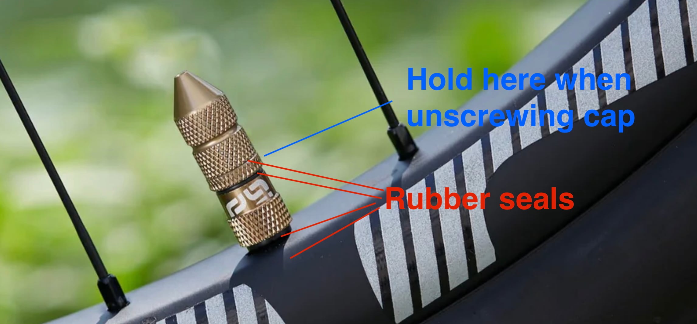

Just to go off topic; Ive just fitted a pair of EThirteen Schrader valves to my enduro bike - didnt want to drill the rims - they fit in the presta hole similar to the set BeBiker mentioned above.
Quick Fill Schrader Tubeless Valve
Those look interesting but isn't there a leakage path through the thread where the first section of the valve stem screws through the rim into the "nut" inside the rim?
Also, what happens if the thread between the first and second part of the valve stem seizes up slightly? Isn't there a risk you end up unscrewing the first part from the nut inside the rim and having to remove the tyre etc to fix?
MrSimmo
Apr 24, 2020
1,096
1,047
The Trail.
I thought the same, there is a rubber seal on the rubber nut that goes on the inside of the rim and also the base section, and then between all of the removable sections (not sure why there is one on the cap but hey ho).
All the sections seem to have the studded (if thats the word) grippy surface so I guess you would hold the right section and unscrew the other.
It seemed to take quite a few turns to get it screwed up to the rim so you would have to loosen it a lot before it came loose.
I'm off to bike park wales with it at the weekend so will give in a proper bashing; if the tyres go flat, they'll be swapped for proper schraders :D
Here's a photo of how it looks on the rim:
