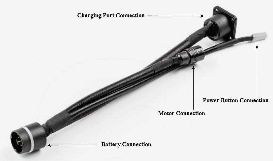

Regarding the main wiring harness on my 2021 Rise Carbon. I tend to ride very rough rocky trails. This type of trail riding tends to cause excess vibration internally between the brake hose, dropper cable housing and wiring harness where they converge in the motor mounting shell. I initially repaired the abraded portions of the wiring harness with cloth electrician's tape. However, by the time I reached 3,200 miles on my Rise, the wiring harness had multiple rub through spots. I replaced the wiring hardness when I sold my Rise to my brother Rich. Replacing the harness is very easy, however you will need to remove the motor from the bike in order to access the connections at the power button, charging port, battery and motor.
2020-2022 Carbon Rise wiring harness

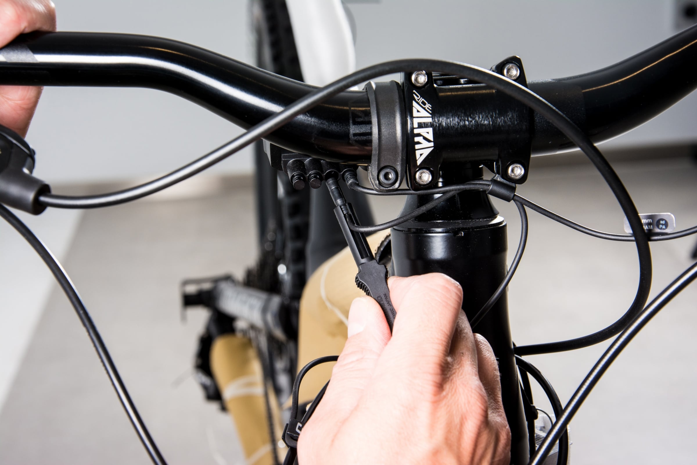

Tomorrow my bike is listed for theatres,I'm going to glove up and go first to that connection located in the head tube. My fork is just back from Silverfish UK (warrantied damper shaft replacement). Hopefully it may be a short operation but yeah I hear you - I'll just poke my nose in a little bit. Some dudes on here post incredible gen !
Mike,

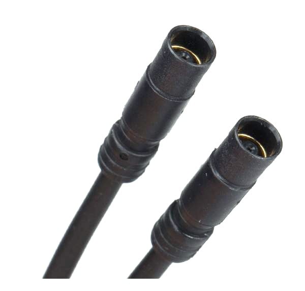

The wired connection will be wrapped inside a foam pad and tucked slightly down into the down tube at the head tube. The exact distance down inside the head tube varies between bikes. You can pull on the head tube wire gentle like and retrieve the foam pad. The pad will contain an the Shimano EW-AD305 adapter. The SD300 motor control wire plugs into one side of the adapter. If your Rise has a EW-EN100 junction box hanging out front on the control cables, then you'll have a SD50 plugs which plugs into the opposite side of the adapter from the SD300 motor control wire. The SD50 wire exits out the head tube and plugs into one side of the junction box. If you have a SC-7000 Shimano black & white computer display the SD50 wire will plug into the back of the SC-7000 black and white display.
This is important: If your Rise came from the factory with a SC-EM800 Shimano color computer display, you will not have a foam pad and adapter located inside the head tube/down tube. If your Rise has the color display, the SD300 motor control wire will travel directly up the down tube, through the head tube, and it will plug directly into the back of the color display. There will be no adapter.
It's extremely easy for the control wires located out front on the bike, to become slightly disconnected. They will appear to be connected but are not. The slight disconnect can happen when you crash on the bike, snag a branch, or are tugging on the bike as you hike-a-bike it up a steep slope or onto a bike rack. Furthermore, I've found that when doing dropper cable work, head set work, removing the fork, or you've got a friend/wife/daughter/son who likes to pull on wires, it's also very easy to slightly disconnect the SD50 wire from the adapter located inside the down tube/head tube (Provided your Rise has the EN100 junction box.)
When troubleshooting the wire disconnect, I've found it's a good practice to unplug each wired connection using a Shimano TL-EW02 wire tool. The SD300 and SD50 wires can be easily damaged when pulling on a wire to remove it from a port, or kinking the wire when trying to re-insert the connection lead back into a port.
The TL-EW02 wire tool has a levered fork on one end of the tool. Shimano SD50 and SD300 wires have a groove around the connection lead. The fork end of the tool is inserted into the groove and used to pry up on the connection lead and remove it from the connection port without damaging the wire.
The other end of the tool has a round tube. The wire connection lead is inserted into the round tube. SD50 and SD300 wire leads have a shoulder. The pipe end of the tool rests against the shoulder on the lead and is used to push the connection lead back into the port without kinking and damaging the wire.
Your Rise should have come with the TL-EW02 tool in the owners kit. If you don't have one, visit your local bike shop. They will usually have one that they can give you. You can also purchase the tool on Amazon.
If you don't have the tool, you can use your fingers to remove or re-install a wire. The connection leads require a little bit of effort to get them to disconnect from a port. The chances of damaging the small wires goes up when using your fingers. Be extra careful.

Mike,
Yip, all good. At least this part of the wiring that is up front. Precisely as you described, foam pad bundle with x2 little zip ties. I separated it all, cleaned and reconnected, used the wire tool that was in the kit provided. It started up first attempt, as normal. Test ride got me about 1k and the fault returned so in the morning I'll check out the motor end. No sweat, yet!
