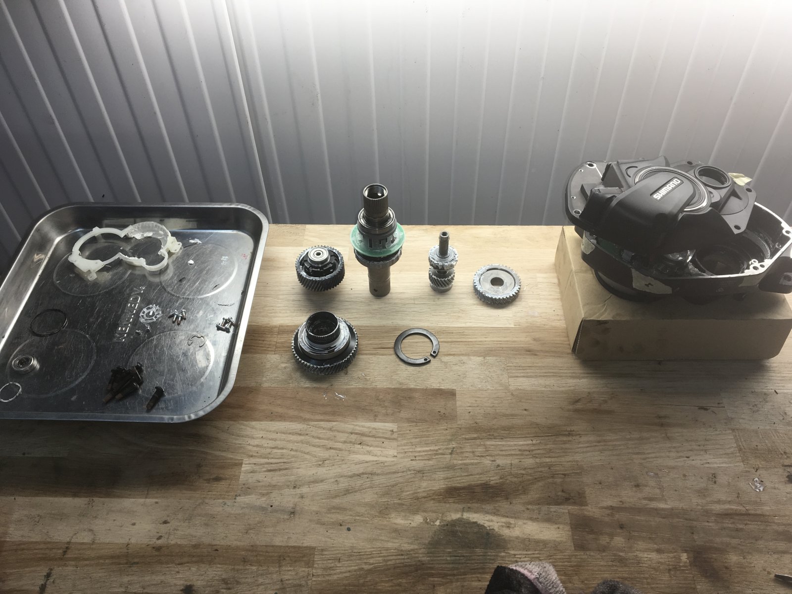

There are issues with the bearings in the 8000 motor unit but you can fix them yourself if you are out of warranty.

I’ve stripped and replaced E8000 bearings
