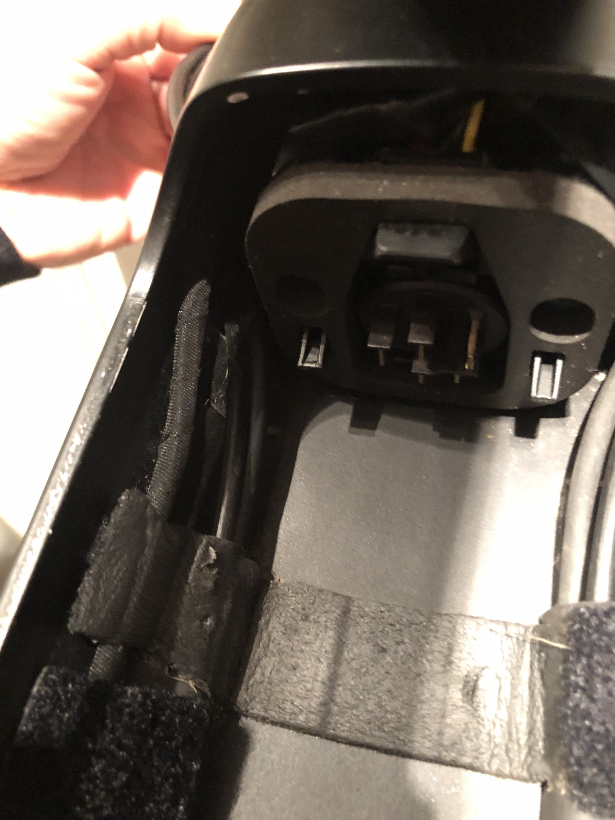

Couple weeks back I received a crash replacement rear triangle for the Crafty. Got it fitted and taken out on a few rides.
A problem that I've had off and on popped up again I've contributed to other things in between having the bike checked out by a somewhat close bosch dealer.
Problem was bike would randomly shut down full good by screen with ride stats and all. I contributed to Gramin speed sensor messing with the rear wheel sensor. Avery magnetic pedals possibly messing with the motor or rear wheel sensor.
I'd remove both and everything would be fine for weeks-months.
Think we found the problem Battery wasn't fully seated in the power connecter to the motor seems mondarker used to thick of a foam cushion to on the connection side and it was only contacting by a few mm. Not the easiest thing to see with the non removable battery.
Not my photo but from reference
