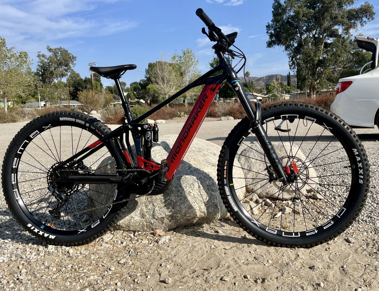

Just picked mine up last month. Had never heard of Mondraker but got to take the Crafty RR on some local trails and knew this bike was for me. This bike is big, long and tall with the 29rs. Once you get over that and can put you weigh on the front bars going down the technical trails it is smooth and solid.

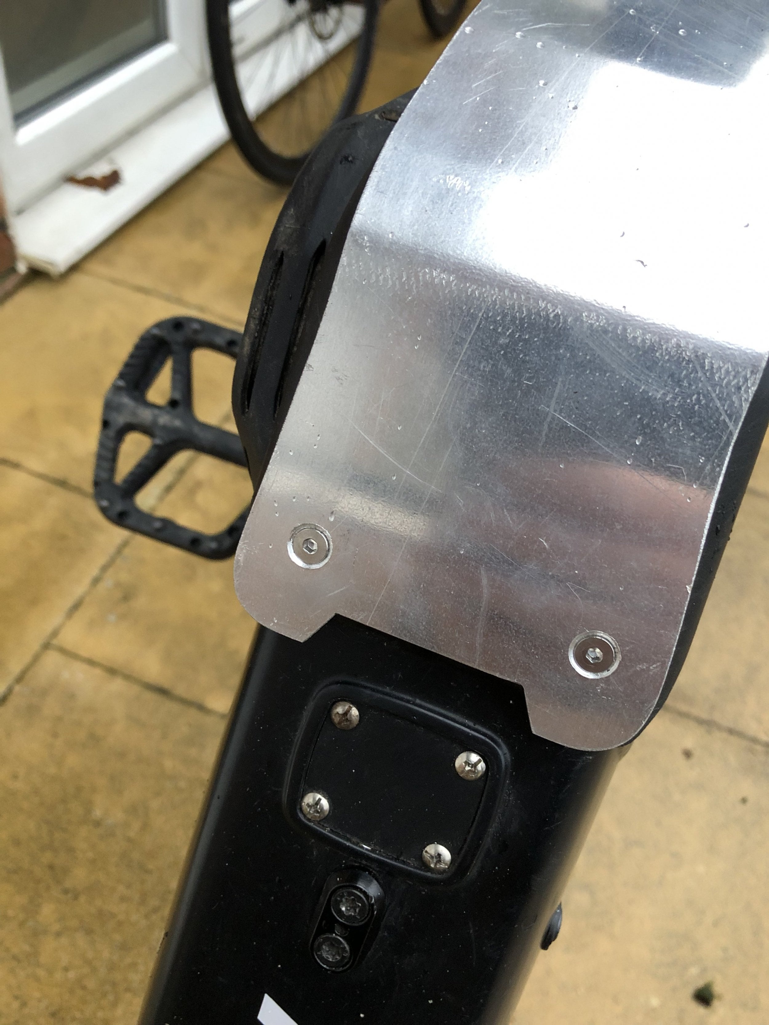

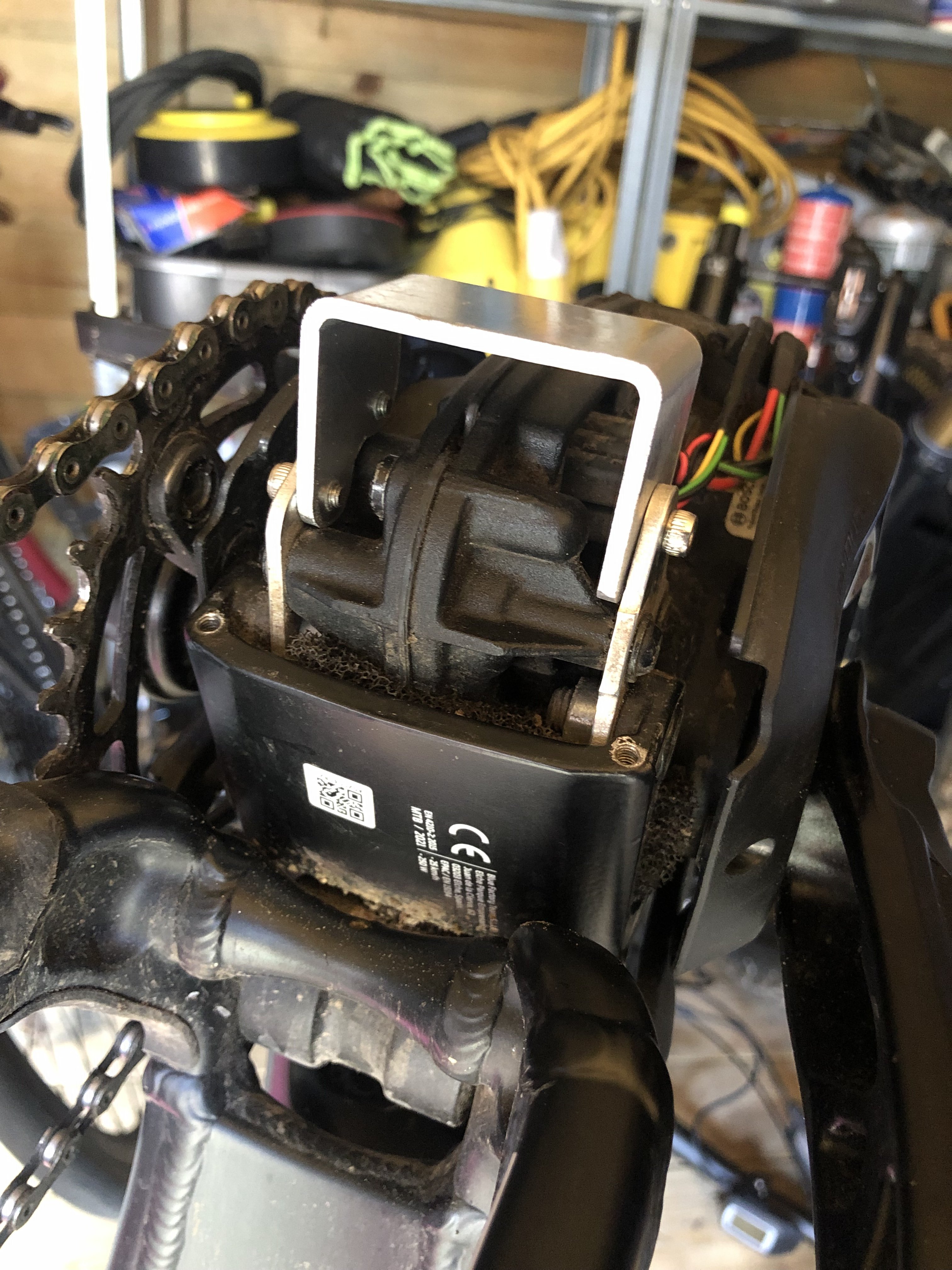

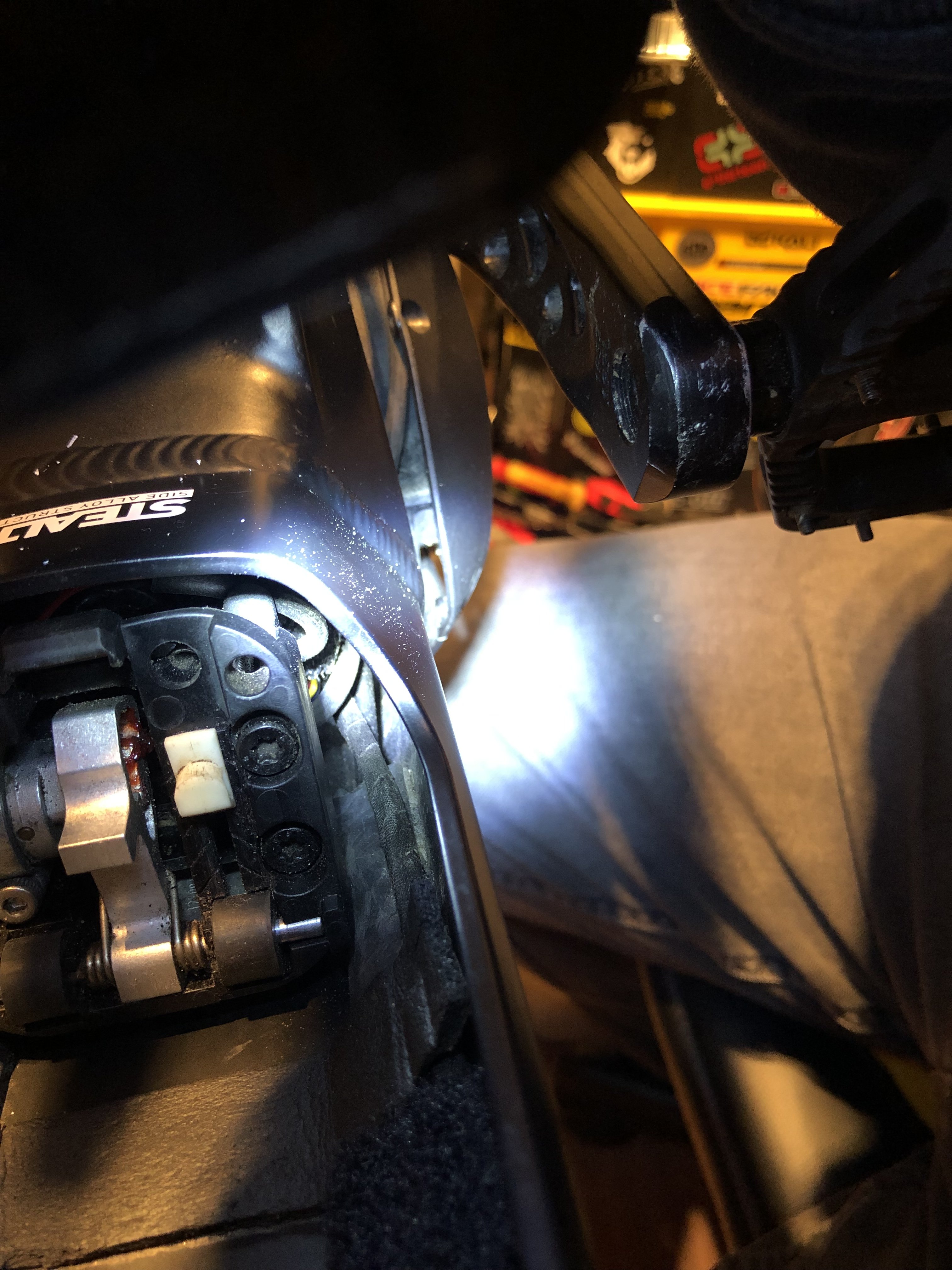

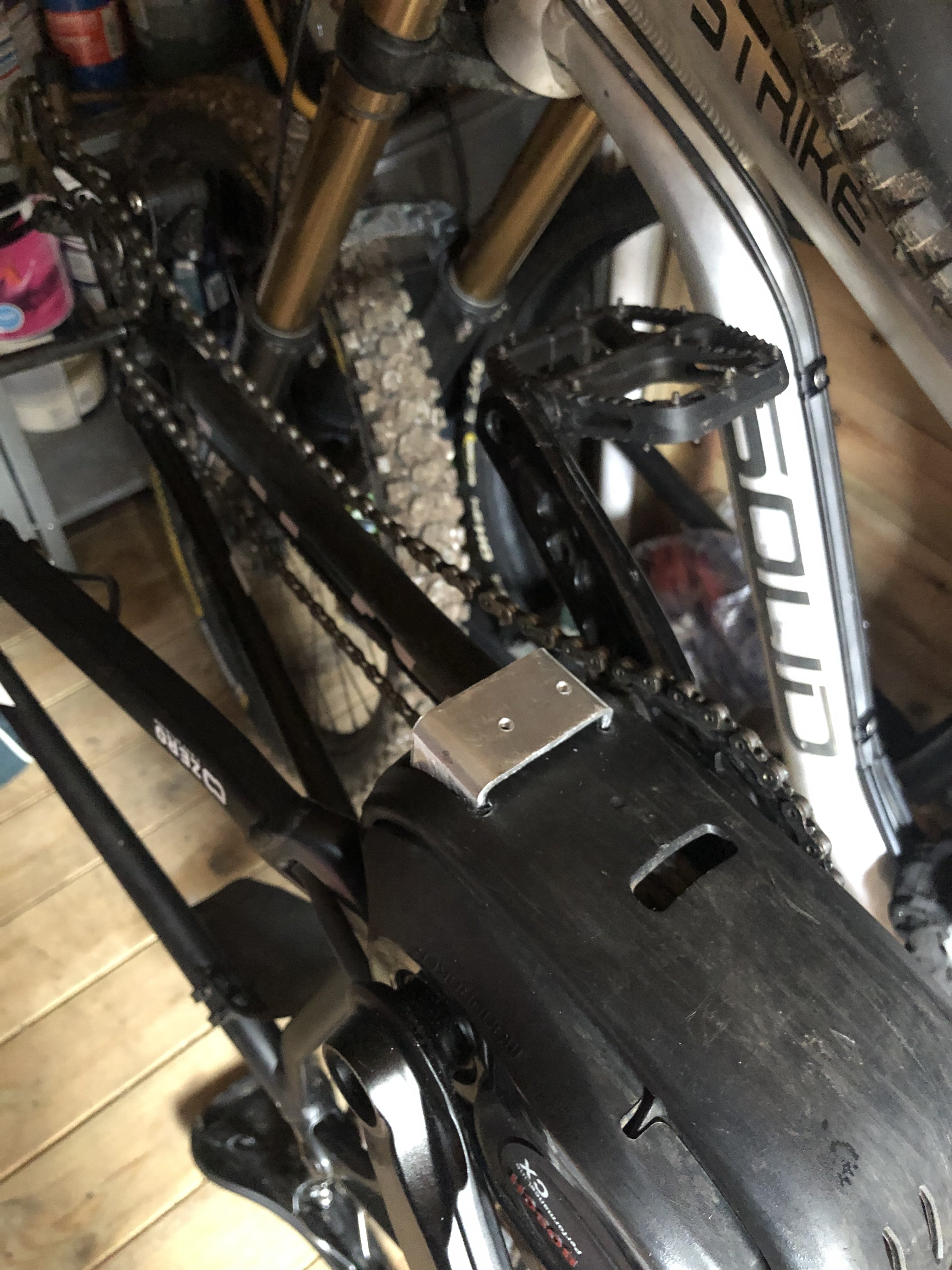

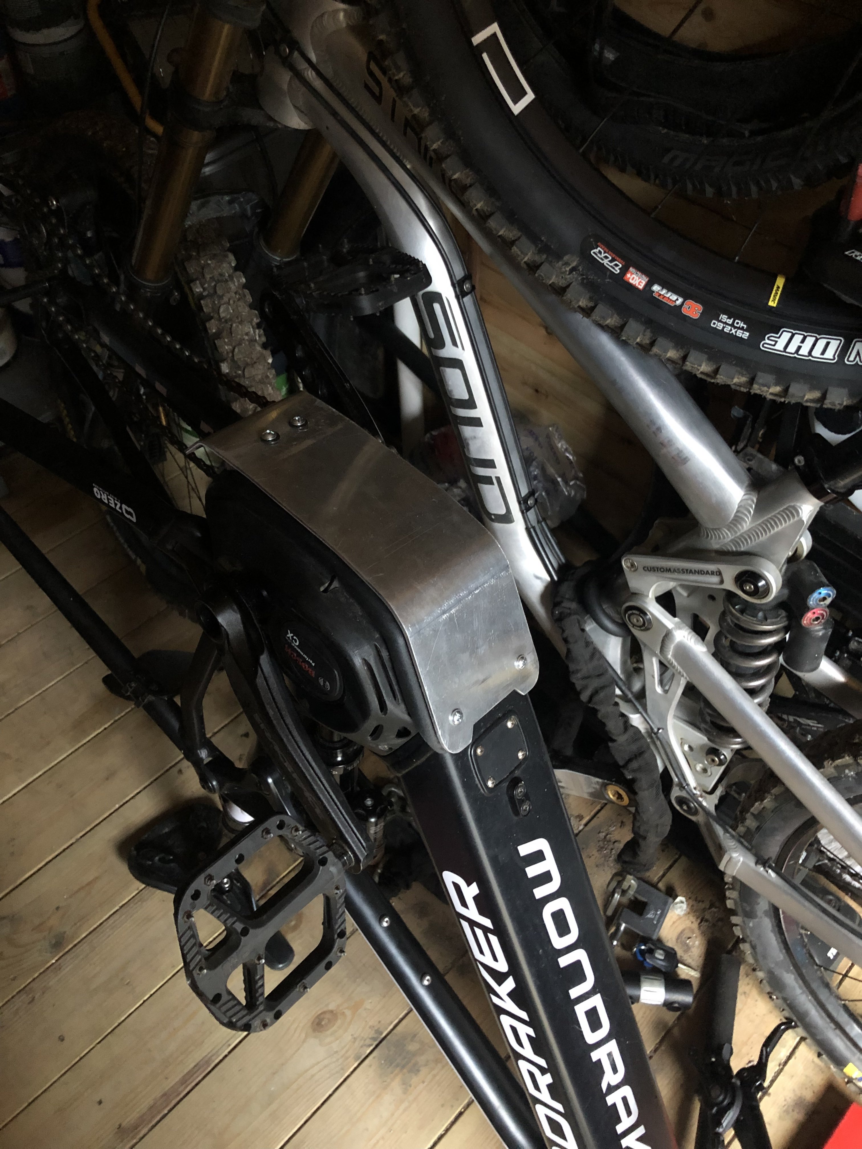

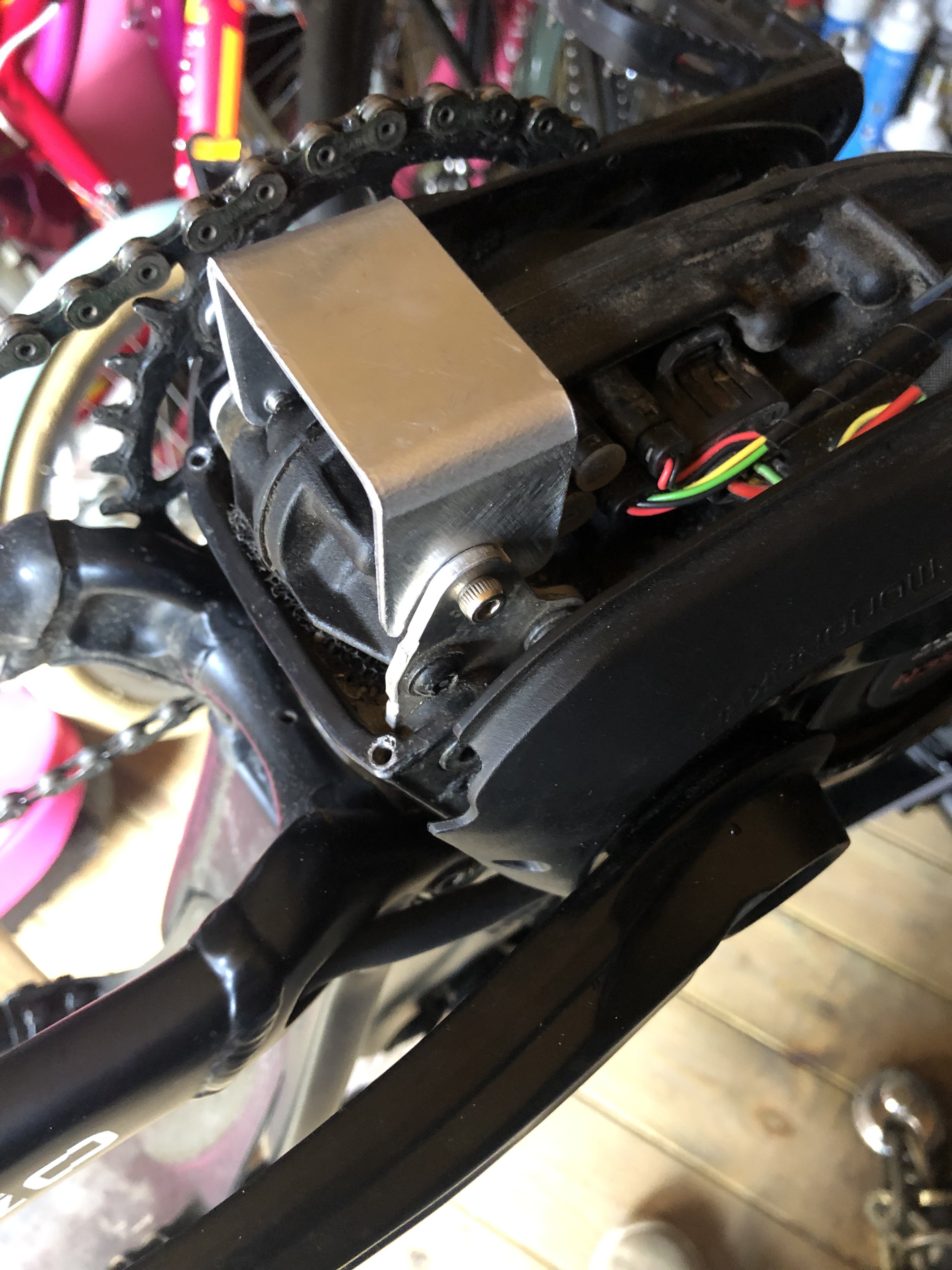

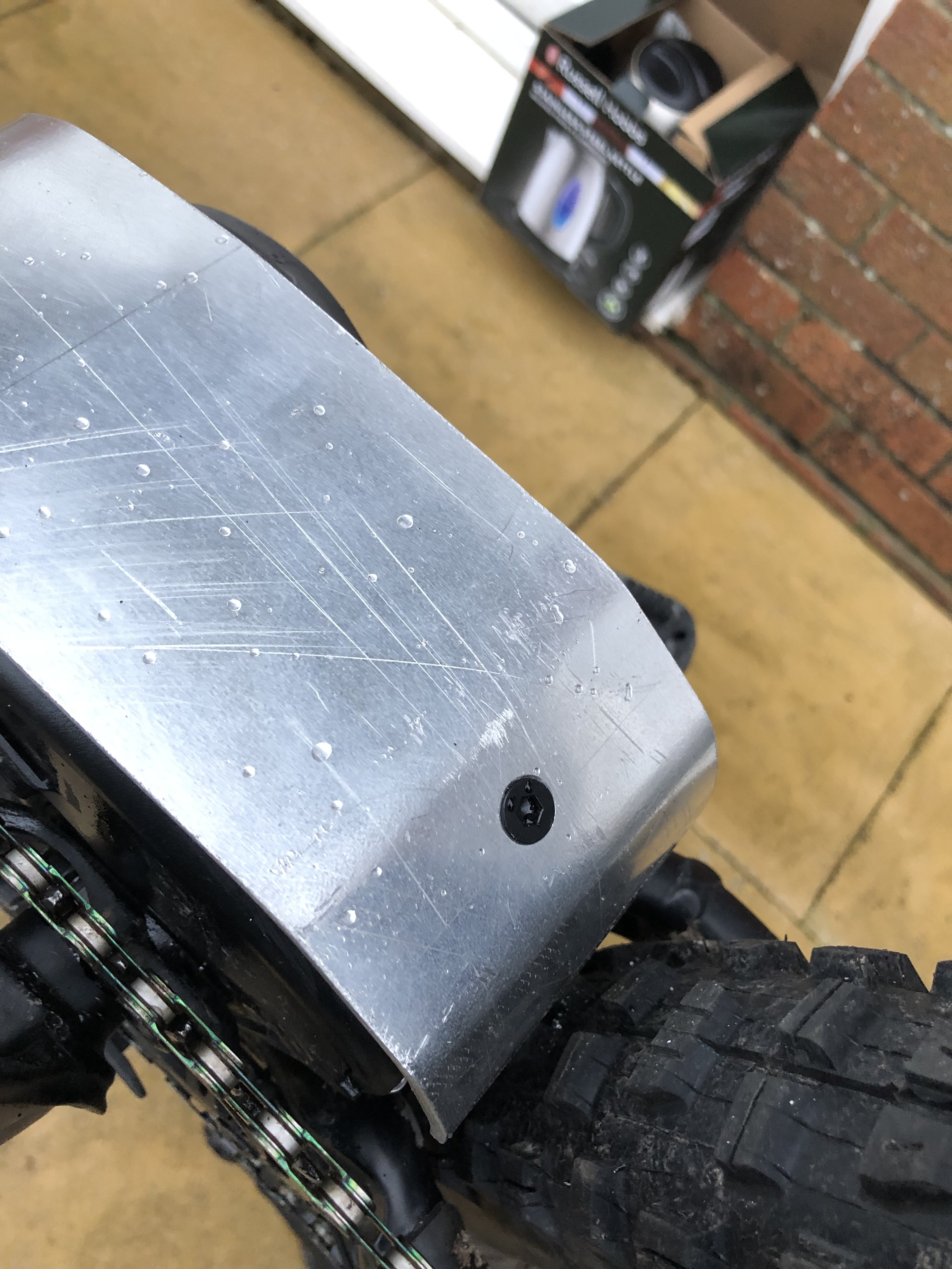

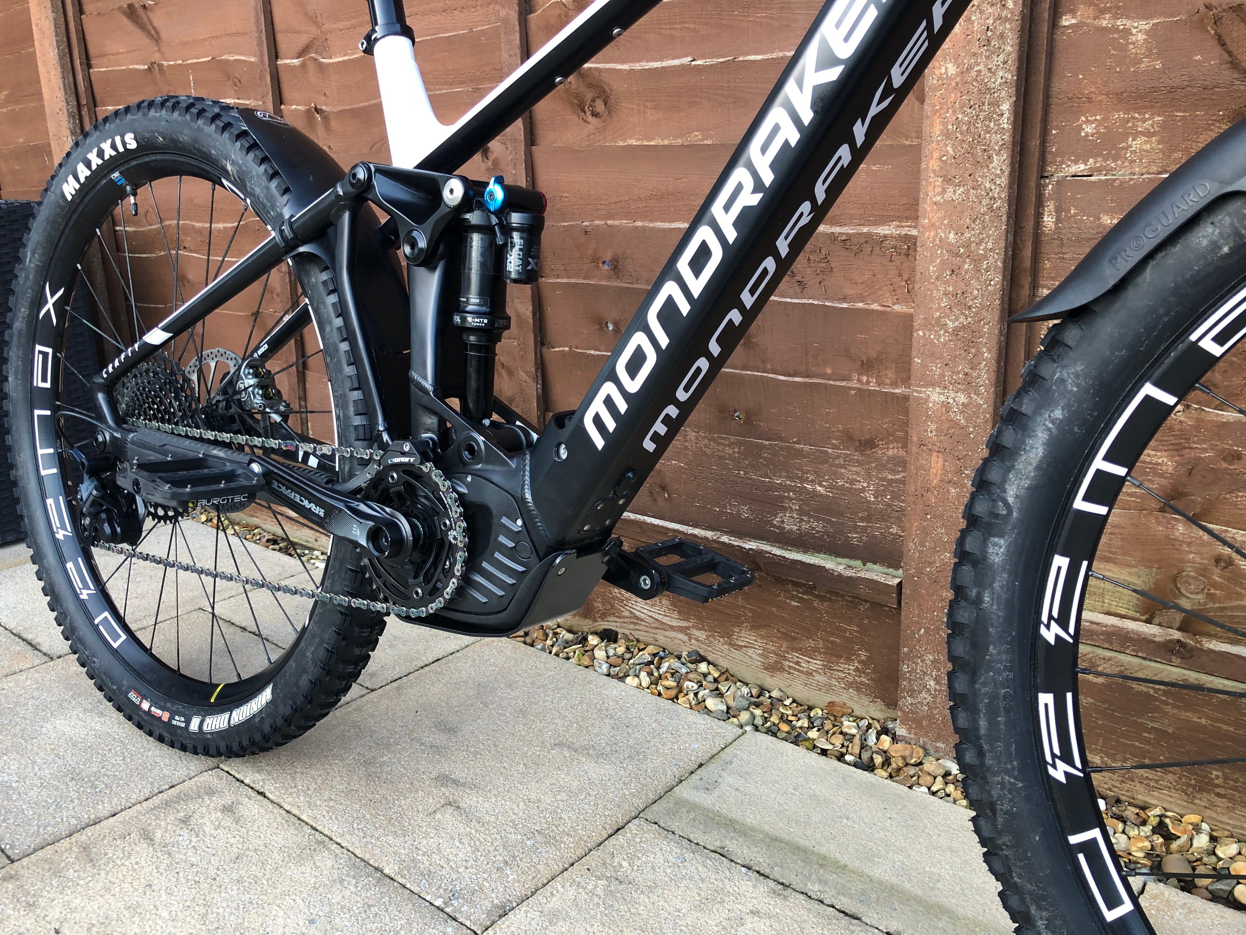

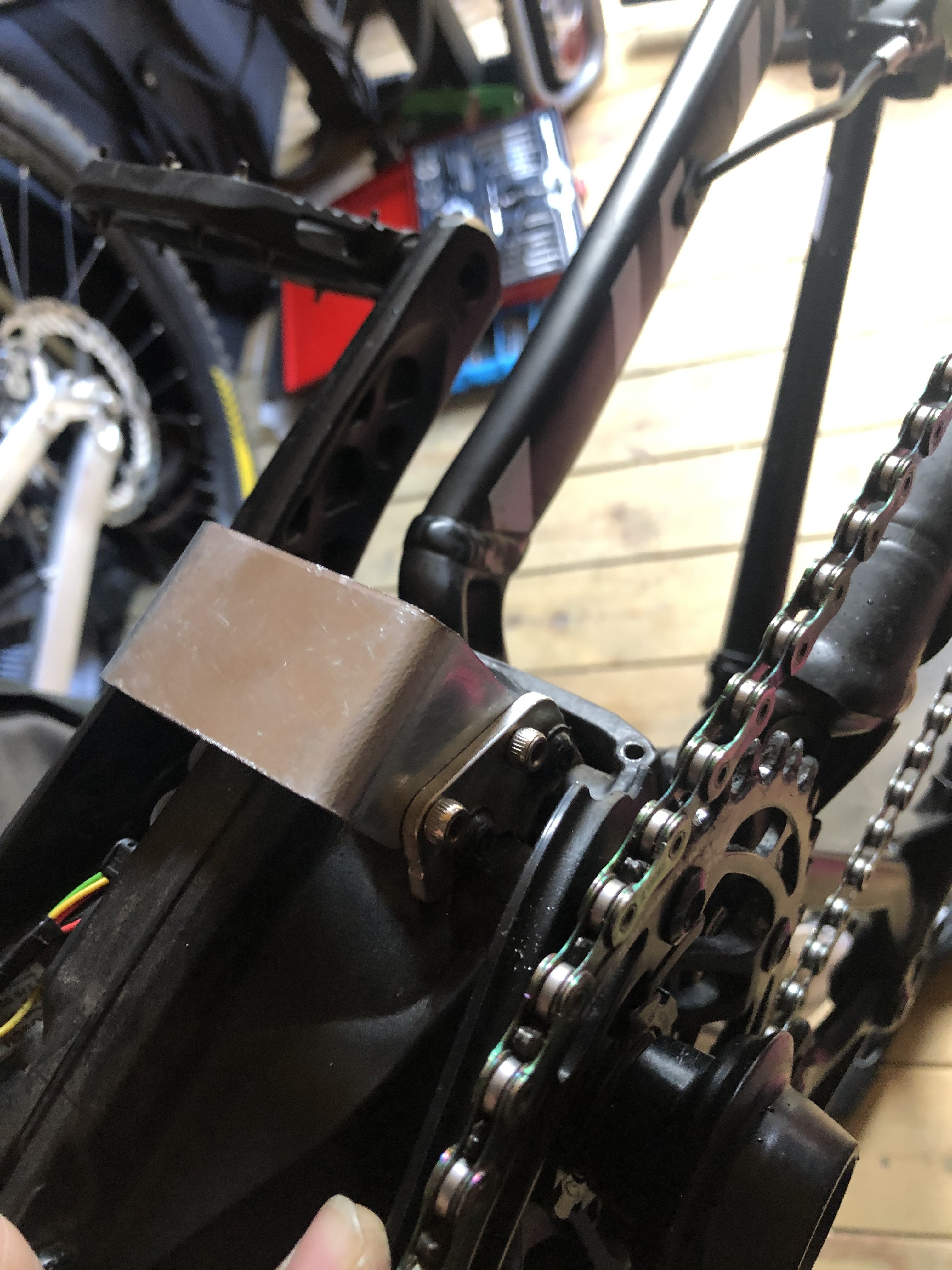

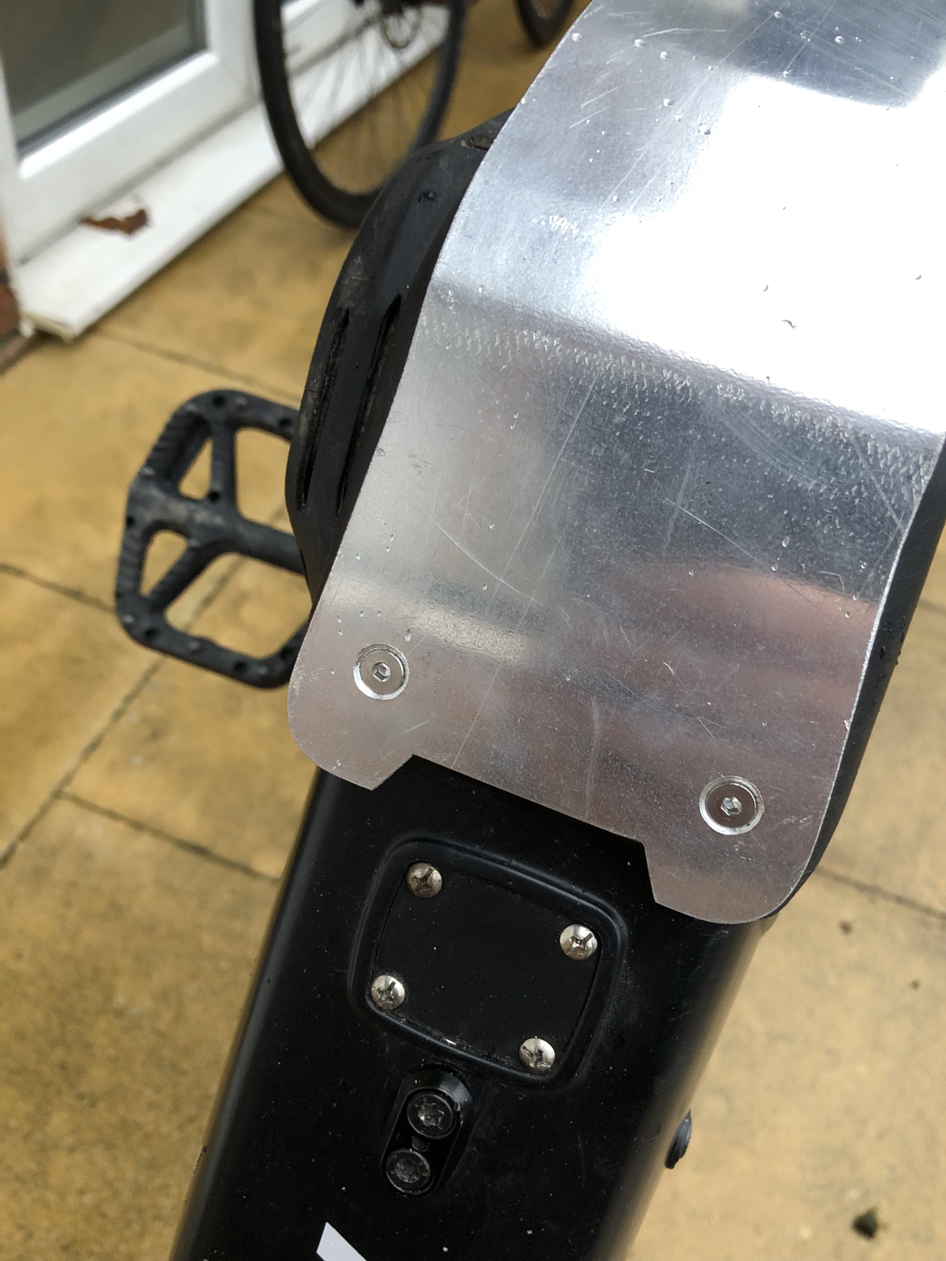

Because the wiring runs below the motor and over one of the fins, a well placed impact could damage if not sever the wires completely. I thought about ordering an Andreani skid/bash plate but not only would it cost a fortune but the mounts that it uses for the existing plastic guard at the rear are very thin and use only small bolts. Adequate for the plastic guard but that doesn’t help my wiring concerns which are not helped by the extra wiring from the Volspeed unit. Decided to try and make my own plate incorporating a mount that attaches to the motor mounts. First attempt seems ok but not happy how low it sits at the back. Might cut it back a bit as the rear will fill up with crap from the rear tyre. Also need to get hold of some quality countersunk bolts the right size. Should have just enough plate left over for mk2.
8085929F-73A7-48D9-8D36-6AFA3A501A87.jpeg 03ABE8A9-FB28-43C3-82D9-5C59018E593F.jpeg 2D490303-7E33-4DF4-B7F7-962D27CD3CA0.jpeg 9A8CE2B6-C645-46C6-86F3-57BD27D6F12A.jpeg 5BC5F283-9D33-4A93-AE5C-5B410FD0B962.jpeg A1A911CE-34B1-423C-9D0A-0A808E5DBA65.jpeg C08FA1D3-BE2C-4B4F-B33E-B4309E647690.jpeg 0D20631F-D021-4C4A-A15B-8D639F5FA44B.jpeg

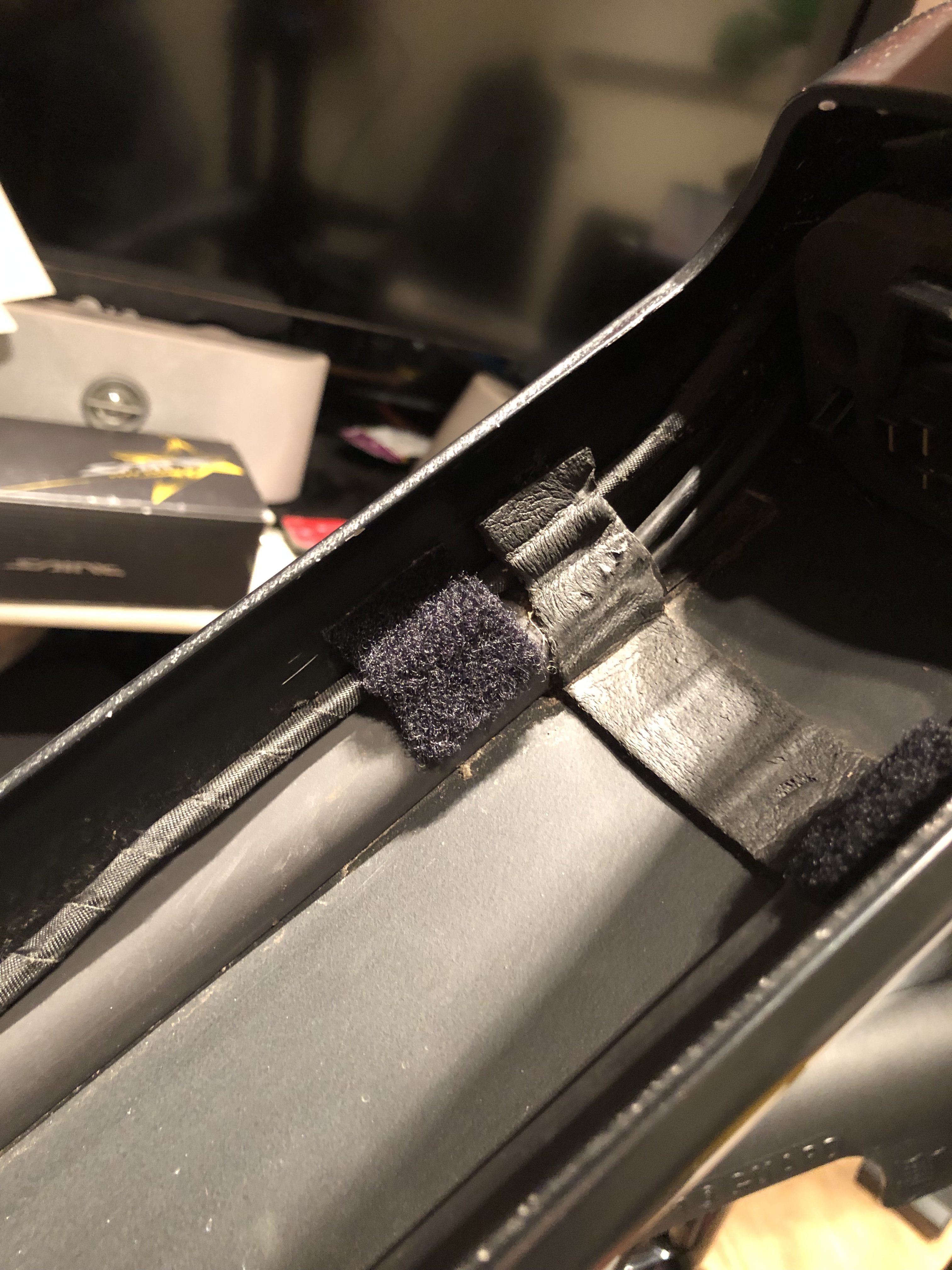

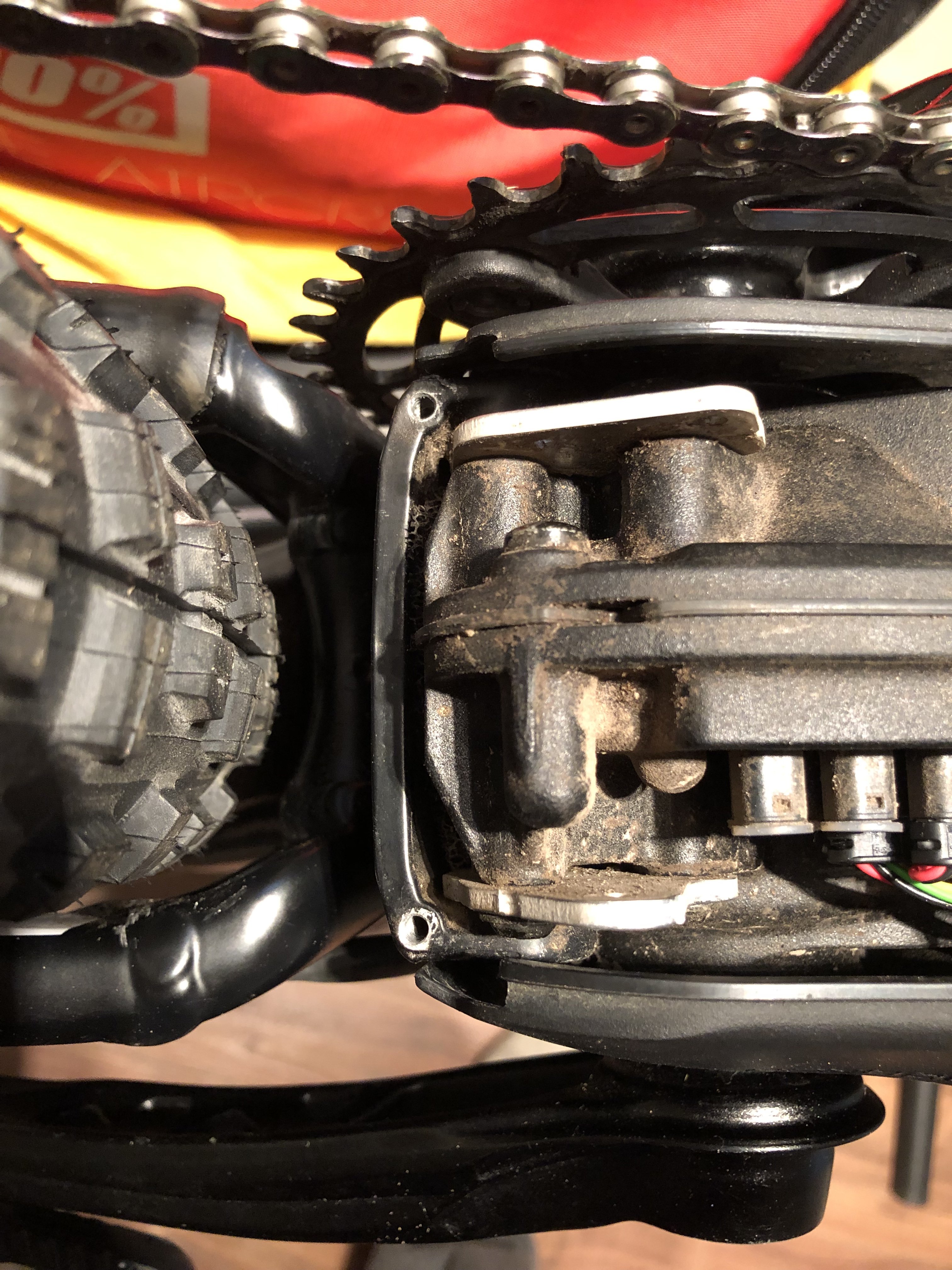

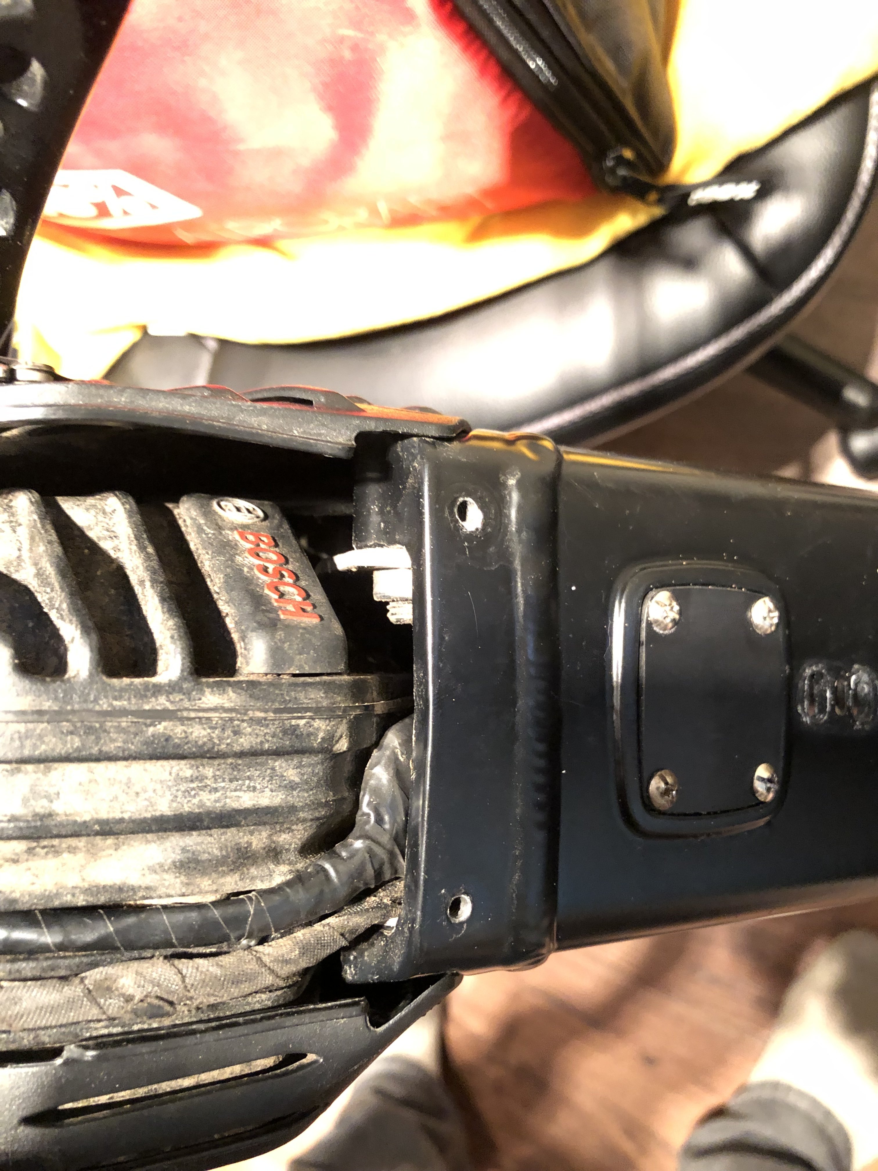

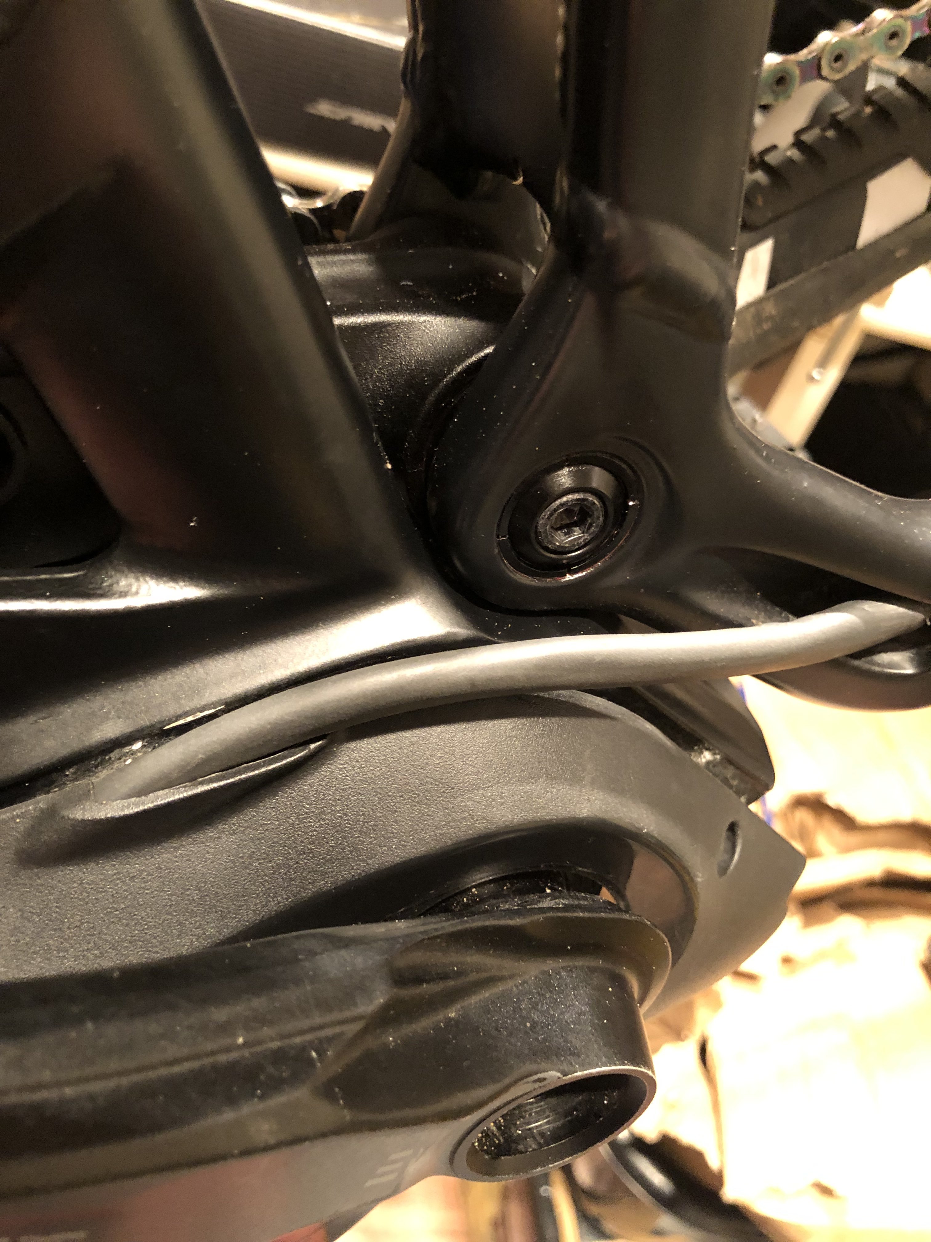

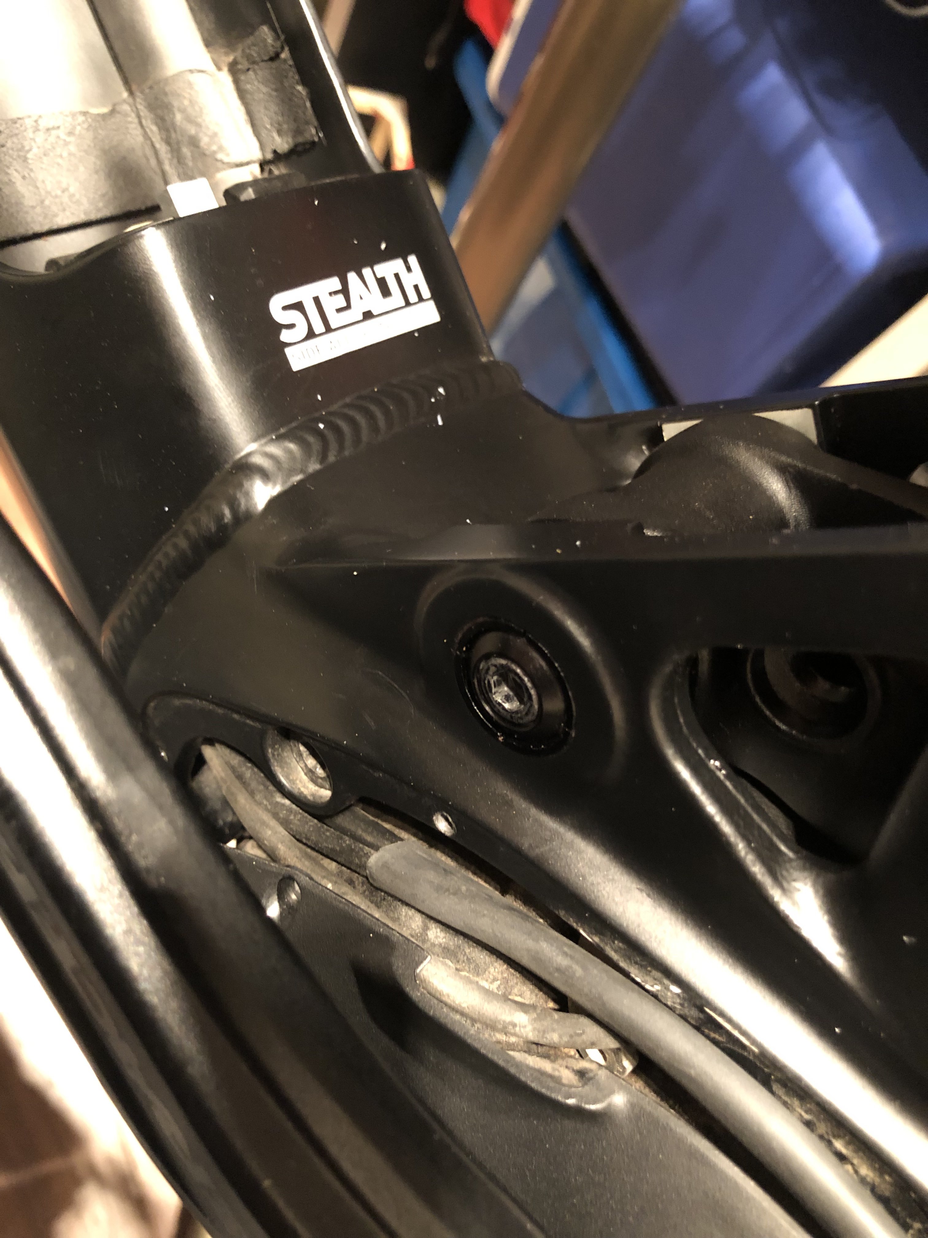

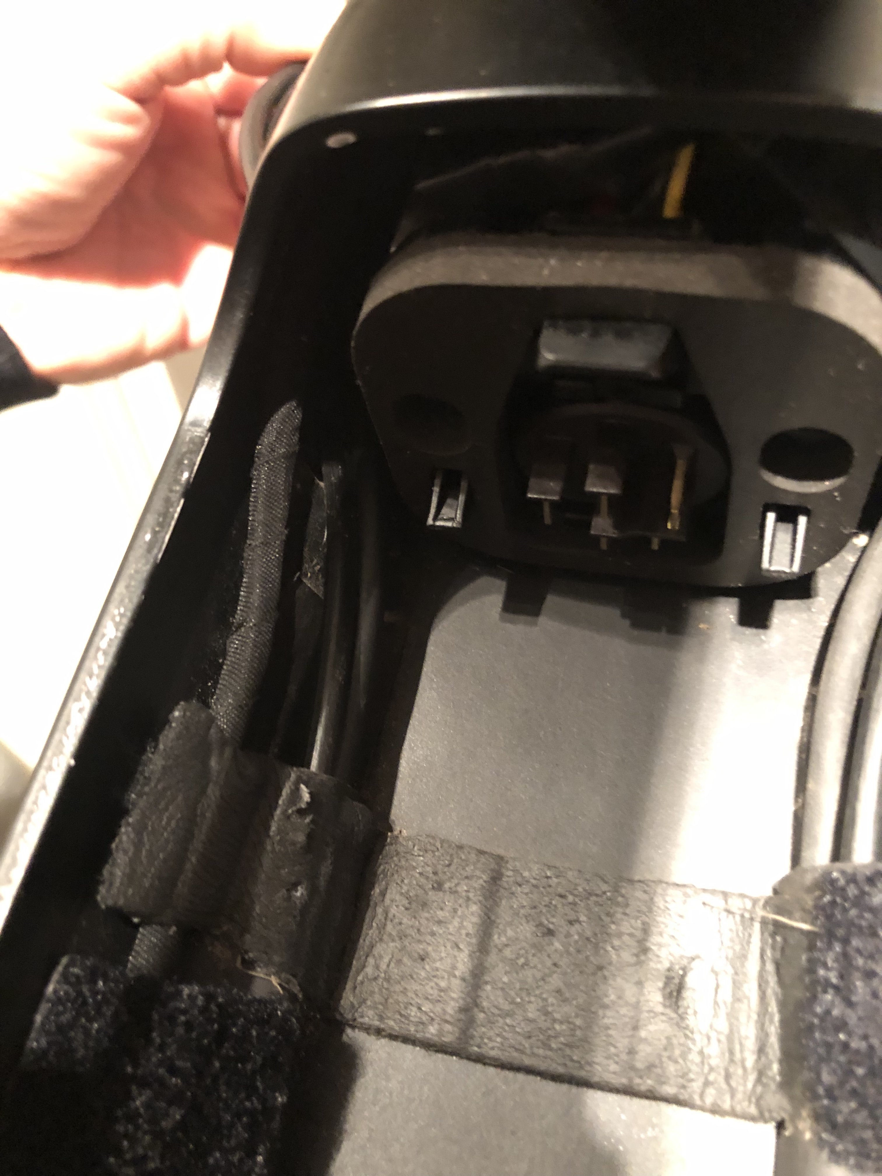

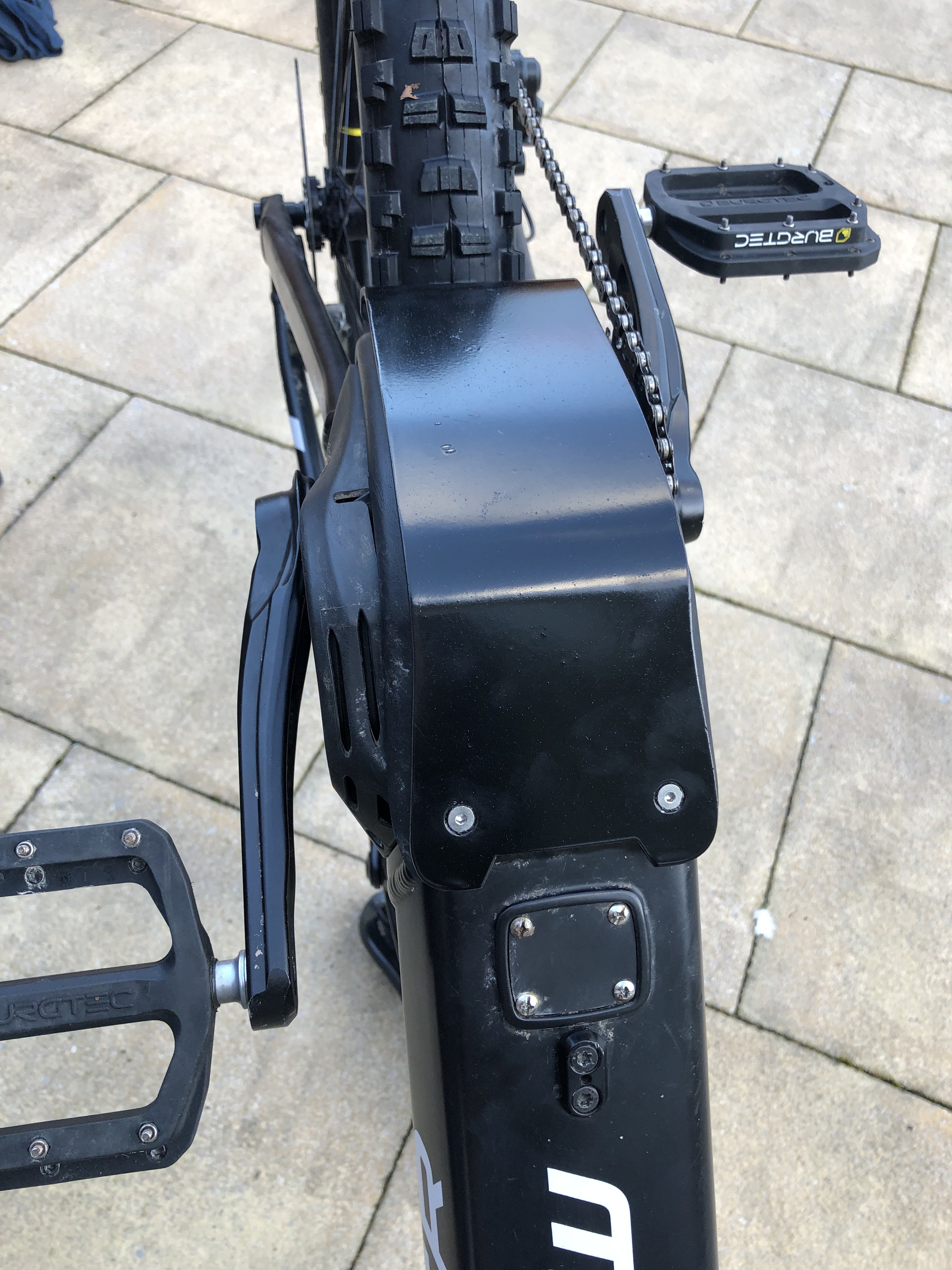

Were you able to get a pic of where the brake line runs?
So on my 2021 with removable battery it runs inside the frame at the top and then through a thin plastic sleeve/tube that’s fixed inside the frame to keep the cables tidy and help battery removal/install as well as stop them rattling I suppose. Then it runs quite loosely behind the lower battery clamp, up to the upper left side of the motor then exits the motor cover and into the chainstay via another thin plastic sleeve tube that holds it together with the speed sensor. Might be different on yours but taking the screws off the left motor cover and rotating it out of the way might help to see where it snags on yours. I’m installing some mt7 brakes in a couple of days, rotating that left cover out of the way will be necessary on mine.

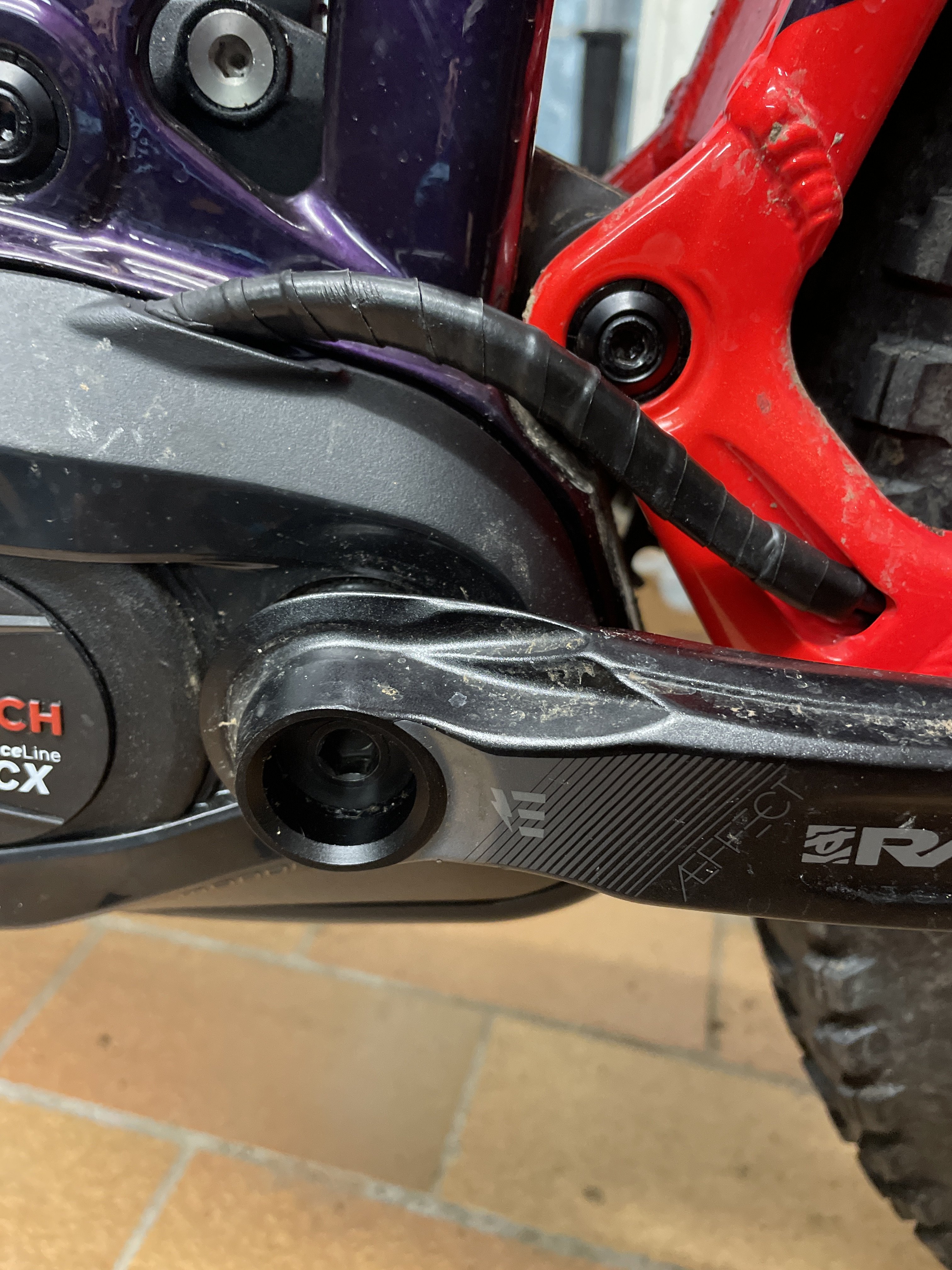

yorkshire89
Sep 30, 2020
468
663
North Yorkshire
I replaced the brake hose on my 2021 level, same setup as the photo's above. I ended up removing the sleeve's that runs down the downtube, and cut off the sleeve from the motor cover to the chainstay, you can't feed the hose through this.
Hoses/cables are now just held in with gorilla tape.
I managed to do this without dropping the motor and using the reverb small barbed fitting to pull the hose through. I did remove the lower battery mount to make access a bit easier.

Just finished installing my mt7 brakes. Where the hose has a fitting moulded onto it at the calliper end the same as the codes that I was removing, I couldn’t use the sram barbed fitting. Had to pull the old one out towards the calliper and reverse for the new one. Was a bit of a faff but this way I was able to feed it through all the sleeves. I had a bellend moment where I got it all the way to the lever then realised I forgot to thread the rubber chainstay grommet on first. Pulled it all back out only to then realise the grommet is split to allow installation after the hose is installed 🤦‍♂️
View attachment 101633 View attachment 101634 View attachment 101635 View attachment 101636 View attachment 101650
Thanks for the details; will pull the cover. The cable is clamped down somewhere and that might be the only hassle.

That sleeve from the motor cover to the chainstay was the only ‘snag’ on mine. The rest was pretty free for movement.
Decolocsta
Aug 10, 2022
71
215
No, there is nothing clamped.
Just Shrinking Tube over the Brake Cable and Speed Sensor cable.
Cut it open and the Cable is free to move.

Can anyone recommend a motor guard for a 2022 crafty carbon?
There only seems to be one available for the crafty, an Andreani guard and it doesn’t come cheap. Hence I’m in the process of making my own. Also not sure it fits the newer bikes as they have a bump on the stock plastic guard the the previous model doesn’t have
