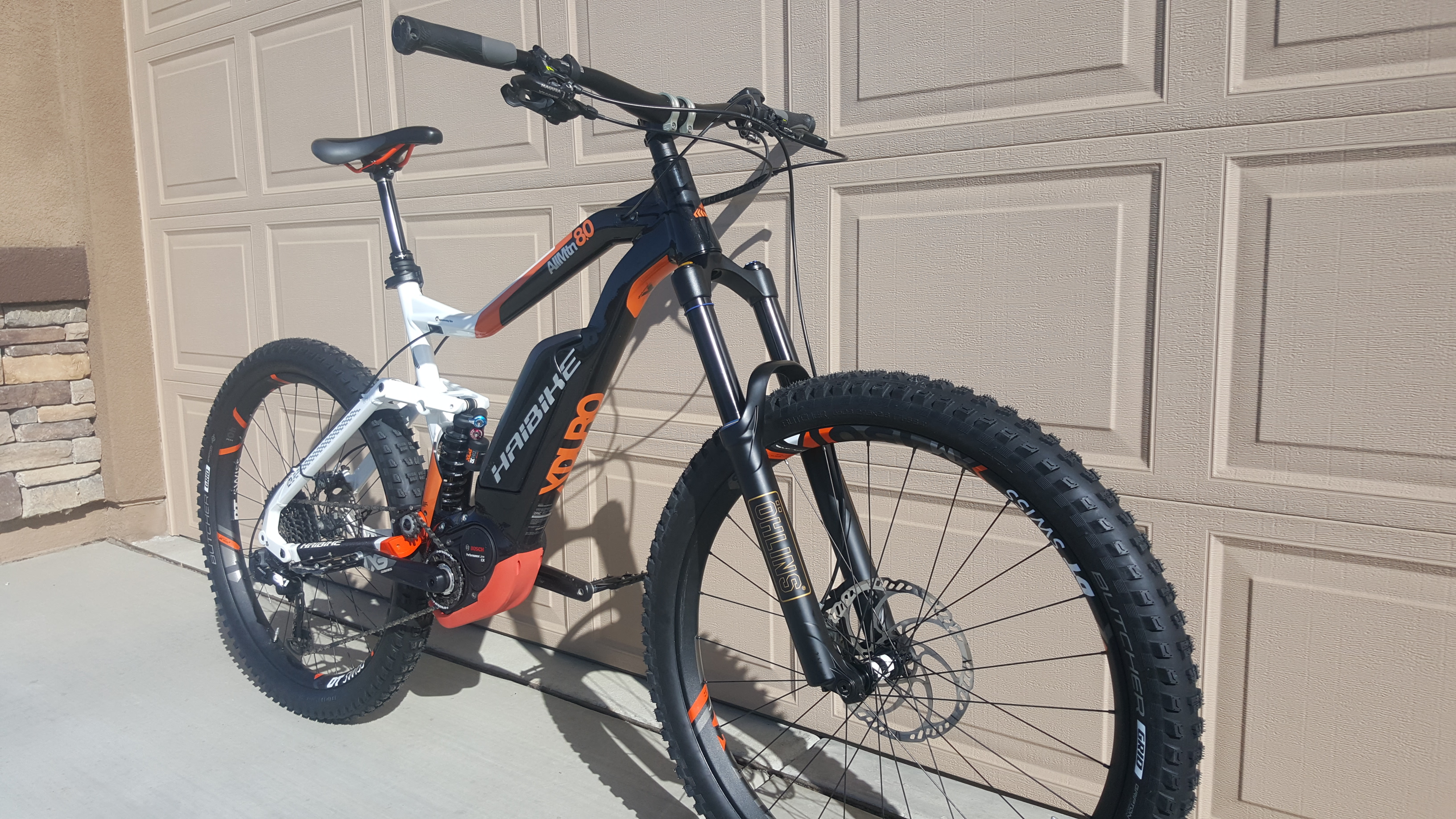

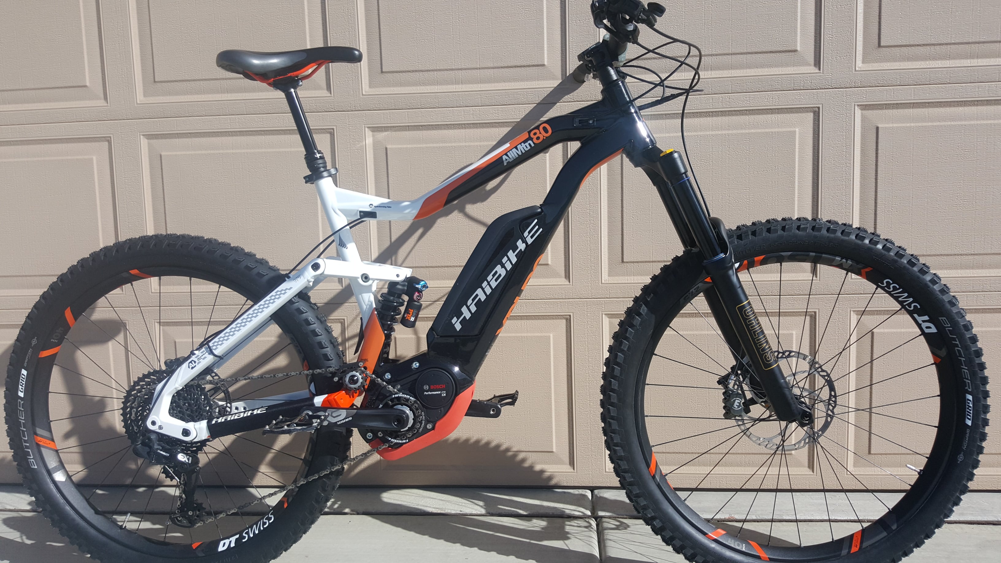

Now that I'm on an e-bike and not counting grams anymore, I switched to coil suspension front and rear. Shock is a fox dhx2 coil and the fork is an ohlins rfx 36 coil. Finally have a mountain bike that has the quality plush feel of my dirt bike in the first inch or two of travel. Yes, it was expensive but I believe I can probably put these on any new bikes I upgrade to also. Who knows, maybe some ebikes will start coming with coil suspension front and rear stock. T
he ohlins fork is 160mm travel and the fox shock is designed for 150 mm travel.
