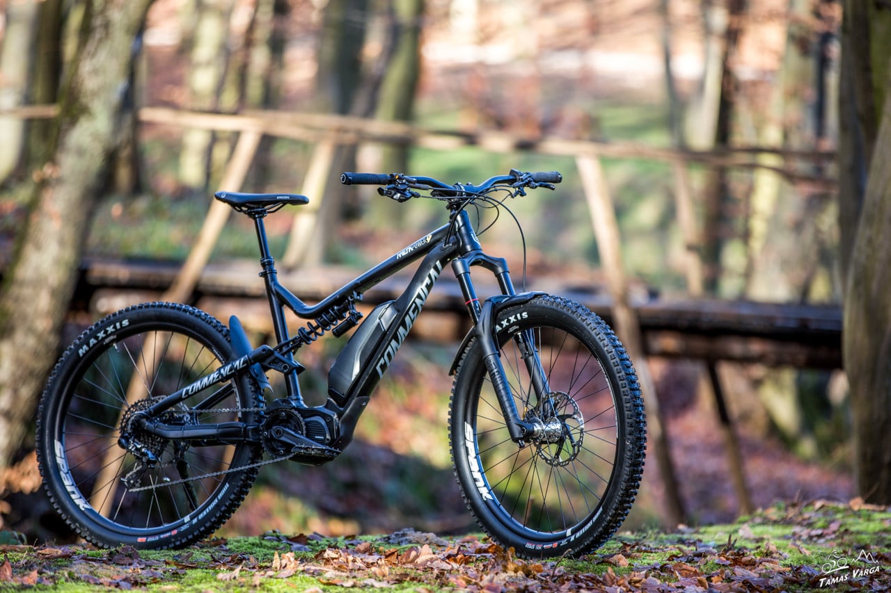

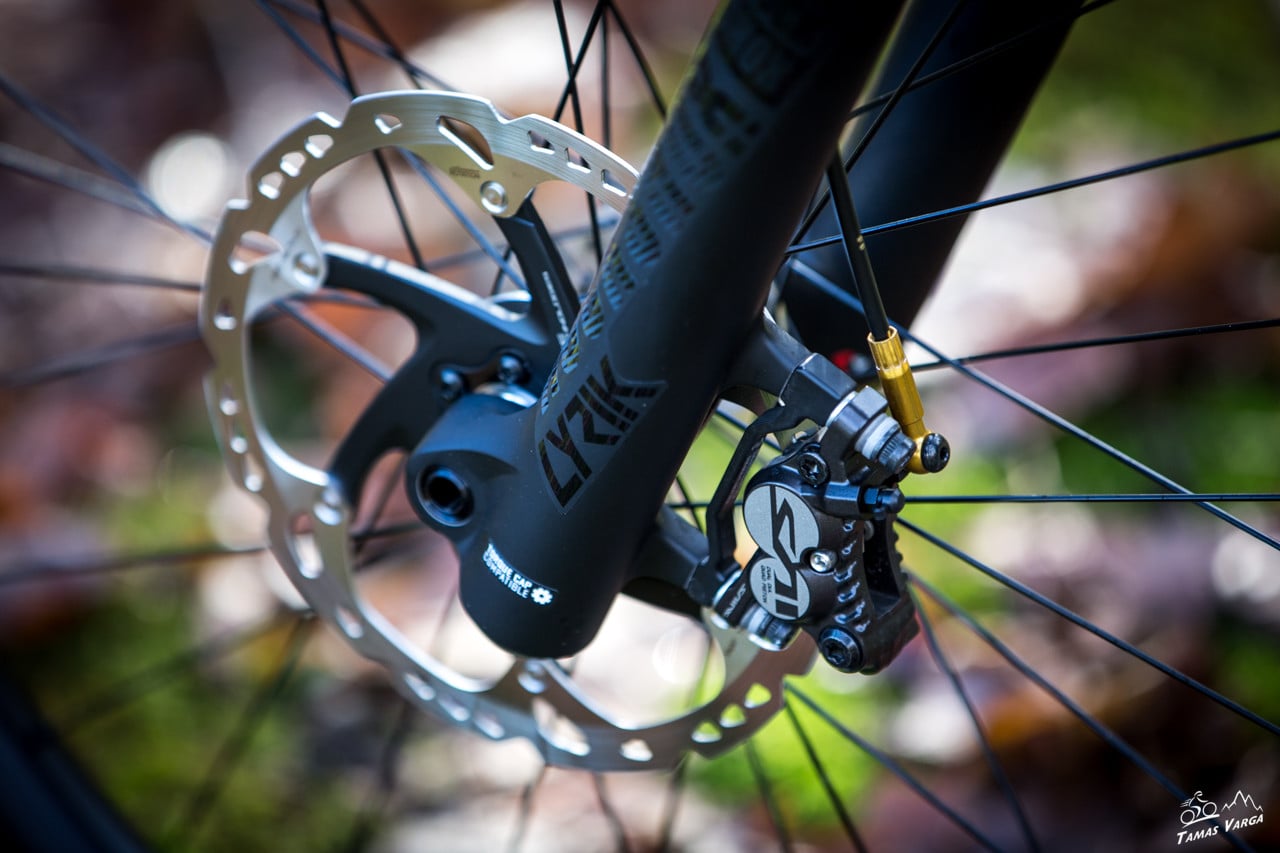

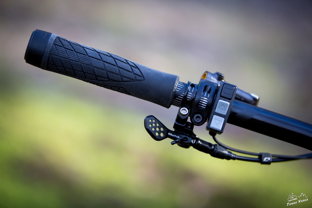

Tamas
Jan 22, 2018
483
503
Hungary/Bosnia and Herzegovina
Mine is an Essential - not much difference.
Few upgrades - E6000 assist switch instead of Di2, BikeYoke dropper remote, proper brakes as the Sram brakes' feel is not for me.

Hi Jeff,
I have it for a month and I rode it 200km. I love the bike it's awesome.
First I was thinking on ordering the Race model because the 8 speed EX1 was tempting but now I'm glad I went with the 11speed. I used to ride my wife's Lapierre with Yamaha and the power delivery is completely different from that one. The Yamaha has huge torque from the first pedal stroke but limited optimal cadence range (50-70rpm) and the big gear gaps would be good for that. The Shimano feels more natural (less powerful?) and the optimal cadence range is higher so I prefer the smaller steps of the 11 speed between the gears.
The replacement of the assist switch was really simple - just unplug the other from the display unit and plug this one in.

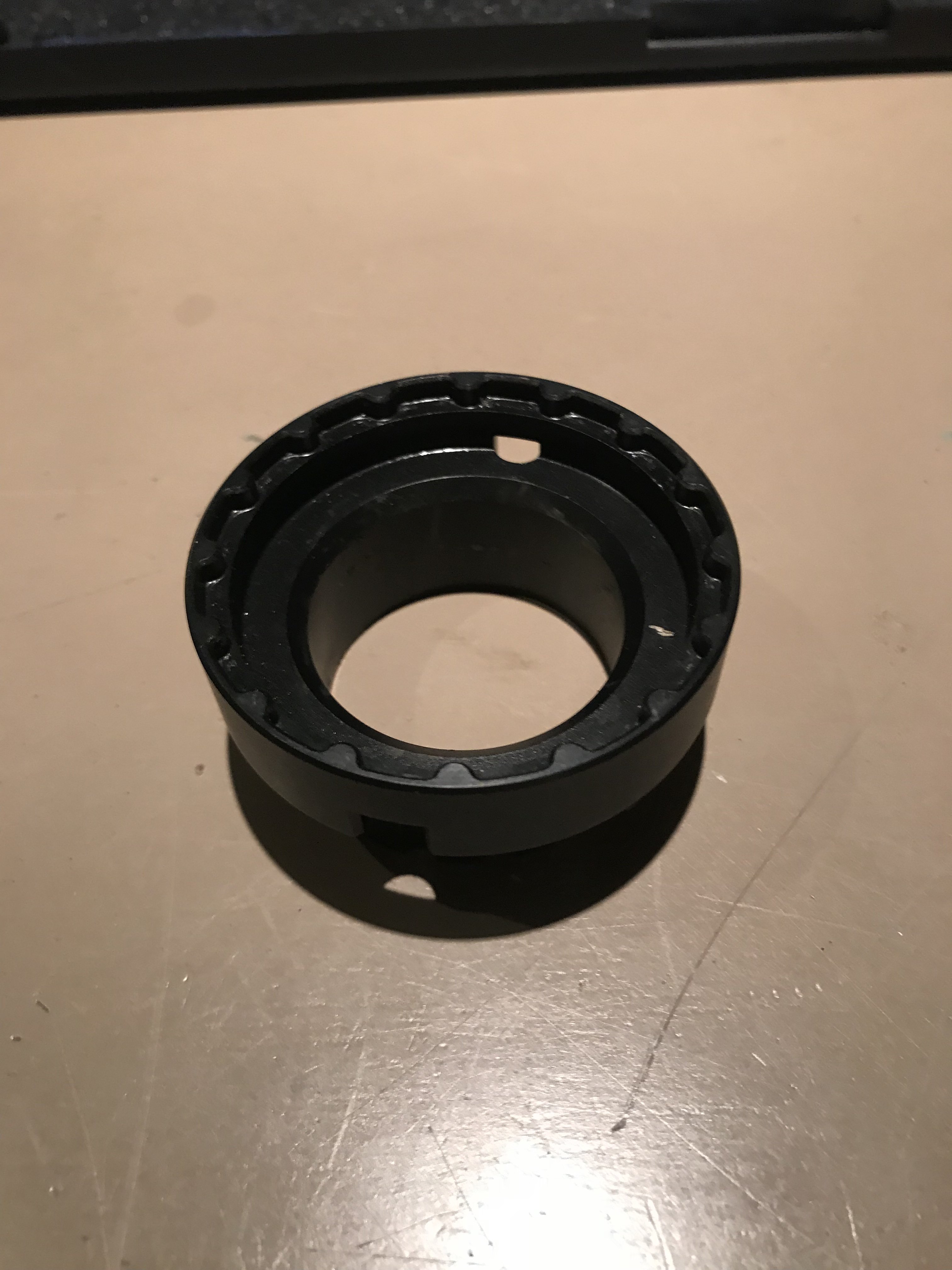

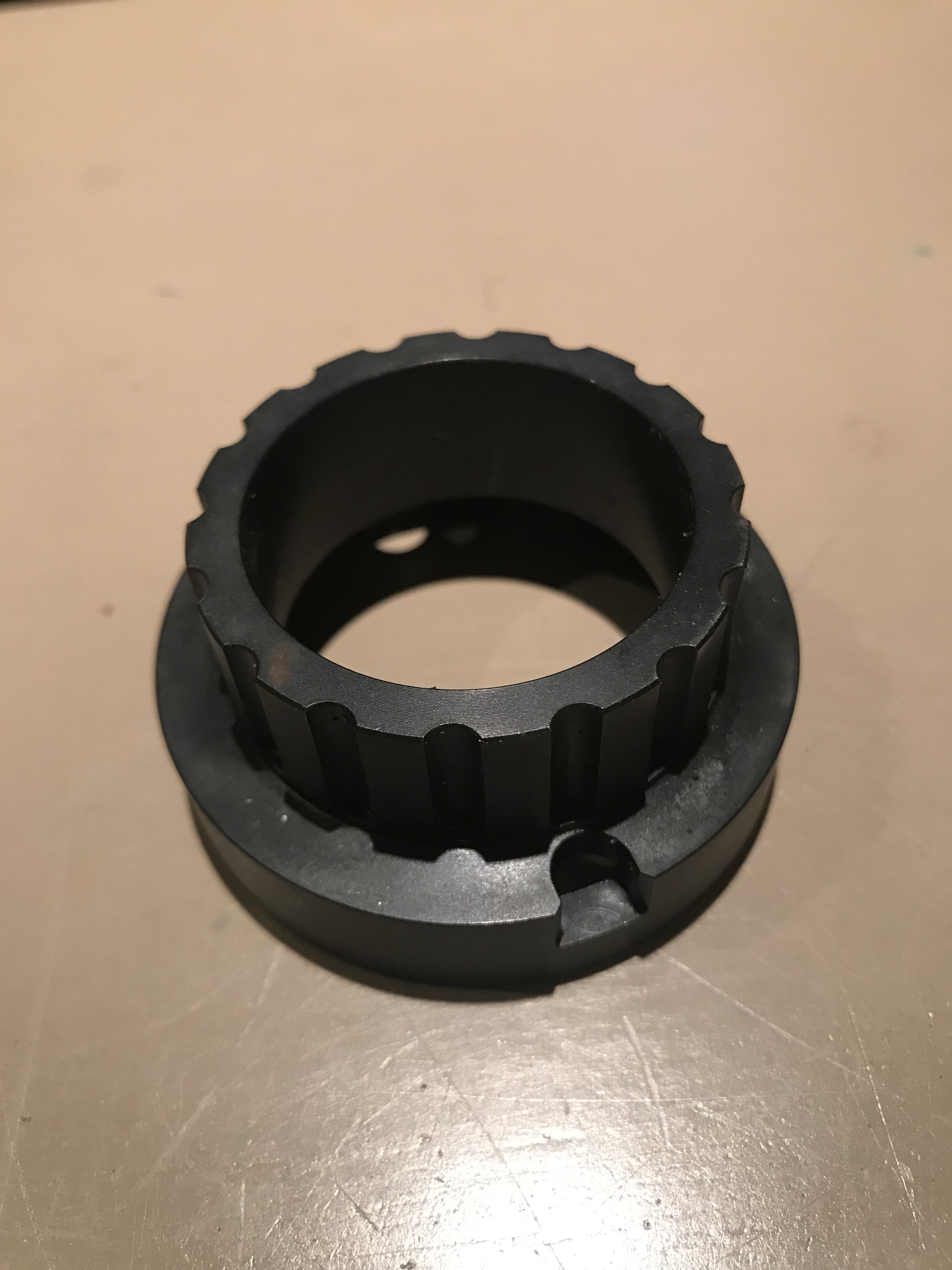

Have you looked into Shimano specific tools yet ?
We have the PC Ei Pc interface for updates and for the fault finding, that you can't do on the app.
The only thing we are struggling with is the TL-FC 39, to remove the front chain ring ? its available but hoping to find a cheaper alternative when we find out the diameter of the locking ring ?

Eckythump
Jan 16, 2018
832
680
North Yorkshire
We have the PC Ei Pc interface for updates and fault finding bits that you cant do on the app.
Jeff
I have the spider lock ring tool if you need dimensions.
That would be great, thanks :)
A pic with a ruler across its face would be ace or internal external dimensions what ever is easiest for you.
Did you have to buy the original shimano tool or did you manage to find a cheaper alternative ?

Tool has 16 teeth, 55mm outer dimension, 51.2mm across the inside of the teeth. Teeth are 3.8mm dia half round. There is a further recess 49.55mm across. Toothed section is 3mm deep, recess 5.85mm deep.
The other side is machined to suit a regular BSA BB tool or has slots for a pin spanner.

is that not just an octolink bb tool? my levo has something very similar locking the front ring spider on and I just used the bb tool
Kernow
Jan 18, 2018
1,436
1,149
Cornwall uk
I have a feeling it will be or something similar I allready have in my toolbox , will wait until I get the bike before buying any tools . ?
