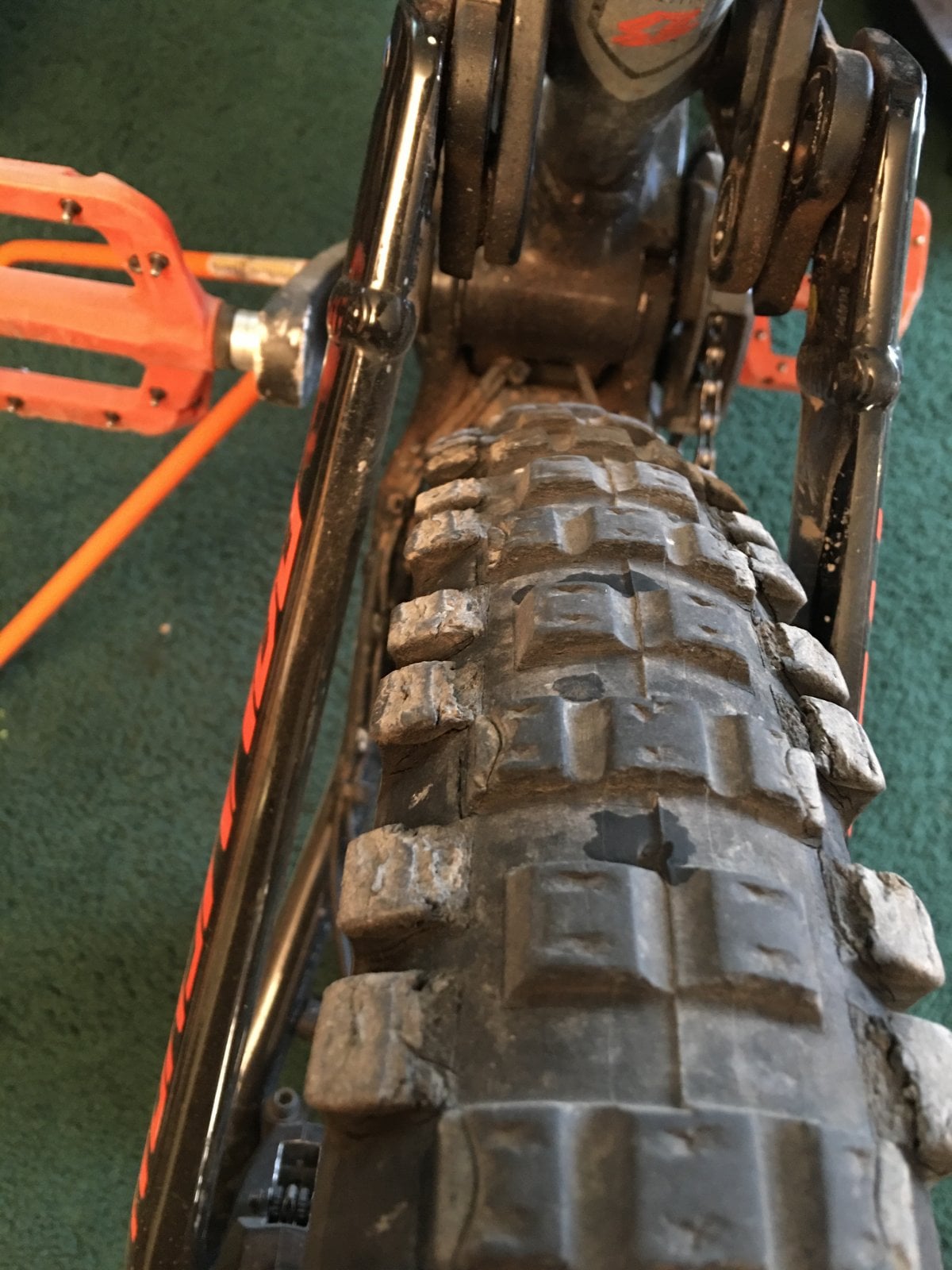

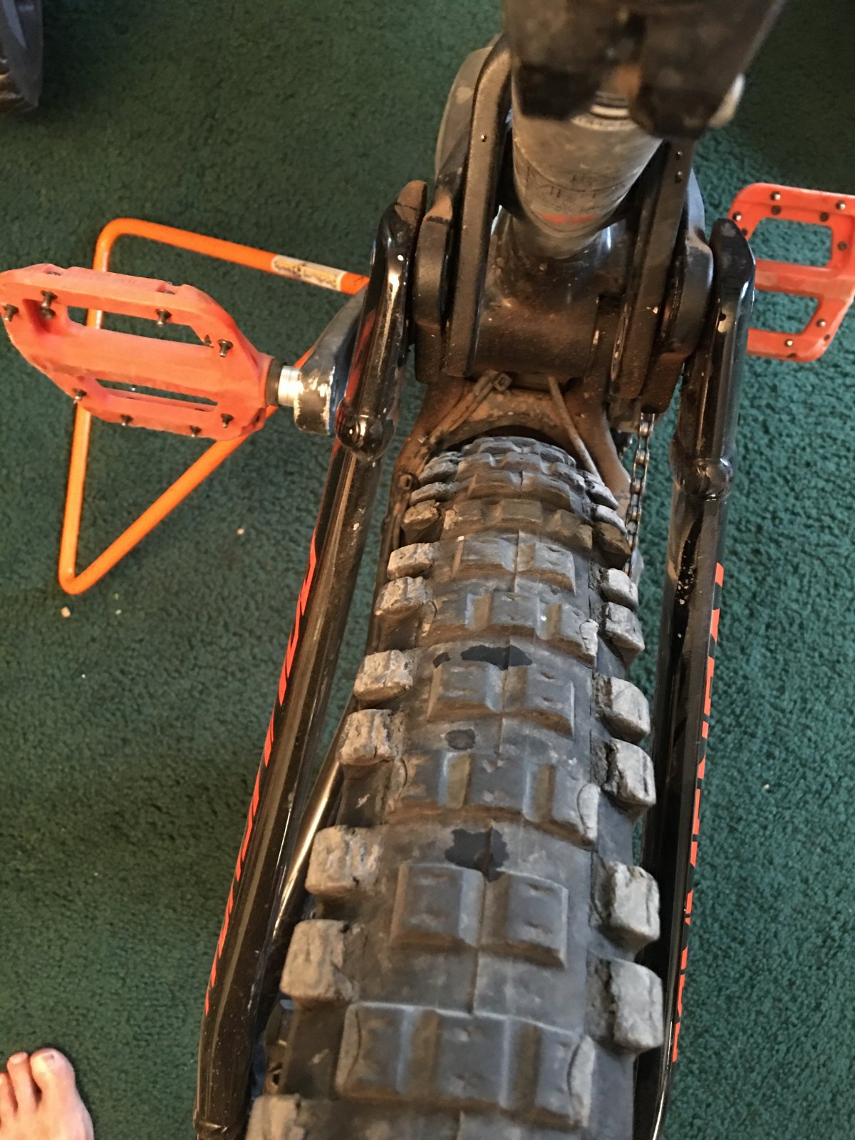

It’s not the grip or sealant it’s the casing. They have had suffered from pinch flats, punctures, tears around treads and nibbles that are shredded. Haven’t had one 27.5 x 2.8/3.0 last more than 500 miles before it was tubed due to being damaged and un-sealable.
Latest one did 100 miles and it’s needing internal patches or inner tube.
Eddy C has arrived and is going on.
