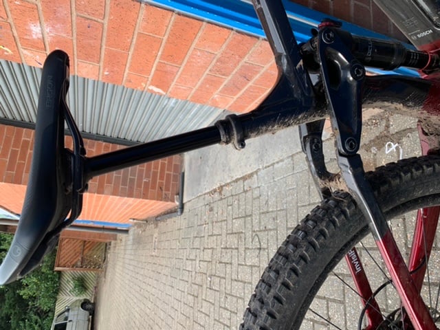

Anyone with a med Rail fit a dropper longer than a 150mm? The 9 comes with a 150mm but wouldn't mind a 175 if possible.
Yes ... I changed mine for 180mm, went for the One Up V2 model as this has one of the shortest overall length available so no worrying about if it will fit into the seat tube enough .

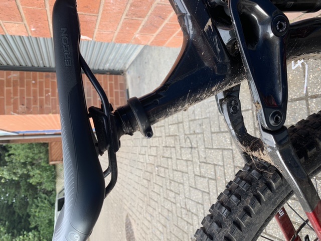

I replaced the stock dropper for a One Up v2 180mm, which I also had previously on my Yeti SB5.5
I'm 5'8" and no issue fitting it on my Rail 7 med.
I'd recommend having a gap of at least 10mm between the dropper collar and the seat tube one, that helped on the Yeti
