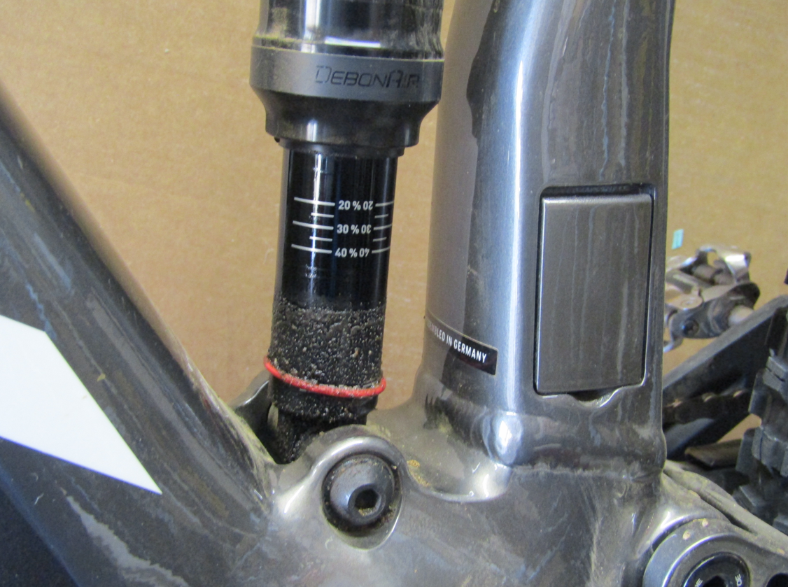

Guys, sorry I have not logged in here in a while, but I am absolutely loving my Rail!!!
I greatly appreciate all of the tips here too!
I have one issue that I thought I would run by you experts, before I take it back to my Trek dealer (which by the way I have a great relationship with... several really cool guys there).
Anyway, my RockShox shock is leaking. I am sure I can fix it as I routinely rebuild dirt bike forks and shocks, however this bike is so new.
Is this common issue with this particular shock?
Thank y'all so much.
Andrew

Definitely not Andrew - glad the bike is treating you well. Mines been a blast this fall as well. Trek warranty is usually pretty good from all my experience and what I'd heard. See if they'll give you a replacement or even offer an upgrade?

Shock looks dirty that is all. Do you have 100+ hours on the bike yet? If so, SRAM says to get the shock serviced etc.

If the shock still has the same sag as when it was set up for you and compresses and returns
OK then it's fine, just dirty.

I downloaded the SRAM repair manual (pdf), ordered the rebuild kit, and already have the correct "PLUSH" oil.
I will service it myself.

While you're doing that you could fit a Megneg upgrade, got one on my wife's bike, really does make a big improvement to the performance of the shock. Was sceptical about the reviews but they're right. For example:
