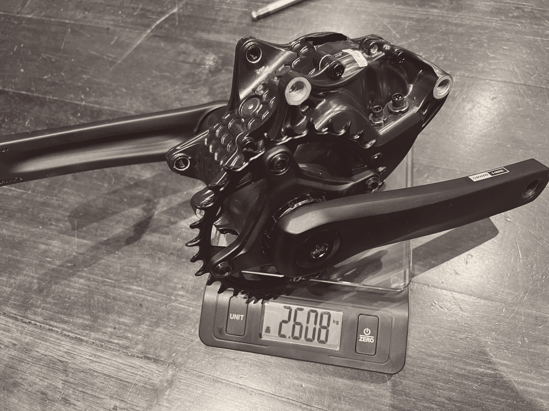

The SL 1.2 is out in the wild with the '23 Levo SL.

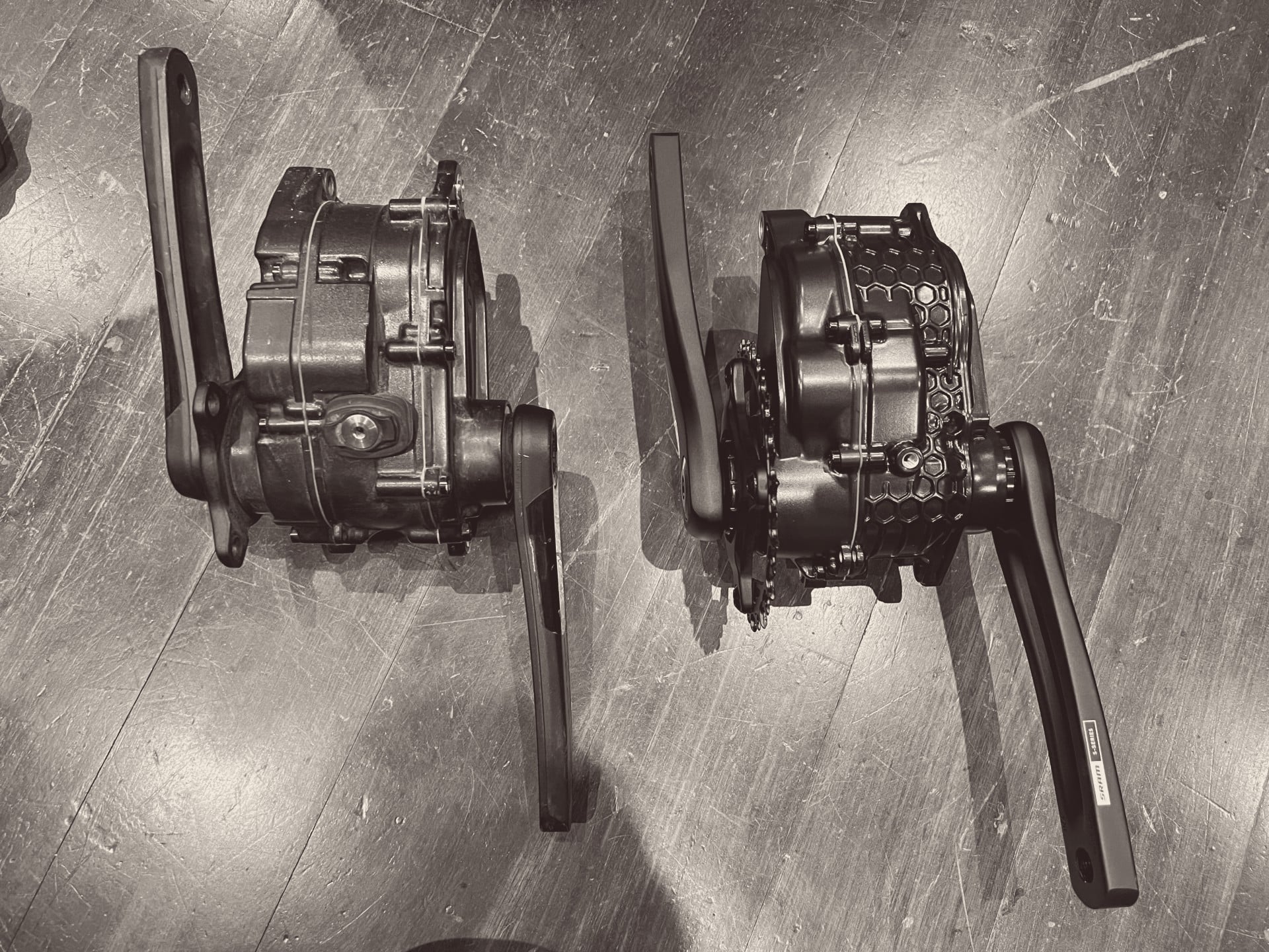

From what we know so far, mountings and connections are all the same. It works with the existing battery and range extender (shorter 145mm instead of 160mm cable).
The motor is slightly larger due to the two piece aluminium honeycomb casing for noise reduction.
New 1.2 motor :
Previous (1.1) motor :
The torque sensor looks slightly different and you can see the casing on the drive side is thicker.
Hardware wise, from what we know so far, there were only slight changes made to the gears to make them slightly quieter.
There are claims that the new motor is slightly more efficient if used with the same settings as the 1.1 motor. This either means there were hardware changes that we're not aware of, or just with firmware they've managed to optimise the power delivery in a more efficient manner. Though they say they've re-tuned Trail 75% Support/80% Peak power and Turbo 100% support/80% peak modes, so this maybe where the extra "efficiency" comes from. Eco remains the same as previously at 35% support/35% peak power. If you want to use all the new power which is available, you'll need to up peak power to 100%.
Allan Cooke from Specialized (mountain bike marketing manager and all round amazing bike rider) suggested a lot was done on the firmware side, so it might be that the hardware changes were primarily for sound, but the power is from firmware. If that's the case, then theoretically Spesh could offer updates to existing owners, though that reduces incentives for existing owners to upgrade to new bikes.
Updating the firmware yourself wouldn't be easy as the Spesh systems are generally well secured even if you could get hold of the firmware, though potentially a third party could offer a "tuning service" if they knew what they were doing and weren't treading on Spesh toes.
Edit: put better picture of original motor.

Thanks for starting the thread.
Looks like they perhaps added a bearing to the drive side of the intermediate axle and the outside of the output shaft.
Possibly the old lay-shaft had rolling-element-bearings inside the lower-speed gears and ran on a fixed axle and the new one has the axle rotate in rolling-element-bearings in the case so all the gears are more efficient?
The enlarged output shaft boss might be to create more space between the crank axle and output shaft to accommodate a beefier bearing and/or a better seal?

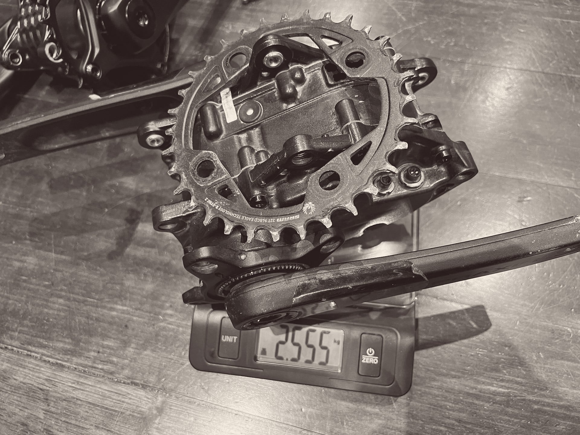

Crank now uses "SRAM DUB" splines, so old M30 SL cranks aren't going to fit nor ISIS ones I assume. Does anyone know what the "SRAM DUB" spline is? Is it a standard anyone can use or is it a proprietary standard and we will be limited to SRAM cranks?
What is available to fit this and in what lengths? Is Q factor standard?
Sealing is supposed to be better and noise quieter and lower pitched. Sealing will be hard to test but noise is measurable.

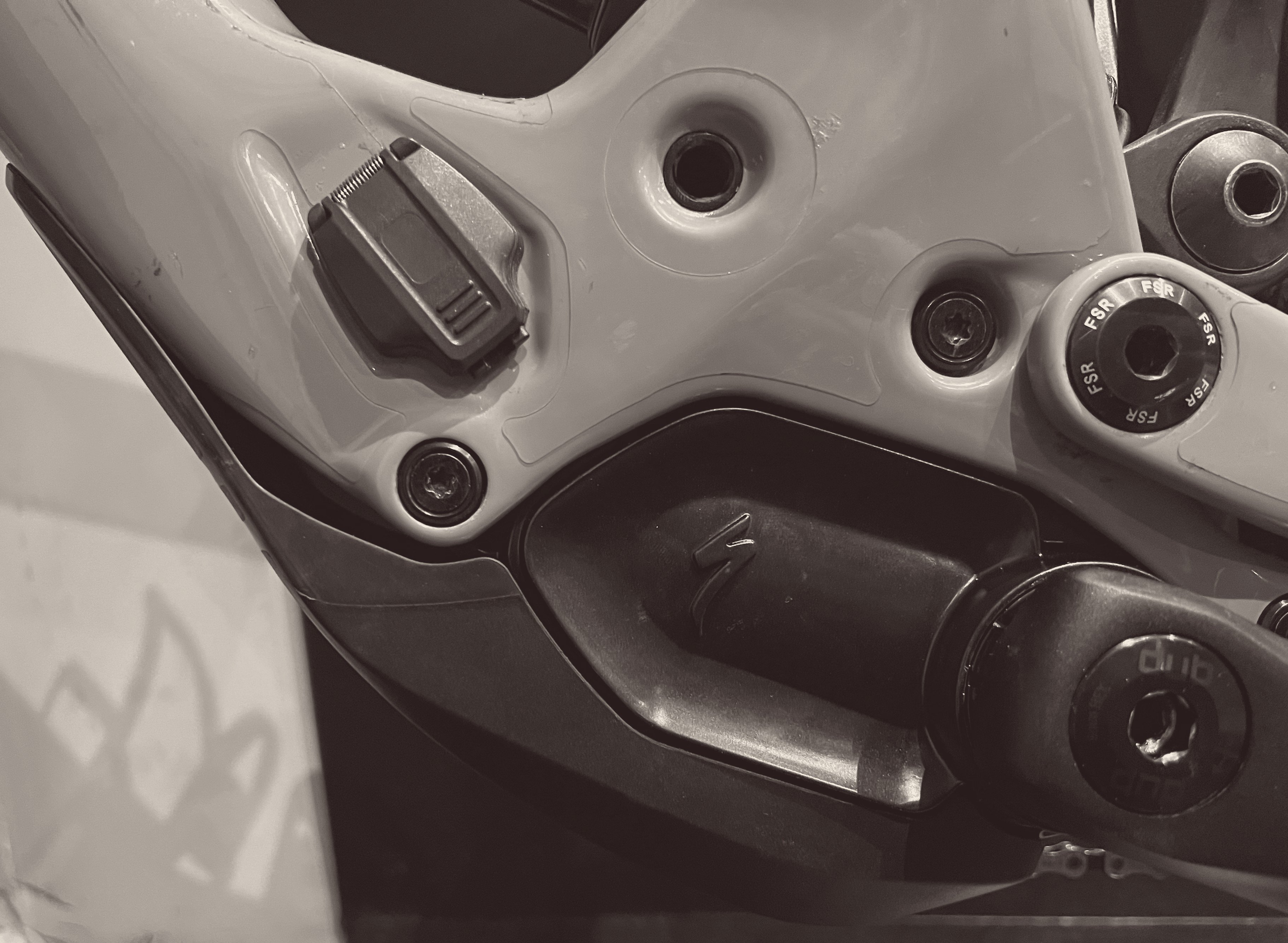

Does it fit in an existing SL ? Yes. Again, the same bashguard problem and you need to use the gen2 bashguard, But otherwise it's fine. The screws are slightly different, but the threads are the same.
Fantastic, thanks for doing this. Does it look like you could just drill an extra hole in the new guard?

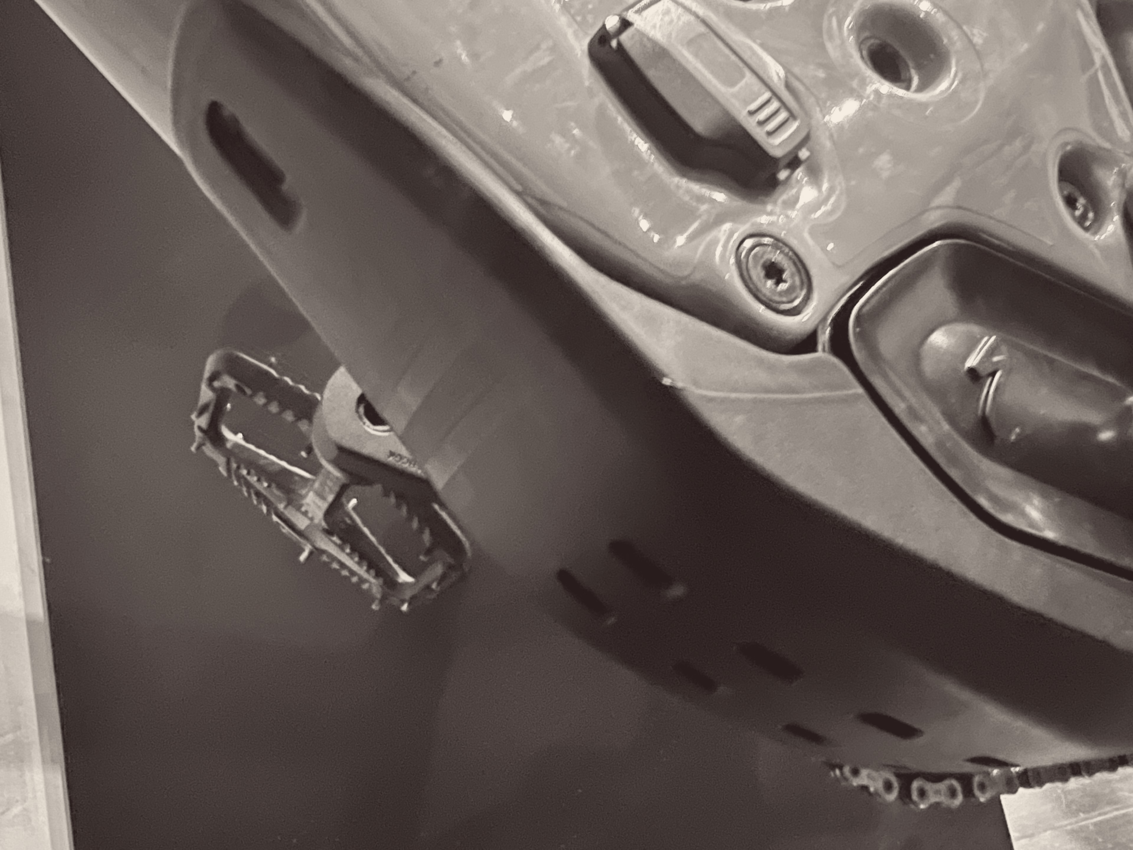

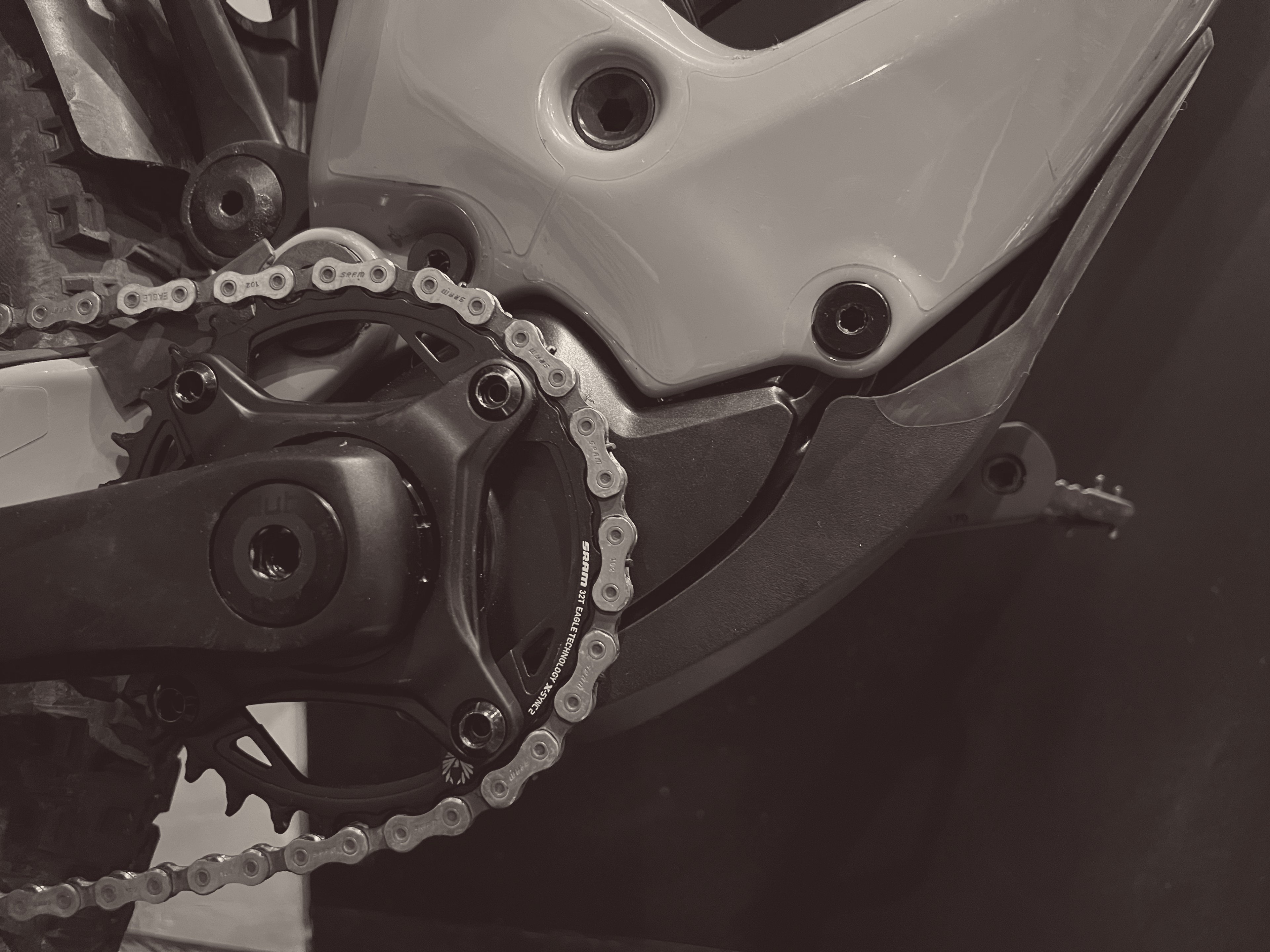

Sorry this is slow, just trying to fit it in around other things and the weathers crap. Heading off trail building for a day or two, but might still manage some updates.
I didn't really describe that very well. The bolt holes are all the same, with the front one also being the battery fixing. The First gen version also had an extra fixing to the motor, which this one doesn't anymore. The motor casing is completely different and now 2 pieces instead of three and obviously the honeycomb.
For a Levo SL Gen1, you can just use the Gen2 cover. No idea what the part number is and it attaches the same as it does on the Gen2 SL.
For a KSL, you can use the Gen2 cover, but it doesn't quite fit perfectly due to the different shape - the KSL twist release on the rear bolt uses a moulded rubber mount. This doesn't line up perfectly with the new motor/gen2 guard, but still feels like it will function correctly.. However, if you cut back the internal fins slightly on the original cover, it should then fit flush on the KSL and also be usable :
