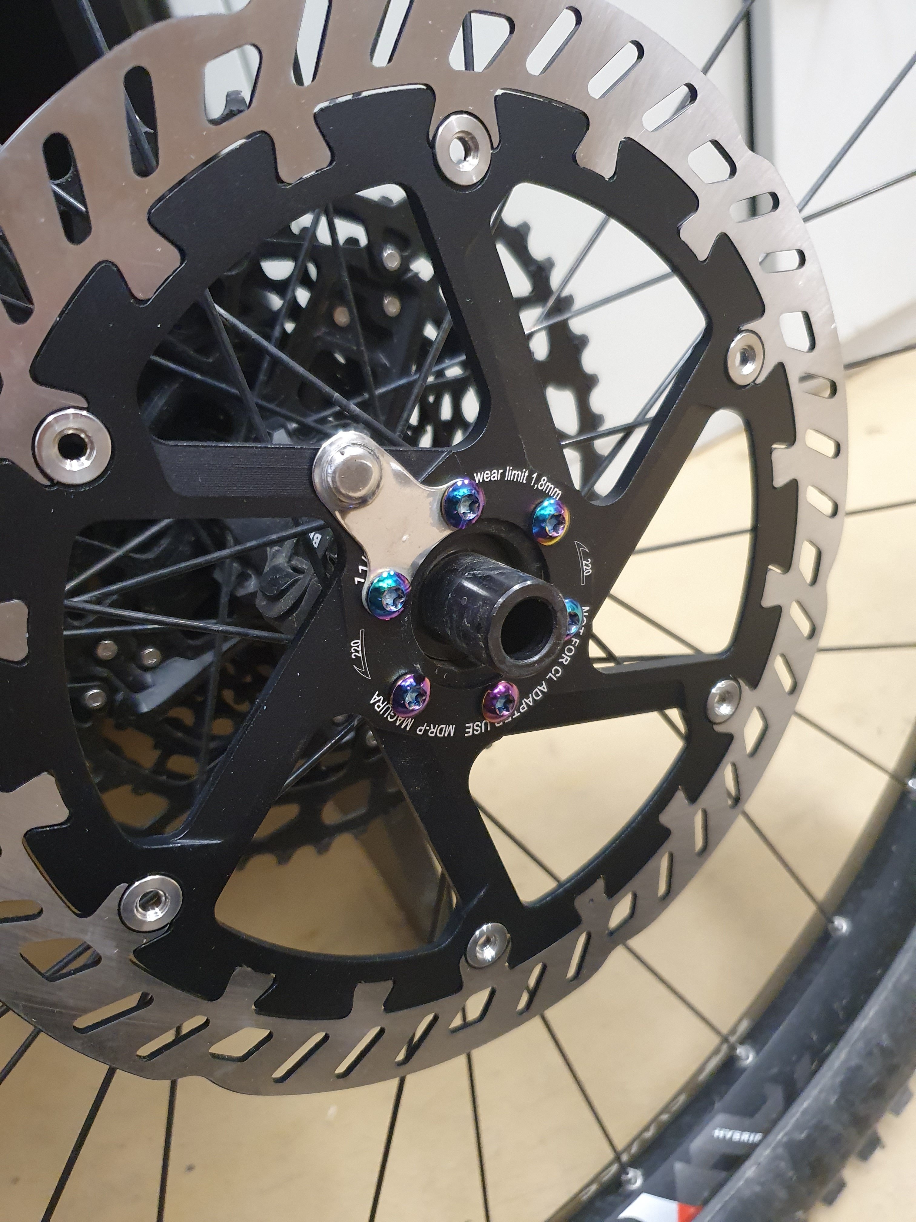

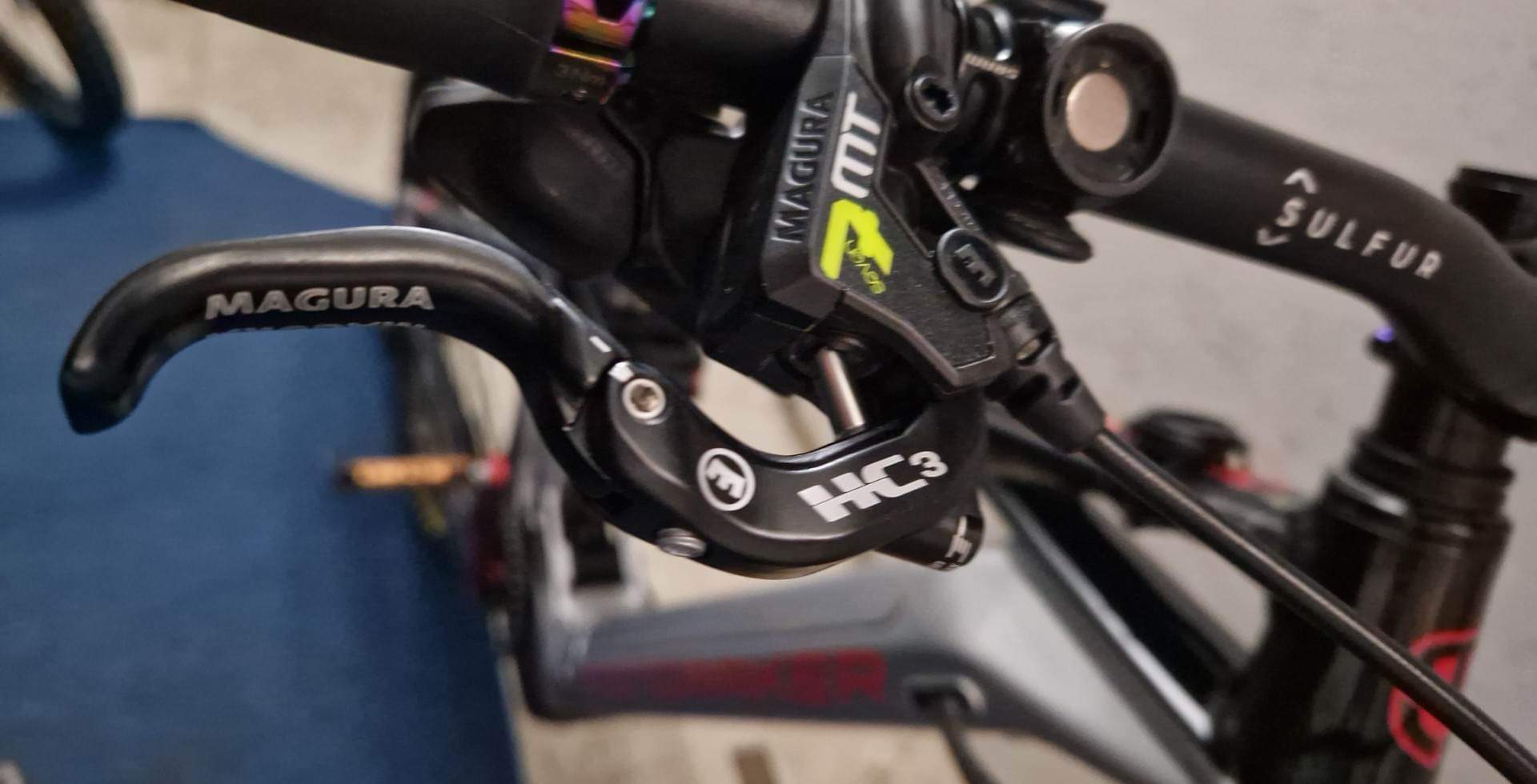

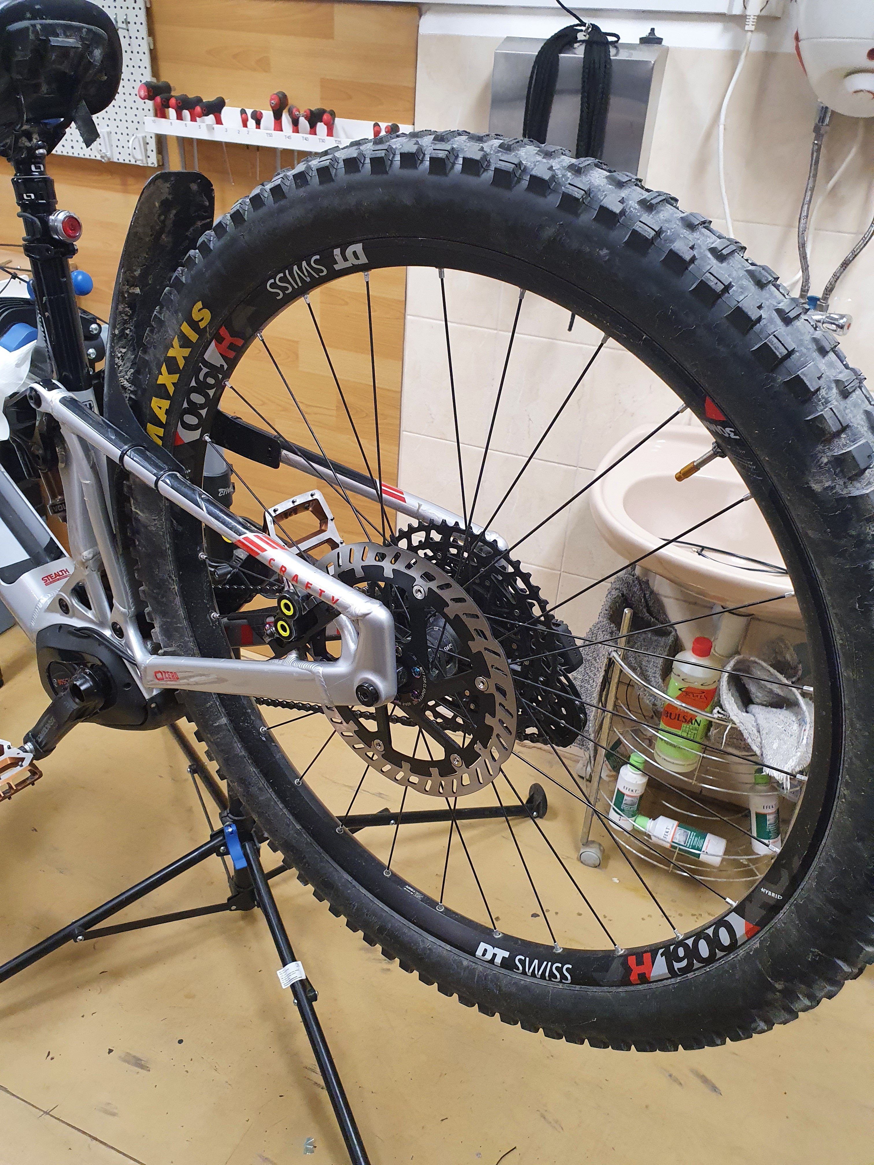

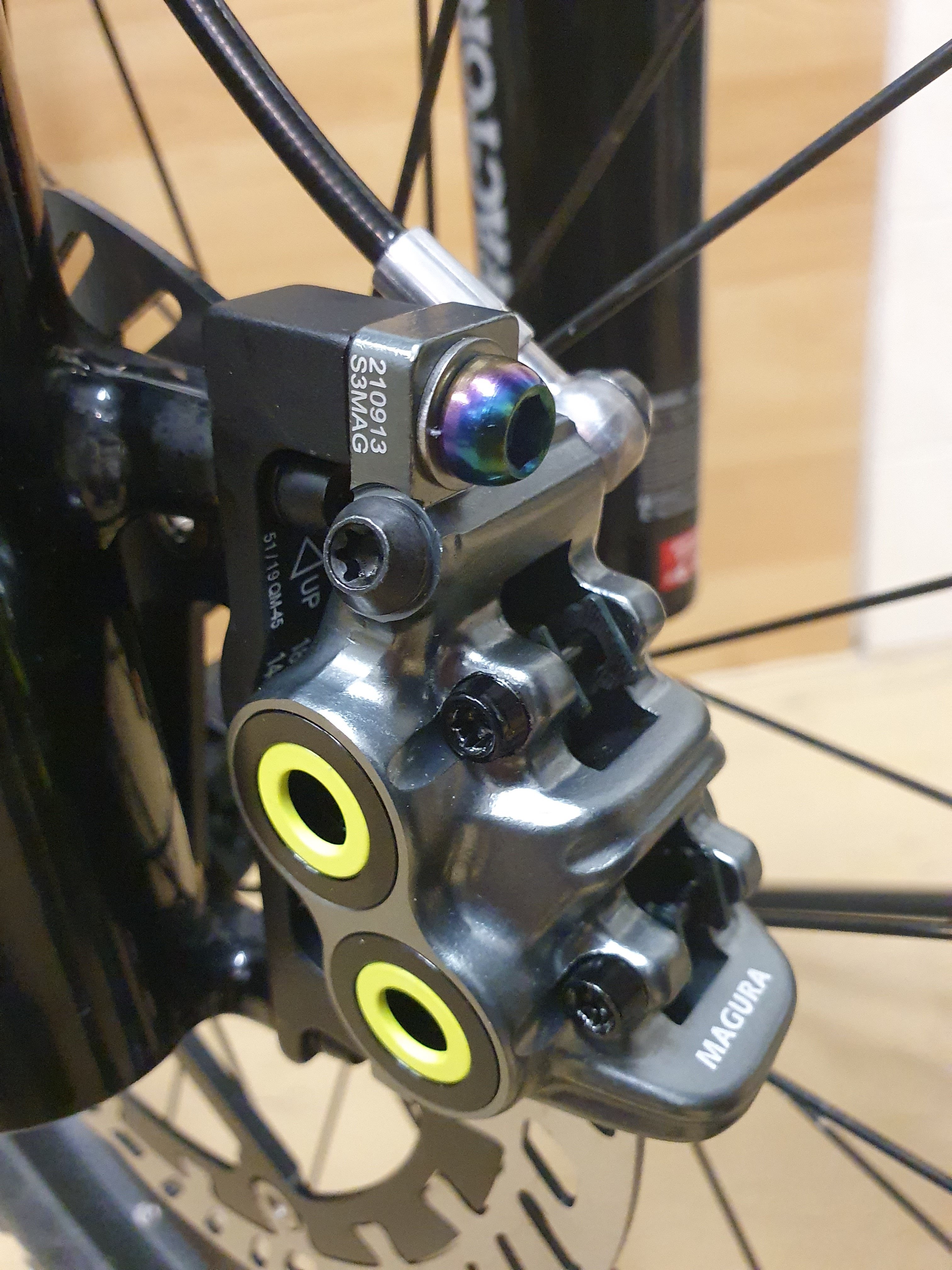

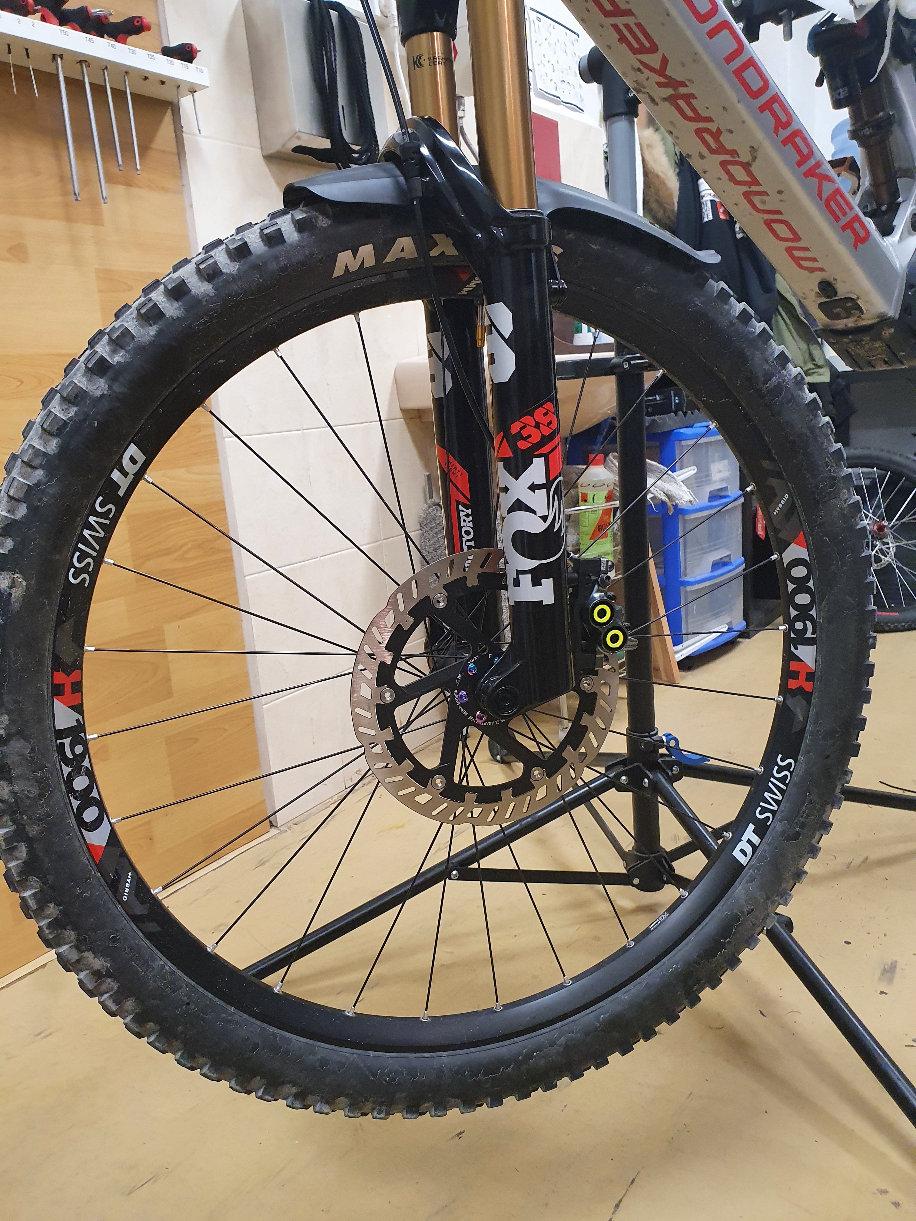

on my mondraker, I replaced code R with magura MT7, 220 mdrp discs and eventually HC3 levers
Despite many mixed reviews, the sram code R never struck me as a bad choice, it was more of an upgrade and embellishment of an e-bike.
Another drawback was that the combined sockets from magura for sram did not get along very well with the axs setting, so in the end I use the sockets separately
Currently it's the best combo I've ever ridden on a bike. I am currently using the second pair of magura boards suitable for ebikes. I also have kool stop red on hold and I'm looking at galfer ebike boards. maguras have only two negatives. Rubber feel of the stock levers (removed by upgrading to hc3) and not completely easy to vent. if they are already set, they also stop the locomotive
View attachment 114928 View attachment 114929 View attachment 114930 View attachment 114931 View attachment 114932 View attachment 114933 View attachment 114934 View attachment 114935
