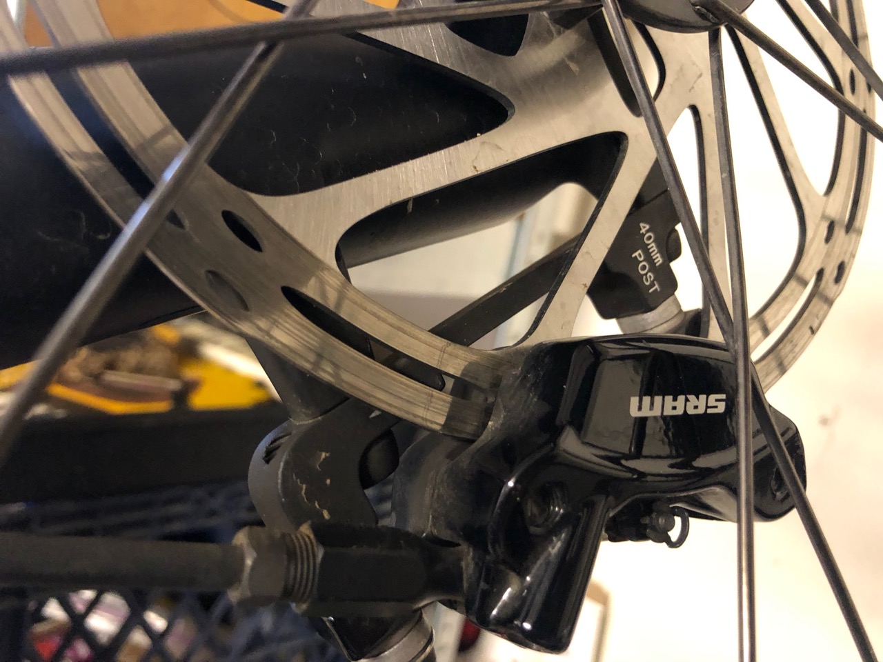

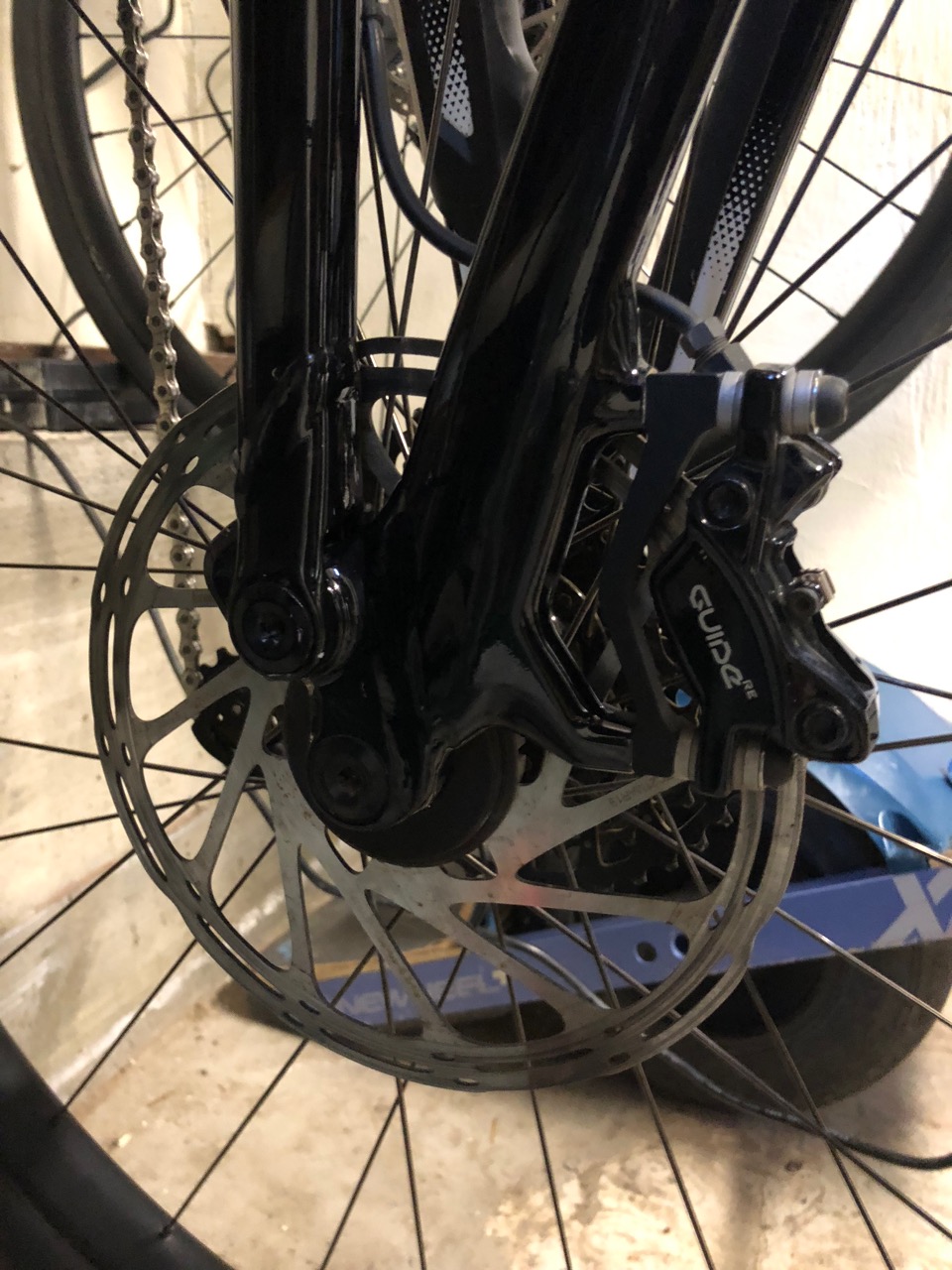

Please note that the actual fork with the spacers is the Fox 34 Rhythm (I'm swapping it for the Lyrik which is arriving tonight ??).
The pics:

OK... Now it seems to be clear.
The Fox Rhythm obviously has PM6. This must be the reason, why you have different adapters on front and rear for the stock brakes.
The rear adapter looks similar to the 2020 Kenevo and it has PM7.
So I'm pretty sure, you will need 2x QM44 adapters.
Maybe somebody else can confirm this...
