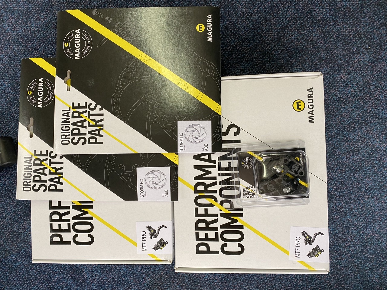

Magura MT7 brakes installed on the 2020 Kenevo by the team at Berkshire Cycles. They are a super powerful 4 piston brake. Single piece forged aluminium callipers with new MDR-P discs paired with Loic Bruni levers for the complete package!
Brakes cost about £150 each (can hunt around for deals!) and the Loic Bruni levers andMDR-P rotors are added extras. Check the brakes here at Magura’s site.

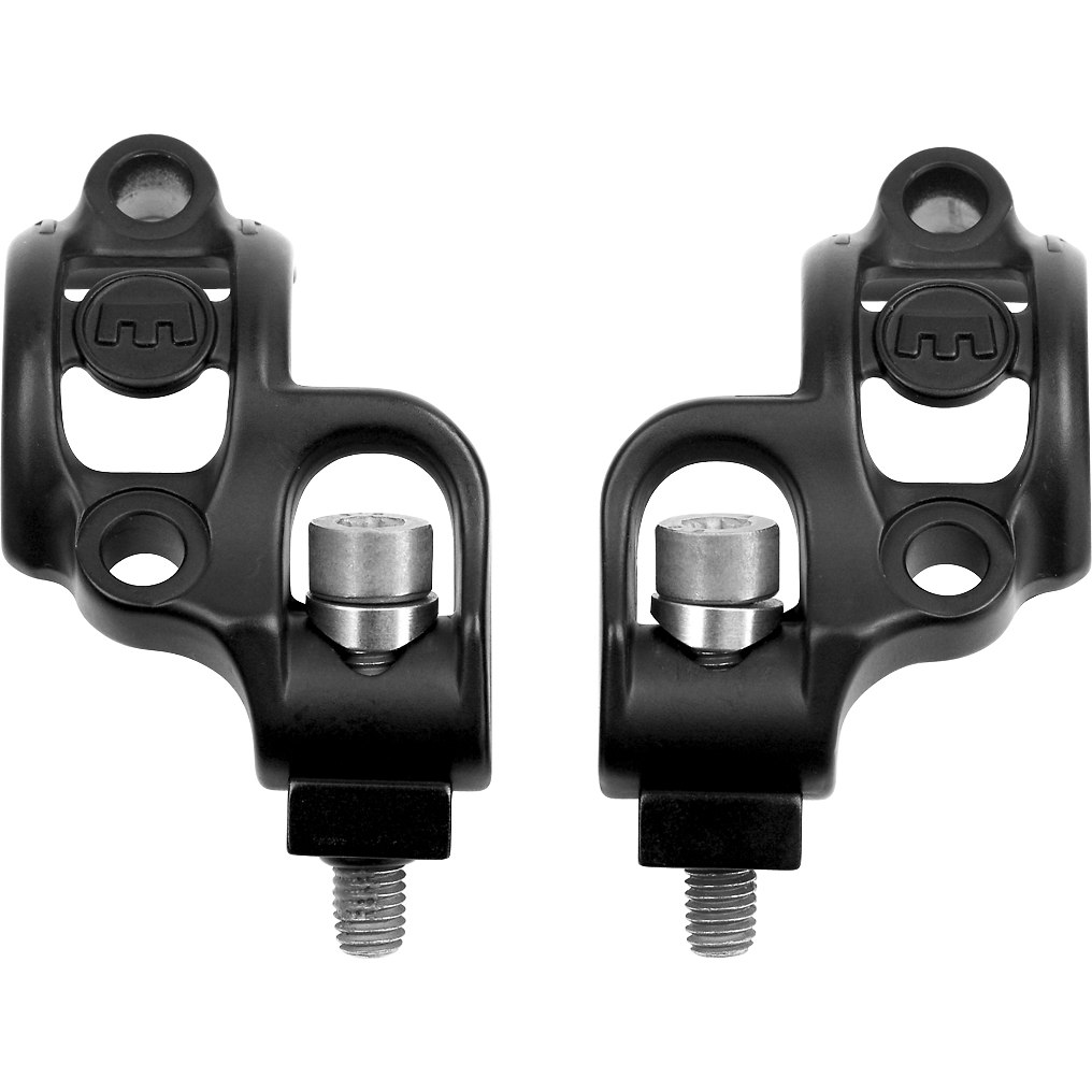

I've been thrashing the MT7's for a few weeks now and so far so good (mostly)
The good:
The Maguras are far more powerful than my old SRAM Codes but at the expense of a little modulation which is a trade-off that I'm happy with. The 2 pad configuration is interesting and I'm looking forward to trying different pad variations. On the trail, they're consistently strong and I've not experienced any fade. Weren't too difficult to setup/bleed but I did need to rebleed after the first ride to get all the bubbles out. The bleed kit is a must and comes with everything you'll need to set up and service for the life the brakes.
Not so good:
I toyed with the contact adjustment didn't really notice a difference. The overall lever quality doesn't impress me either, the 'plastic' is light but I'm dreading the day when they a serious hit. The match-maker system is not as good as the SRAM/SRAM, you can't adjust the position of the clicker in relation to the brake lever. I found the 'shiftup' clicker too far away with my lever in its natural place, and I had to move my hand between shifting and braking.
Verdict: If the only difference between in the MT5's and Mt7's is the lever, I'd go for the MT5's or even run a 'Shigura' configuration. The cheap feel of the lever is the only let down on an otherwise perfect brake.
The good:
Not so good:
What’s a shigura setup mate?
cozzy
Aug 11, 2019
930
1,037
Hampshire UK
Shimano lever of your choice, I used xt.
Magura hose. Shimano compression nut. I've used olives and barbs from both Shimano and magura with success. Shimano brake fluid.
Been running this on one of my bikes for over a year with no issues. Gets away from the horrible plasticy leaky magura levers.

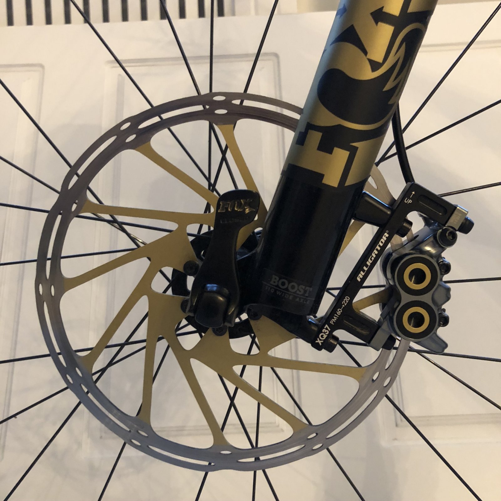

So guys what bloody calliper adapter do you get if you upgrade to 220mm rotors on the turbo levo?
