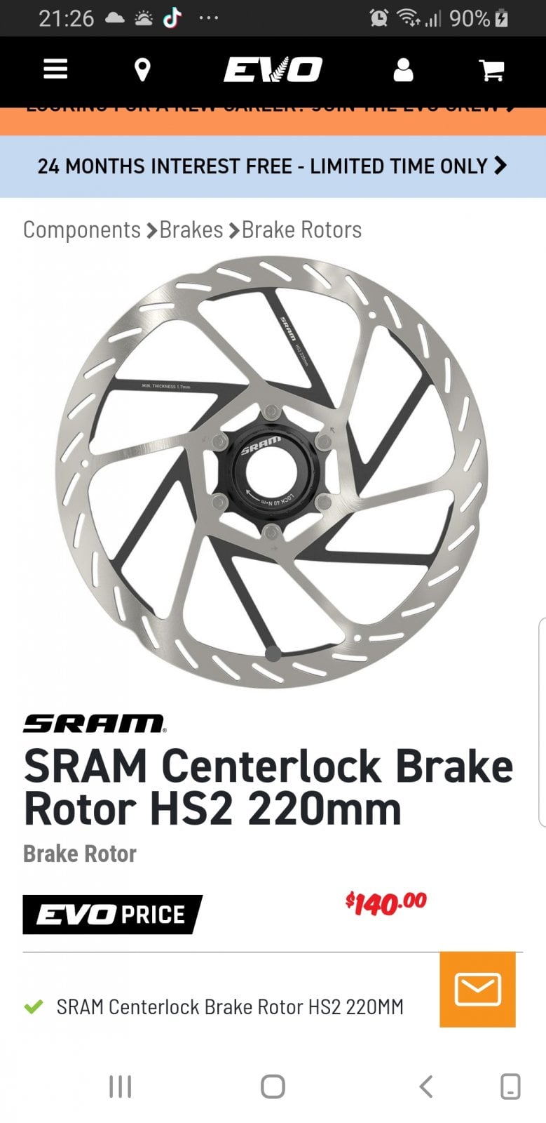

I have ordered some sram HS2 220mm for my trance which has the center lock system, not so many options for these if you want 220's, The Trance comes with 200's but they are pretty average ones.
Has anyone tried these? they come in 6 bolt as well

Hi Shane, just wondering how you got on with these? I’m wanting a bit more power than my 203 rotors offer on bigger descents, I tend to cook them. Seems not much around in Nz for 220/223 centerlock options that I can find.

I put the HS2 discs on my DH bike they’re an improvement over the standard SRAM discs, which isn’t hard, but one still warped after just a few days use. They’re no where near as good as the Magura MDRP or Galfer “thick” discs.
