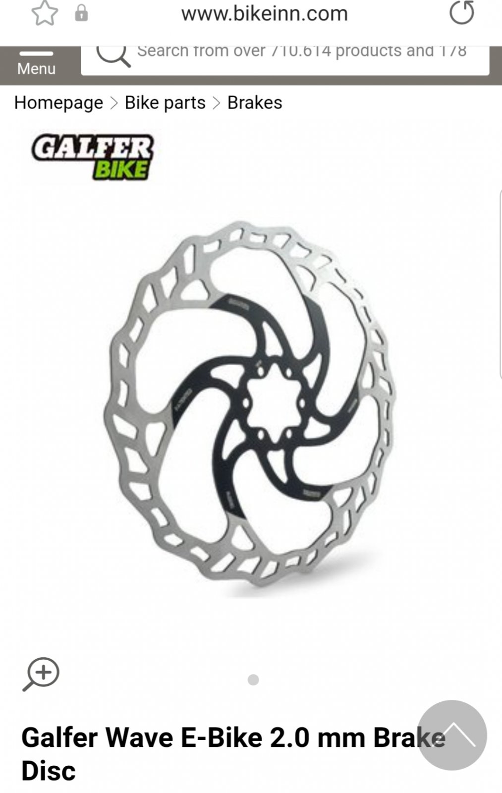

I had these and they developed significant movement. The noise was really irritating. I wouldn't buy again. In the end I got some Galfer rotors which work as you'd expect.
Lol...I all but pulled the trigger on the Galfer rotors 2 days ago, read a few had warping problems and one mag review had a squealing noise after a few months of use.
You have the Galfer Wave 2.0mm one?
They are a well priced rotor
Very irritating? :) I need to replace my rear 203mm Galfer Rotor with 2mm in 3500km now is 1.5mm thickness.
I do not want same Galfer. If Magura is not a good option, Wich Would I buy? If is Centerlock better because my Wild use CL.
Trickstuff? Maybe TRP 2.3mm fit in my Saint Brakes?
Thanks.
PD: I don`t want Ice Tech.
