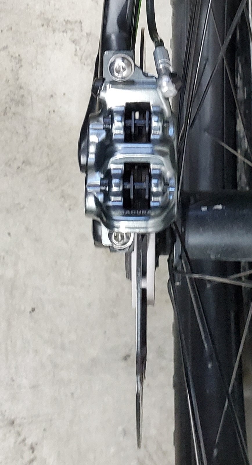

I think it depends on where you ride and how you want your bike to feel.
Is this the rub you are speaking of (sorry about the blur!):
Plenty of clearance.

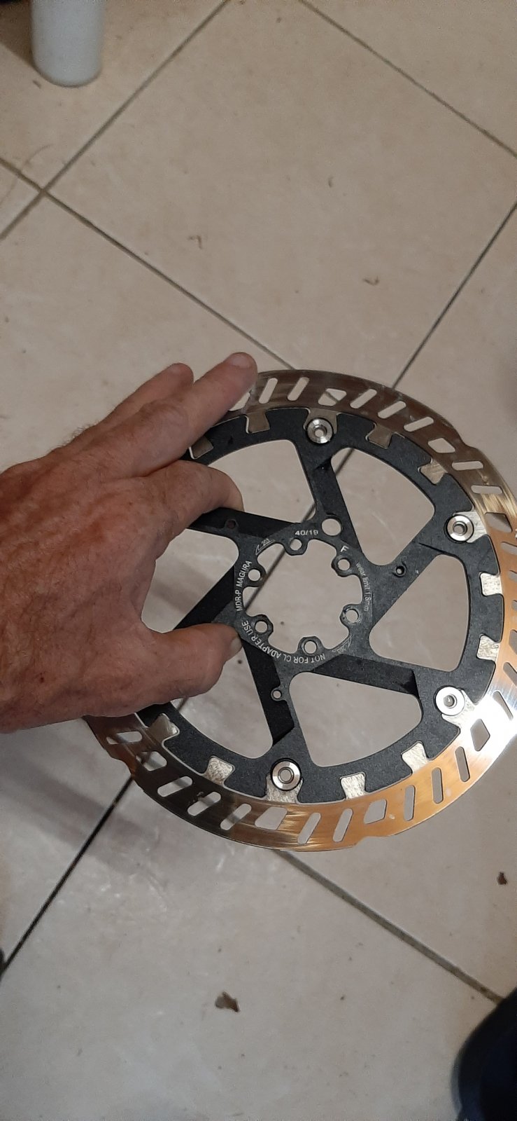

No probs it has facility to attach the magnet .
You are in luck one of mine is sitting next to me off the bike . Uses the rotor bolts .

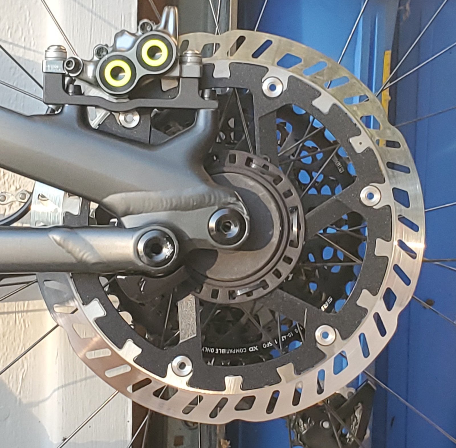

I have a 2019 Turbo Levo FSR. The base mounts (with no adapter) are 180mm. That's all that matters for choosing what the correct adapter you need. You can use this chart: Redirect Notice (from here : MAGURA | Bike & Motorcycle Brakes )
My bike had 200mm front/200mm rear, with SRAM Level T brakes.
To install 220mm both front and rear with Code RSC, I used a Magura QM45 adapter, and M6 20mm bolts.
I transferred the magnet from the old to new rear rotor and had no issues at all with clearance to the swing arm or with the sensor and magnet.
