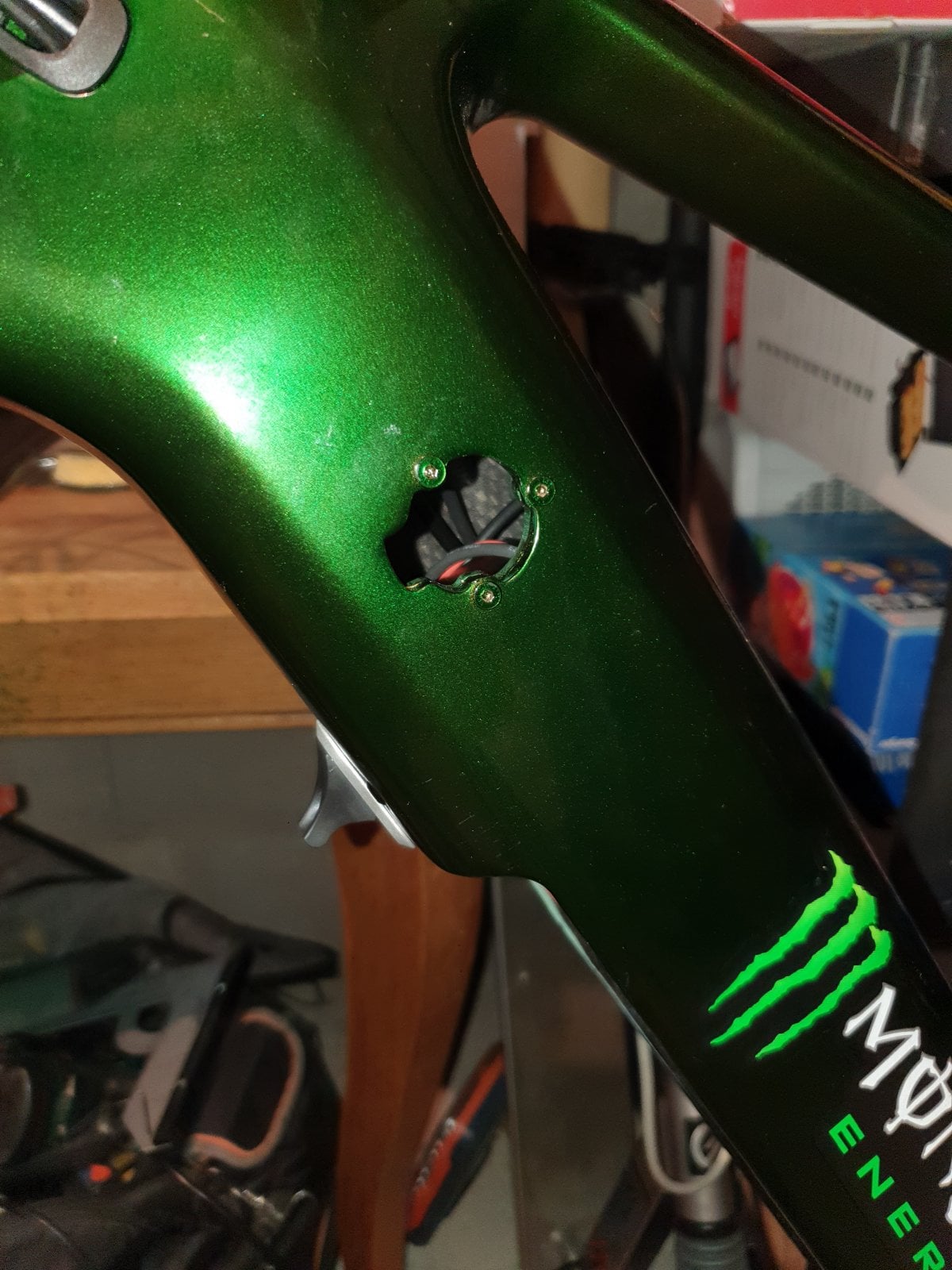

Hello,
I work to finish my LCES004 with M510 motor and I don't find solution/part to close this hole.
could you help me?

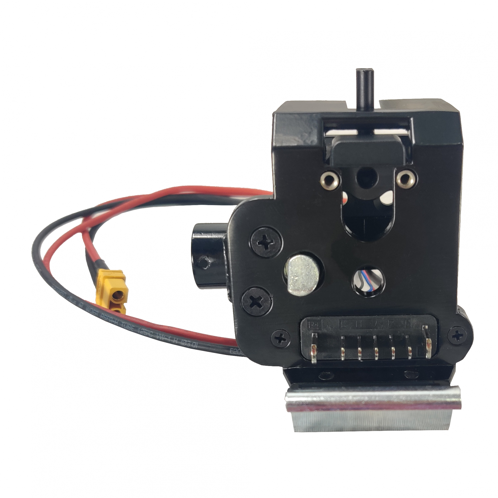

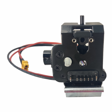

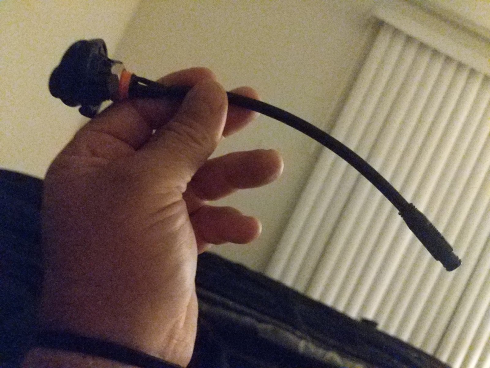

Where did you get the part that holds the battery into the frame? Is it the thing pictured below? Is that the "charger"?
I am going to buy the same frame, motor, and battery, but I have no idea what I need to order when it comes to the battery connecting to the frame like yours does...
I am planning on ordering the motor kit and battery through fltebike.com as they were recommended by the LightCarbon rep, but it doesn't show me what comes with the battery.
Slaine
Apr 12, 2022
96
39
France
this part is the battery connecto on frame, normaly he come with the motor & battery kit if you buy a bafang battery BT f03 or BT f04

I got the charge plug with the BT-F03 450 Wh batteries...

Hi,
1) For the speed sensor I have just the right length. I put the cable on the hole on the frame just up to the motor.
2) I don't have this issue with my frame, the connector fit on the frame
3) I don't find the plug. I create a CAD Model to close the hole. I print on PLA with my 3D printer
regards

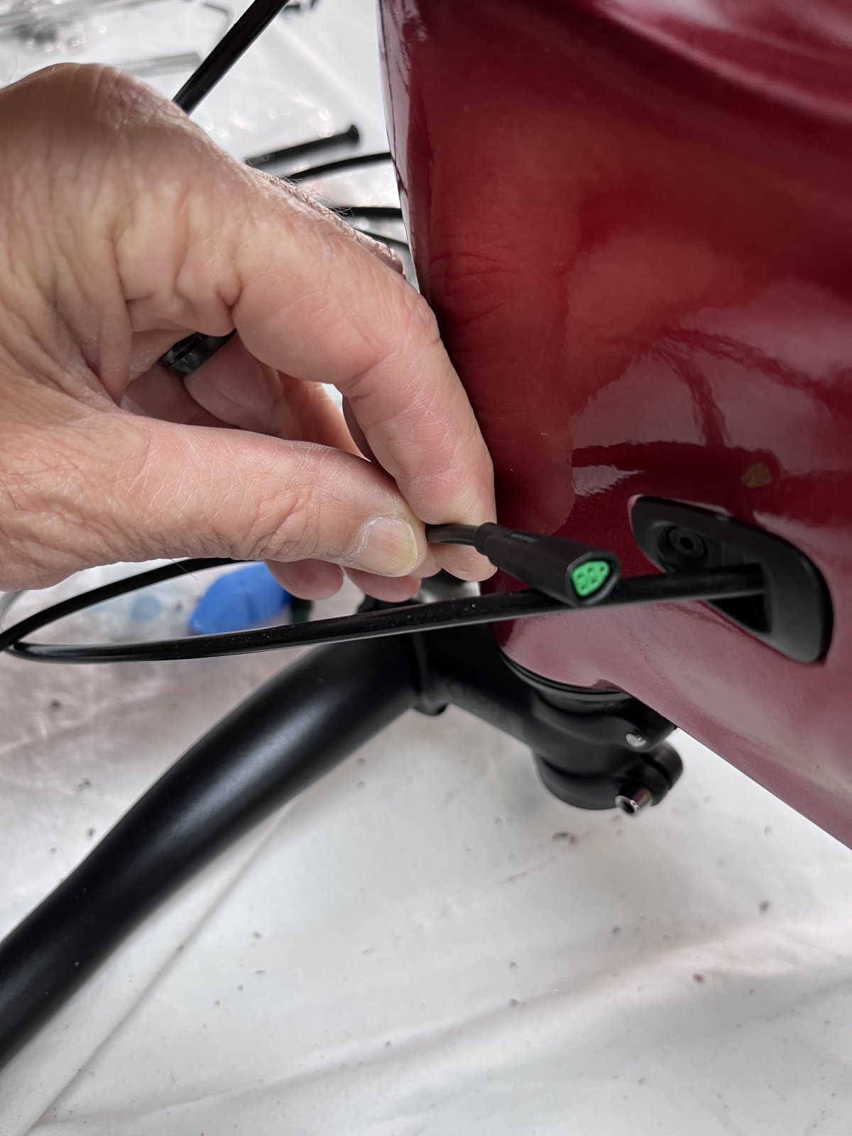

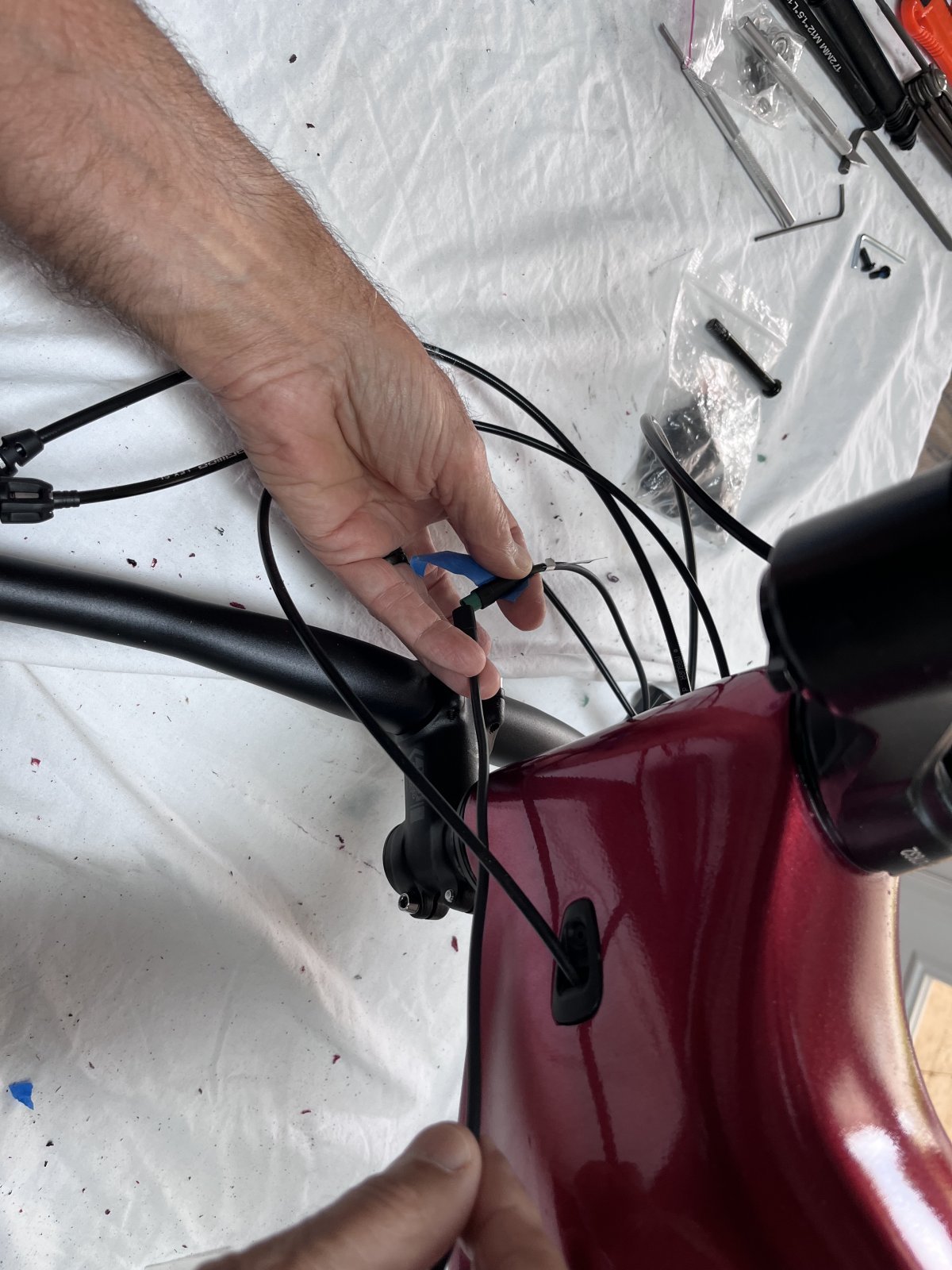

The connector cable coming from the display is very short (20cm in length). The cable coming from the motor has a green connector that needs to pass through the "cable frame plug (plastic grommet)". The frame plug is intended for two cables and has separate cable holes. The green connector will not pass through the hole. I would need to cut out the separator and jam the plug through this "expanded" hole. How did you solve this issue?
I am discovering that the frame manufacturer (Light Carbon) is not in synch with Bafang and you really have to use a lot in ingenuity and do this project (wrong length cabling, rubber grommet doesn't fit hole size (where the key lock passes through the frame), no wiring schematic, no assembly guide, and a bunch more ... oh well.
I just heard back from Anna at [email protected] - they are selling me the longer cable to solve the speed sensor cable length issue. She said they don't have a charging port suitable for this battery. Where did you get you connector? Is there a "proper" partnumber for it? Thanks for the help by the way!!
View attachment 98944 View attachment 98945
Try switching the cable frame plugs for each side...they were reversed. I drilled mine bigger and squeezed the display cable (green plug) through before I discovered the former and already set up my rear brake😑.
I had to buy an extended cable plug at greenbimekit.com myself (they suck but better than no retailer).
Grommet for key hole should fit barely and won't pop out once inserted.
I have an extra charger plug if you want it. I'm doing a second build with my DIY battery and was going to use the other charger port plug at the frame key hole with modifications to frame.
Send me your address if you want to my email:
[email protected]
and I'll send the other one to you with shipping quote. Then PayPal shipping fees to me prior to shipping.
