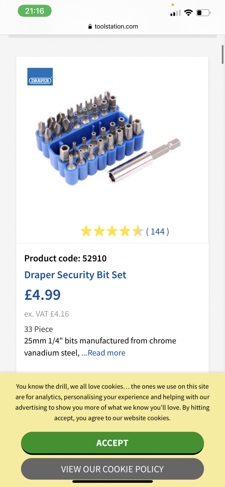

Great Idea but I could only unloosen two of the bolts on the back of the battery, The other six are the security type of star screws. They need a bit with a hole in the middle. I ruined an old credit card trying to do this with no luck but thanks for the idea.
Doomanic
🛠️Wrecker🛠️
Jan 21, 2018
8,724
10,389
Or just knock the centre pin out with a hammer and punch.

£4.99 toolstation

No, he's the US, which is why I posted a link to Amazon USA.
chrismechmaster
Dec 7, 2020
816
420
Newbury
Sweet I guess they don’t have toolstation in usa don’t know ?
was thinking he will want these bits tomorrow if he is desperate to get this battery out
