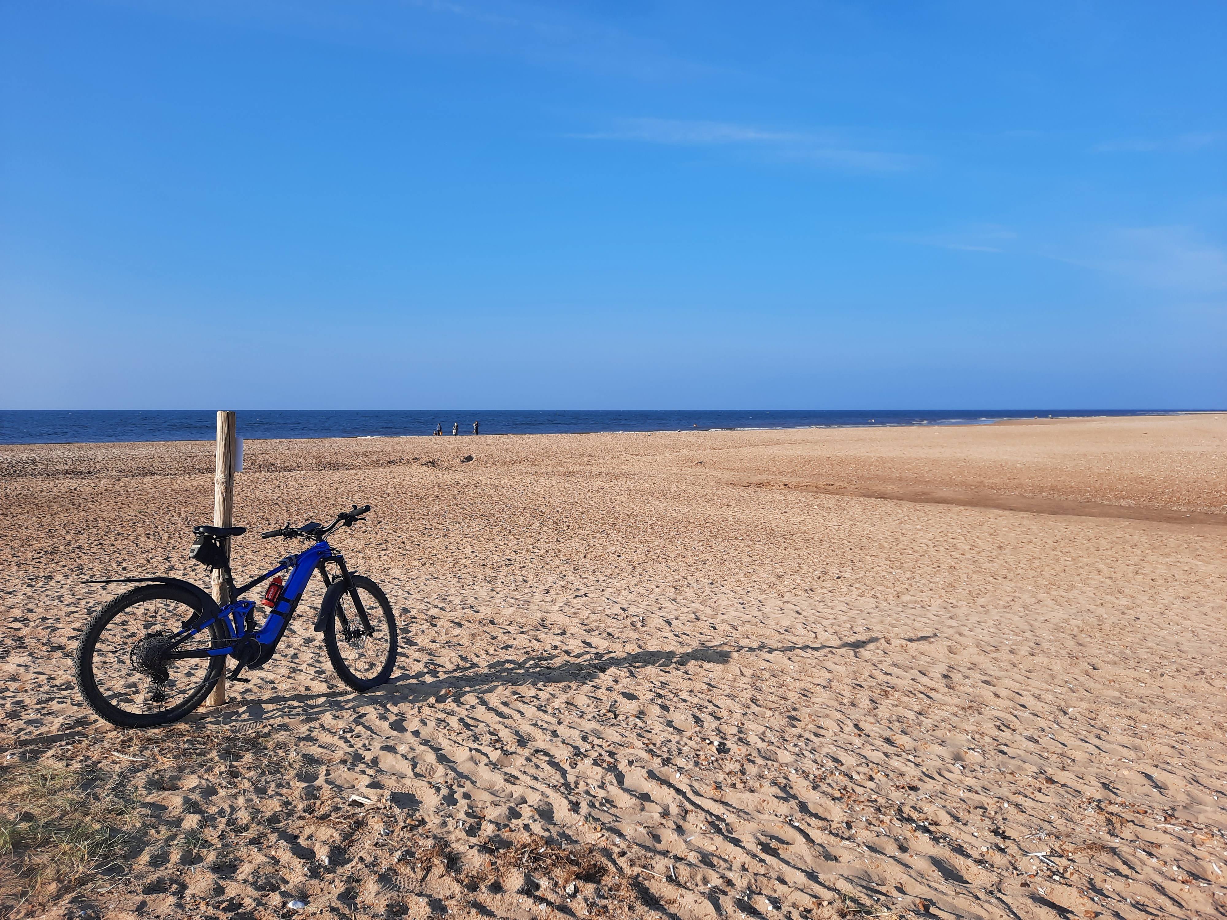

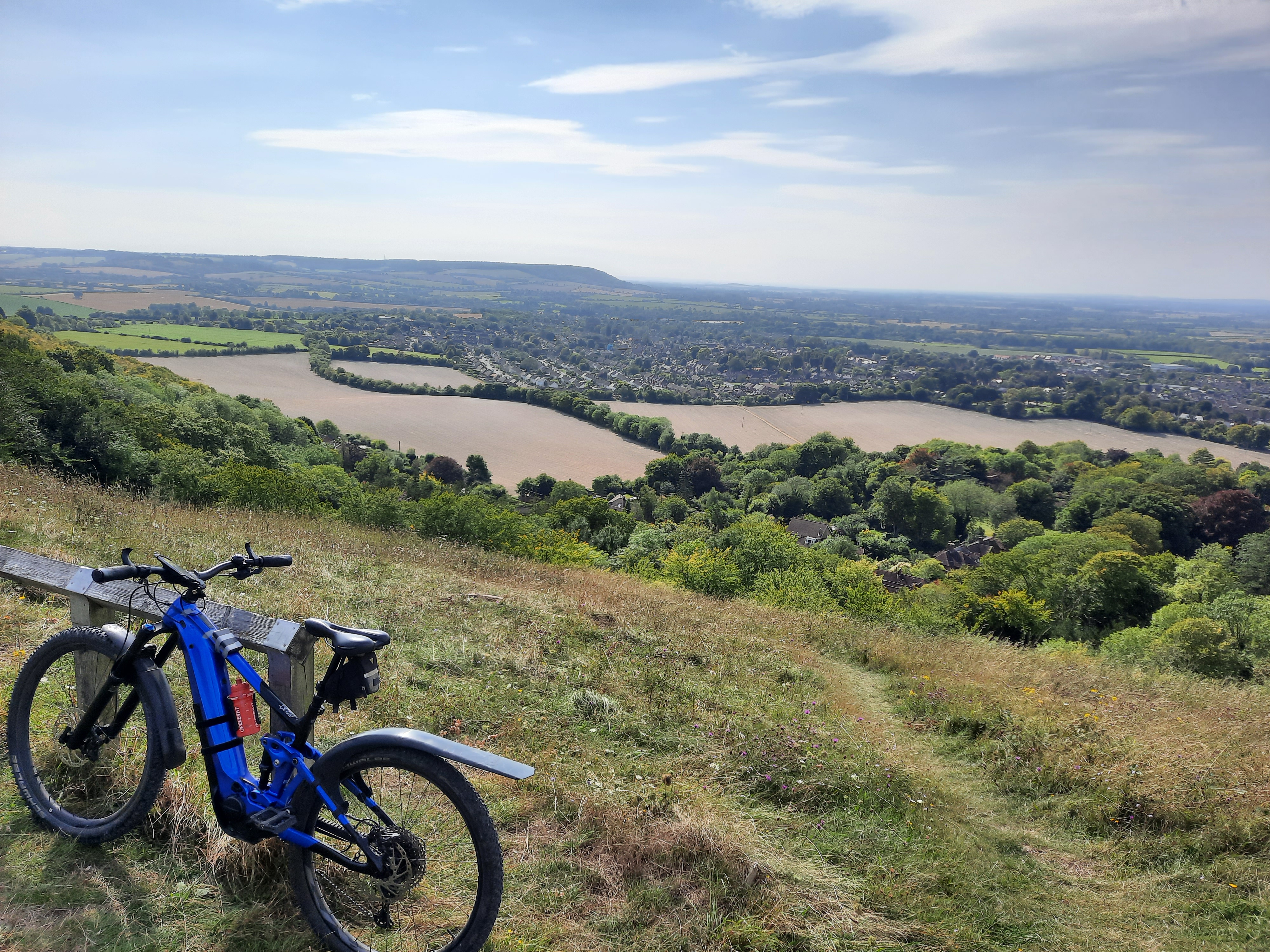

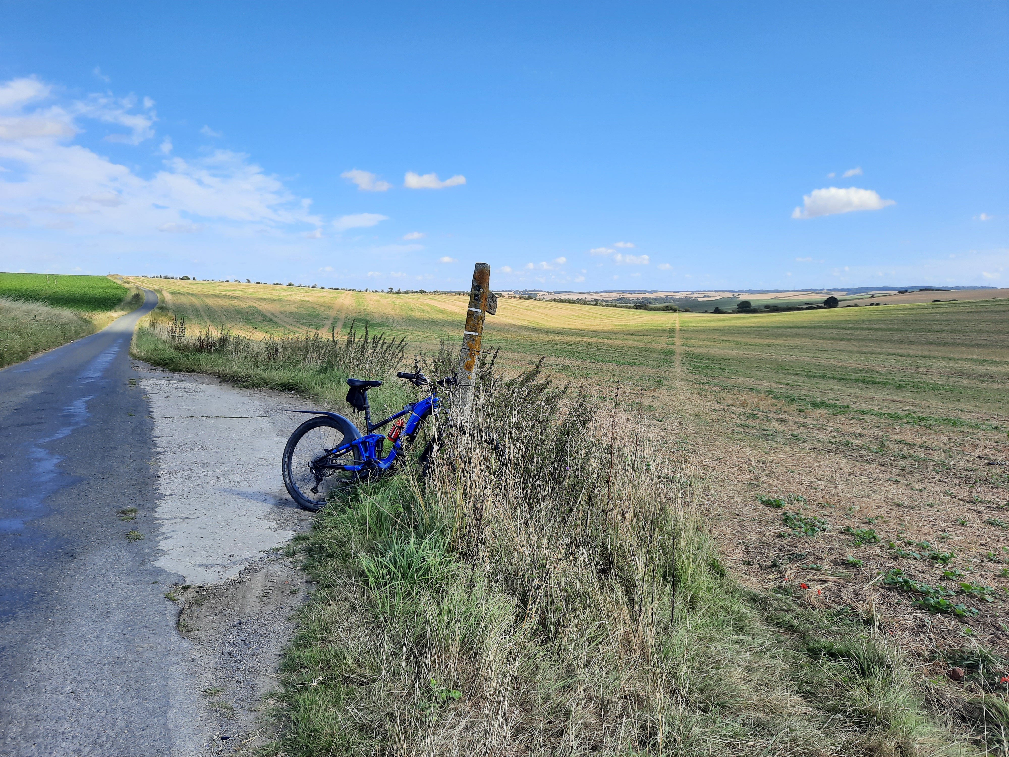

Tedster, this may be of interest to you.
I've just completed the Greater Ridgeway Trail, almost 400 miles over 8 days. Did it in two halves, the first half on a Gaint Reign e+1 in May with 625 battery and the second half on a Trance E+2 with 750 battery. The Trance was the better bike for me, the Reign was overkill.
The only mods were slightly higher bars, 2.35 Smart Sam tyres, a better seat, Grip Puppies and inner bar grips. The bike was right for me on this trip and it coped with everything well, some sections needed all the suspension (150/140) and others not, but I would not have wanted to be on a bike with much less travel.
The daily mileage was from 44 to 67 (Dorset is very hilly, Norfolk flat) but always had at least one bar left. I passed several gravel bikes along the way and the riders did not look that happy or comfortable to me, some said their hands were shaking after a few miles of gravel.
I usually ran the bikes in level 1 or 2 with the occasional level 3. With a lower power bike it would end up running near its maximum for longer so in theory the bigger motor should be less stressed and last longer.

I'm around 75kg, have lost a few this year with all the ebiking.
Grip Puppies are foam over grips from the motorcycle world, I have them on both motorcycle and bicycles. The inner bar grips are really good too, they just give another riding position and handy in a headwind...all on ebay of course.
It's the standard Trance but with the 750 battery bought from here
The blob on the top tube is a power bank as the phone would not last all day.
Re luggage, I am lucky in that her in doors was acting as support vehicle in our camper, so only needed to carry day stuff, just a seat bag and bum bag as I prefer not to have a rucksack. However the other week I did see a orange Giant emtb locally with a rack on the rear frame and bags on the front too...it can be done, 20240827_151208[1].jpg 20240829_112754[1].jpg 20240830_173559[1].jpg

Looks good actually, wondering if advanced is worth extra money
Thanks for all info super useful
