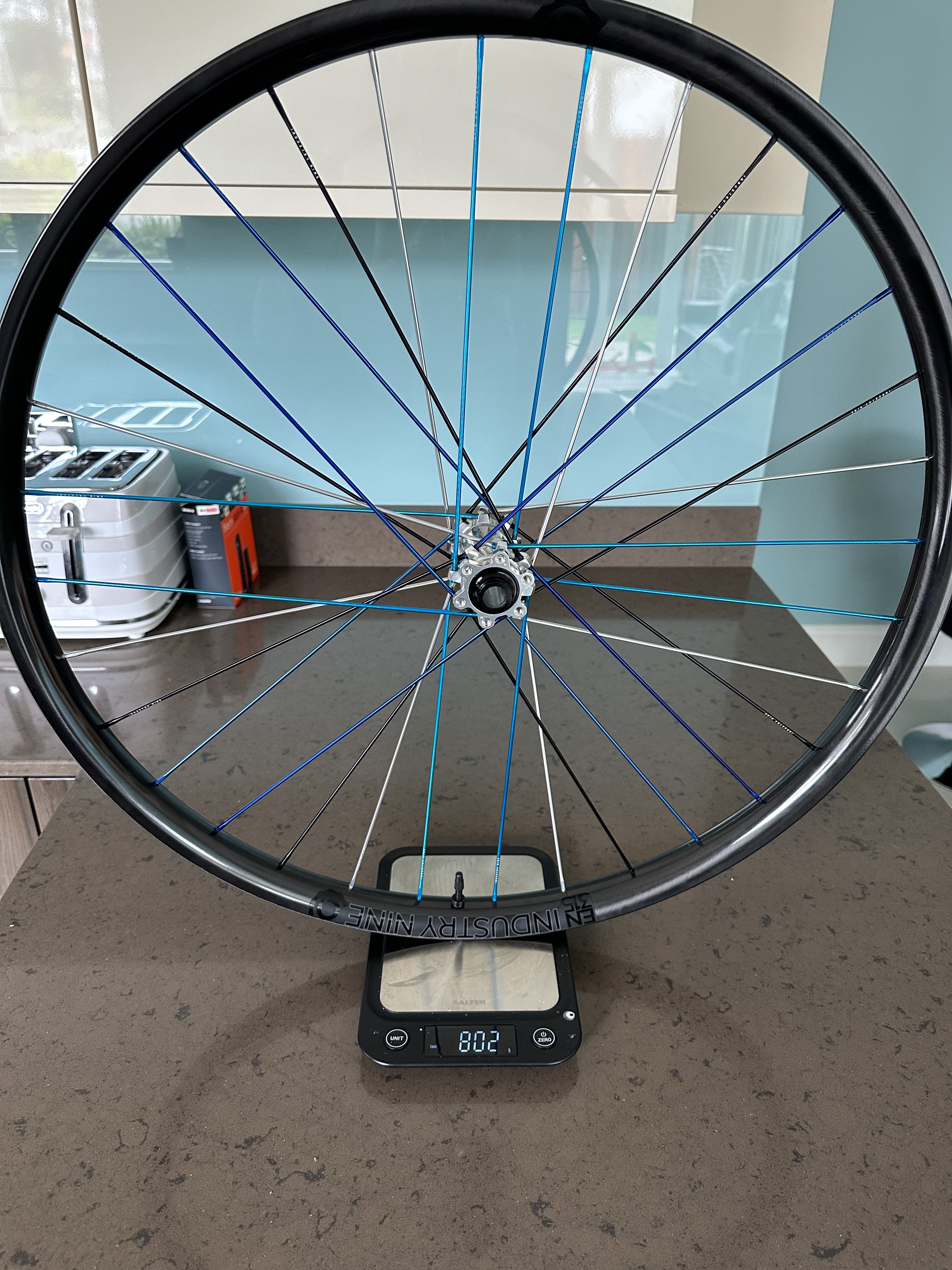

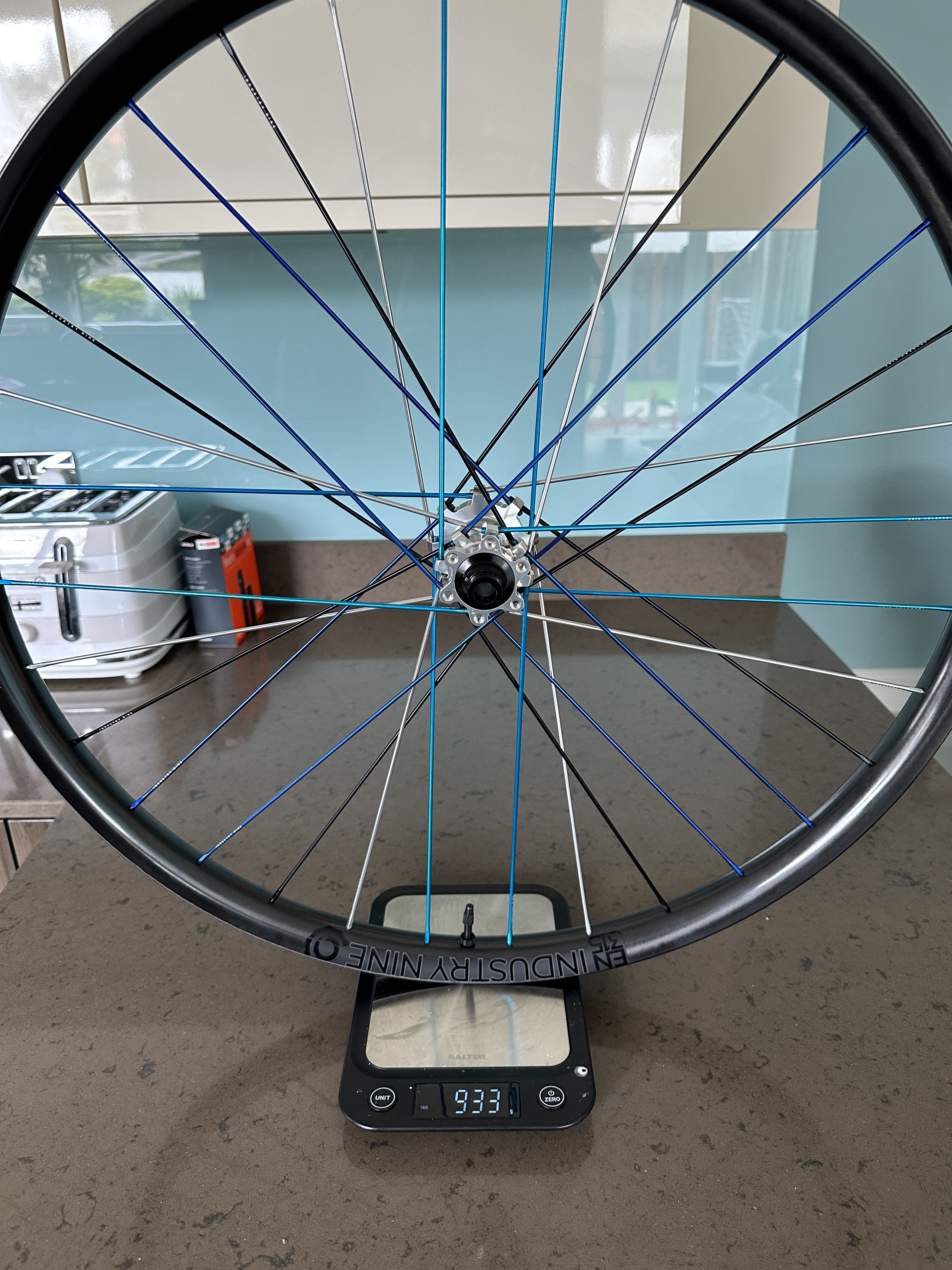

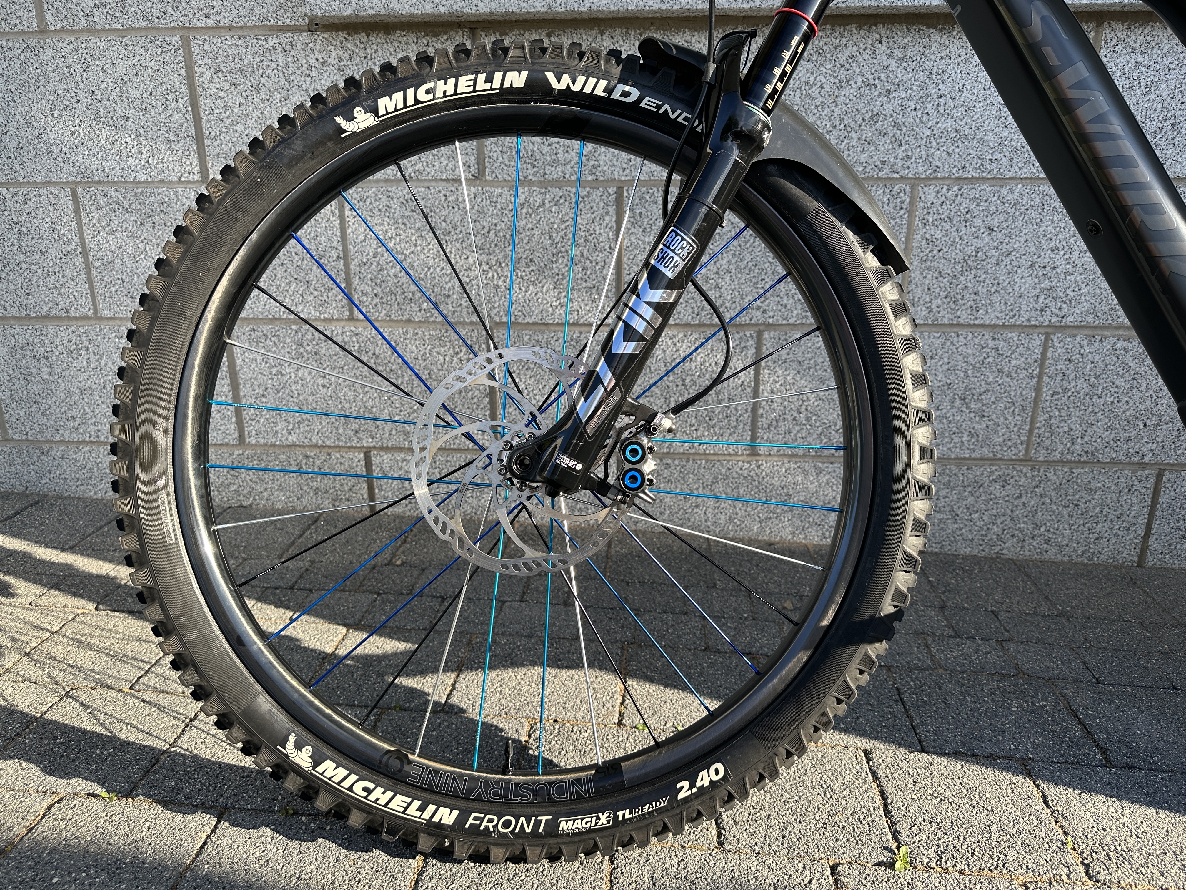

I think I'm going to keep the bike as a 29'er... so now I need to pick a wheelset.
If all options were available to me at a reasonable cost, I'd being going with the Industry Nine 315 with 32 spokes on Hydra hubs... purely for the customisability! Those wheels look awesome... but a fully pimped set are going to cost about £2600 for me in the UK.
My next choice is a set of WeAreOne Convergence Triad wheels - with Sapim CX-Ray Spokes and i9 Hydra hubs. Somewhere about £1900, and just under 1900g (inc XD driver)... which isn't much of a weight saving from the Roval Carbon wheels I have on at the moment.
I could get Sixth Element a bit lighter / cheaper with DT240EXP hubs... but they come out more expensive than the WeAreOne's with i9 hubs at £2031 and about 1775g.
Another option is to buy a set of Roval Traverse SL wheels - which are about 1770g, and I can probably pick up the set for £1300. I feel like if I'm going to spend that on a set of wheels, I should really get something nice that don't look like they came stock with the bike though!
I'm a bit torn now. The Convergence rims look awesome with the twisted effect, and are my front runner...
Just a shame you can't buy i9 spokes over here at a reasonable cost.

I'm not really trying to advocate for Berd, but it is an interesting technology. As to compliance, I had been on a set of I9 Trail 270's with the alloy rim. They're 24 spoke, so they have a nice ride characteristic. These are a little better. The compliance seems to be in the plane of the wheel. So, impacts feel a little less jarring. Outside the plane of the wheel, though, they are not flexy, IME. They track where you put them laterally, but are compliant vertically, if that makes sense. I'm not sure they would be worth the extra $500 in spoke cost, but I have my children's inheritance to get to zero.
Jukka4130
Jun 27, 2021
36
34
Finland
Apparently, that is enough to stretch the spokes.
To be more exact, the build process entails tightening and letting the spokes set under tension for 24 hours – three times. In other words, there's quite a bit more work involved when building wheels with Berd Spokes. In certain applications, it's well worth it, though.
Regarding hub choices. All J-bend hubs need to be prepared before installing Berd Spokes. For most manufacturers, this will void warranty, at least when it comes to the hub shell. Using hubs with propieritary Hook Flange design, made specifically for Berd Spokes, makes life so much easier during the build process – while keeping warranty intact. Besides Berd Talon hubs, Onyx has their Vesper lineup available in Hook Flange versions. The Vesper is not approved for e-bike use, however.
