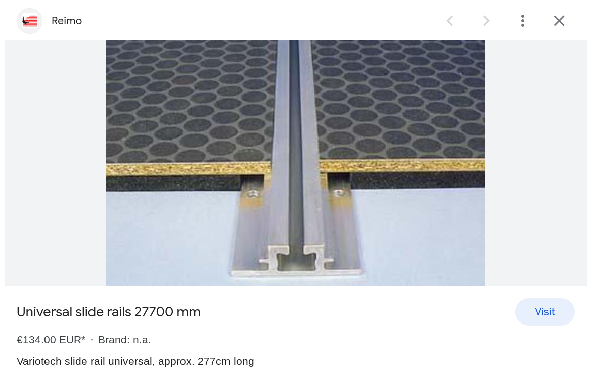

You could in theory bolt a fork mount to a linear rail system, but I don't see how it would help, you'd connect the fork to it - then when sliding the bike in have to lift the back end up into the van, which is the same amount of effort as.... lifting the back end into the van

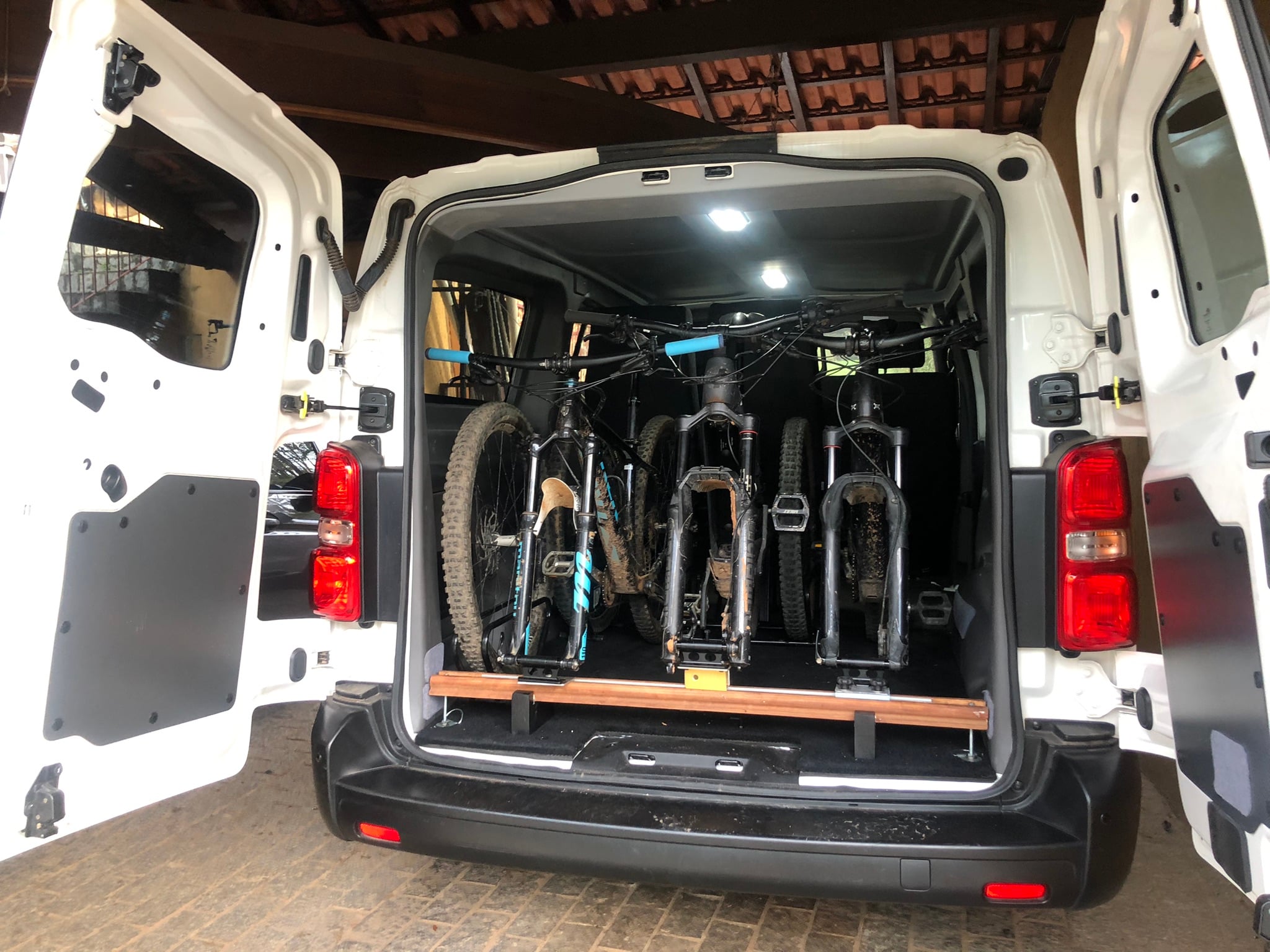

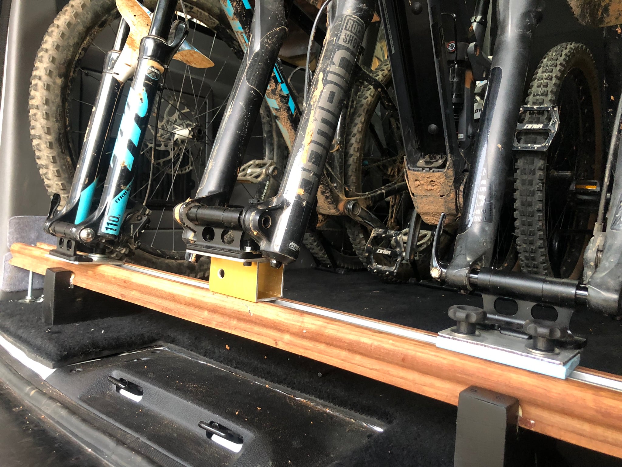

I don't find it too bad just lifting the back wheel into my Caddy and then the front sits on a fork mount.

We have a couple of similar ramps we used to use to load a couple of supermotos on the back of our pickup truck (which we no longer have). We also still have a couple of Bumpstops that were bolted to the load area which held the bike front wheels, perhaps they could be used for eBikes?
